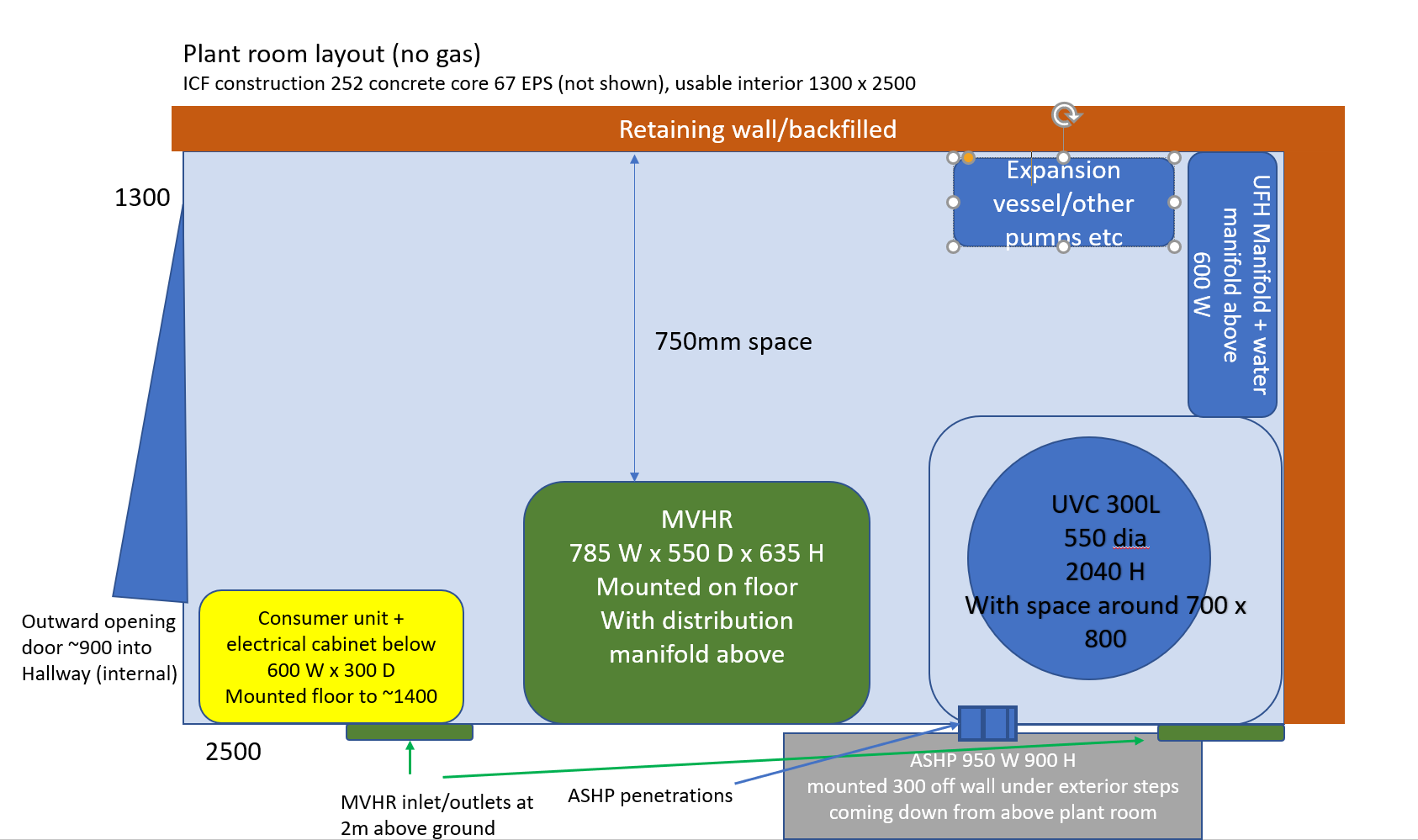

Thanks have added some notes to my plan so I remember this ? @jack yes good spot - I expect to have utilities enter at back left so water softener could be good here to keep kitchen / utility free. @Dudda yes thinking to have hot & cold manifold and then a hot return from the top floor manifold. Will be using some form of home automation technology - currently trialing Fibaro Z wave in current house) so may use the elec cabinet as the hub for that. Was thinking to have a small AV cupboard but if I can fit it all in here then that could be even better - hadn't really thought of doing that. Luckily my initial plan shows this opposite end to wet stuff and may be prudent to have cabinet 100mm off the floor as well...just in case. Only issue may putting laundry on the cabinet if we put a drying rack in here ?
Hi, we're closing on on finalising the revised planning app and I'm thinking what will be in our plant room - appreciate thoughts on layout and additional items I may have missed. I have read about the DHW cylinder being near most frequent/heavy points of use but the plant room seems best place may go with a PIR activated hot return to help with that. House is ~300m and the spec (from BPC) was for 2 x MVHR units - am thinking one can go in the plant room to serve the 2 floors nearest and the other can go 1 floor up in the garage. Heating is UFH with an ASHP which I'm thinking will be well located just outside the plant room - not near any neighbours and any noise will not be near any windows. My layout idea is below. The dimensions are from the expected components we've been looking at so far. There is a separate utility room for washing machine/storage and drier etc. One idea I read about somewhere was for a drying rack in the plant room - may be an add-on when we finish it. Not currently planning on any windows. Location is Dorset and the position of this room is to the side of a lower ground floor and will be mostly shaded from the sun.
