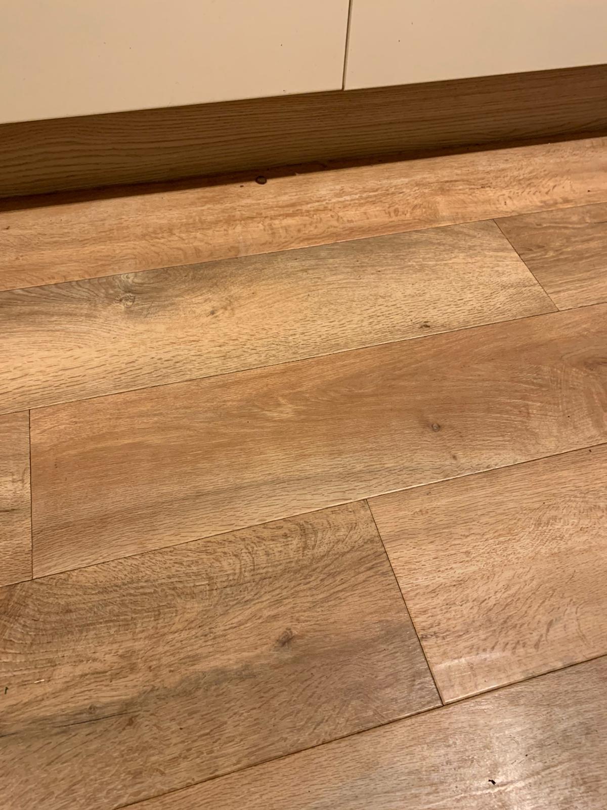

  3. Strips of vinyl glued directly to the floor Its similar price to tile Looks and feels like timber slats
