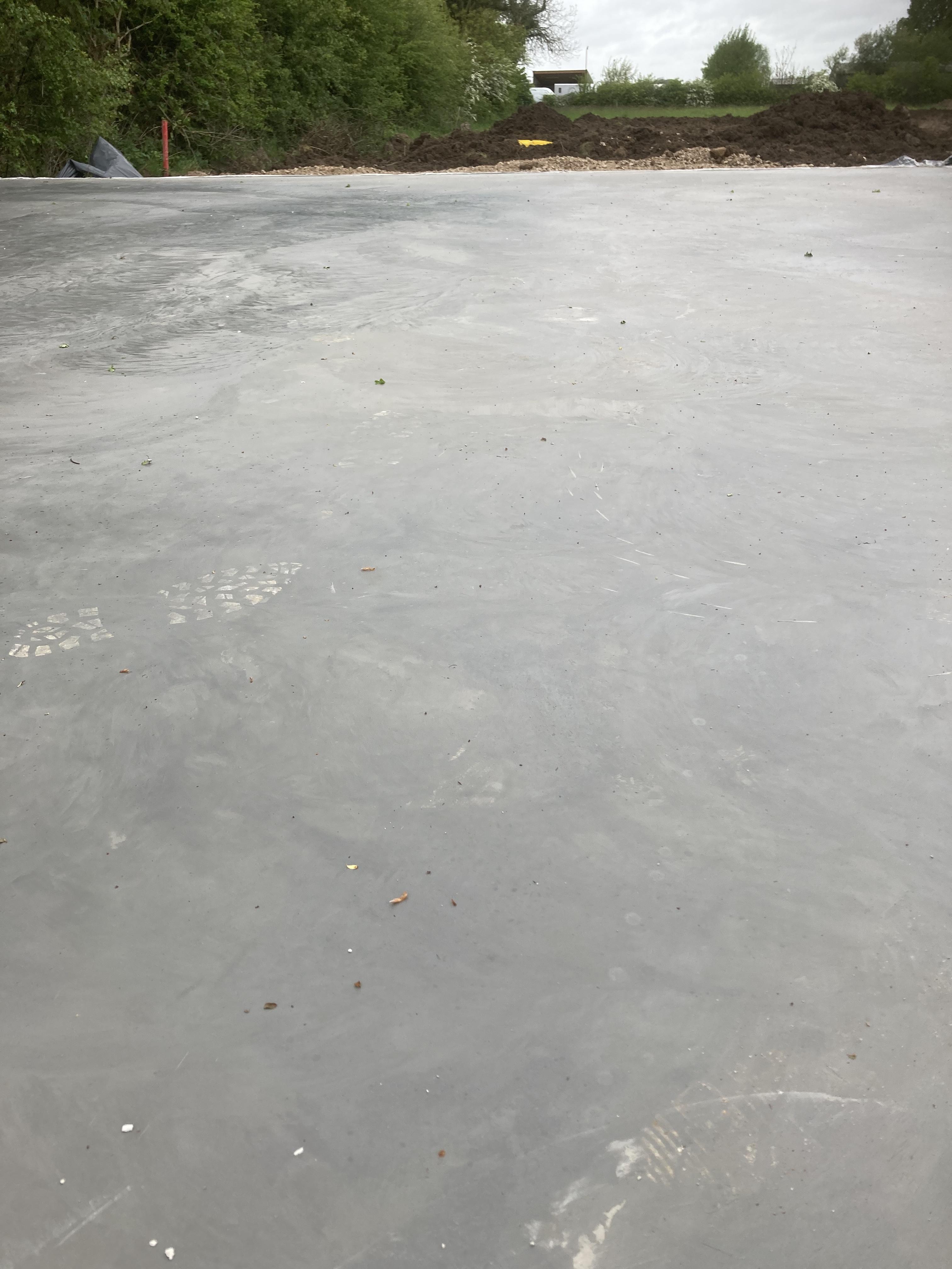

Why not hire a power float for the day Better finish than self leveling I polished our workshop floor the morning after laying
