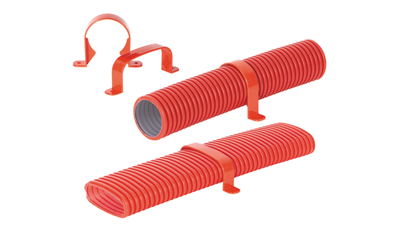

MVHR vent location
dogman replied to dogman's topic in Mechanical Ventilation with Heat Recovery (MVHR)
I have considered using the oval ducts that are about 50mm deep. Will need to drop the celing by another 30mm the plenum is not that deep -
MVHR vent location
That was my idea of using the service void on MBC homes. The air tight layer is the OSB inner skin for walls or the airtight membrane for roof this is then battened out by mbc as a service cavity -
MVHR vent location

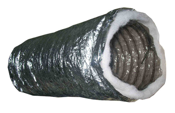

@Mikey_1980 Had not thought of that, Was it standard 75mm flexible duct ? It would save on insulating pipe to avoid condensation Were they able to seal the vents enough for the air test?( didn't you have issues with yours) -
MVHR vent location
I did consider floor vents but wife not a fan of them. I have found that in our current house the vertical vents are noisier than roof vents. It could be the type of diffuser though It would be the easiest in the floor and as any noise is sent upwards it should help -
MVHR vent location
I have had my designs back from my preferred supplier. My next issue is the supply outlets in the bedrooms. As we have a sort of room in roof (roof starts 1800mm from floor with a height of 2800 at the small ceiling) it is difficult to put the outlets in the ideal location ie in the corner furthest from the door I have the following choices in the vertical wall between two bedrooms in the flat roof above the windows or try my latest mad idea. Use the service void as a duct one side will be osb the other plasterboard my only worry is that i am looking to have some sort or active cooling so it may need to be insulated with some sort of thin insulation mhvr idea.pdf Is it a good idea? am i missing something. I can work around the battening. Comments please -
