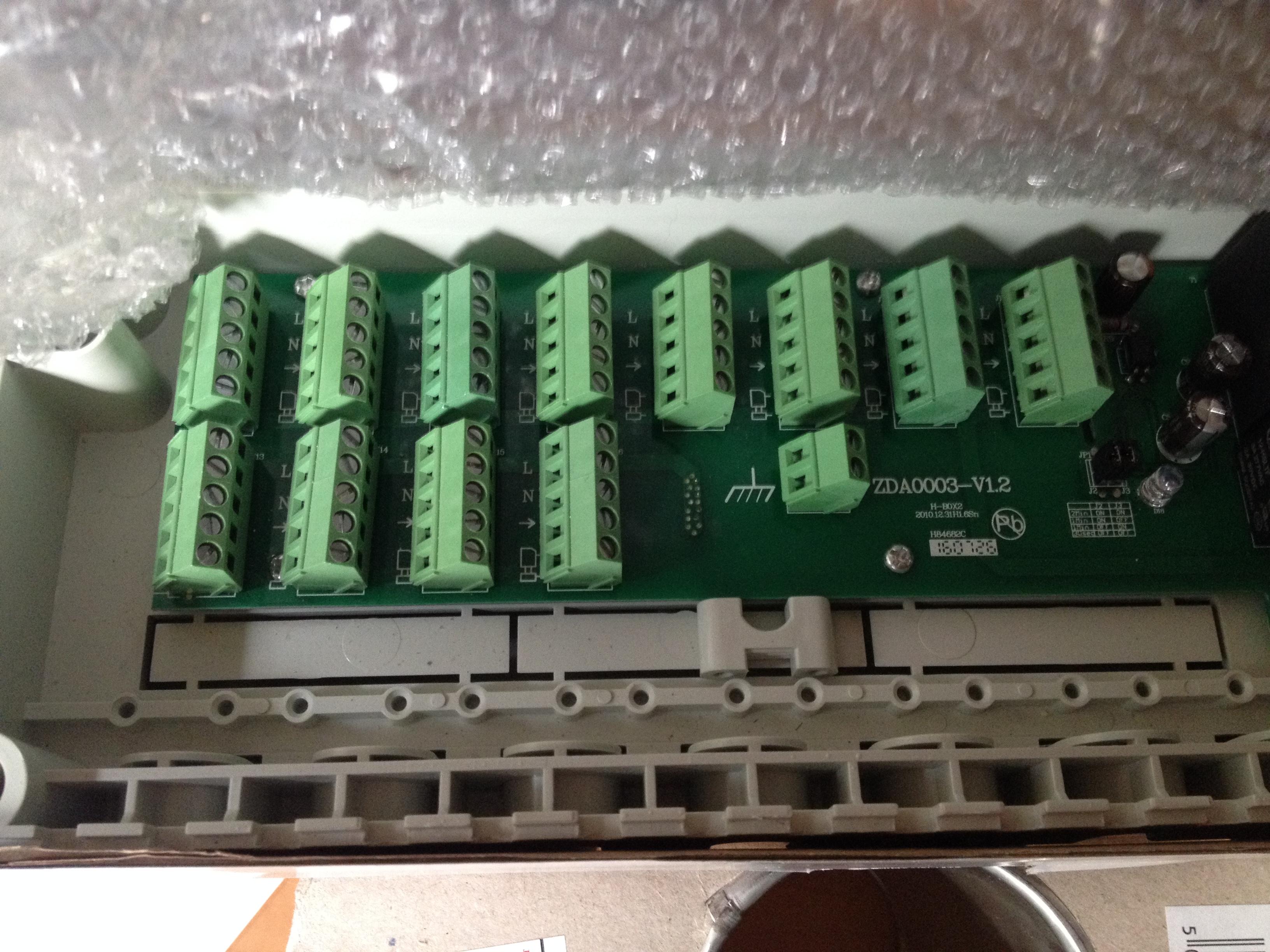

Can someone tell me if I've ended up getting the wrong cable? I went and bought 6243Y 3X1+1 1mm from TLC: https://www.tlc-direct.co.uk/Products/CA1slash3G.html But it seems overkill to me (bearing I am no electrician) for what is only linking the thermostats to the ufh control board. Even the cable clamps in the wiring centre won't be able to clamp that cable down: Did I get the wrong stuff? Surely this would suffice? https://www.tlc-direct.co.uk/Products/CA0dot75HR4.html If not, it'll be a bugger to get the wiring centre all connected (leaving that for electrician):
Thanks @JSHarris. Pics always help. And that wiring info will help my electrician no doubt as no-one seems to understand these black magic heating systems. Just looking to get my floor tiles down before I move my 2x200kg units into place without cracking the floor!
