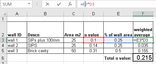

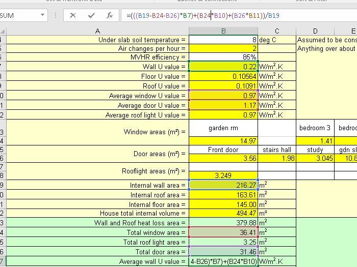

Thanks. Yes, i have lots of S facing glazed walls which will help a bit in the winter but potentially overheat the place in summer (although the sun is already nice and high now to reduce that by quite a bit). Cell34? I can see that B27 incorporates window and door areas values, but I don't see anywhere in there that you can list all of your different walls with respective u-values: So you have to work out your average wall area first and enter that in B7: -
Right, so I've started playing with Jeremy's heat loss spreadsheet and have started going over my figures to see if I have screwed up somewhere big time, as my heat loss seems a bit high. So, I have a number of different walls of differing u-values (column D) with respective % of total wall area (E). I have then mutliplied each u-value with that % (F) and then totalled the figures in F to get a final u-value. Is that an accurate method of dealing with differing u-values? TIA!

Thanks @PeterW, @Alphonsox Updated the s/s. 6.8KW/h so 163KW/h per day!!? Time to re-check my calcs! Biggest issue is the ventilation loss. Anyone been successful recently in finding the localised temperatures recently from the metoffice site? Had a look yesterday but could not find them, so just kept Jeremy's figures in there. Not that my local figures are going to reduce my space heating demand significantly!!- 204 replies

@JSHarris Just resurrecting this thread as I'm finally biting the bullet and have downloaded your heat loss spreadsheet from your site. I know that's what you say, but do you have a dummies guide in completing it?? I've got most of my measurements and figures to hand so have had a go and completing the s/s, but have a couple of questions: 1) Should B23 be referencing B21 also? i.e. =SUM(B19:B21)? Or is floor area heat loss incorporated elsewhere? 2) "Fabric & Ventilation loss" sheet has Internal wall area on row 19. Presume this is essentially all perimeter walls including windows /door areas? 3) Lastly, looking at the table 'Heat loss vs OAT' gives me heat loss at various temps. So where there is a difference of 20 degrees, I get a 'Total heat loss power (W)' of 6809 (don't choke there!!). So essentially that is my heat demand for space heating? I've set current ACH to 5.0 (this is a retrofit after all) but hoping I can achieve a better figure than that as I continue to methodically seal areas as best I can! TIA!- 204 replies
