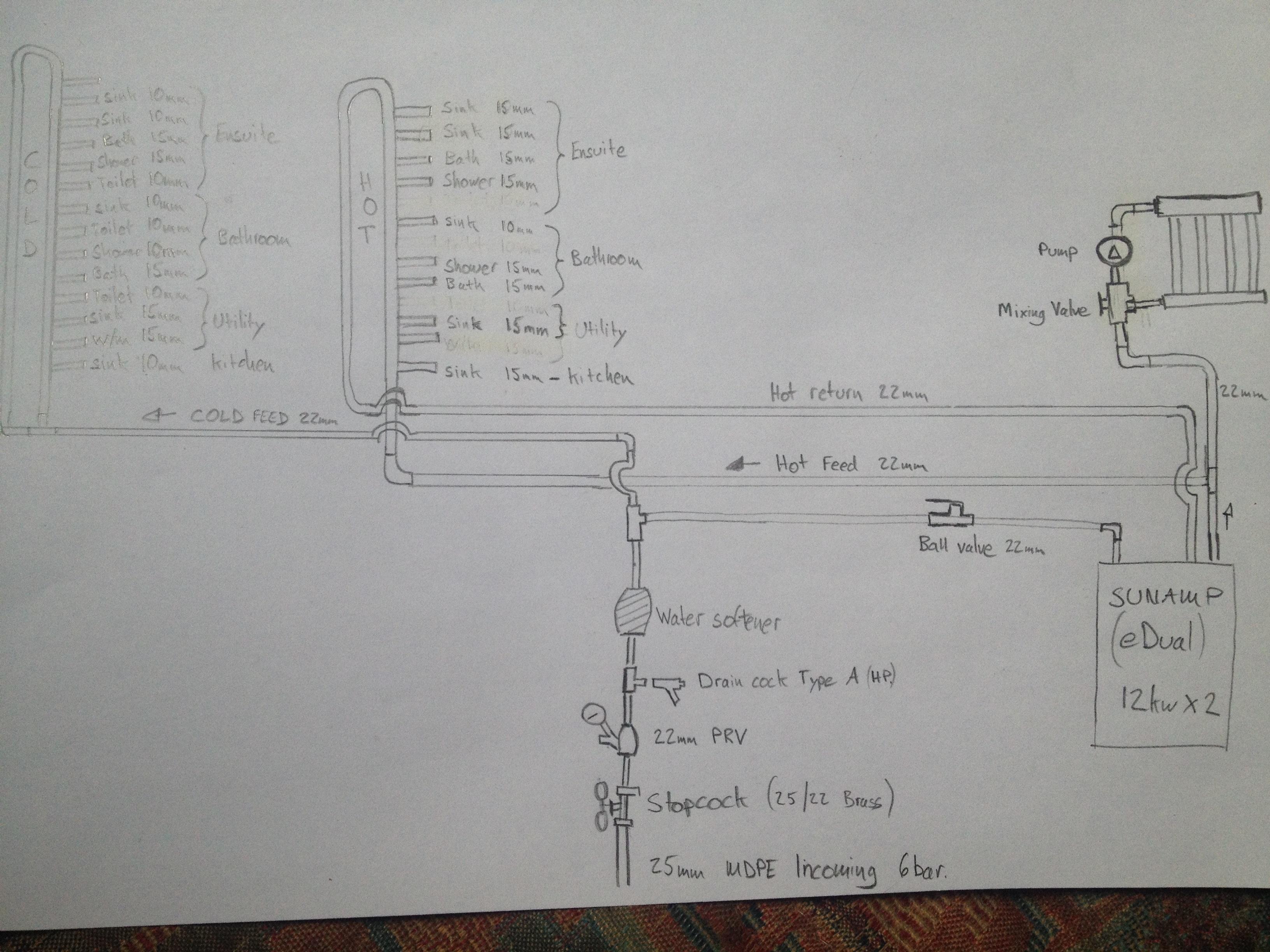

  14. Would be okay if it was just one I needed. 3x 4-ports, and 1x 2-port! But seeing I need to do the HRC in brass anyway, it makes sense to do it all in brass. At least I only paid £64 for 100m of 10mm Hep2o pipe.
  15. Let's not sink to these new low-levels of humour shall we?? So now I see that there's not a 4 port 15mm manifold - great. The setup was to be in a fairly confined space as it is and having 2x 2ports in place of a 4 port manifold is going to take up space with additional connectors. I could get use the brass manifold type instead, but the prices put me off (£43!!!), but the advantage they have is that they look better (although no one's going to see it!) and they have the inbuilt valves which I would also have to add to a full plastic setup. Are there any other advantages going for a brass manifold setup??? Any cheaper sources for the brass buggers? https://www.jtmplumbing.co.uk/pipe-fittings-c433/hep-o-brass-manifold-and-fittings-c661/hep2o-four-port-valved-manifold-15-tm-tf-fp-p21691
  16. That's terrible! Really don't see why you had to pipe up this time of night.
  17. Thanks @PeterW That is a good price with free del over £50. I best start looking at what bits I need for a manifold etc! For anyone in Herts: https://hertsplumbingsupplies.co.uk/pushfit-plumbing/55-15mm-x-25m-hep2o-barrier-pipe-coil-hxx2515w.html£33inc. Delivery makes it more expensive than JTM though, so unless you can collect...
  18. @Nickfromwales - I will thank you NOW Nick - your input is always appreciated. Have any forumites bought any Hep2o recently? As I'm not using this for heating, I presume I may as well just go for the standard Hep20 rather than the barrier type pipe? Any good online merchants for Hep2o? Wickes appear competitive at £40 for 15mm 25m barrier pipe using the 10% discount offer. Looks like their are better prices on barrier than std.
  19. @Nickfromwales Thanks again! wadevayalikefromthere - does that come in 22mm? Will ask in Toolstation tomorrow. Oh, okay. That makes it simples then. I like simples. Just retain the hot return from the hot, manifold, correct? Just retain the hot return from the hot manifold, correct?
  20. Oh, okay. That makes it simples then. I like simples. Just retain the hot return from the hot, manifold, correct? Cos I got over 6bar innit. I have a private water setup from the neighbouring landowner and there could be a potential for the pressure to increase when they aren't using water, so I thought it be best to have a pressure reducer/limiter. Not read the sunamp material yet, but I guess that may need protection. Also, water softener may need pressure limited too? The PredV is fitted already. Oh yes, do I need a non-return valve anywhere?

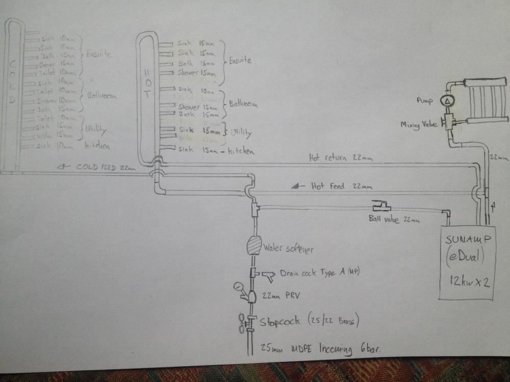

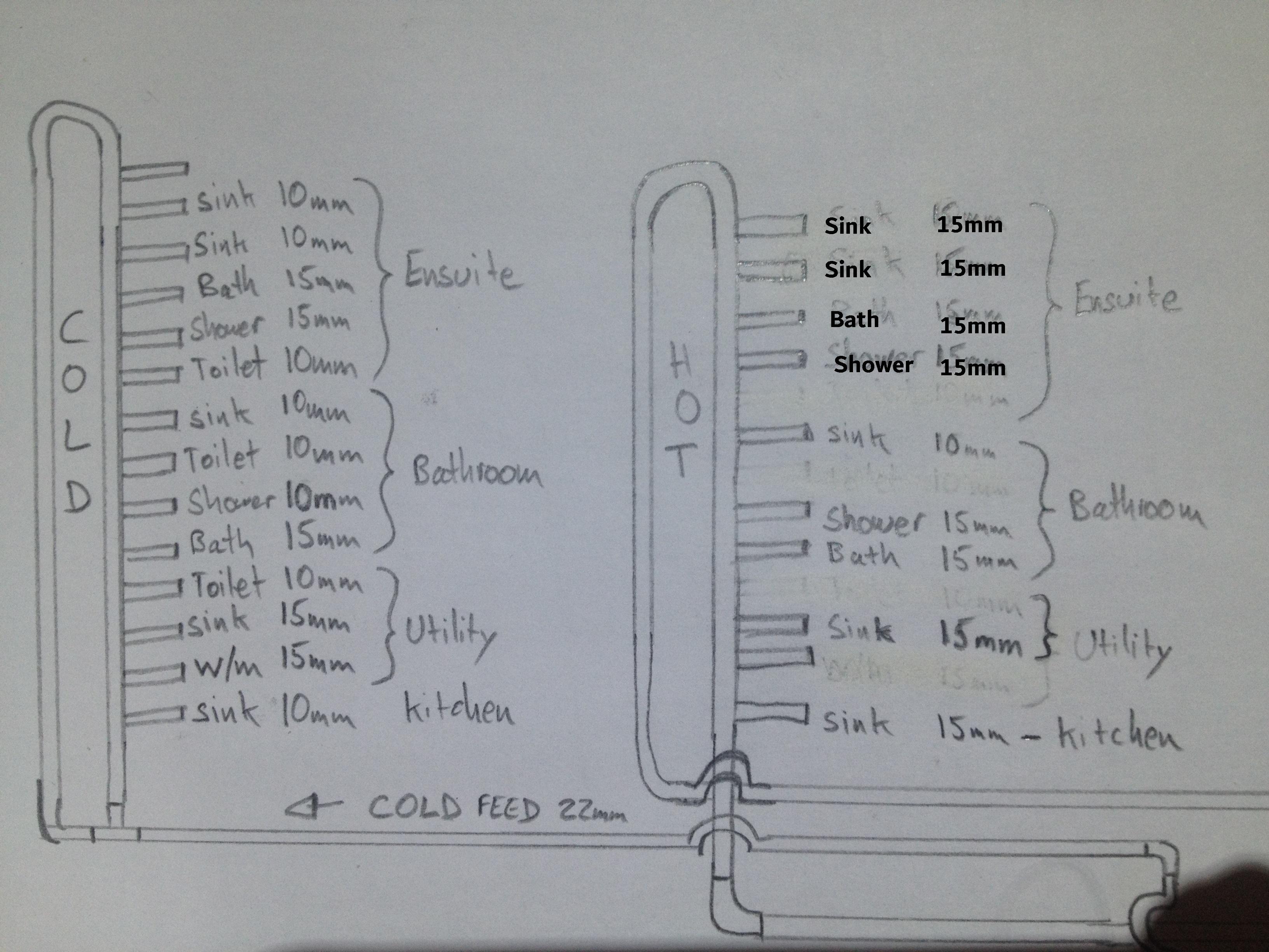

  21. Thanks @Nickfromwales. Yes, I was thinking of having a timer of some description for the HRC to the hot manifold. I've added pipe sizing to each outlet now on my crappy sketch below (Visio pi55ing me off!) and think that tallies up with what you recommended. Ignore the pipework between the UFH manifold and the Sunamps - I haven't looked at the SA instructions yet and will most likely get a plumber to assist me with that side of things. I have added a water softener as it's all 'well 'ard' down this way, innit. Not sure what system to go for, but I have seen a thread about that elsewhere on BH to read up on. 1) I also have a feeling that I need a non-return valve somewhere - between the stopcock and PRV? 2) As for the actual pipe, as I'm not using this for heating, I presume I may as well just go for the standard Hep20 rather than the barrier type pipe? Any good online merchants for Hep2o? Wickes appear competitive at £40 for 15mm 25m barrier pipe using the 10% discount offer. Looks like their are better prices on barrier than std.
  22. @Nickfromwales - Thanks for the info Nick! I have some comments below and some qs also! Yes 2x eDual units. Floors fully insulated, will have EWI and plenty of loft roll/PIR in every crevice I can force it. 3G windows. Hopefully better than a tent (at least the weight of the Sunamps will stop the tent from flying away!) Don't go down that path!! Concrete floor is all UFH and I don't want to be digging any of that out again! So my only choice is that long run. But I will be having that Quooker type tap in the kitchen so the hot tap will barely see use. But I'll go for the 10mm runs for hot and cold then for the kitchen then and all other sinks/basins - also for toilets I guess? With regards to the HRC - is that really needed between the sunamps and the manifolds? The distance would only be around 3m, but I guess if that is to be 22mm, then there is extra volume involved.
