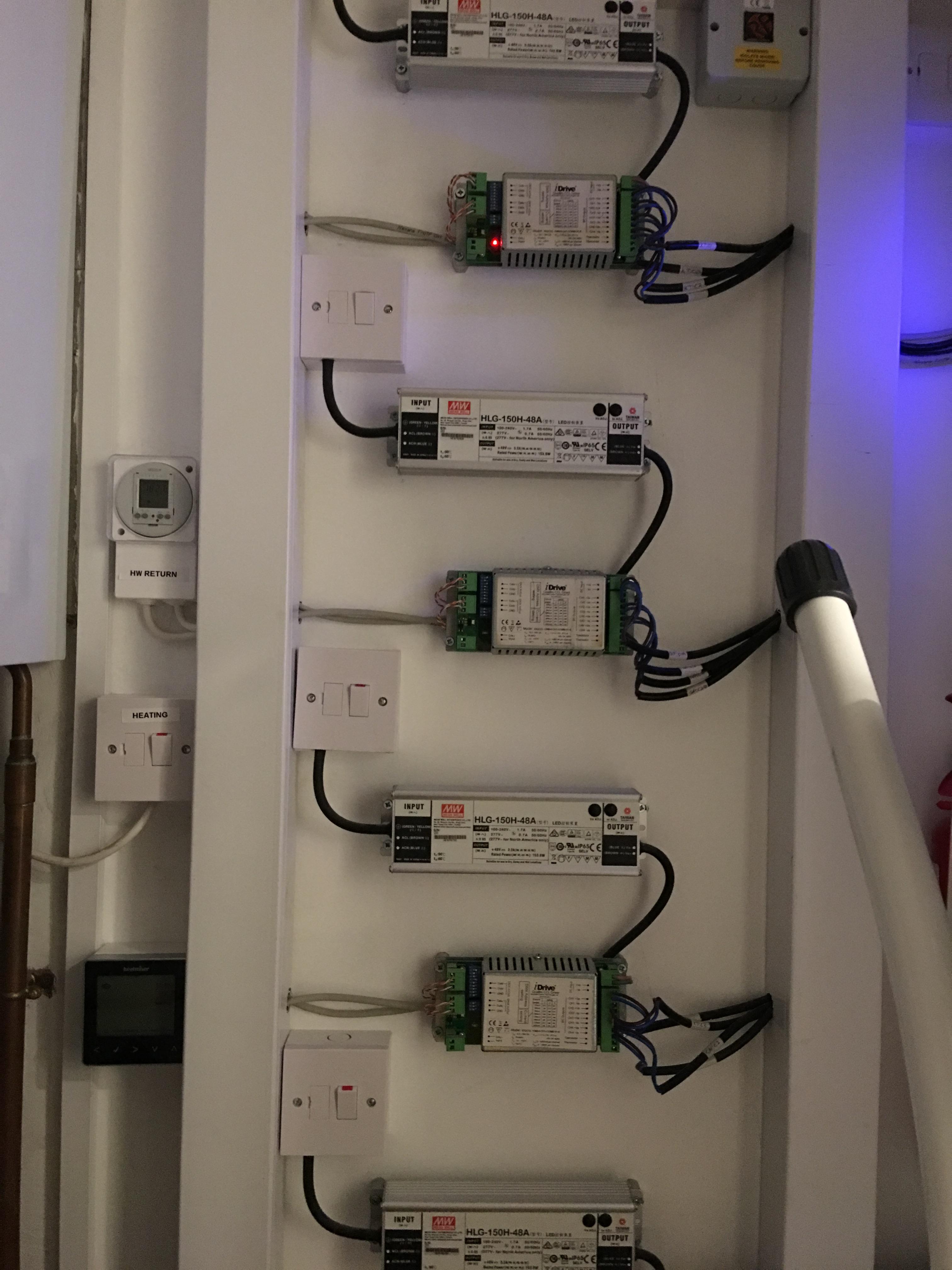

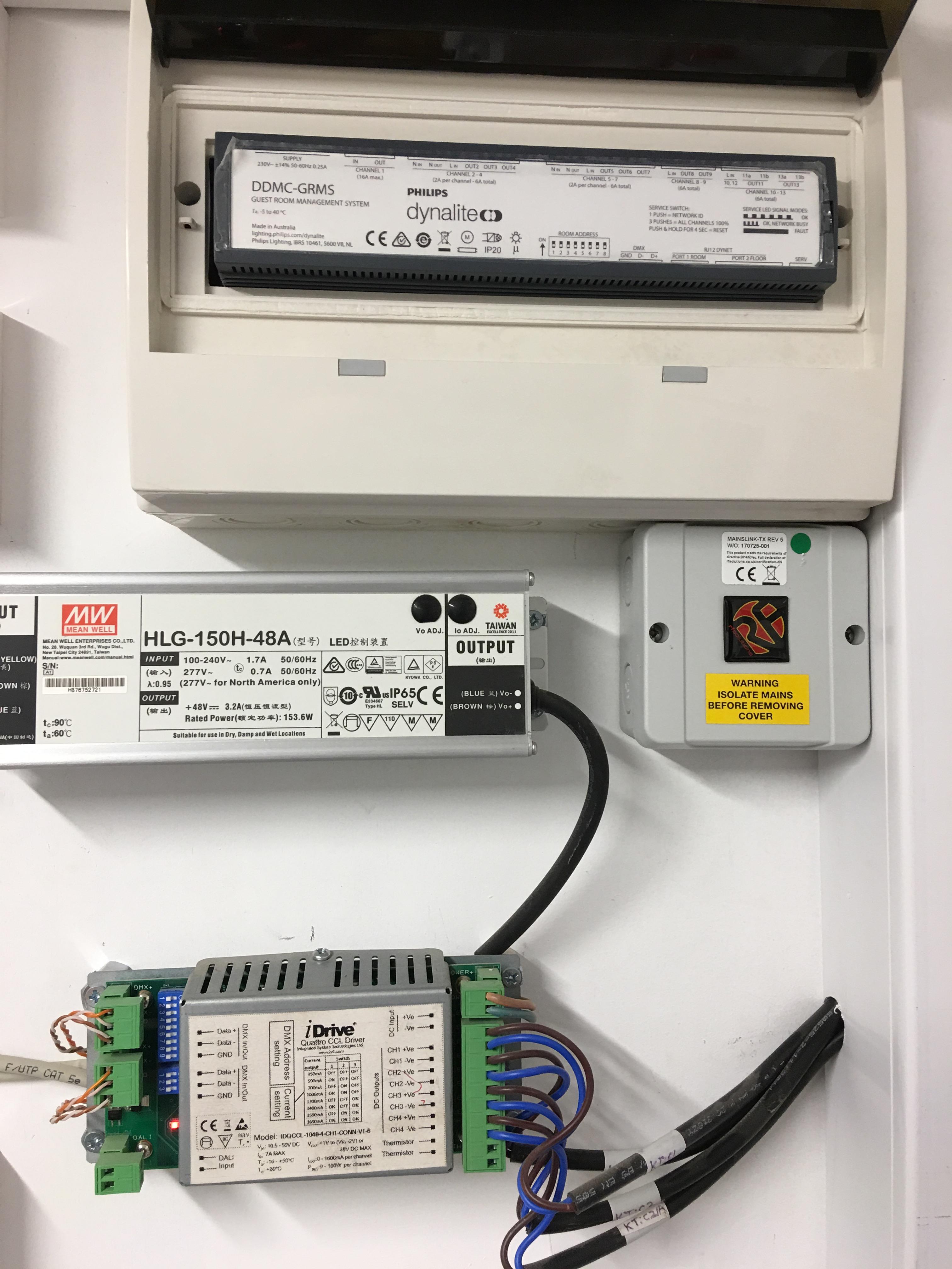

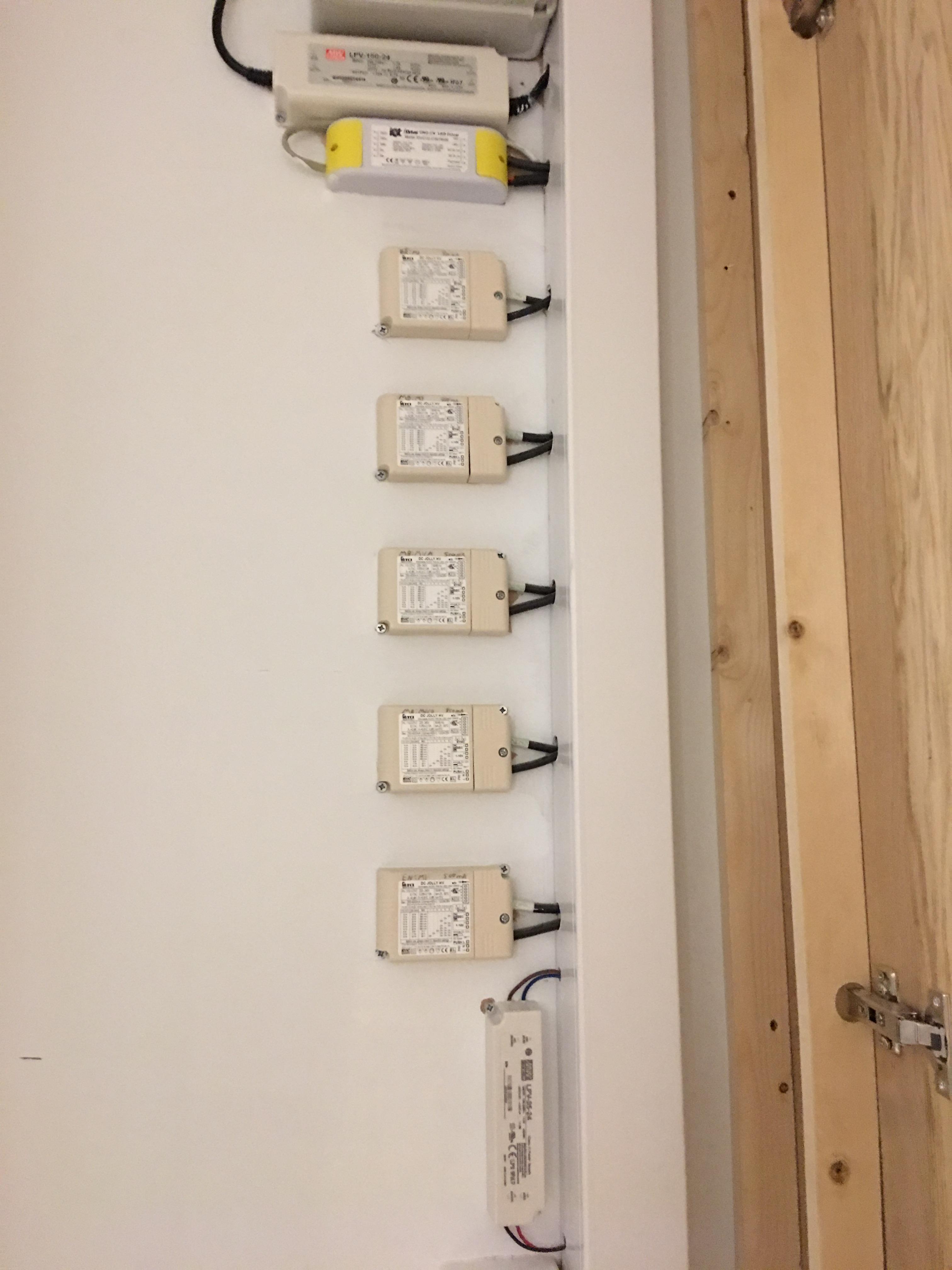

@Ed Davies think you have understood set up properly thats what is is. Closer pic...plus pic of conventional installation for non automated install in bedrooms which I think may be more the type if thing @JSHarris is mentioning.
@JSHarris yes its all safe, certified and compliant. Its a professional installation not only certified by installing electrician and inspected by building control for sign off but in addition installer had his annual professional competence check inspection here. May be not a good photo for detail.

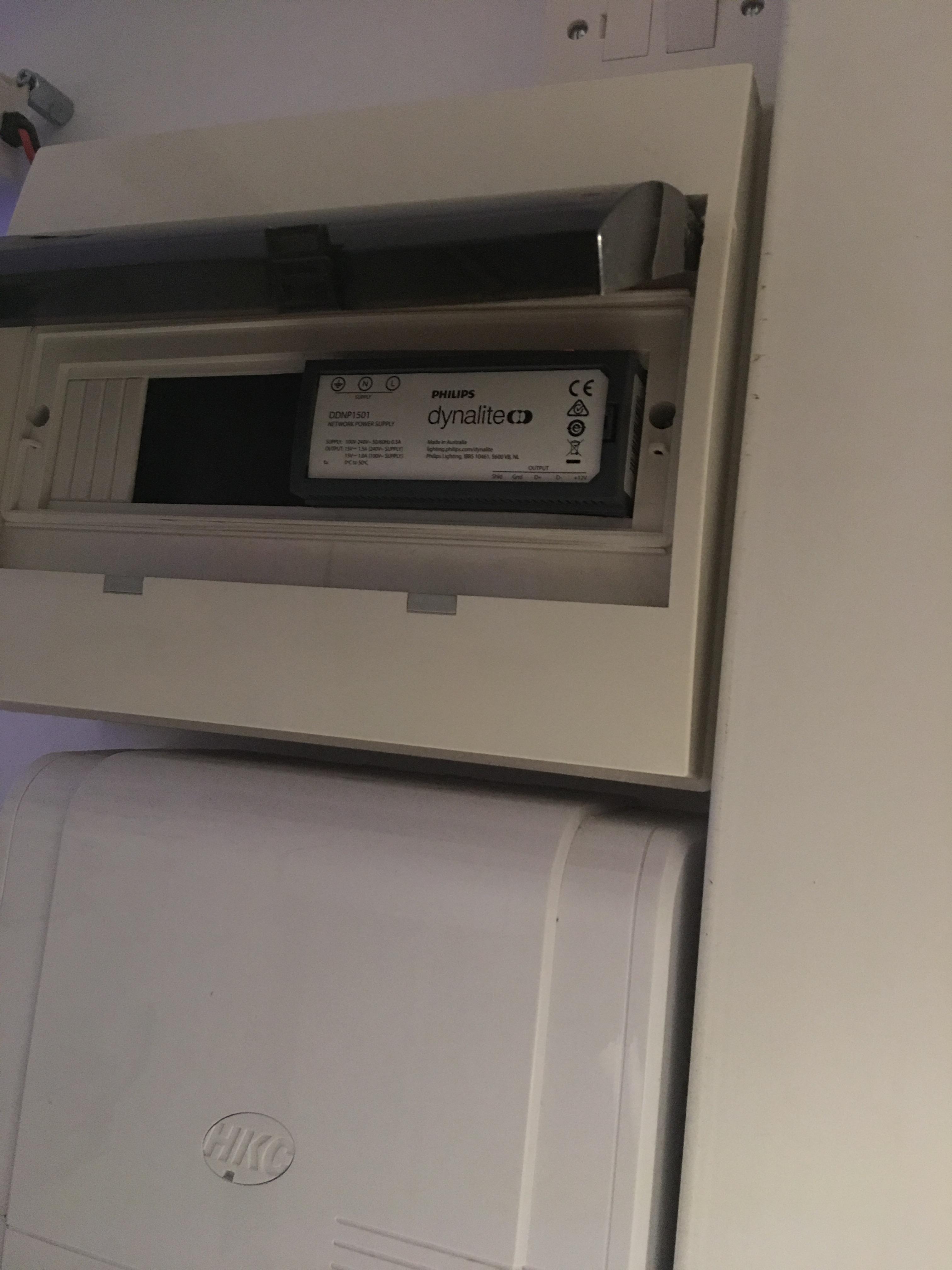

That is nothing remotely like mine! It could be that because I have no ceiling void (single storey) that mine is different. I have all led a mix of wall lights ceiling downlights, floor uplights, pendants and led tape. I also have a 5 amp circuit for lamps. All run by dynalite system. Have wall switches and app control. Have also some lights on pir sensors not on automated system. On outside lighting have it on auto as well as pir so if its off on auto it will come on if sensor activated. This is mine in the plant room.
