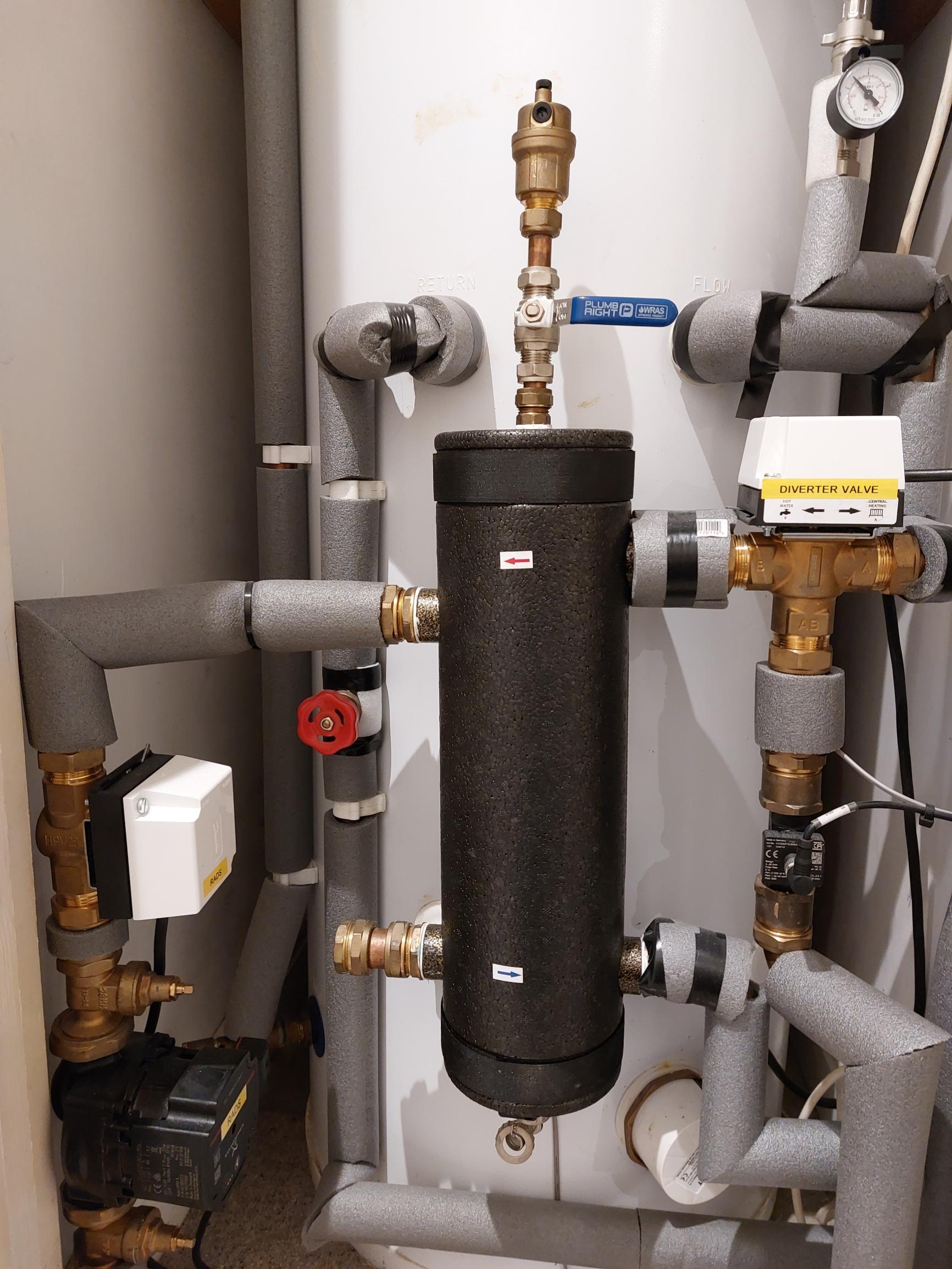

Change Two Pump+LLH to One Pump/No LLH
PhilT replied to PhilT's topic in Air Source Heat Pumps (ASHP)
fortunately just one zone for the whole house, well balanced with all rads open -
After installation the 3 port valve leaked flow to the rads during DHW cycle, in the height of summer - not ideal. For reasons best known to them, the installers put in that 2 port valve, which had the desired effect of completely stopping the leaked flow to the rads. -
I've read a lot of good advice and observations about optimising efficiency by avoiding any kind of buffering/second pump setup. Currently my ASHP (which has no inbuilt pump) feeds a primary circuit, a 26 metres long loop of 22mm copper pipe, using a Grundfos UPS2 25-80 180, partially looping back through a small LLH. The secondary circuit tapped from the LLH is 8mm microbore feeding 16 oversized rads on two floors, area c. 130sqm, fed by a Grundfos UPS3 15-50/65 130. Interestingly the return from the rads/microbore does not loop back to the LLH but instead connects directly to the primary loop flowing back to the ASHP. Reading the specs I notice both of these are substantial pumps. Would the primary one be man enough on its own? Could the LLH and 2nd pump be taken out, connecting the "primary" circuit directly to the "secondary", and what would be the issues?
