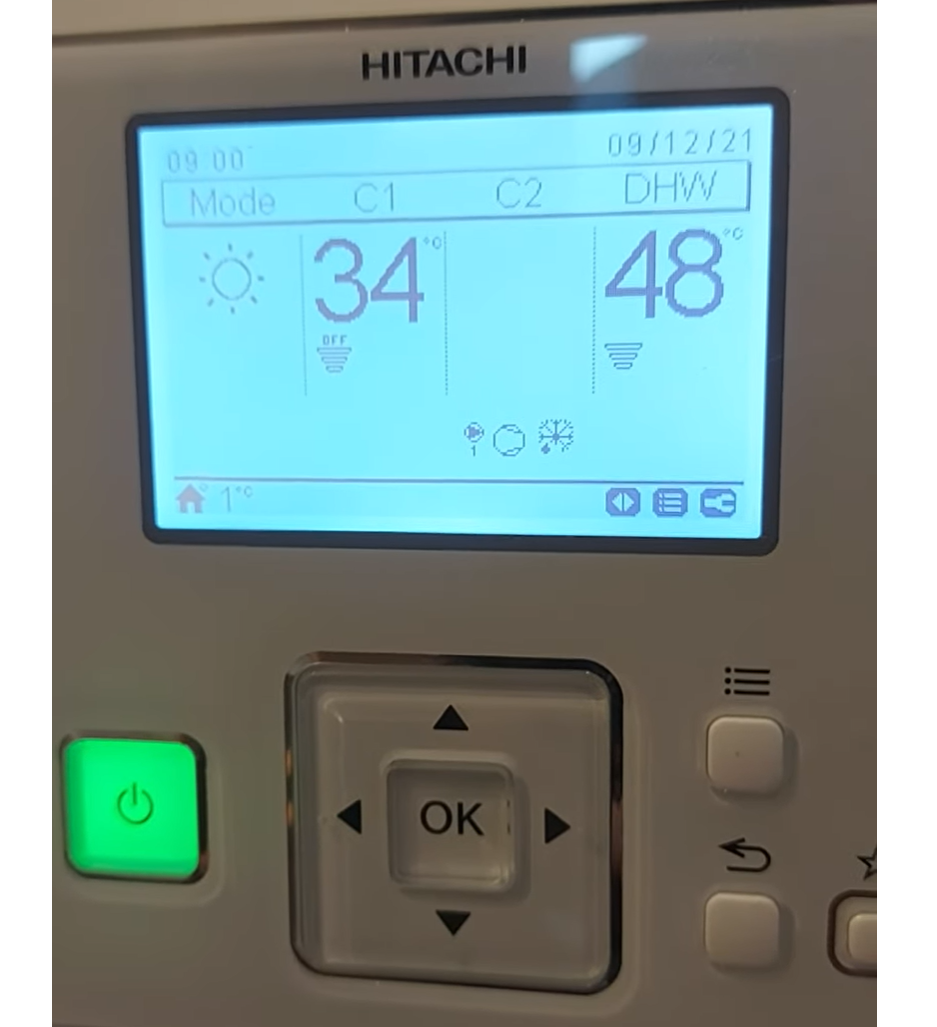

  3. All the Youtube videos I can find about the Hitachi Yutaki show this control interface, featuring a big green button which is used to switch the heating or DHW on/off. Yours looks quite different but you should be able to switch your heating ON by simply pressing your on/off button while your screen is highlighting circuit one (47) (third screen above).
