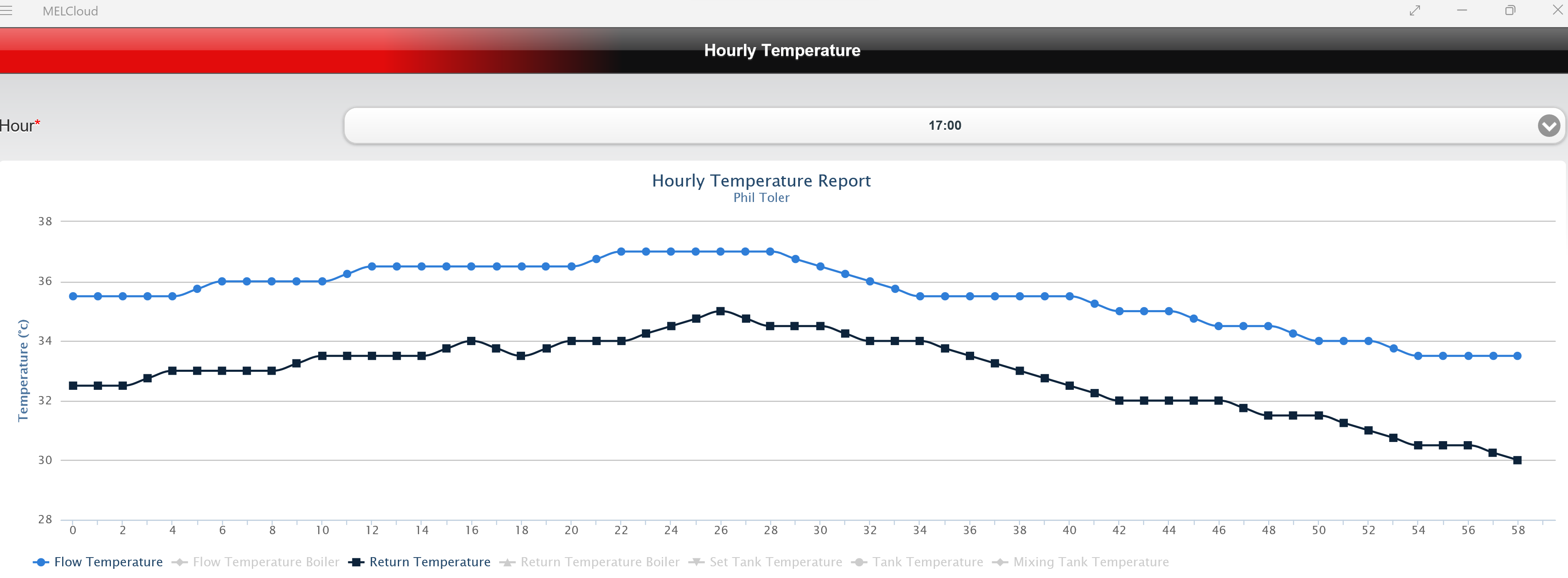

Do you have a radiator circuit? My max is set to 50degC flow temp at -3degC outside temp, minimum 35degC flow temp at 15degC outside temp. BUT - If you plan on switching to Auto mode this range is not critical, because the max flow temp is governed by the room temp - mine rarely goes above 40 and from what you said I don't think yours will either. At time of writing here it's 11degC outside and the flow temp is 33degC. As you can see from the chart below this is how Auto mode reacts as room temp is reached. Domestic hot water temp is down to personal choice, no. of inhabitants, size of tank, lifestyle etc. Mine is set to 42degC and I never run the legionella cycle. -

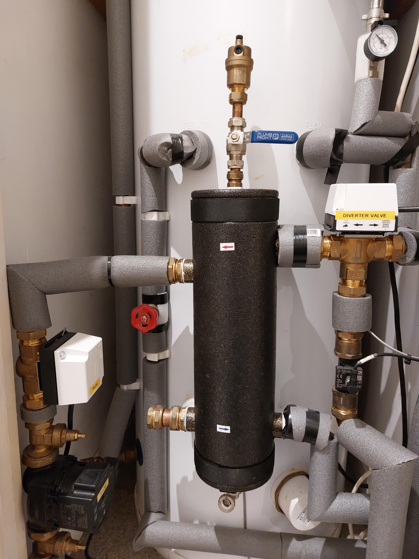

Sounds like you either need stronger pump(s) or the settings need adjusting to allow higher flow rates from the existing pumps. Also someone I know with a similar setup to mine (two pumps) had three pumps installed (one primary, two secondaries) -
Radiators not reaching flow temperature
PhilT replied to Helene's topic in Air Source Heat Pumps (ASHP)
SimonD suggested a 40l/min flow rate, so 33l/min, although very high compared to mine, may not be enough to shove water all the way around your big house and up into your loft K3! Do you have one or two flow pumps? if you have only one either it's not man enough or it is not set to a high enough speed. If you have two, check the other (secondary flow to rads) pump and increase its speed or, if not already, try setting to maximum speed. This should be quite easy as long as you can get access to both. Usually they have 3 speeds which can be adjusted via a dial or a button which selects 1, 2 or 3 lit LED's. You should be able to hear the speed increase. -
I'm wondering if this (see photo) gets you the best of both worlds. The LLH (vertical black cylinder - capacity c. 2 litres) is connected such that only the primary flow (right top/bottom) can loop back around into the primary circuit. The LLH secondary return (bottom left is sealed off, instead rejoining the primary circuit return from the LLH further back downstream to the heat pump, thus eliminating any mixing of secondary return with primary feed.
