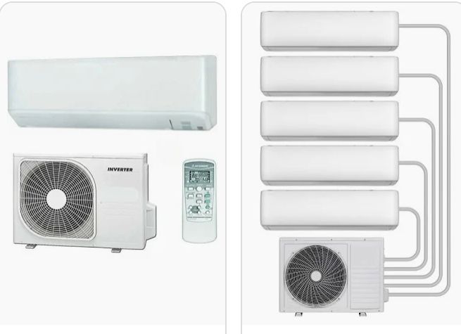

It's either one mini-split per room (1st photo), each room having an indoor blower and an outdoor heat pump/air con, or (2nd photo) one central heat pump/air con unit feeding however many indoor blowers for all the rooms you need heating. The first option involves an external unit hanging off the outside wall of every room - very unsightly, as well as being more challenging to install and maintain the upstairs units. The second option is neater but involves pipework installation around the house, and then you still need the DHW tank system in addition, so I would be surprised if a 9 room commercial installation is cheaper than a full hydronic system (net of grant) which, if well designed and installed, could be 30-50% more efficient. It's certainly worth a sustained research effort to get as many quotes and as much info as possible. The major energy suppliers such as Octopus are offering very competitive prices for hydronic systems, but their lead time can be very long and their offerings may not be available in certain areas.
Difficult to say without knowing more about your situation. Will you be doing this yourself or are you talking about getting quotes for full installation options? If the latter, I was quoted £1500 for a 3kW split heat pump/air con for one room. Probably not the best quote but it gives you an idea. Do you have a max budget in mind? What age, size and type of property is this, number of rooms, floor area etc?
Yes the number of new houses that have been built is so huge, it all acts like a gigantic storage radiator
Do you know how much gas you used last Dec? That will give you a broad sense check. This Dec is very similar re temperature and weather conditions, in my area at least.
What did you have in mind, individual split units for each room, or a central unit with a fan in each room? Both can also do air con. Do you know neither of these qualify for any grant? The BUS £7500 is only available for "hydronic" systems. Have you done any costings? By the time you have added up the capital and installation cost of an air to air system I wouldn't be surprised if it costs more than a full hydronic system net of grant.
