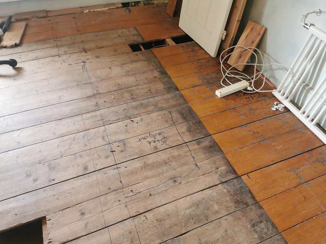

Hi all. As part of my ongoing project of renovating an old farmhouse I'm just about to add an ensuite bathroom to a decent sized bedroom. The current floor has floorboards. I dont want the boards continuing under the stud wall I will be building and want a good base to potentially tile onto. Last time I did an upstairs bathroom I used 18mm T&G ply but I think this is now frowned upon. Whats the recommended materials for this sort of work now? We have not yet made a decision of floor covering but dont want to rule out tiles. Picture of the floor boards in which hopefully you can make the lines were I'm intending to build the stud wall Thanks
