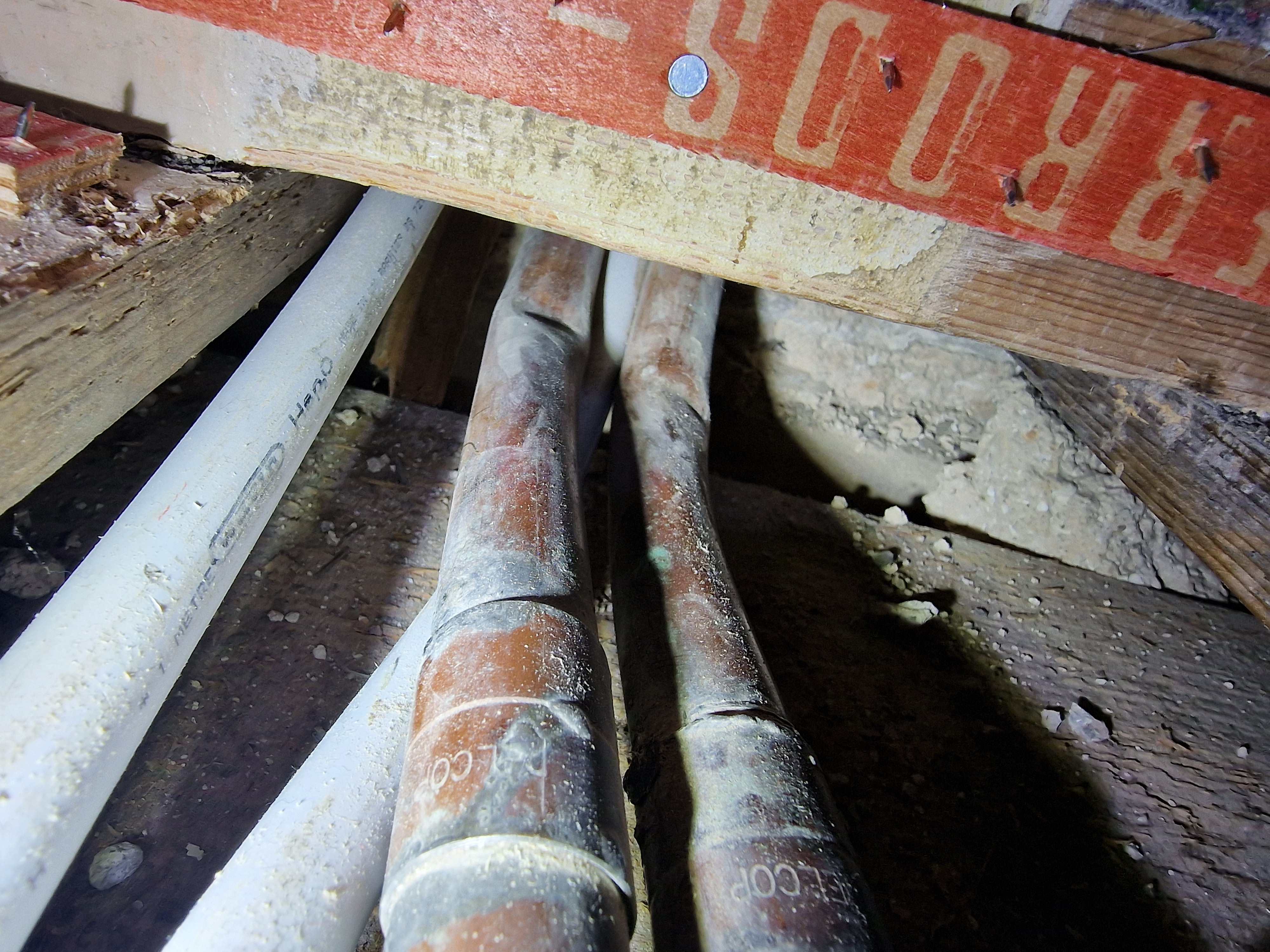

"Or too high a pump speed for the system " Not something I can adjust as far as I know. Its all under the control of the Vaillant Arotherm ASHP -

Yes they were paid to do a brand new install. Those pipes are remnants from a heating system that was put in and removed back in the 70s. I knew they had used these short sections at the time but I was not aware of the kinks in the pipes. I dont think they will make any fuss about coming back to sort this out as they seem a decent outfit. -
Our ASHP system has been in just under a year. When running the first couple of rads are noisy. I was resigned to this as there's no obvious fault but that changed today. Doing some work under the floors and noticed these creased pipes. They reused some ancient pipes they found which got around some awkward steps but it looks like these old pipes were badly creased whenever they were put in. These creases are just after the noisy rads. My thinking is the restrictions are forcing most of the water through the rads which are prior to the damage and the high flow rates are making the radiators noisy. Is this the likely cause or am I reading too much into this?

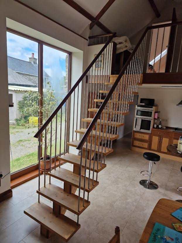

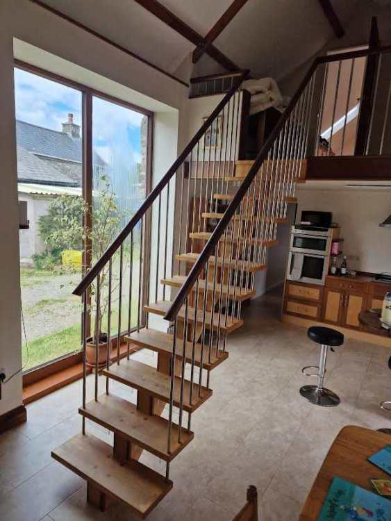

I'm no structural engineer but it looks fine to me. Taking that much out of the middle of the stringer would be a different matter As it's turned into share a picture of your home made stairs these are mine and are made of maple and cherry built around a central steel box

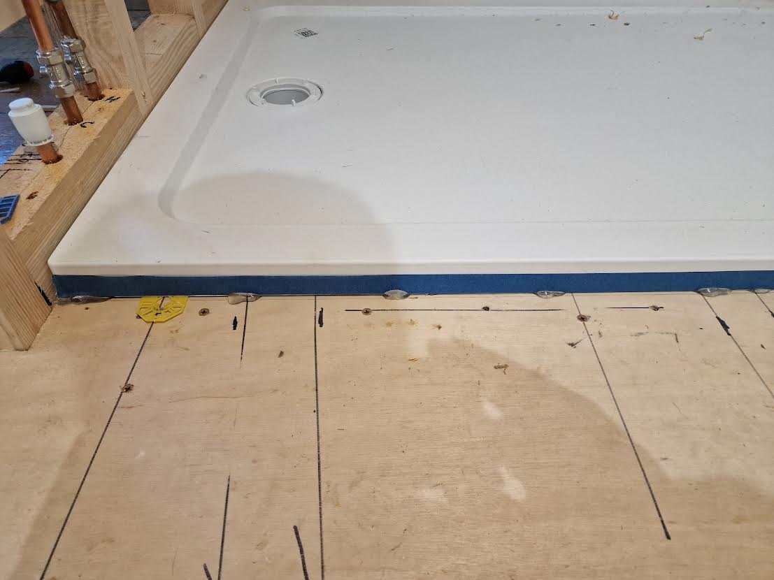

I've just laid a Mira Flight tray with some OB1 and needed a 2mm packer under one corner. I went for blobs at the the nodes and all around the edge to make sure the OB1 was thick enough to bridge any gaps. On ours the edge protrudes down around 2mm-3mm more than the rest of the tray so if going for a continuous bead you will need a lot CT1/OB1. I went through 2 tubes with just a 2mm packer and blobs. -

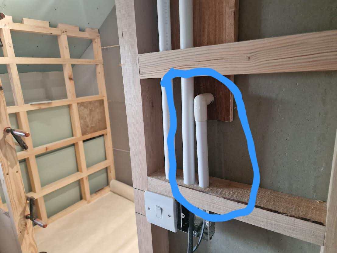

Some more options on fixed angles would be nice but as was pointed out I could of used some of the other angles available in the brown 110mm. I think in this case the problem is me being an amateur. A pro would have know what components were available. I have now found an ideal coupler to solve my problem. Also I have chosen not to use variable angle systems when they are probably fine so my cautiousness has hindered progress I'm going to have this on the back of the pan and then a 45 degree onto the 110mm waste. https://www.monsterplumb.co.uk/mcalpine-wc-con7-14-degree-angle-rigid-pan-connector-110mm?utm_source=google&utm_medium=cpc&utm_campaign=22385443807&utm_term=&gad_source=1&gad_campaignid=22375516008&gbraid=0AAAAADRbF0WMYsYZoKrYUagiN7GtkSFsm&gclid=Cj0KCQjwu7TCBhCYARIsAM_S3NgL8Y7mX1v5wu0edW-hPP_yfKCogYm_unyvPoeFMxfveUBoTGU-n0EaAum2EALw_wcB
