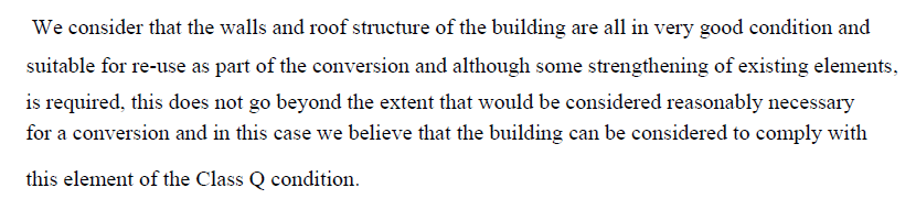

But, particularly for the SE, first it was the report where they said to planning that the barn was convertible.

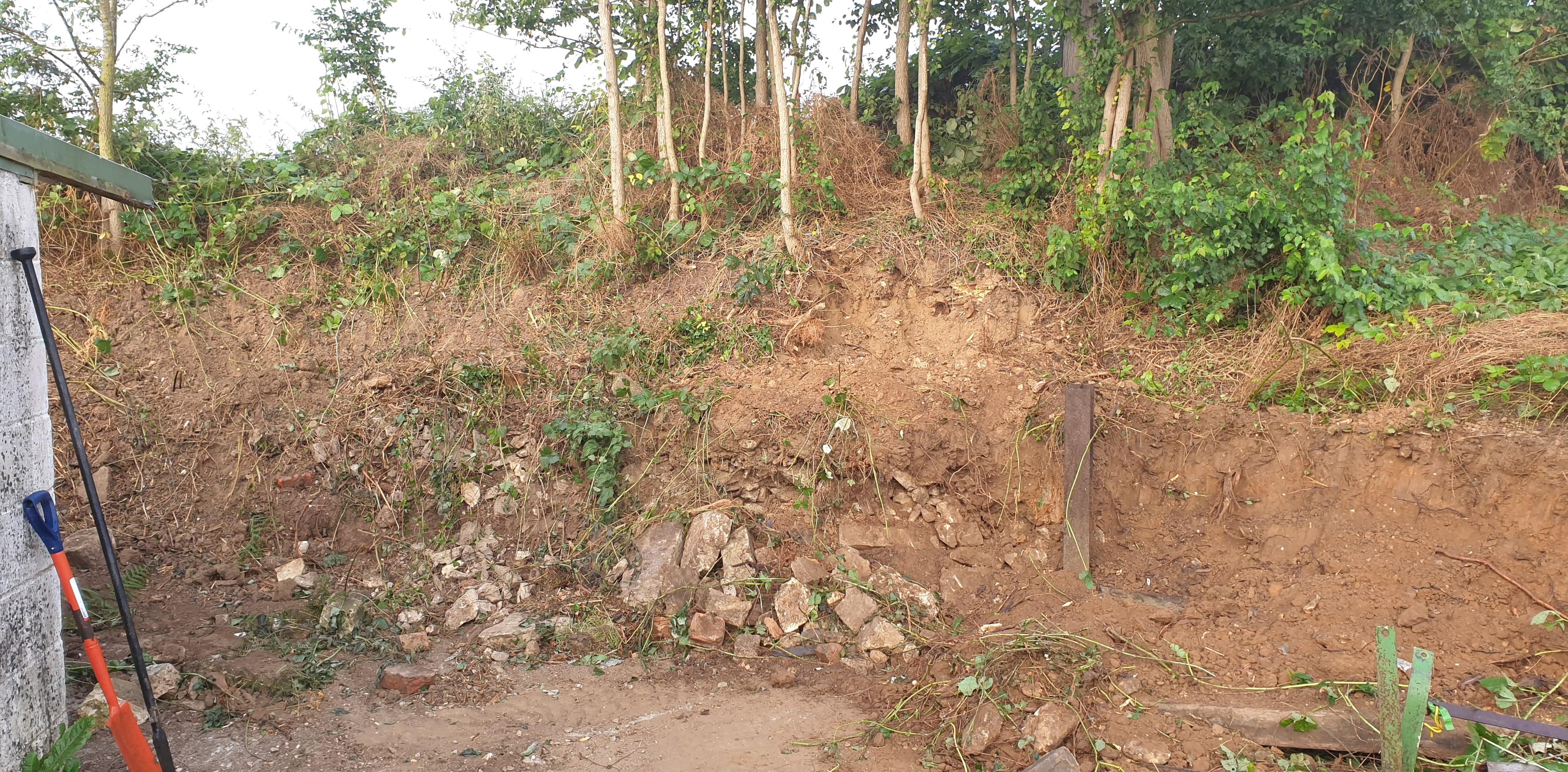

Then we started preparing the site, documented in previous blogs, we did this thinking that it would benefit us with the SE report to get the building regulations drawn.
How wrong we were.

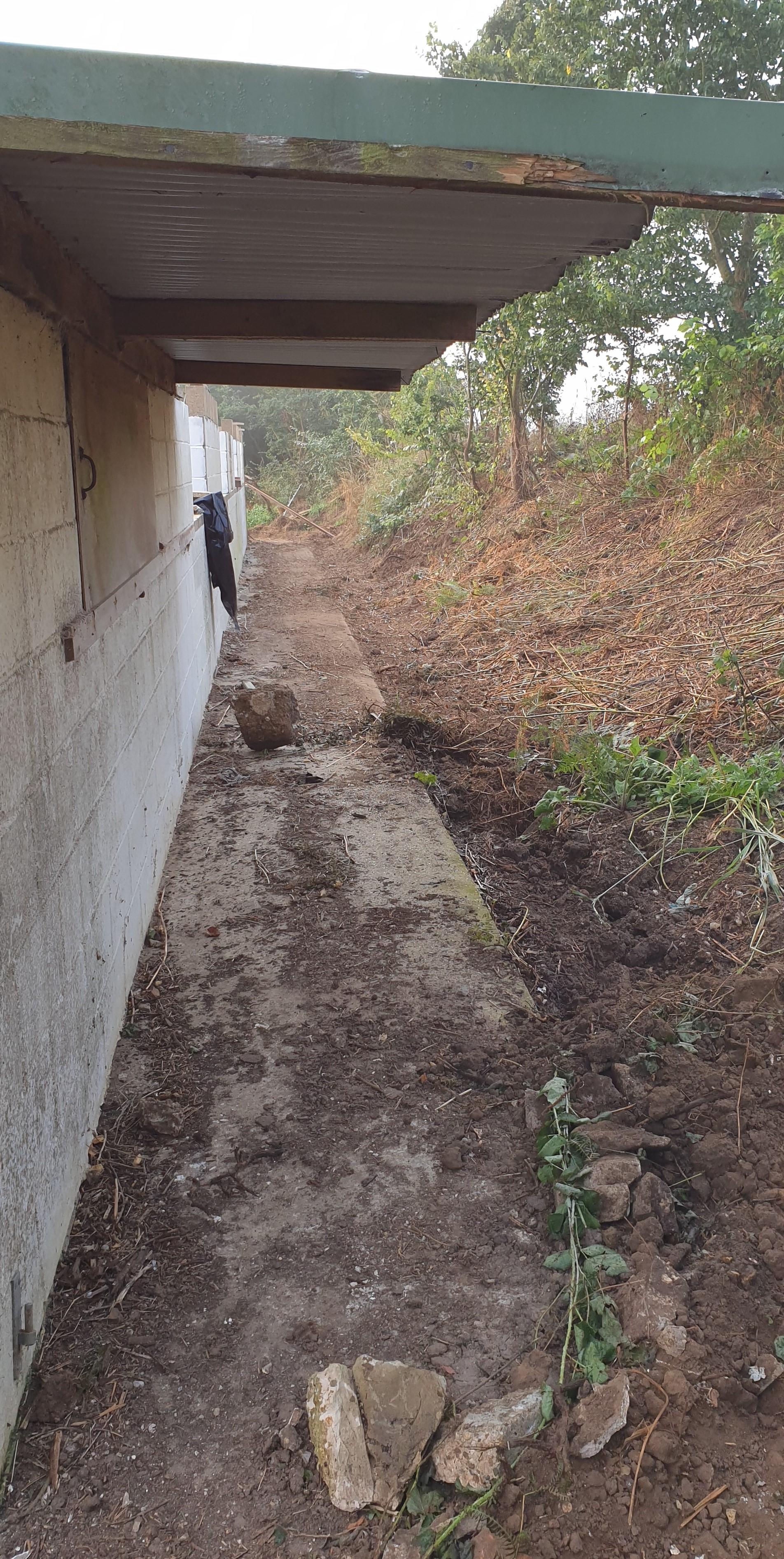

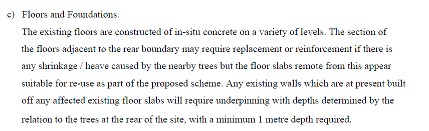

One of the limitations of the barn conversion was that one side of the building can only be 2.2m high.  We worked around this by designing rooms so it wasn't needed for walking.
Yesterday, I received the report, only to be horrified to see that this low side of the building, 2.2m remember, needs underpinning foundations of 'at least' 2.4m.  How can a single storey build possibly need foundations deeper that the height of the building.
The opposite side is 3.15m high to the roof, here the SE say we only need 1m deep foundations, figure that out.

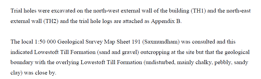

The soil is not clay, not sand, there are a few 3" elm trees that are being knocked down so no large roots.
But, it gets worse,  they say that this must be done 1m at a time, doing 1st meter, then 3rd meter, then 5th meter, then 2nd meter etc.etc.
This particular wall is 25m long.
They have no issues with the existing internal walls.

The most disappointment I feel is that the SE passed the building as fit to convert, including digging holes to look at the existing foundations with no mention of anything like this.

The one thing that we cannot do is dig down 600mm x 2.4m a meter at a time.  Maybe a groundworks company could, but at what cost for what, in reality, is a tatty barn which, if we could have got planning we would gladly have knocked down and crushed.

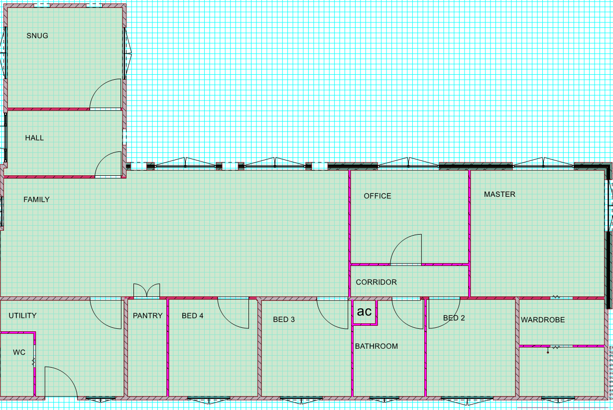

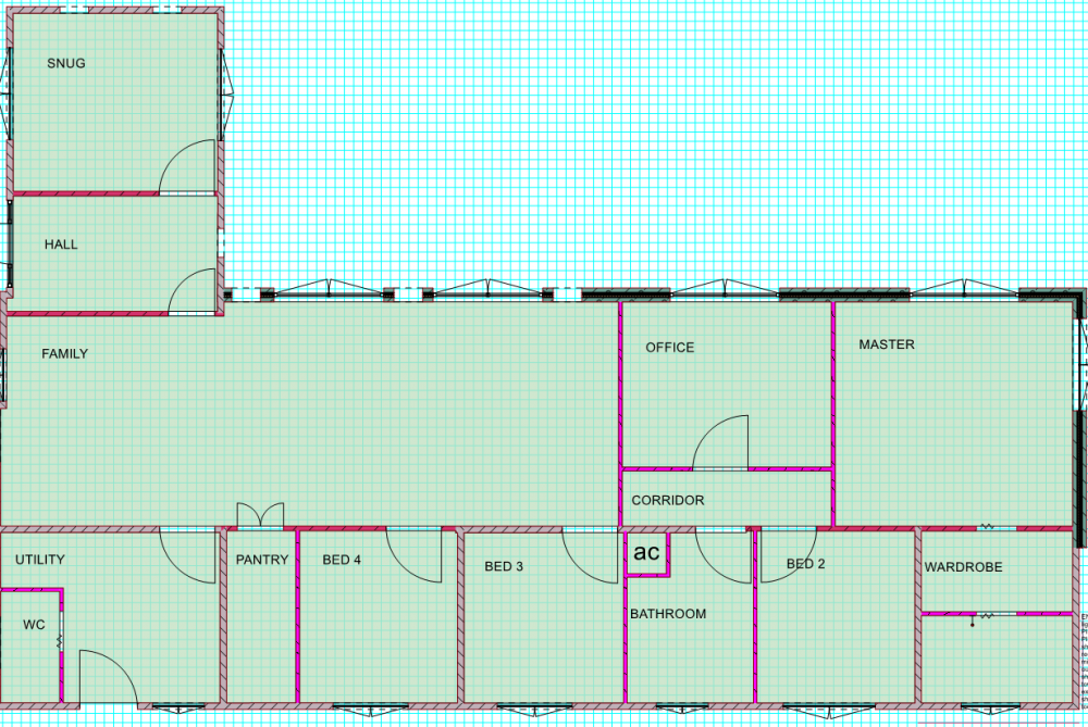

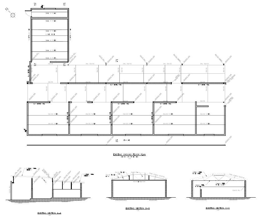

Here's a little reminder of the layout.
The wall is the bottom one up to where the ensuite wall is and the top of the WC on the left.

@LSB. What a pain. I feel for you. Self  building is tough on a greenfield site never mind having to deal with the issues of kicking an agricultural building, dragging and screaming, into a modern house.
To me it seems absolutely ludicrous one cannot simple demolish and replace the exist structure with something externally identical. I suppose that's beside the point. Perhaps, given the reality of the works to be undertaken, the planners would now have some sympathy to this position?
Secondly about the SE. If they are quite new to the role they are naturally very cautious, infact the exact right personality to be an engineer, however they may not have the experience to know exactly where the line is. Hopefully a senior colleague will have better news.
As an alternative solution, maybe contact a local underpinning firm for a consultation. They may well have a cheaper solution that your SE will be happy with given their more in-depth knowledge of the situation.

Well @LSB, stepping back from the situation, the depth to me seems odd.
As I understand it, foundations are used to ensure the weight of the building is dispersed over a ground surface area capable of supporting the structure plus a factor of safety.
So larger surfaced than usual foundations usually indicate either a heavier building or dodgy ground or a point load - say a pad foundation for a steel.
Deeper foundations point to poor ground or tree roots.
The only time I've known  2.4m deep underpinning was because the roots from a mature oak tree 10 meters away were undermining the foundations of a house.
If there isn't anything indicating tree root potential then it has to be poor ground and the only way to tell how far to go down is to dig a trial hole or bore down to see where the good ground starts.
Other things of note are sites with steep sloping ground or near other properties or your going for a basement.
This is the limit of my knowledge so I leave it to others to point out my failings.

Maybe not.. just by messing about on site you can gather valuable information that can be used to solve a problem.
From what you have said it seems like the soil is the crux of the matter. The roof loadings and the self weight of the wall are not onerous given the size of structure you have. I'm just speculating but are the walls close to a boundary with trees on the other side?  Has the SE not realised that the Elms are young and to be removed.. then speculated that they will grow into large trees? It could be a simple lack of communication!
Digging deeper if this is not a communication issue. You mention that the soil is neither clay nor sand. It may still bit bit expansive.. prone to swelling / shrinkage.. much depnds on which part of the UK you live in. Some of the Gault (fissured) clays in England are sensitive to ground and moisture changes, If for example you live in parts of Northern Ireland, Norfolk, Stirling in Scotland, the Severn type estuary regions in Wales then the ground can move about to a good depth.
Another thing is that your SE may have identified a band of silt.. so not clay or sand.. and this is another type of material. Silts are tricky to build on so maybe the SE has, luckily for you picked up on this.

Unless you have spent say 10k plus on a pretty comprehensive ground investigation.. maybe with an interpretive report I can't see (willing to learn though) the justification for concluding that the founds can be significantly shallower for the internal wall.. which may be load bearing to some extent. This makes me lean back towards the trees rather some tricky layer of soil in the ground.
In summary see what the SE's have to say. If you get no joy then dive back on BH. Provide as much info on the ground as you can and some cross sections so we can see where the roof loads go, the wall thickness and so on. BH members can then have a few more bits of info to work with.

3.  This is the drawings done by the SE on their first visit to check if the barn could be converted.
4. SE comments re soils for planning, this is obviously not the whole document, just a bit from it.
5,  Walls
6. Floors
7. conclusion
So, the first report, bits above from the SE did not raise any issues.
They do mention trees, but these have been cut down and all the roots removed except a few still waiting to be done.
This is the only remaining trees, which I will cut down if necessary, but I would like to leave a couple just to hide the electricity pole.

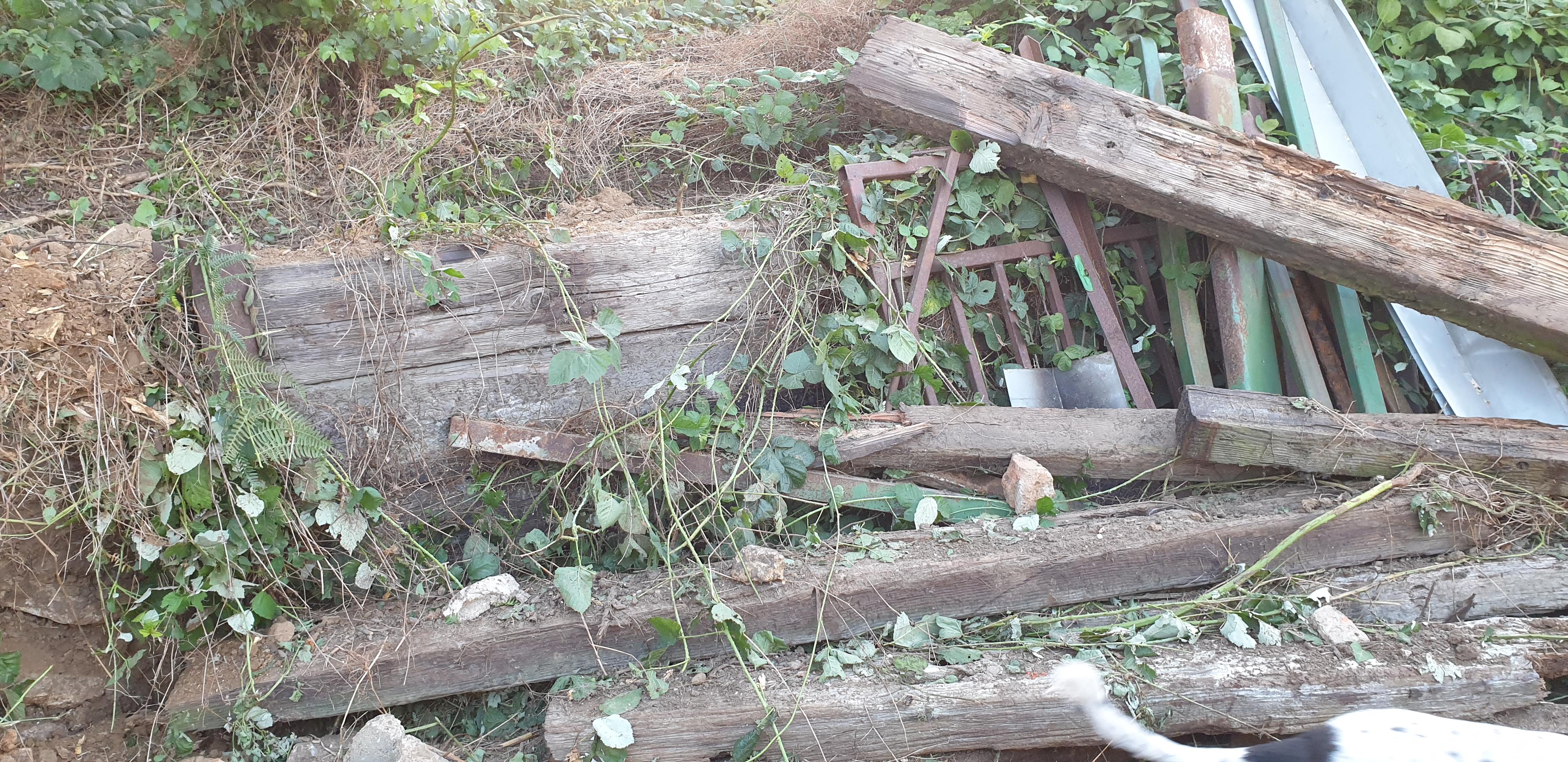

The back edge was like this before we started, not a lot of trees, even then.
This is what it looks like now.
Every tree that has been removed we have dug out the roots.
We have also remove the retaining wall mentioned as we wanted more space along this side of the building.
The plan is to terrace the bank, eventually
