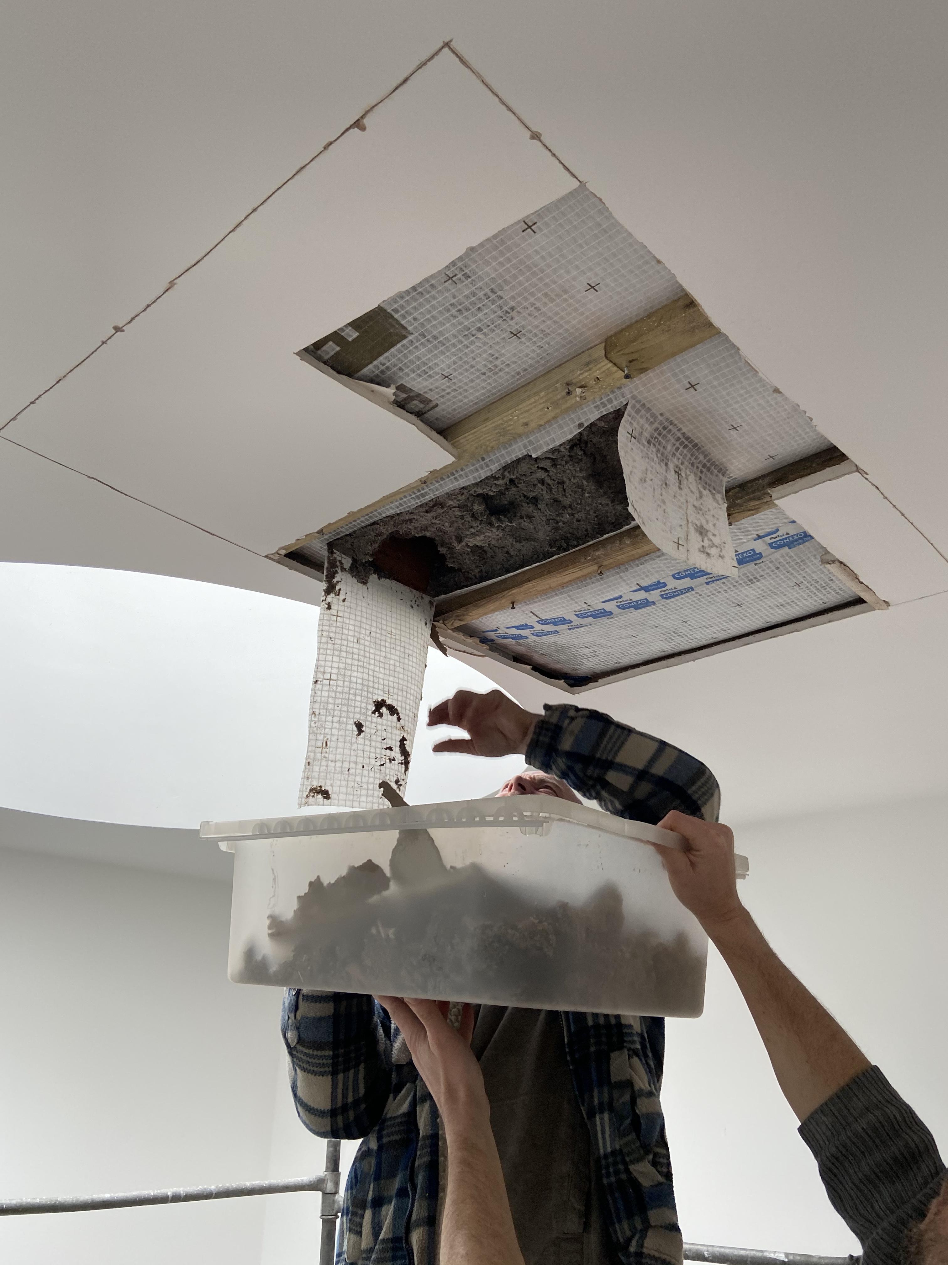

Thought I'd add this to the blog but would be very grateful for some advice.
Some construction background:
MBC timber frame, flat roof, pumped insulation in roof void.  Make up of roof is Sarnafil (hot welded) laid on a felt base, on top of 22mm OSB roof (with a slope), on top of 22mm OSB roof deck (flat - slope provided by battens to create the fall), then 400mm pumped insulation between the roof joists, air tight membrane, battens, 12mm plasterboard and skim.
Roof lights on the flat roof (including a lovely round one, subject of another blog post).
Yesterday we had some drips coming through the finished ceiling, about 700mm from the edge of our circular rooflight.
We cut away some plasterboard to see what is going on.  Plasterboard soaking wet, batten soaking wet and looks like the insulation is soaking wet.  There is some water damage closer to the rooflight too, visible in the photo, but we started our cut at the plasterboard edge which is where the water started seeping through - the low point I guess.
Have contacted roofing supplier and rooflight supplier (both of whom fitted their product).
What shall I do next?  I can't help feeling that without detecting the source of the leak neither supplier is going to help us.  Any thoughts?  Cut away our ceiling until we find the edge of the problem? (as we get nearer to the rooflight bit of course we are 7m off the floor ☹️)

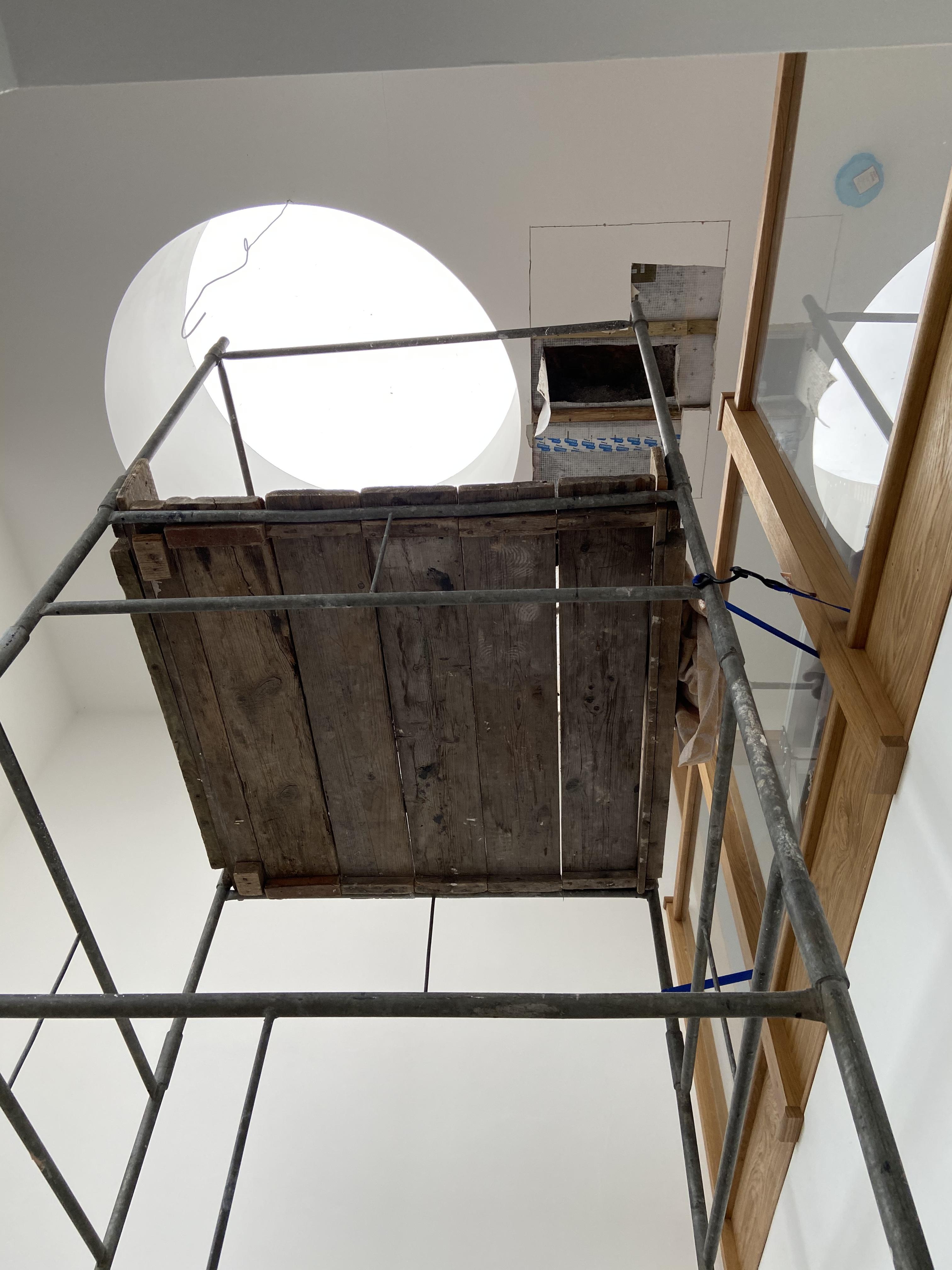

Thanks for all the comments so far. Here’s an update:
MBC (Darren) came onsite as on another local job. (they are brilliant, those guys) And together we took out a load of soggy insulation and put a small hole in the lower roof deck. We still have more to do as haven’t found the edge of the wet insulation yet. Leak appears to be down a bit of OSB nailed onto a roof joist below the upstand of the roof light. OSB roof deck appears dry in that location.
roof inspection yields nothing obvious. It’s hammering with rain so can’t test anything. A piece of plastic over what we thought might be the problem has not stopped the drips (every second when it is raining).
Inspected roof light mastic seal as advised by them. No issues of note. And roof light overhang appears deep enough to prevent any water ingress.
Awaiting roofers on site. Guess that might be tomorrow now.
waiting on the insurance front so we can see which party is liable and whose insurance will pay up.
luckily we own a scaffold tower (for our hedges, v helpful during the build) so put that back up pronto.
@jack your story fills me with trepidation but I expect we’ll be down some similar route on timing.
Got to get roofer to admit liability first so need to have a better go at leak location inside first.
once it stops raining we can get back on the roof to properly test it.
MBC and we agree this has been going on for months - the sodden insulation and lack of evidence of a failure point seems to indicate a tiny hole and slow damage.
and to think we were thinking we were almost there ?

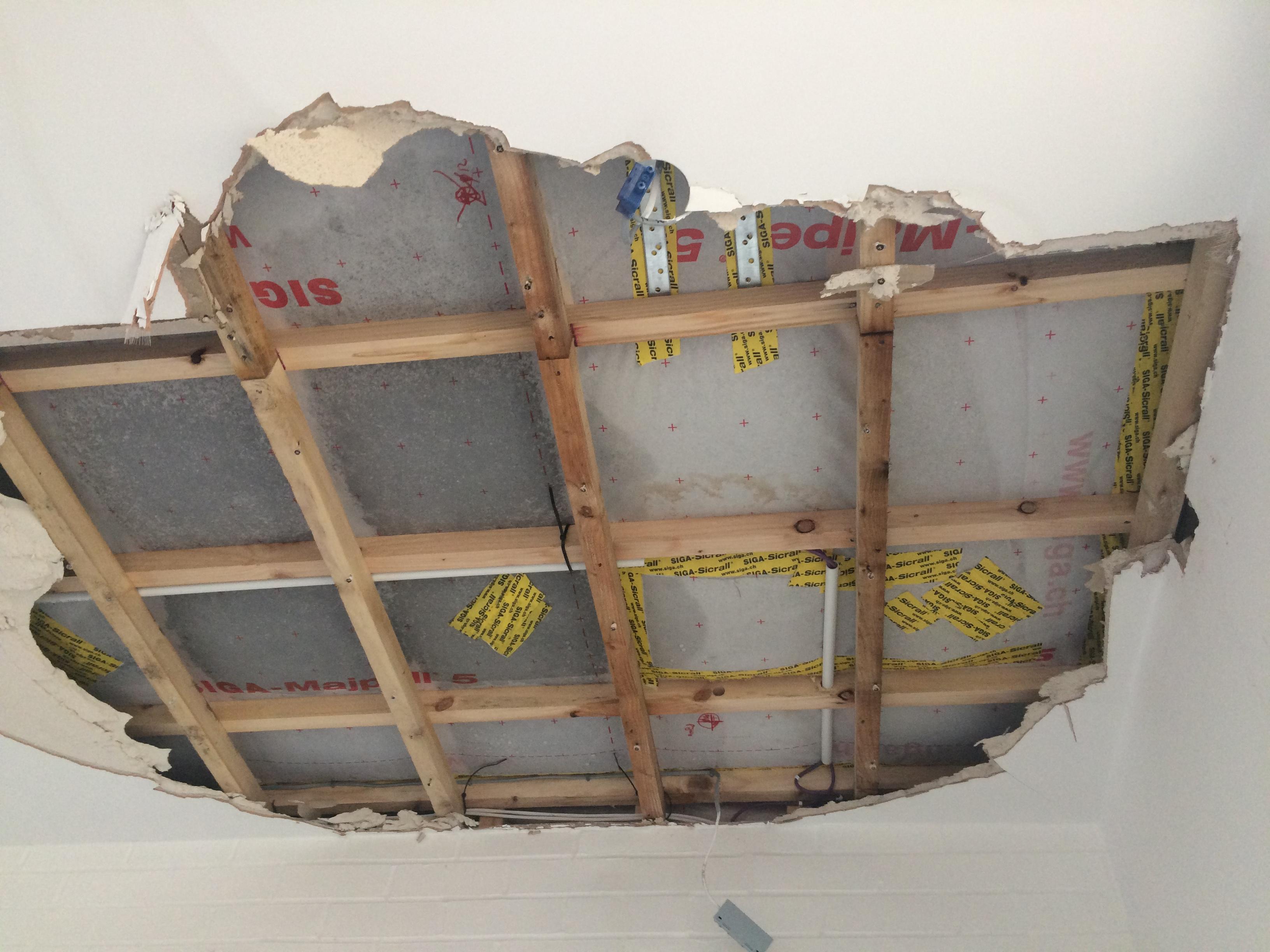

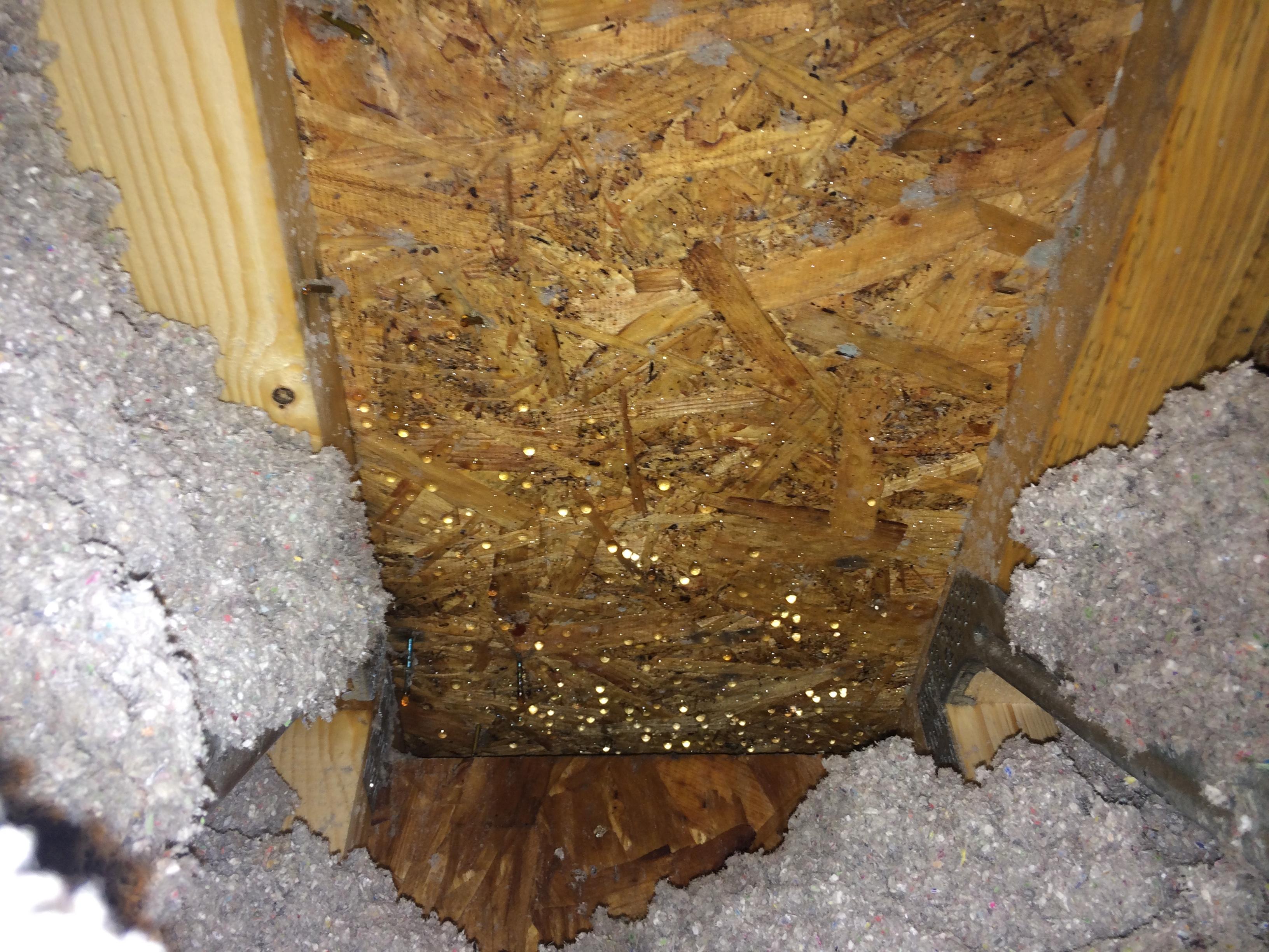

Those photos are bringing back all sorts of nasty memories. You have my sympathy!

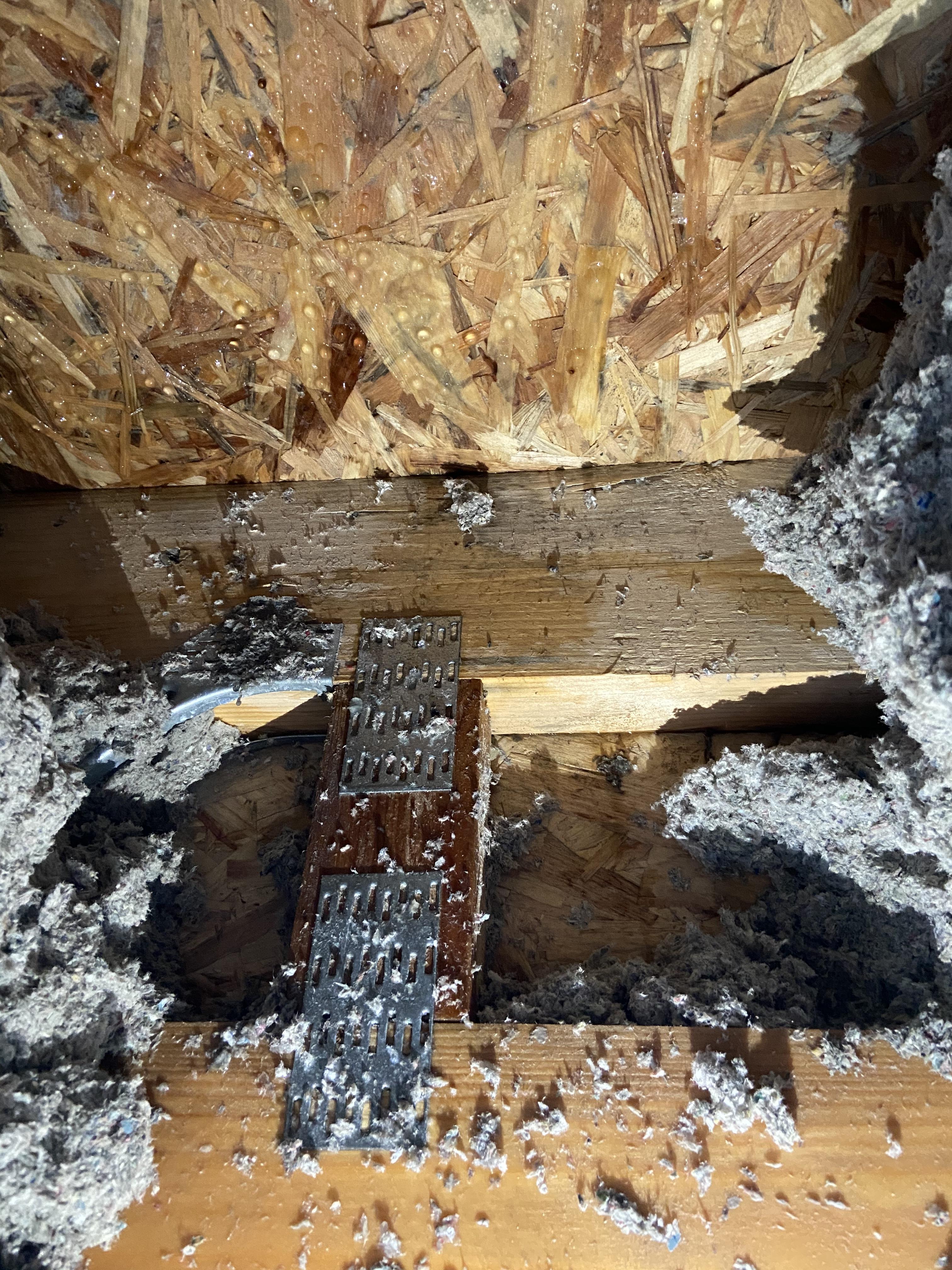

Wow - your photo is almost identical to the mess we exposed today, condensation on the lower side of the OSB with soaked insulation.
We have exposed even more of the area now.  The middle section is the problem area.
It has been a long day and we have just finished clearing up the mess (that pumped in insulation takes up alot more volume when it is pulled out!).  We have looked back at all the build photos and the construction drawings for the upstands for the roof light.  Its a bit of a puzzle but we are hypothesising that the water is leaking in through a mastic seal onto the frame of the rooflight (which sits under the glass).  It is then leaking through a screw hole into the upstand (timber) (the frame was fixed into the upstand with vertical screws), travelling down to the bottom of the upstand where it joins the roof joists and then spreading both above and below the vapour membrane (the drips are coming from below the membrane, but the insulation within the membrane is soaked also.  Of course there could be a leak in the roof material somewhere but that theory is not so obvious given where the water is being found and the lower roof deck being dry.
Tomorrow and Saturday are supposed to be dry (no rain hopefully) so we plan to get some water up there and selectively test the various areas.  I have messaged both companies inviting them to be present.  I'll video the tests so we have some evidence because fixing this is going to cost someone some money.  Thanks for all the advice, and supportive messages today.  It is good to know you are all there.....
