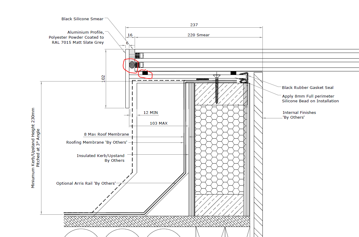

water poured all over the roof light this morning. First in the area nearest to the problem on the inside. Nothing dripping through for 5 mins. But then we moved to the higher end of the roof light (it’s on a slope to allow the water to run off). Almost immediately the drips started. And continued for a few minutes after we turned the water off.  So we have found the problem. Now to contact the roof light people.
we can’t see any solution other than to break the seal, crane out the glass, check the frame and (assuming we are tight) remove it and then check the upstands. Looks like the mastic may have failed at a different point but that the water might have run round within the frame to the low point where it then descended thorough into the roof void.
so happy we have found the leak. Now the next bit begins.....

Glad you have found the leak, but I would be worried by a design that relies 100% on mastic.  It should be designed so that components overlap correctly so water runs off not in, and any mastic should be for good measure.
Link to comment
I agree with this @ProDaveand of course we haven't quite confirmed the exact issue.  I am also not a professional designer of glazing units (though I now know a bit more than I did earlier this week .  ) But if you look at the cross section of the design it looks like this is the only reasonable possibility for how the water is getting in.  Our theory also depends on the failure of the two bits circled in red.
We don't think the water could be going up the inside of the frame (capillary action) as it is quite a way up but that could be the second option but that would require the failure of the silicon bead and whatever is next to the screw in the drawing below.
I wasn't on the roof for the install (HWMBO was, but didn't take too many photos).  The only photos we have before they lowered the glass in are here too for interest.  We wonder whether the water seeps in the outer edge, and then is funnelled round to the lower part of the frame where it deepens until it seeps over / under the blue things (?) and either down the screw thread or over the edge seal (?).  I guess we won't know anything for sure until the glass is lifted.  But we don't see how just repairing the mastic seal is going to solve the problem as there may well be damage to the insulated upstands and more.

I don't like the design of that one little bit.
I would have expected there to be some form of gutter around the perimeter of that, with that able to drain somewhere safe, to give a safe exit for any water that does make it past the seals.
No doubt they will remove the glass, re seal everything and put it back, and then all will be well.   Until next time......
When it is off, make sure every single fixing screw hole is well sealed, that will be where it is getting into the building.  And since the framework does look to be larger than the upstand, I would talk to them about the idea of drilling safe weep holes to allow any seepage out onto the roof.

I'd very definitely want to see weep holes to drain what amounts to a gutter all around the periphery.  Sooner or later the edge sealant will fail again, for sure.

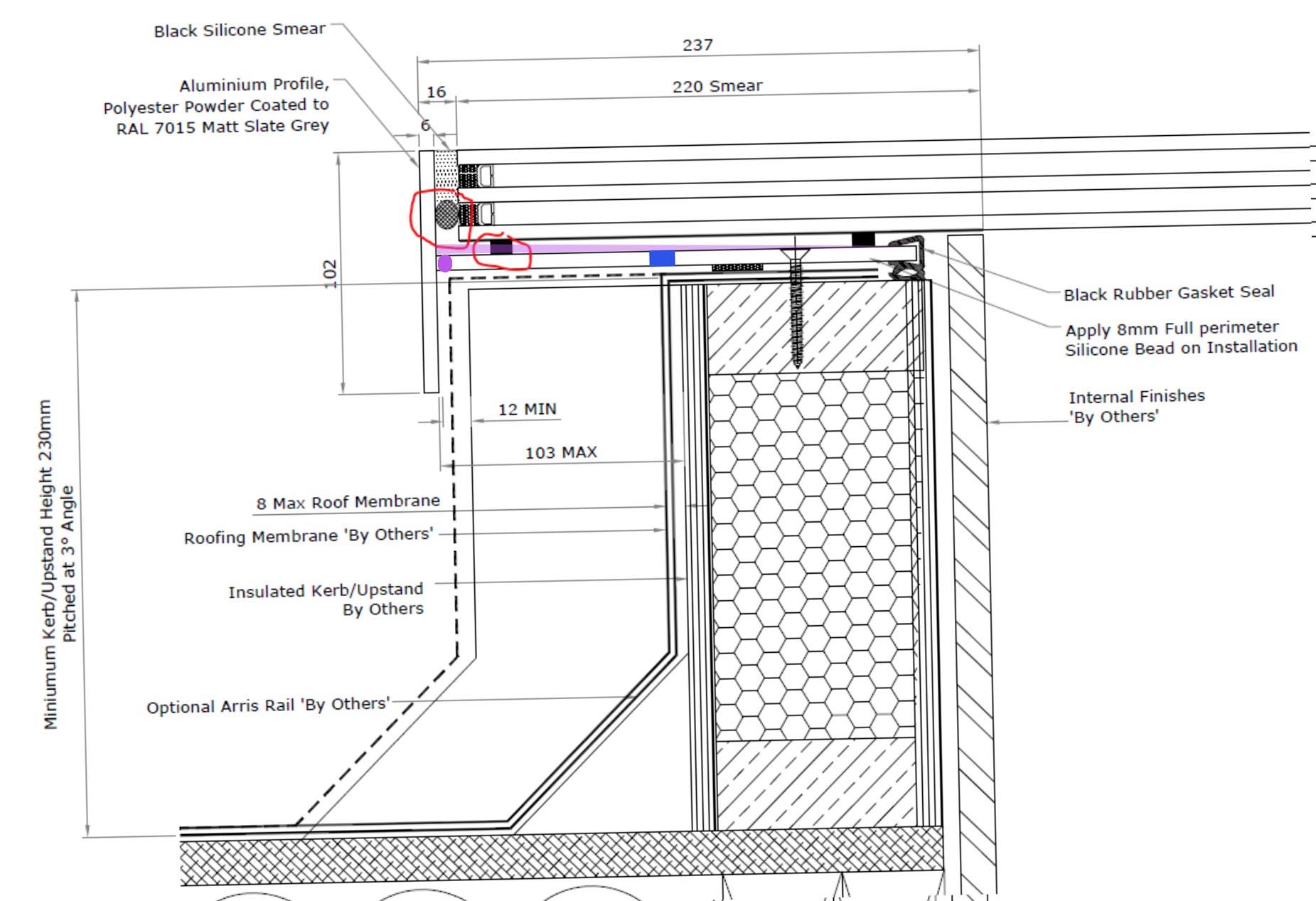

I've had a rather similar experience with a Vision AGI skylight on a flat Bauder (same as Sarnafil) roof.
If i've interpreted your earlier blog posts and pictures correctly you made your own upstand and then the skylight was fitted onto it frame first then the glass inserted.  You'll need to have been fairly hands on involved really to be able to answer the following points, but the top flat surface of your upstand needs to be really quite good in terms of its flatness in order to provide continuous full contact with the whole circumference of the skylight frame.  It also needs the roof membrane to have been lapped both up the side of the upstand AND over the full width of the top surface.  You wouldn't think this was critically important based on the supplied technical drawing but what if the frame actually does have weep holes, say where i've put a blue mark on your drawing.  For me there were weepholes not illustrated, ask the supplier.  Given the wide fitting variation of 12mm min to (103-8mm) max possible the actual whereabouts of the weepholes wouldn't necessarily sit where i've marked blue, but in this position they'd drip inside the membrane IF the membrane terminated on the vertical and didn't roll over.
If they're blaming the mastic failure, thats the easiest fix for them and the first thing they want to try before getting more 'deconstructive'.  I'd presume they've now drilled a weep hole at the lowest possible point so about where i've marked purple, on your lowest falling edge....so I've tilted the image for a fall and added a pale purple 'wedge' representing the potentially trapped water that drained out.  To form that wedge of water all mastics and gasket seals had to get breached and the wedge height reached the screw through the frame into upstand.  Maybe the screw became the leak point....otherwise the wedge would have to grow to overflow the internal edge of the frame, at which point water would escape directly behind your internal finish...can you see any staining or evidence there.
These are my thoughts anyway, hope something is useful.  Mastic was initially blamed and replaced in my case but it was not the final answer.  I actually ended up with a replacement skylight but that was in part due to a concurrent problem not relating to the leak(blown glass unit leading to condensation between panes).
My initial skylight was supply only and I made my own upstand.  The replacement (on the grounds of the blown unit) was offered supply only, leaving me with the consequential costs of removal/refitting totalling approx £1000 for me, largely due to need for crane/lifter/banksman.  They denied liability for getting the skylight onto the upstand but having ascertained the info' that @Temp has uncovered for you I persisted and so they delivered and fitted it with their own team and hydraulic lifter 'in the interests of being helpful'.  I still paid £500 for a local crane though but reserved the right to make a small claims when I have time (which will be never).  I would fully expect to win that claim as should you regarding your peripheral damage.
