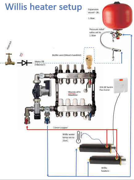

Willis Heater approach
So therefore looking to heat the UFH with 2x 3Kw willis heaters in order to progress with the internal house work. Thought I'd add some info on here as a lot of people like myself aren't familiar what they are. They originated out of Ireland and still much in use over there. They're essentially external immersion coils and instead of sitting inside a tank are simple external electric units - AKA "Willis jacket", "standard sleeved immersion heater"," inline electric heater". Googling should get you something like this:
Willis Immersion Heater | Shell & 3kW Element
Item Weight 1.15 Kg
Product Dimensions
30 x 9 x 9 cm
I have tried to get plumbers interested in rigging this up, but they're either not interested or have told me it's not possible/don;t know what a willis heater is. I've managed to plumb in all the Hep2o in the house, so hopefully this won't be too much of a bodge.
@TerryE has kindly discussed his set up which is pretty impressive with his DS18B20s set into the walls etc. I'm no programmer and my javscript is mainly simple web stuff and wanting to get heat into the place ASAP, I just want a KISS approach for now. Perhaps later I will think about having some of it programmed using Terry's Node Red option which makes for interesting possibilities. Get a feel for Terry's approach here:
But as I've said, I'm after a bog standard dummies approach to this - seriously KISS:
So rather than wiring up room thermostats to the wiring centre, I will for now simply use the Willis inbuilt thermostat and set that to gradual increasing temps from 10oC up to a max of 25oC. A gradual heat increase seems safer in my mind. My only concern is if the Willis thermostat fails and carries on beyond 25oC - up to max temp. Obviously I will have the manifold mixing/blending valve that should restrict temp flow into the UFH also, but is there a further failsafe to consider?
Dummies layout.
Eventual Sunamp units (for DHW) will be located on left of manifold so having to locate Willis heaters to right  and expansion vessel top right:
FYI: The immersions need to be turned the other way (so colder water enters the side)
Parts list:
  • 15mm copper pipe. The Willis heaters are 15mm so I presume plumbing them into the manifold with 15mm would be okay?
  • 15mm plastic pipe for cold return should suffice I presume?
  • Bottle vents - automatically release any trapped air (like this one). Do I need any and if so where do I place them?
  • Willis heater (ebay has the cheapest)
  • Expansion vessel - 8litres sufficient for total UFH volume of 130L? (like this one
  • 20A DP switch outlet (for each willis) from a 16A MCB (like this one)  . Probably one for each willis
  • Immersion timer (like this one) to be added possibly when I change over to E7 low tarriff rates
Will get an electrician to wire it all in for me!
Be grateful for comments, suggestions and any answers to above questions!

Ok so use copper within 1m of the Willis just for ease. If you don’t want to do compression joints then use these as they are just as quick but can be de-mounted unlike the Sprint version ... you will also need a decent copper in pipe slice - this will last you a lifetime.
Expansion vessel should be 15 litres, it’s not a stored system so don’t need to be looking at over pressure valves but I would add a pressure gauge and a fill loop and reduce the pressure in the expansion vessel to 1.5 bar as they are pre-charged at 3 bar.
Rest looks fine - post up some pics and we can see where to help.

You definitely need the PRV, but not the BV.  The Wunda manifold has a manual bleed which you can use to release any gas, but the system is closed so you won't get any gas build up.  You need to do you UFH routing but ~160 m2 of slab should work out at around 7-8 x 100m loops.  You want to balance you loops for even flow and keep the loops to just under 100m each or alternatively 75m if you are using 300m coils.  You must avoid any joins in the slab: each loop has to be one continuous length of pipe.
I note that given a wall U-value of 0.33 and your calcs seem off to me:  I can't understand why your floor and wall losses are of a similar order when you have 50% more wall and the U value is 3x worse.   You also seem to be planning far below a PH class house, so your house as a system is quite a bit different from mine in its operating nature.  I use the thermal capacity of the slab to advantage so pretty much all of our heating is done using E7 low tariff rates and we operate the house as a single zone.   You seem to be designing your 2 x Willis as a pretty much always on (during peak heating months) heat source.  Have you costed the running costs?  IMO, you've moved well into the zone where a more cost efficient heating method such as an ASHP or even gas should be considered as an option.  Something doesn't hang together here.

I believe that it's best to fit the Willis heaters so that the immersion is at the bottom, rather than the top, so as to avoid getting an air pocket adjacent to the element that cannot be bled out.  Alternatively, they can probably be mounted on their sides, with the side pipe poking upwards.
I'm no expert, mind, it just seems more logical, and potentially a bit safer (in terms of avoiding overheating the small bit of element in the air pocket) if they are arranged like this.  It may be that the MIs say different, and MIs always trump any other advice.

I,m with @Jeremy Harris, the picture on the side (above)tho shows it mounted on its side with input pipe coming upwards but as JSH says it cannot be bled completely of air like that. Be interested to hear from someone that has fitted one and what it’s fitting instructions were.

So, just putting my final shopping list together:
Expansion vessel
Can't find 15L, so oversizing it won't matter I assume? i.e. 18L expansion vessel (with loop and fixing kit).
Pressure relief valve
Only need the one correct, and that comes with the above expansion vessel kit?
Bottle vent (fix to manifold)
Yes, kept on having to release air during initial loop fill up (pressurising for concrete pour), but was thinking to add a bottle vent to the manifold so that any air is released automatically. Manifold is not pressurised at the moment so will have to do that.
15mm copper pipe - Willis heater connections are both 15mm, so seems best to just connect it all with 15mm pipe, unless there's a reason not to?

Expansion is fine oversize, you need a lower pressure valve so possibly want to find an alternate to the 3 bar one.

I have a beginners question.
Is the dashed "mains fill" feed permanently connected at mains pressure to a t-connector at the base of the expansion vessel? I assume not because of the risk of inhibitor chemicals leaching back into mains fresh water.
Link to comment
The filling loop should be a flexible pipe, with hand disconnects and shut off valves at both ends, and a non-return valve on the mains feed side as well.  When not being used to fill the system the valves should be shut off and the pipe disconnected.  In practice the pipes are often left connected, with just the valves shut off for isolation.  You can buy a filling loop kit which has all the bits needed, like this one:  https://www.screwfix.com/p/r24-filling-loop/83905#_=p

Updated setup. Others have the Willis with element at top, but I may 'lay' mine down to prevent air being blocked in top. Will see what the instructions say, if anything. Internet a bit scant on instructions so will post on here when I get the goods. Also added bottle vent to manifold and NRV on mains fill line. Apologies for the small print.

The 20 A DP isolator needs to be uprated, or two need to be fitted, as each Willis heater will draw around 13 A, so with both on the current will exceed the 20 A rating.
Link to comment
? Yup, I thought that was the case and had two on my shopping list above already. Will add it to the diagram for future refernce/readers! Thanks J!
Ok, so pressure relief vessel kit came with 3bar pressure relief valve. What pressure valve should I be looking at and where to source one from. The ones at Screwfix etc all seem to be fixed at 3bar.
Currently have this one: https://www.altecnic.co.uk/images/products/info/313_314 Safety Relief_DS_07_11.pdf
They do have a 2.5 bar also, but is that going to make much of a difference?
https://www.altecnic.co.uk/domestic/plumbing-heating/sealed-systems/616/
Why do you need a lower pressure PRV?  Which bit of the system can't take 3 bar?
Link to comment
No point in running 3 bar on a system that is just circulating water in the UFH. Lower pressure is less stress on joints etc, and as long as it’s above 1 bar then you won’t have any problems.
I use standard copper cylinders as buffers too and they only take 1.5bar before they pop the domes on the bottom - another reason to have a low PRV
