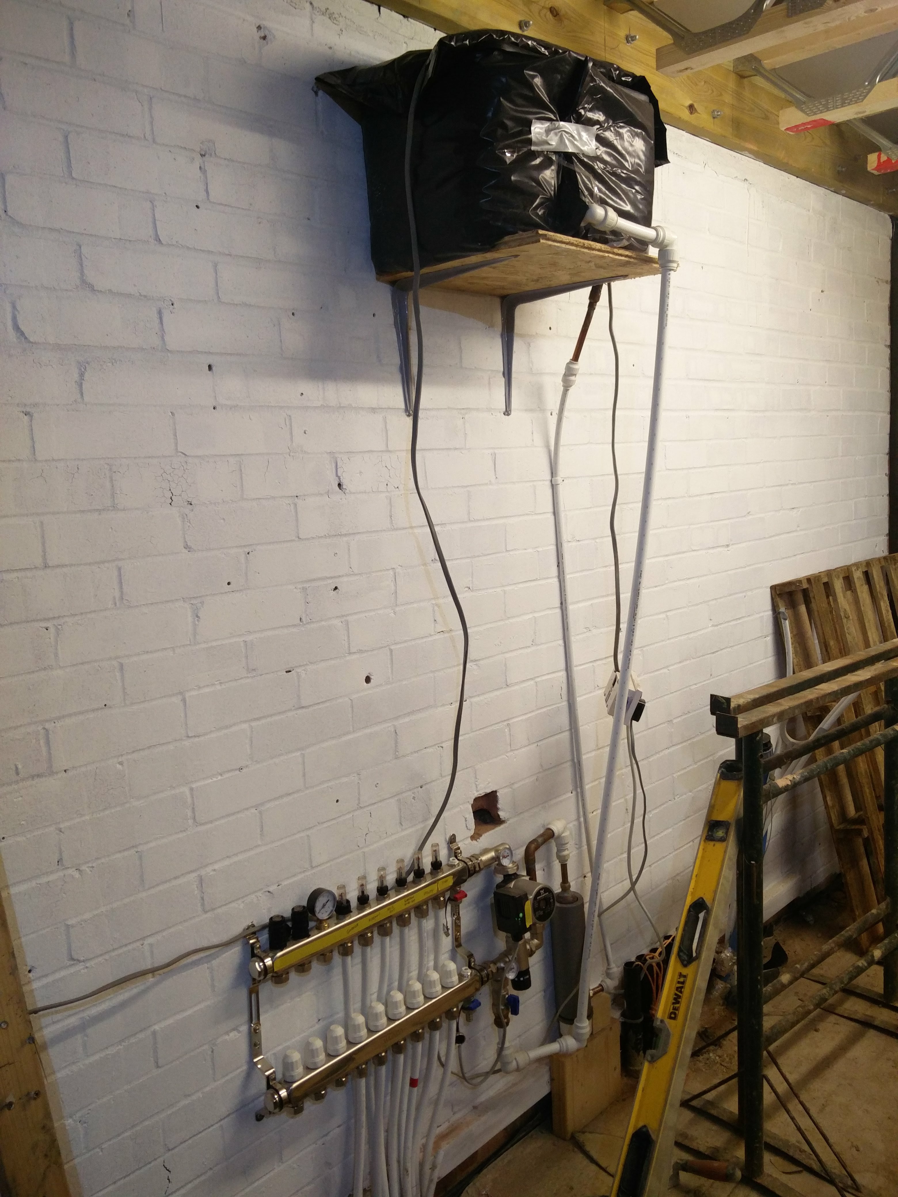

This is exactly what I have right now, the 3kW willis is running flat out 24/7 but is keeping the slab at about 10oC with outside air temp between -2 and 5. Costing £££ in leccy, but its stopping any UFH freezing, and also dries up any water on top of the slab. Otherwise, it would be like an ice rink in there.
The Willis cost me ~£40 on eBay, and I used the old CH header tank just above the manifold to rig up something till I get the new boiler in.
@chrisb any chance of a cheeky picture?  I've had 3kw of oil filled heaters going flat out since 10am and the air temp has lifted by 2deg, not too bad considering its been freezing all day.  Up to 7.2deg inside when I left tonight cf to -4deg outside, hopefully they will keep on top of the job tonight - better weather tomorrow.  Slab is cooler than this.  Hopefully before the next cold snap we will have heating sorted!

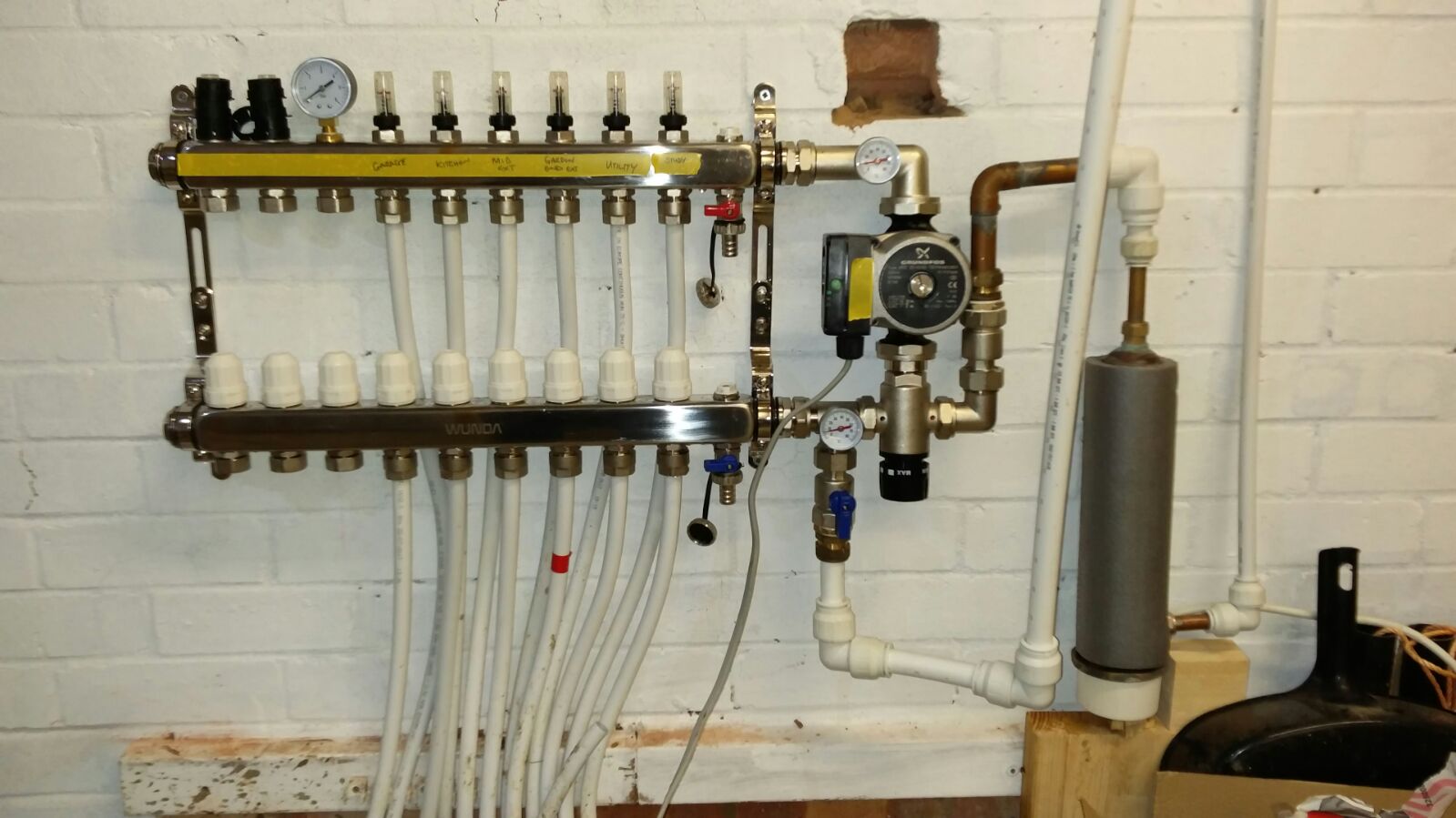

Both the feed and return pipes are attached with tank connectors low down in the side of the tank. I filled it with a hosepipe and check the level every couple of days. The Willis thermostat is set to 25oC and the TMV set to the hottest setting. The Willis never turns off, well certainly not yet, anyway.
I wired the willis and the pump to their own 13A plugs (yes, I know about them not being continuously rated for 13A), which connect to a pair of single 13A sockets connected with a length of 2.5mm2 T&E run from a 16A MCB in the consumer unit on the other side of the wall. The plugs are in free air, and I have checked after several hours of operation and the heater one is only slightly warm. I'm satisfied that the fire risk is low, unlike the 2kw fan heater which stopped 'fanning' and turned into a melted lump of plastic pretty quickly, and the convector heater which has a very hot plug if run on the 3kW setting.

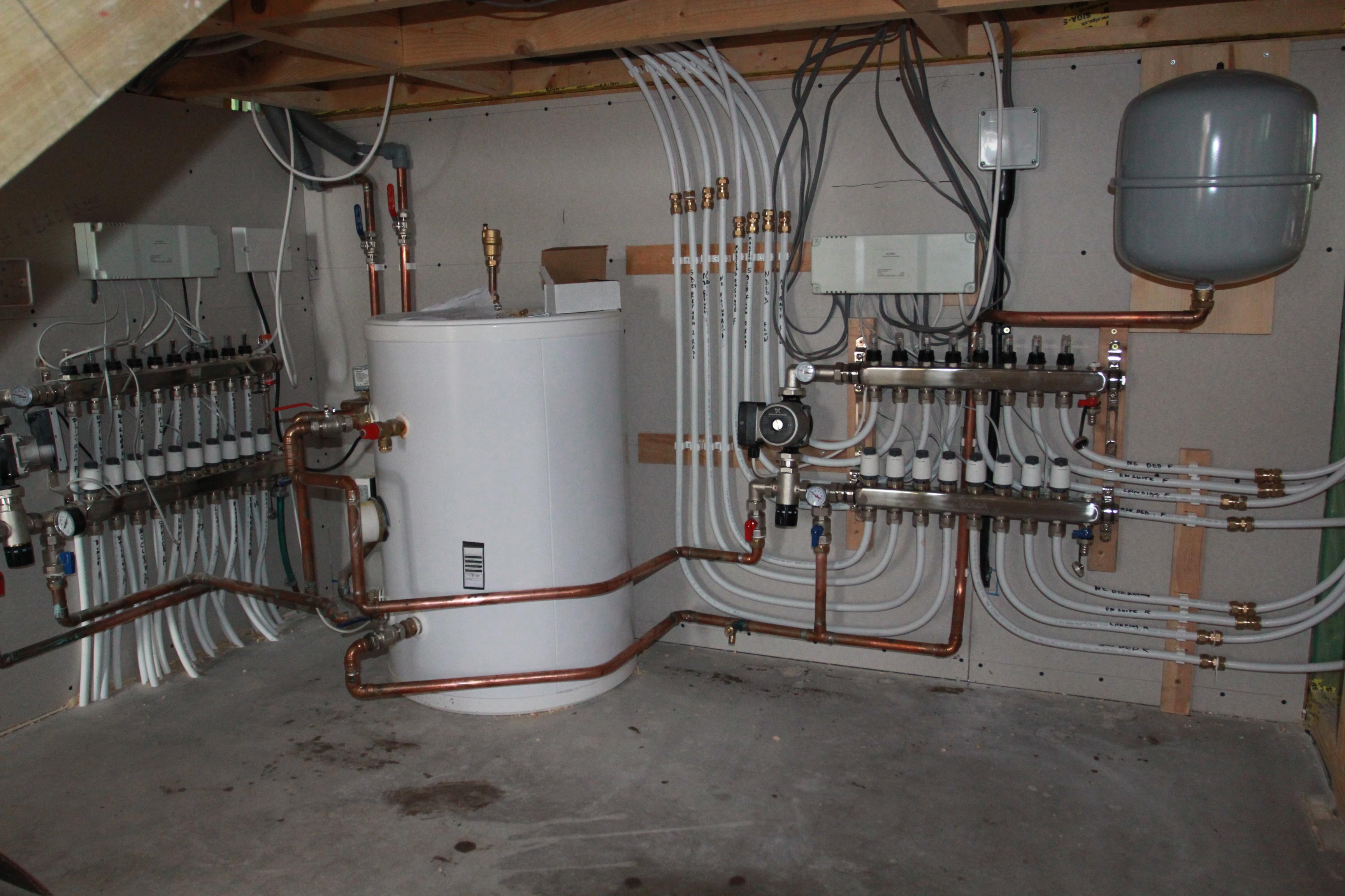

the heating system is now in and complete.  Mains gas boiler feeds a 90l buffer that then feeds two Wunda manifolds - ufh down stairs & rads upstairs.  All individual room stats.  A bit of cable management needs to happen but otherwise I'm pleased.  Its taken Q a bit of work but all good learning.  Its a @Nickfromwales design :)

If you follow the expansion vessel back to the buffer, you can see it could be isolated from the heating system should the right hand manifold be fully isolated and left so for any duration ;) The expansion vessel should be connected independently to the buffer, BEFORE the isolation valves, as its to protect the vessel more than anything. Ultimately if its your house and nobodys going to work on it other than you then you can sleep easy, but the rule is that you never have an isolation, or any other valve, between the EV and the cylinder / heat source.
Im such a killjoy :ph34r:
bugger.  This is the second one on the heating system (1st one is in the system boiler) - just added it because I thought it would give a bit more slack.  If I shut off the valve then the system boilers own ev will still be plumbed in.  So the 24kw system boilers ev does the UFH (~100l) and this one does the rads.  Once we move in - I may go back and tweak this so my fellow Welshman can up the mark to 10/10 :D
ps @Nickfromwales - I've left the PRV on the tank as well - I will pop a container under it (don't want to take it outside - it will impact on my airtight barrier) just in case it blows.  There's another one on the boiler.

You have to keep that T&PRV on the buffer so you're covered for the terminal failure scenario, which is all the isolations shut off and the immersion heater on and its stat to have failed. Its that situation that dictates the T&PRV's location ( and the fact that its factory fitted with half a tub of thread lock so its near impossible to remove ).
Just put a 15L container under it and you'll be fine as the PRV on the boiler should be a lower setting. The buffer one is 5 bar IIRC and the boiler one will be 3 bar.
