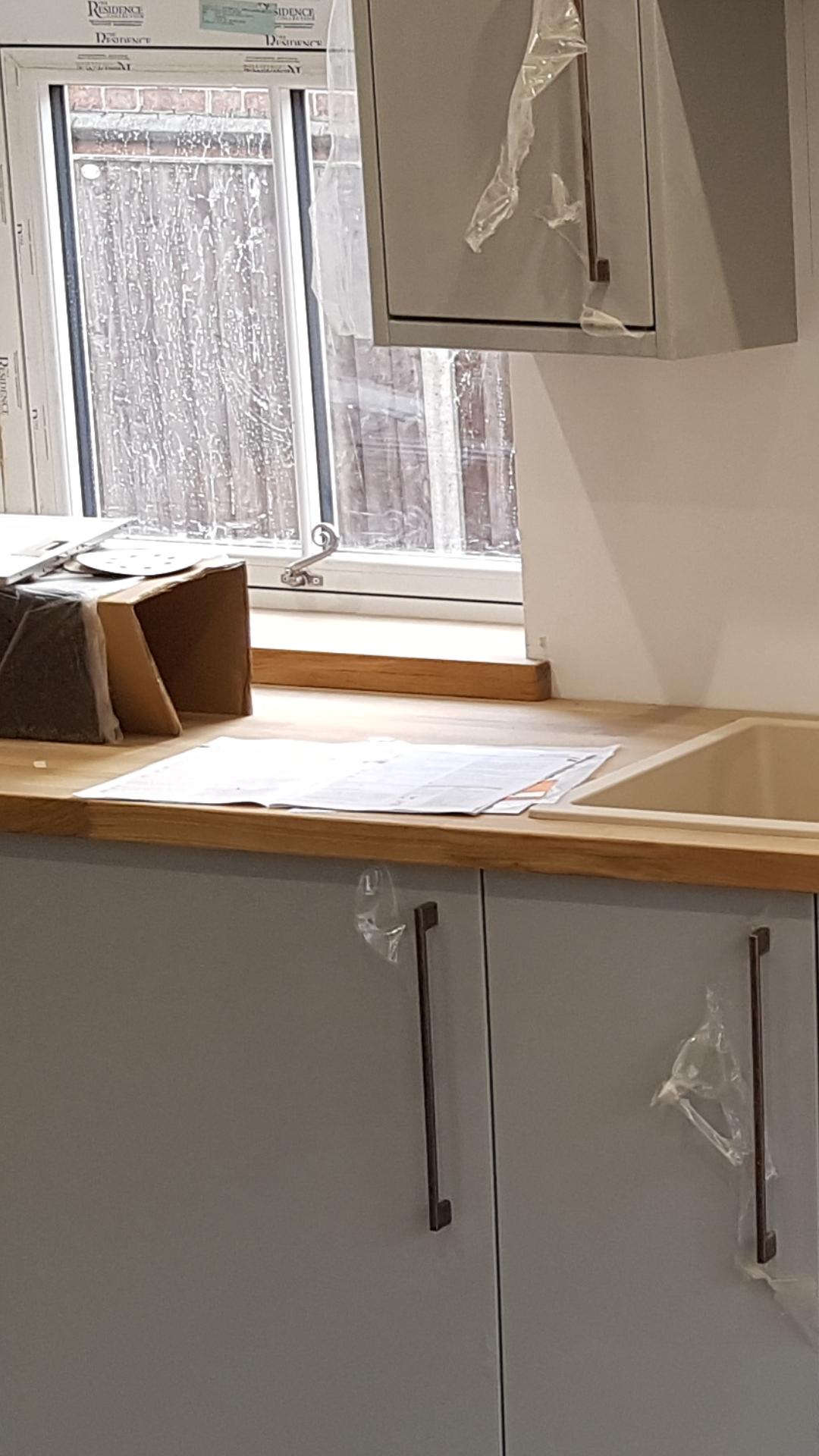

Wagas Posted June 1, 2019 Posted June 1, 2019 Hi, my architect has the kitchen sink window starting at 950mm above finished floor level. This seems a bit high to me, 915-930mm would be better I think. I'm wondering if 950mm is the minimum distance from floor level that a kitchen sink window needs to be for building control? Does anyone know? Thanks
ProDave Posted June 1, 2019 Posted June 1, 2019 Our worktop is 935mm above FFL Even 950 would put it only very slightly above worktop making an awkward detail to finish. Our kitchen window cills are 1100 above FFL to give a decent splashback. Or are you wanting the window low so the worktop extends at the same level to be the window cill?
Oz07 Posted June 1, 2019 Posted June 1, 2019 As above I like them 1050 minimum as gives 6" ish This is what happens when too low. Its ok but not ideal

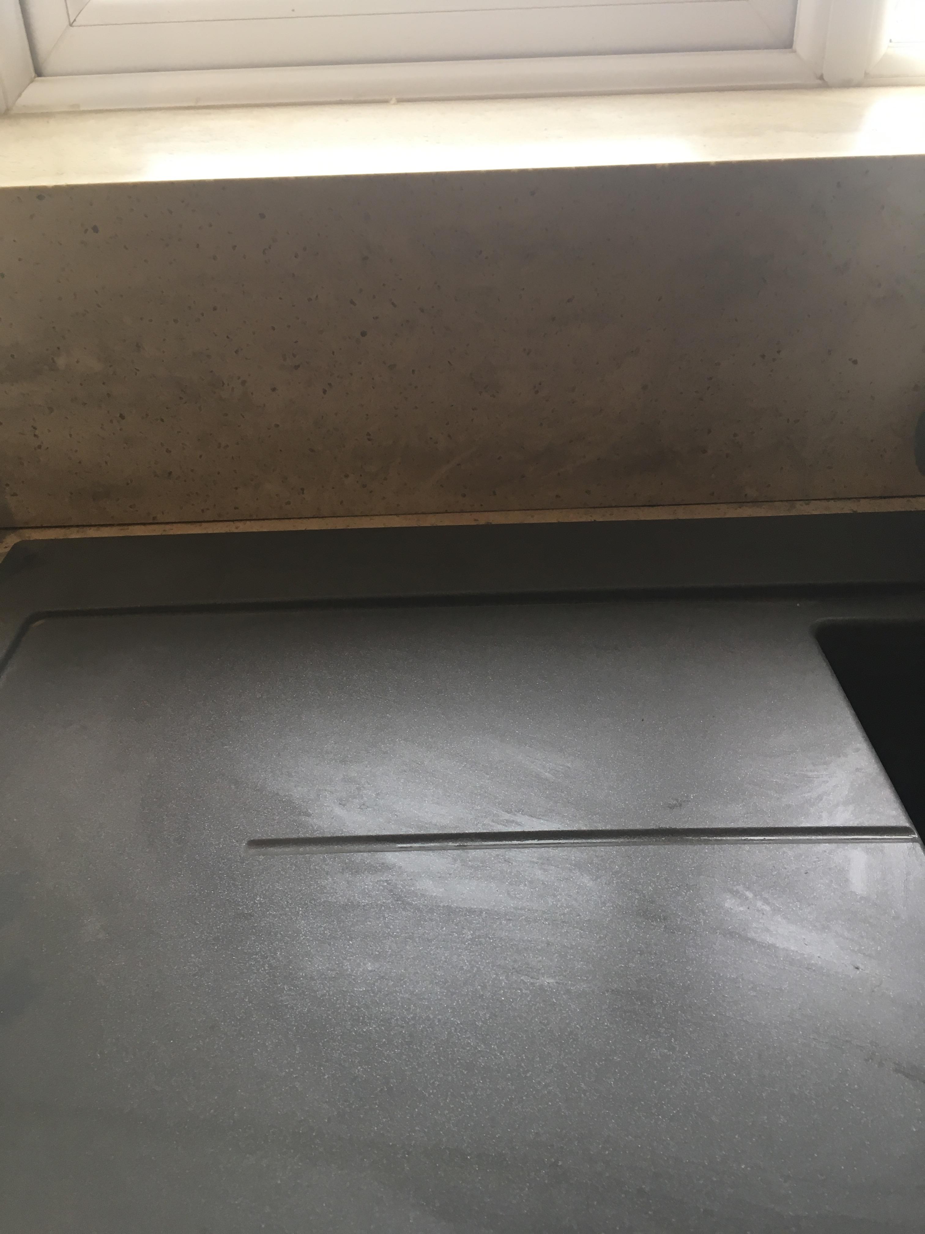

recoveringbuilder Posted June 1, 2019 Posted June 1, 2019 Ours is like this: the corian is formed as a splash back and window sill, you don’t get splashes on your window which we did in our last house which had the worktop just under the window sill

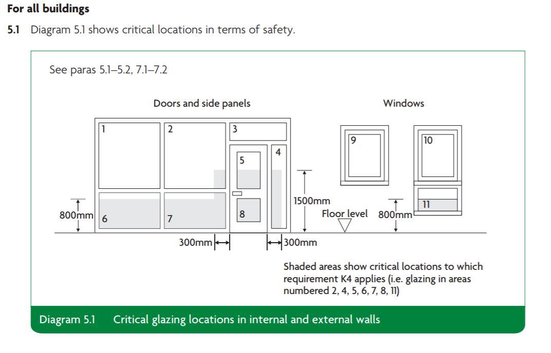

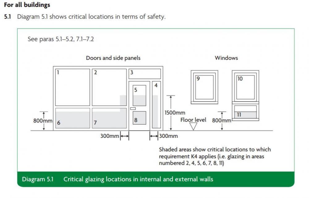

Wagas Posted June 3, 2019 Author Posted June 3, 2019 23 hours ago, PeterW said: The only restriction will be that if it is below a certain height then it has to have toughened or laminated glass in the panel. Is that restriction 800mm? So for living room/ground floor bedroom as long as windows are 800 above finished floor there are no toughened glass/restricted opening requirements? Thanks
PeterW Posted June 3, 2019 Posted June 3, 2019 1 hour ago, Wagas said: Is that restriction 800mm? So for living room/ground floor bedroom as long as windows are 800 above finished floor there are no toughened glass/restricted opening requirements? Thanks This is the safety zones for glazing from the current Building Regulations Part K 2013 Full text here https://www.planningportal.co.uk/info/200135/approved_documents/73/part_k_-_protection_from_falling_collision_and_impact
