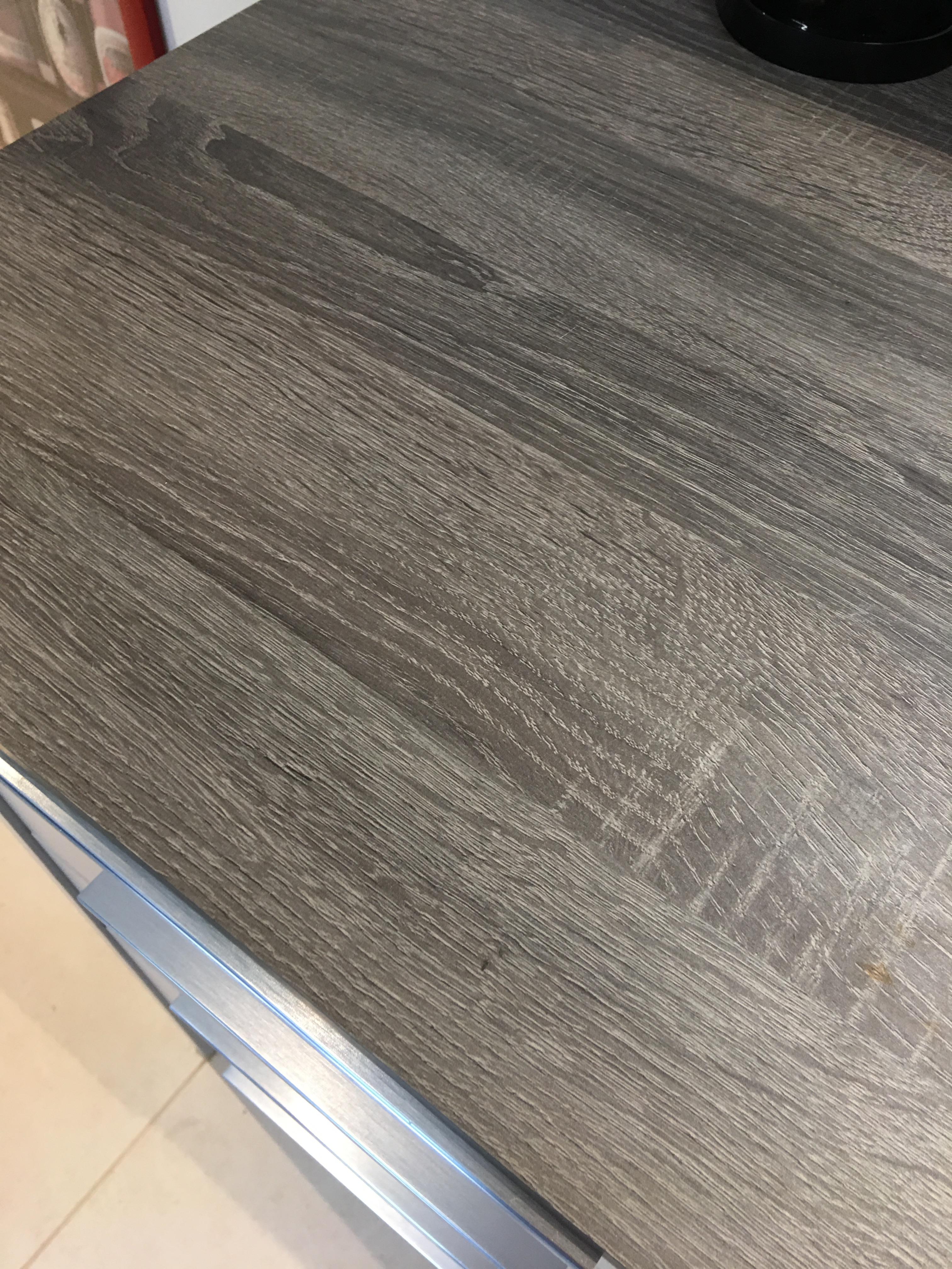

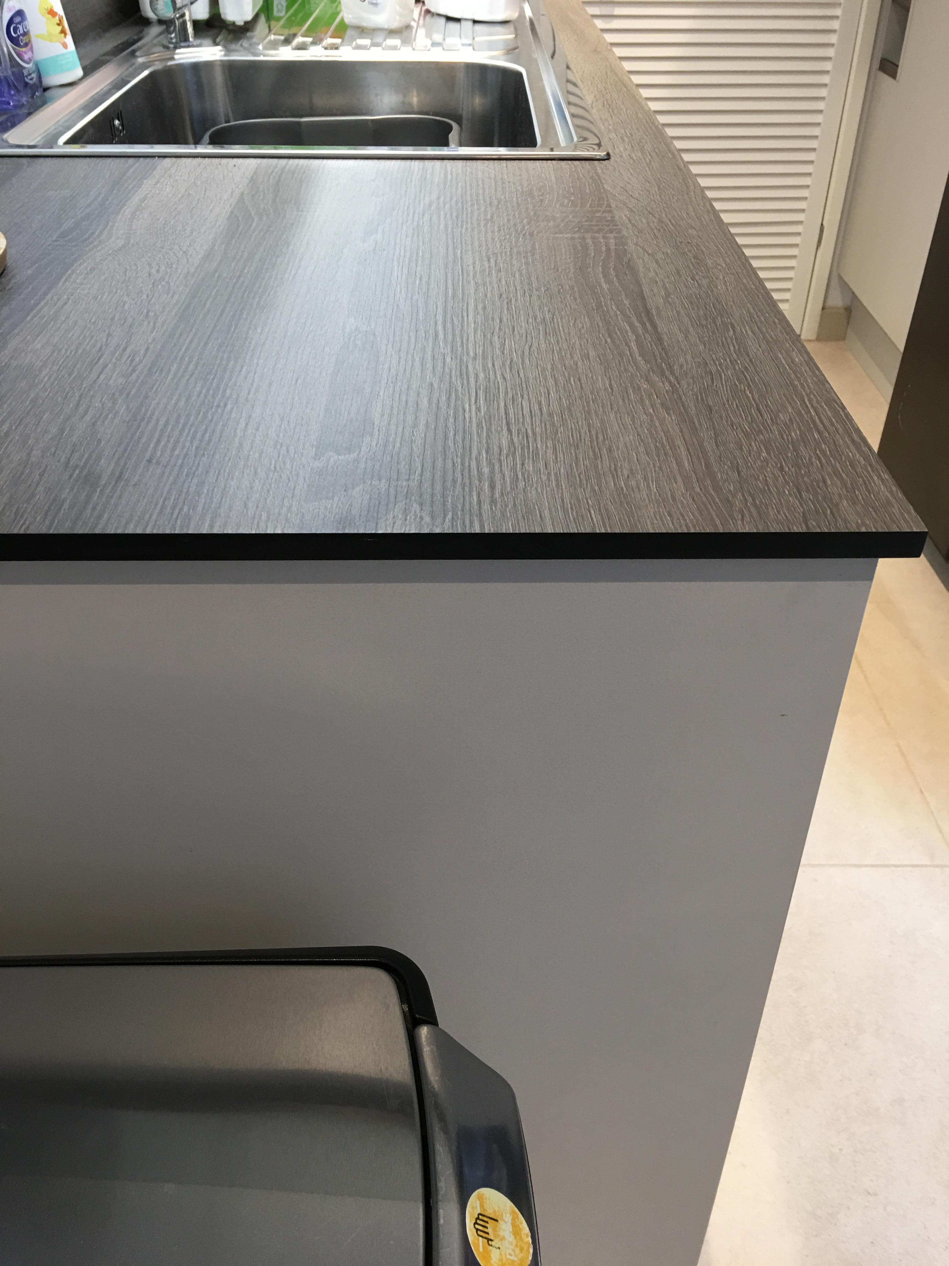

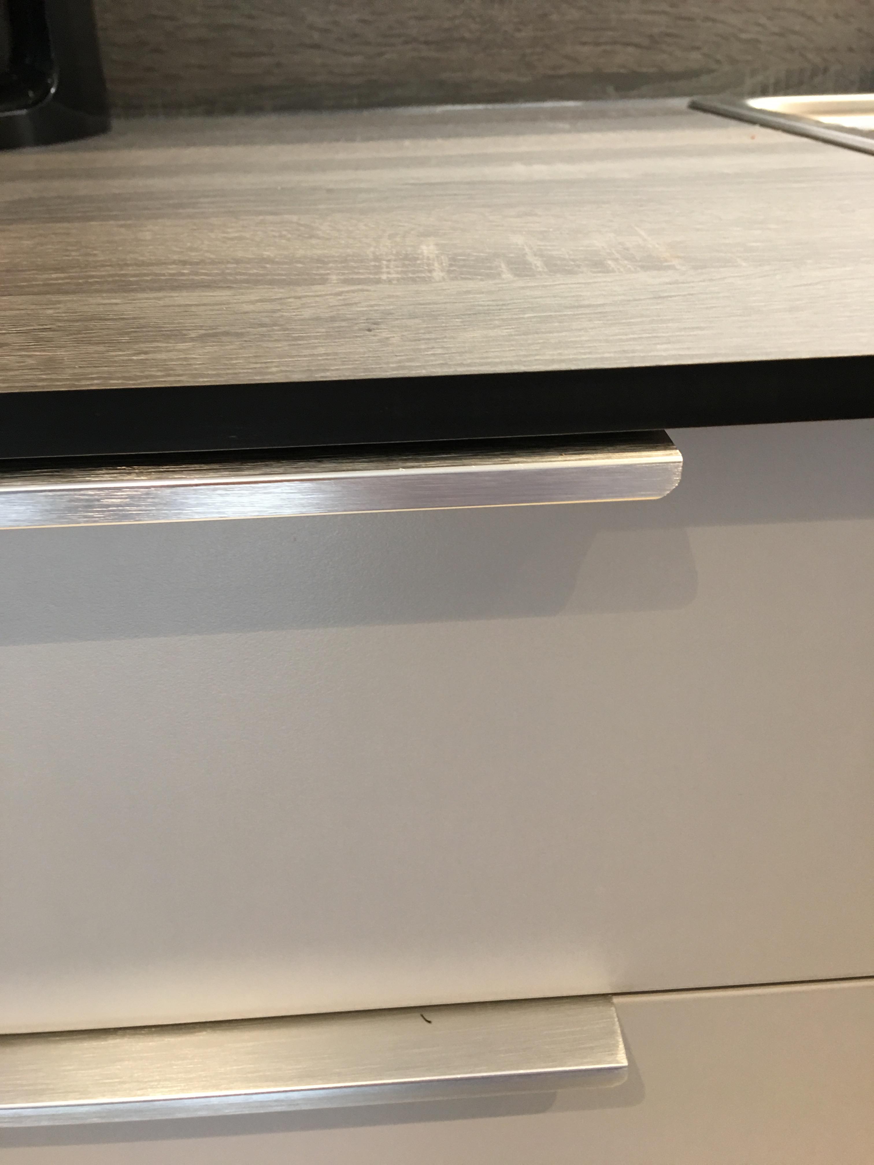

In my utility room I used Howdens units.  I wanted a waterproof top not just a standard laminate but granite was overkill.
I found a product called Zenith.  It is completely waterproof wont lift like laminate and is scratch proof and pretty bomb proof I think.
I had a 12.5mm thick one so nice and modern and slim.  I had it to look like my oak in the kitchen so it reflected the style of my kitchen without the same cost on natural materials. Zenith comes in all sorts of colours and styles.
I had a piece 3065 x 650 x 12.5mm for £190 plus vat. Matching up stands 4065 x 95 x 12.5mm £40 plus vat.  So got the lot for £230 plus vat (and delivery if you need it). It looks amazing and is so durable.  I would use it in a main kitchen without hesitation.
 I got mine from www.solidsurfacekitchens.co.uk

That's pretty, great tip I will be sure to consider, thx!
