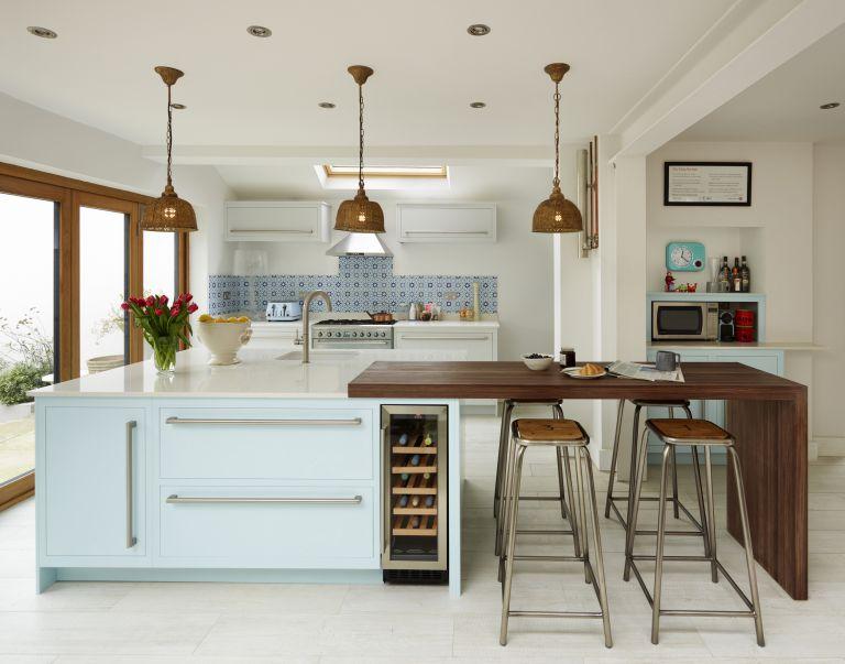

    I know the discussion has moved on a bit, but I managed to get some pics - unfortunately the worktop install has been pushed back till thursday - they forgot to cut one of the holes, and now are sayin

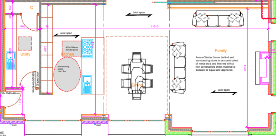

 It's planned so that you walk into the kitchen from one side with plates etc, scrape into the bins in the cupboard on the left of the sink, rinse if needed, then load into the dishwasher immediately to the right of the sink. Cups, glasses and crockery can all be put away from the dishwasher without any movement other than bending and pivoting.
I think I get the idea, but a picture/drawing would be helpful!

Here is ours
kitchen_1.thumb.jpg.5b505a69a262a1cf0e9236c6aad3a525.jpgkitchen_2.thumb.jpg.217aa114a424fecd7fb7376c66bc1e2d.jpg
The sink and ovens are on the conventional run of units along the wall.  Turn round when at the sink and you are now looking at the hob.  The other side of the island is a seating area or "breakfast bar"
The bit that is probably not ideal in our layout is the fridge. Next to the fridge where the closk is in this picture is going to be boxed in as a pantry.
It is access to what will be the pantry that makes it essential that this is an island so you can walk past either end of it to get to the fridge or the pantry.  It would be no good as a peninsula from the wall for instance it must be a true island.
At the moment the gap between the wall run of units and the island we think is too big.  It is set to that gap to satisfy Scottish building regs but we are near certain after sogn off the island will be moved a little closer to the sink.

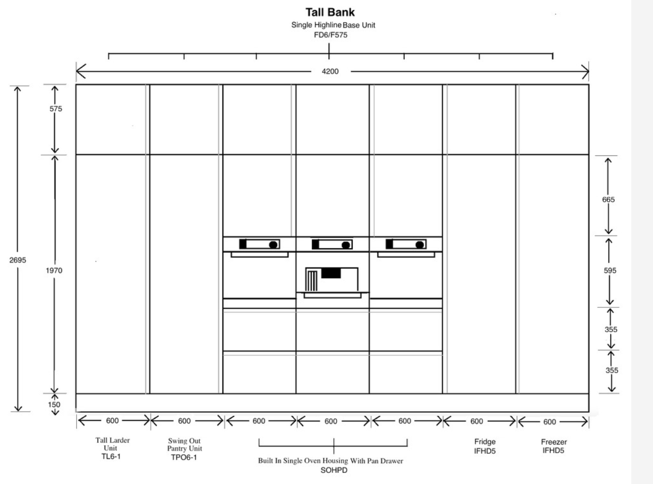

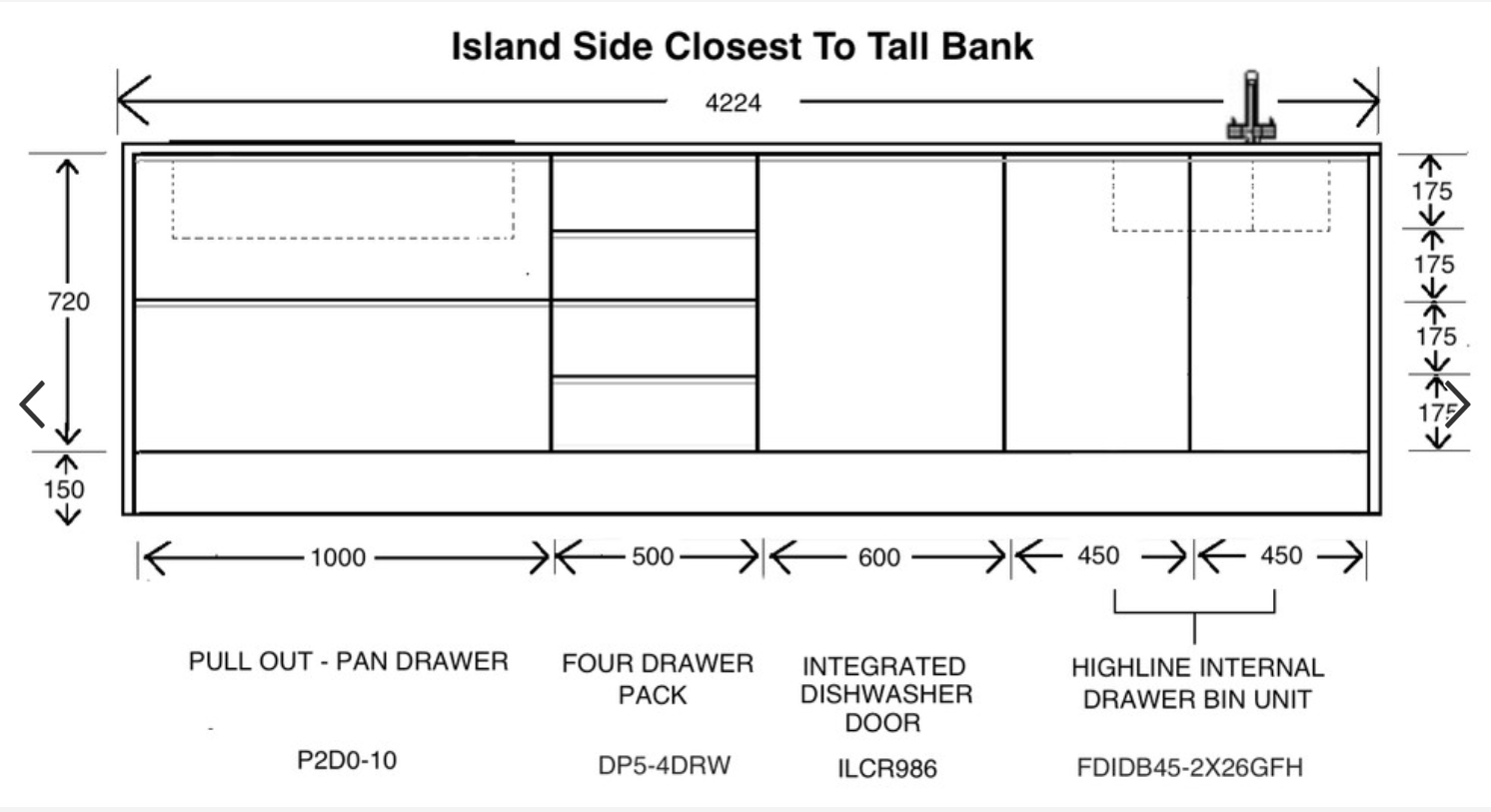

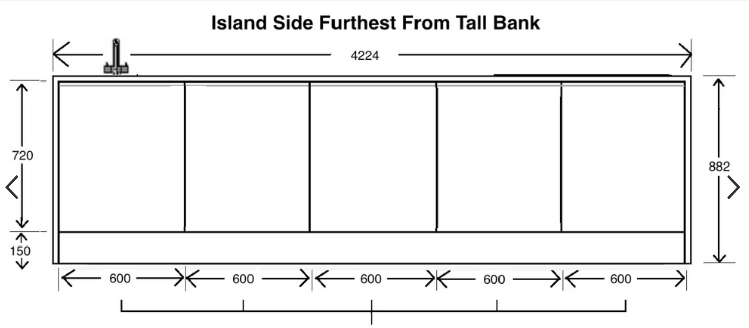

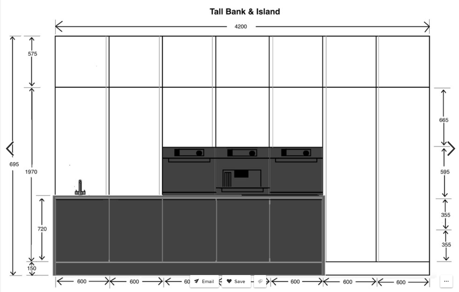

14 hours ago, divorcingjack said:
So we have a massive island in our new kitchen. We thought of it as a "thing" in itself, rather than actually part of the kitchen, although of course it is functional. It is solely drawers, no cupboards at all, and has a prep sink (quite small), quooker tap, hob, waste disposal, and bins
This, I think, is what I'm settling into. You have a larger sink elsewhere I assume?
. Ovens, fridge, freezer and pull out pantries with ingredients are directly behind the island prep area, so you can turn around and take stuff out of the oven without walking all over the kitchen with it.
Good point, freezer I think I'll put in the utility room though. Needs to be nearby but a bit of a space waste to be too local I think
We don't have any other work surface in the kitchen - all the units behind the island are full height against the wall, so we deliberately made the island oversized. There is (controversially) no seating at the island though - we've had it before and found it uncomfortable and not really used. Our dining table and bench seating is next to the island, so we'll use that instead. I love it!
Clearly families need to form habits around what's offered, I can certainly imagine it 'turning out' you would never use certain things... hard to predict sometimes.

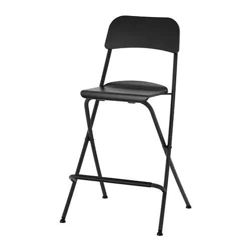

6 hours ago, puntloos said:
I want stools with proper back support. Is this a thing?
I use Ikea Franklin models in a student rental I look after for the family.
Seats are formed ply, they have backs, come in 2 seat heights 63cm and 74cm, and fold. When they are unfolded it clicks with a feeling like a tomb closing in a pyramid ... very solid. There is a footrest.
Cost are £25 or £27 each, and they are in black and white.
The ones I have were put in in about 2012-13, and I am not aware that any have been replaced.
The only wear I have seen has been through the black along the edges where they are grabbed. Easy to repair (boot polish or spray paint).
Recommended - and if you want posho or fashionable ones later then these would be a good interim.
But do go to Ikea and sit on them. The back support may not be right for you.

is it a useful trick for you to sketch out a design of your rooms as separates, then just remove all the walls and see if it feels different? Just leaving a wall out (esp. to separate circulation space) can be a creative move.

Also ignore some of the width dimensions shown on the island drawings, it's not 4224 or 5 * 600, it's 3100 mm.

In terms of food prep there should be room for 2 people to work between the hob and the sink, otherwise there is more space round the other side of the island or at the sides.

Our island is slightly bigger than the floor plan, it's 3100 x 1200 mm, we would have liked to go slightly longer, however 3100 mm is the longest we could get the preferred worktop in.

Also the sink isn't as large as displayed on the floor plan.

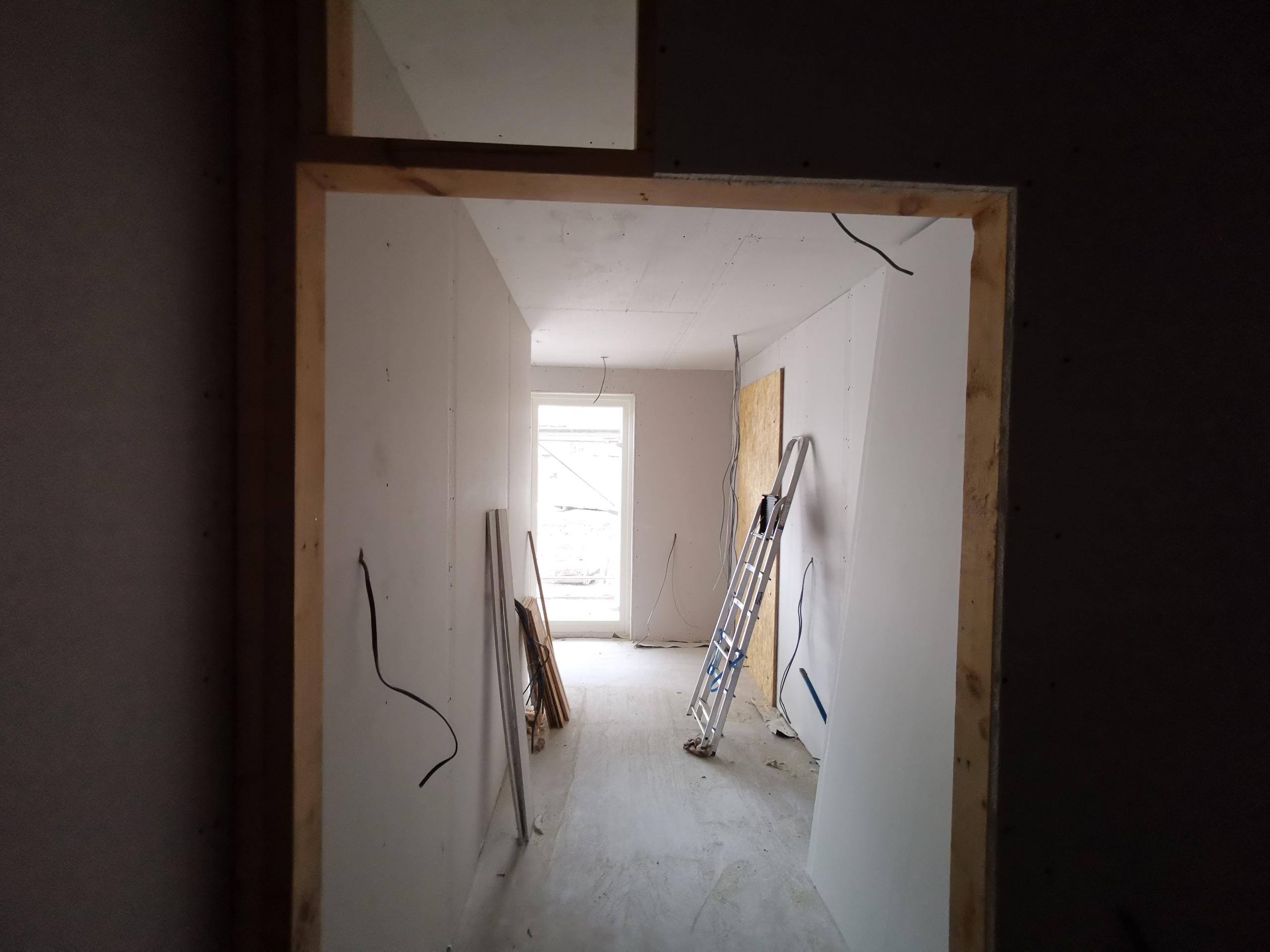

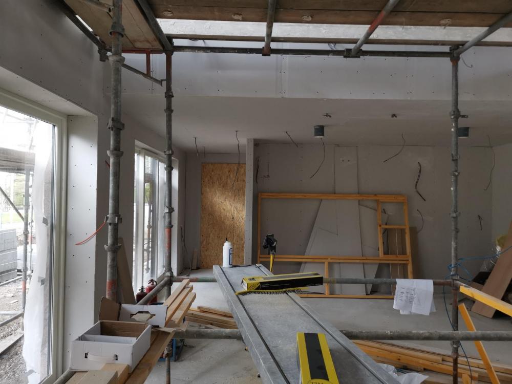

Photo was taken before the end partition was erected. The door will be positioned to the left, meaning there will still be lots of natural light.
Also I took this photo standing inside the 1200 mm deep cupboard.
