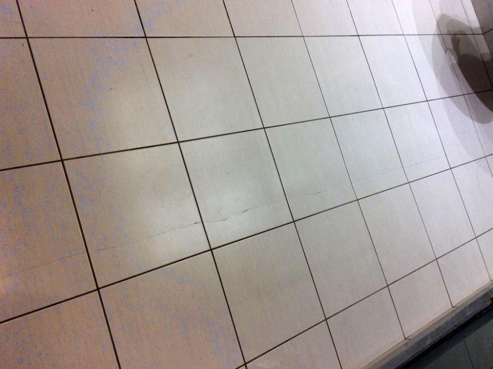

Ferdinand Posted April 14, 2019 Share Posted April 14, 2019 (edited) This is an attempt to compile a list of small errors that are large problems to sort out later. Though perhaps we need to be thinking about "deep" errors as well as small ones. It has been inspired by my current need to replace both bathroom floors from what seem to be minor mistakes 10-12 years ago by the self-builder who added a top storey to thsi bungalow. Ferdinand Edited April 14, 2019 by Ferdinand Link to comment Share on other sites More sharing options...
Ferdinand Posted April 14, 2019 Author Share Posted April 14, 2019 (edited) Cause: Probably either using a non-flexible tile adhesive in a room with ufh (bath 1 and 2), and/or using 8x4 sheets of chipboard for the subfloor rather than tongue-and-groove (bath 2). Relatively minor mistakes 10-12 years ago by the self-builder who added a top storey to this bungalow. Consequence 10 years later - significant contributer to need for 2 new bathrooms. Bathroom 1 - movement and grout deterioration. Bathroom 2: Tiles cracking on an 8x4 grid, exasperated (maybe) by ufh only being over part of the floor increasing differential movement Thought: Skimp on the stuff you can see, not the stuff you can't see. And save on the deal, not the quality. Edited April 14, 2019 by Ferdinand Link to comment Share on other sites More sharing options...
Jeremy Harris Posted April 14, 2019 Share Posted April 14, 2019 Good illustrations of a point that @Nickfromwales has emphasised a few times, that tiles laid on a boarded floor need a layer of glued and very well screwed marine ply fixed to the floor, to reduce the risk of movement. I glued and screwed 9mm marine ply to both our upstairs bathroom floors, making sure that the ply joints were well staggered away from the underlying flooring joints. This seems to make for a very solid floor, but I did use lots of PU adhesive and hundreds of screws, just to be sure as I could that it wouldn't flex, as our flooring up there is 600 x 400 travertine, which needs good support. 1 Link to comment Share on other sites More sharing options...

ProDave Posted April 14, 2019 Share Posted April 14, 2019 The floor tile thing. Due to complete ignorance, at the last house, I stuck floor tiles direct to ordinary P5 chipboard with UFH. 15 years later they are all still intact, no cracking, no loose tiles, no hollow sounding tiles, not even a crack in the grout lines. Topps tiles must have saved the day by selling us a "flexible" tile adhesive that made them work when everyone says they should not. Link to comment Share on other sites More sharing options...
Ferdinand Posted April 14, 2019 Author Share Posted April 14, 2019 (edited) 3 minutes ago, ProDave said: The floor tile thing. Due to complete ignorance, at the last house, I stuck floor tiles direct to ordinary P5 chipboard with UFH. 15 years later they are all still intact, no cracking, no loose tiles, no hollow sounding tiles, not even a crack in the grout lines. Topps tiles must have saved the day by selling us a "flexible" tile adhesive that made them work when everyone says they should not. I guess that the bathroom humidity might be an aggravating factor? Edited April 14, 2019 by Ferdinand Link to comment Share on other sites More sharing options...

newhome Posted April 14, 2019 Share Posted April 14, 2019 32 minutes ago, ProDave said: The floor tile thing. Due to complete ignorance, at the last house, I stuck floor tiles direct to ordinary P5 chipboard with UFH. 15 years later they are all still intact, no cracking, no loose tiles, no hollow sounding tiles, not even a crack in the grout lines. Topps tiles must have saved the day by selling us a "flexible" tile adhesive that made them work when everyone says they should not. Mine is flexible adhesive and all 5 bathrooms upstairs are done the same but it's the 2 largest ones that are starting to show the issue (one more than the other). That may be to do with the size of the floor area or as @Ferdinand says the humidity as those are the 2 bathrooms I use. I don't use the others unless I have visitors. It's not too bad just now but I can see the grout cracking and feel them moving a bit where that is happening so I imagine it will only get worse TBH. Link to comment Share on other sites More sharing options...
