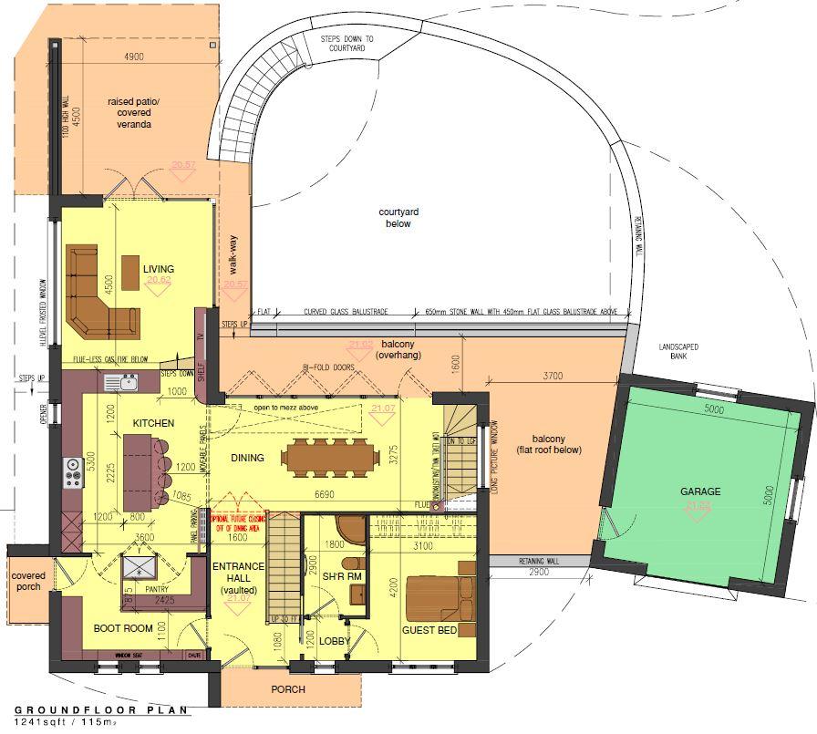

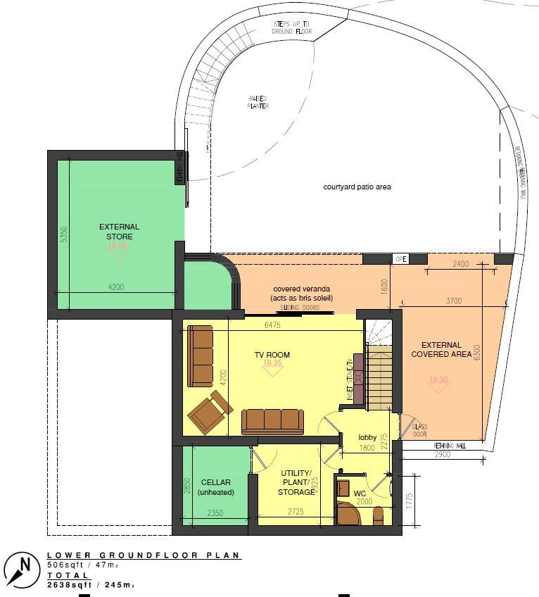

Conor Posted April 3, 2019 Author Posted April 3, 2019 Planning drawings attached. We'll likely make the basement same as the main floor area as it'll simplify construction- esp if using a raft. Will also raise ground level up a bit at rear and lose sliders and all the expensive balconies. Ground floor, we'll be flipping the kitchen to the outshoot, living to where the dining is and dining to where the kitchen is. A few other things changing as well, moving stairs, losing the laundry space etc etc. Not had the heart to tell the architect just yet....

Conor Posted April 3, 2019 Author Posted April 3, 2019 8 minutes ago, jack said: Welcome to BuildHub. Before going any further, take a look at the definition of acceptable overheating in PHPP. It actually allows for quite a lot of time spent at uncomfortable temperatures in my opinion. You can reduce the values - both the temperature defined as overheating, and amount of time you're willing to accept - in PHPP. I'd start by halving the number of hours, and knocking at least a degree or two off the overheating temp. You might be surprised by the results. Cheers. From memory it was set at 25c. I'll go back to architect when we're making our other changes. Now to me, that's too warm. To my partner, that's just at the point where she no longer has to wear a wool jumper! 1

Conor Posted April 4, 2019 Author Posted April 4, 2019 14 hours ago, Bitpipe said: Beautiful house - not too dis-similar to ours in terms of aesthetic but our basement is fully enclosed and not a curve in sight Echo everything above, 22 is our steady state temp (passive house) in SE England. That is t-shirt temp. My advice is to plan for external motorised shutters on east and roof glazing and south if possible - makes a huge difference to overheating. Consider RAL 7012 (Basalt Grey) as a less harsh grey than the standard anthracite (7016) - goes great with white render. Think we will be enclosing the rear of the basement at least partially. Going off the idea of having living and kitchen elevated above garden. Think it will also come in cheaper as we'd be losing a sliding door and a bit less material to depose of... But would lose the under balcony storage areas. Decisions! Agree with the colours... Will be a lighter grey than shown. Render will be an off-white.
