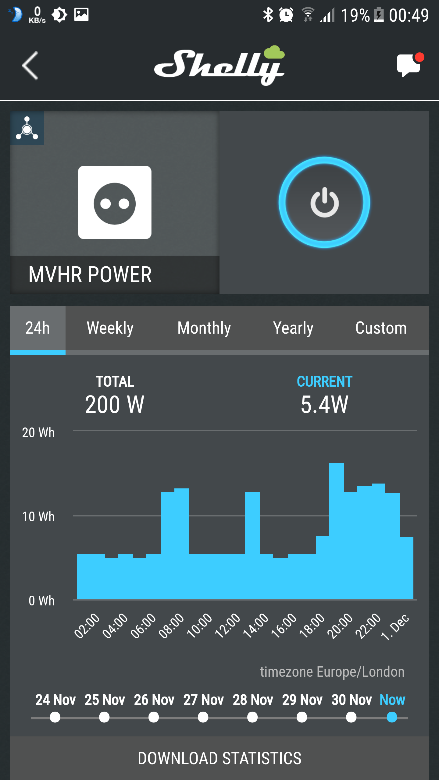

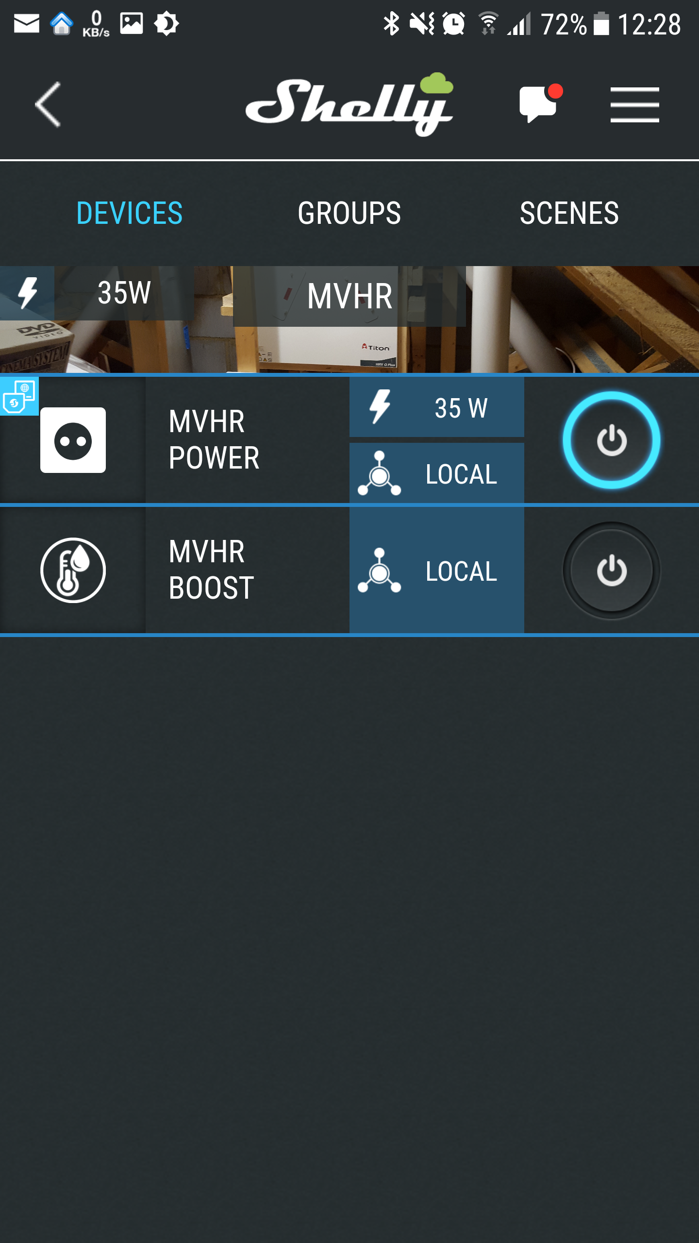

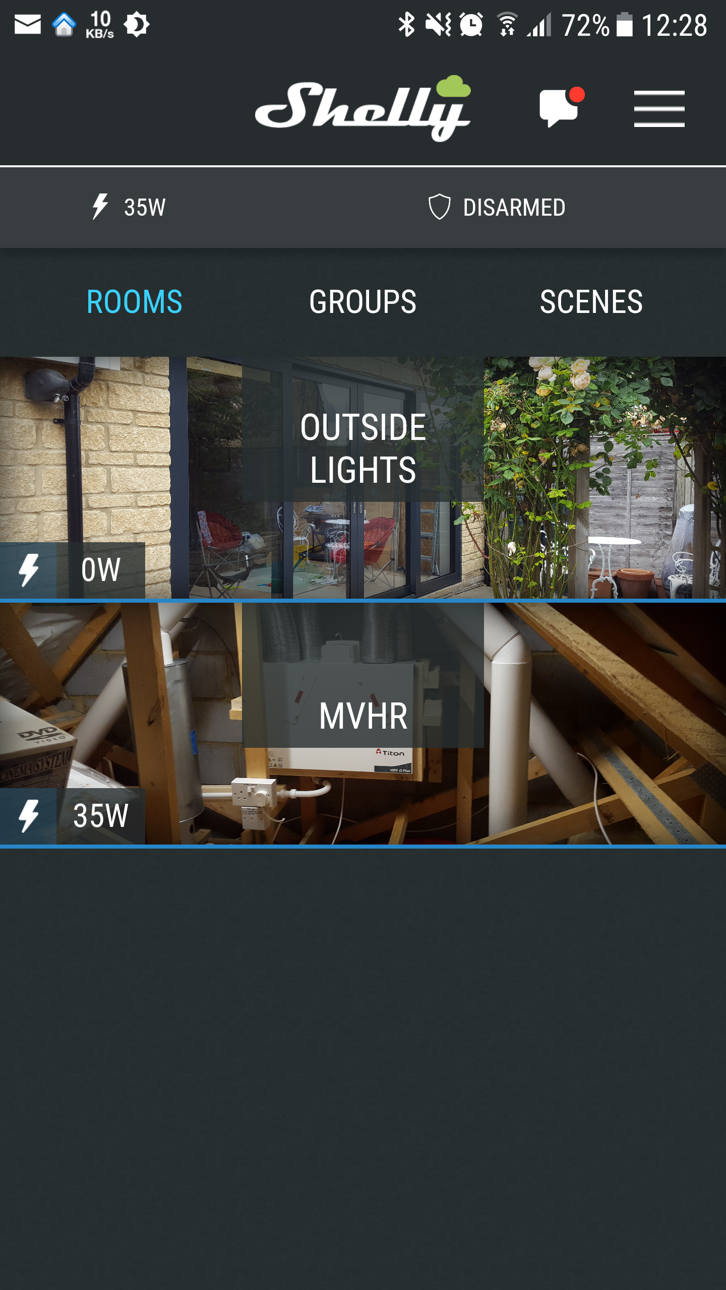

MJNewton Posted December 17, 2019 Posted December 17, 2019 (edited) On 26/03/2019 at 15:27, PeterW said: There is a school of thought that MVHR should have a smoke alarm trigger to shut the system down in the event of a fire - I’d suggest this is a good idea [...] Not wanting to divert the thread, but I've just done exactly this with an Aico smoke alarm relay base and Shelly 1PM smart relay and have been very pleased with the result. Not only does the power to the MVHR get cut in the event of the smoke alarms going off but it also send me an SMS and app alerts within a few seconds to say this has happened. Furthermore, with the smart relay being 'in series' with the power supply it logs power consumption which will be of interest over time (well, to me as I like stats and graphs!): I do wonder how I'll react if I ever get that text! Edited December 17, 2019 by MJNewton
jamiehamy Posted December 17, 2019 Posted December 17, 2019 27 minutes ago, MJNewton said: Not wanting to divert the thread, but I've just done exactly this with an Aico smoke alarm relay base and Shelly 1PM smart relay and have been very pleased with the result. Not only does the power to the MVHR get cut in the event of the smoke alarms going off but it also send me an SMS and app alerts within a few seconds to say this has happened. Furthermore, with the smart relay being 'in series' with the power supply it logs power consumption which will be of interest over time (well, to me as I like stats and graphs!): I do wonder how I'll react if I ever get that text! If I mess up in the kitchen (which doesn't have an opening window) and the smoke alarm goes off, I switch the boost on which usually sorts it very quickly. If the mhrv switched off in those scenarios, we'd a bit stuck! I'd def like to see the consumption tho, very smart.

MJNewton Posted December 17, 2019 Posted December 17, 2019 (edited) The Shelly is dependent on wifi for external access, however the use of the Internet is optional as it has its own built-in web server that can be accessed on the local WLAN (or directly if set up as an access point), and use of the cloud can be disabled entirely. Simple functions like controlling power output based on a physical trigger input, time-based schedules, overtemperature/overcurrent etc are performed locally and don't have any external dependencies (other than to configure them in the first place). For text alerts (and, I think, app alerts) an Internet connection is required. Edited December 17, 2019 by MJNewton

MJNewton Posted December 18, 2019 Posted December 18, 2019 Something important to add - you mentioned about running on 12v so please note the non-intuitive (to me at least) wiring schematic for DC operation that requires + to the 'N' terminal and - to 'L'.
