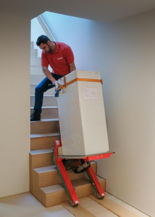

oranjeboom Posted June 28, 2020 Posted June 28, 2020 On 28/06/2020 at 09:30, Marco Van Bowden said: One thing I saw, but confess I overlooked, was weight. OMG! That's a ground floor based install for sure isn't it? No first floor, or basement stuff there Expand Yes, the buggers weigh a lot but people have been able to haul them up the stairs like @Jeremy Harris (not a 12Kw one though). Other installs have been able to use specialist stair lifters: And I put my units on wheels in case of future needs to move: So I wouldn't discount Sunamp purely on weight - there are workarounds!
