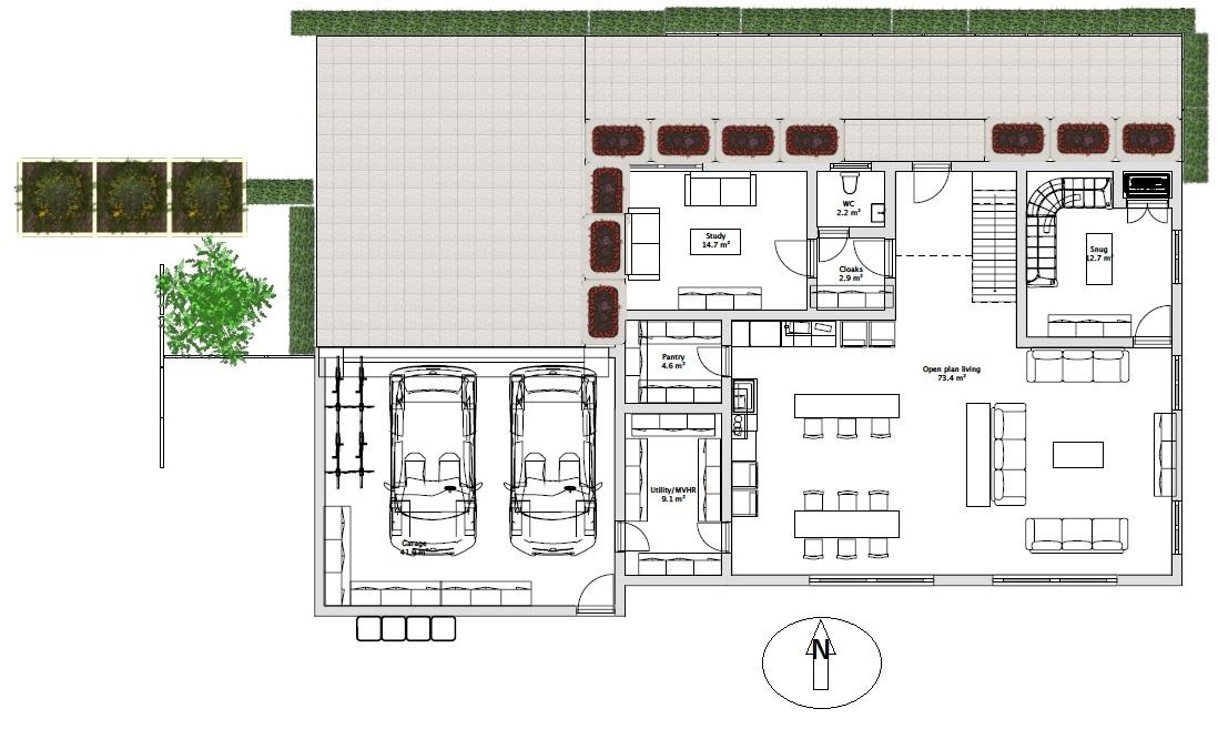

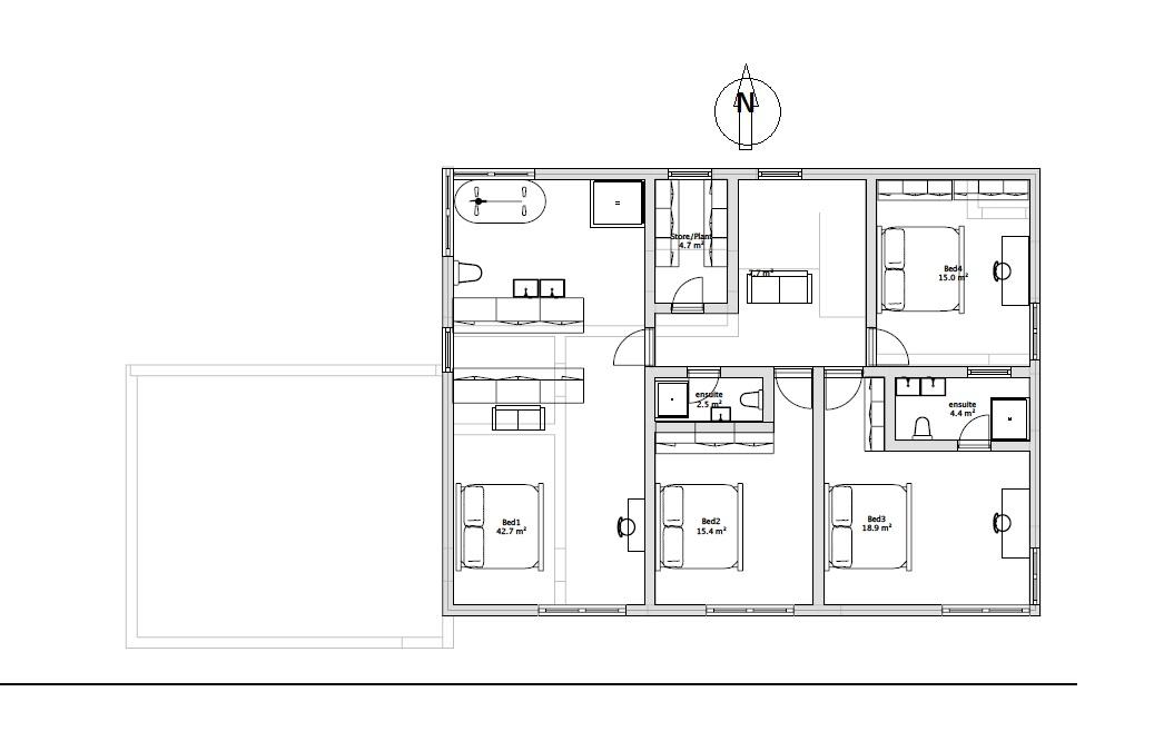

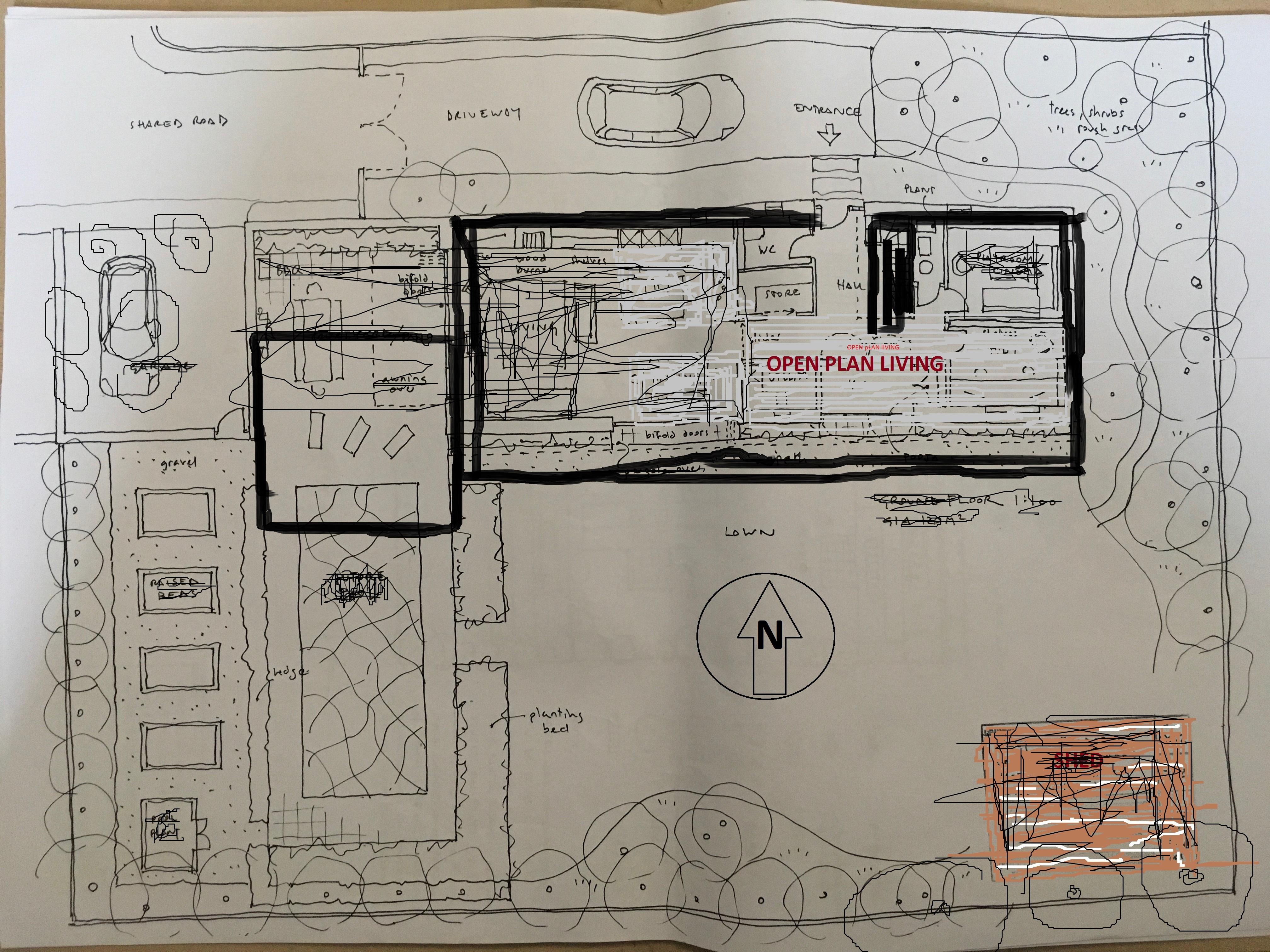

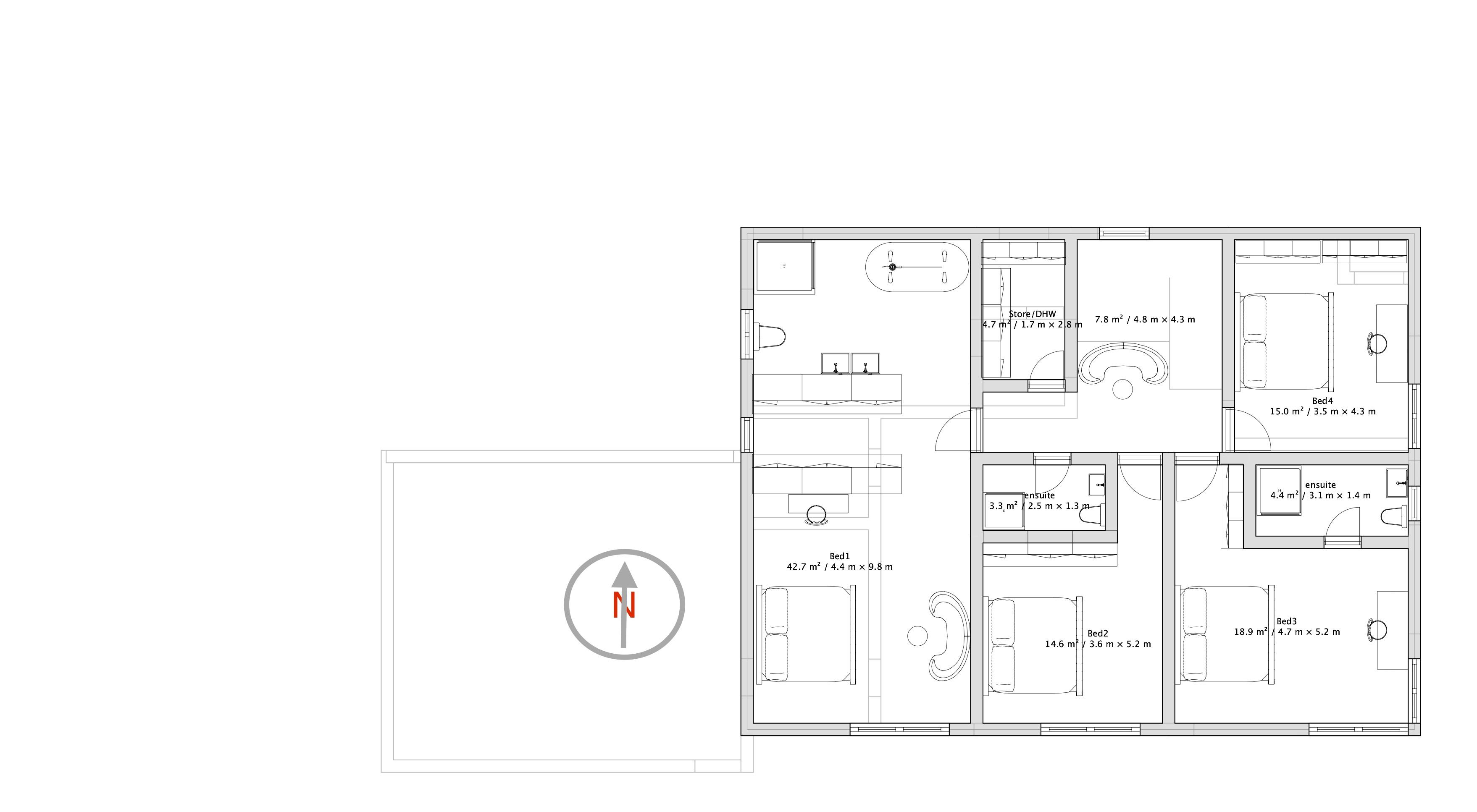

vk108 Posted February 21, 2019 Posted February 21, 2019 Hi, We are planning Passive house standard but not going for certification. Site is south orientated with tall trees of 20 meters around 16 meters from South boundary. I have made some DIY house plans using My Home 3D pro. Please advice if any changes required as I am applying for detailed planning soon. This is my first self build and planning for Timberframe supplier for a speedy build. House Gross Area 13m*10m and Garage being 7m*6m. Feel free to express yourself either good or bad, I don't mind to be honest

ultramods Posted February 21, 2019 Posted February 21, 2019 Can you add the room dimensions to the plans please? Also try and get the images slightly higher quality
bassanclan Posted February 21, 2019 Posted February 21, 2019 My initial thoughts are you would want your soil pipes etc to be near each other and not coming down in the middle of your open plan kitchen. Clocks is a bad pinch point and you'd struggle with disabled access into the wc

AliG Posted February 21, 2019 Posted February 21, 2019 (edited) The basics of the design and room layout seem good. There is little I would change. Most charges are detail. This may be the first time ever I have seen a house with too may cupboards. You seem to have marked up the plan with fitted cupboards everywhere. This will be very very expensive. Ex the kitchen and wardrobes you probably have something like £30,000 of fitted cupboards there. Wardrobes in spare rooms are probably better built from plasterboard with doors not fitted furniture unless you really like the look of it. Changes to consider - 1.The cloaks area outside the WC should not have a door as this will turn it into a dark small space, use an arch. or just leave it open As mentioned WC may not meet disabled access requirements, you need room for a downstairs shower. 2. The door to the snug is in an odd place in the corner of the sitting area, it would be better at the end of the stairs. The cupboards in the snug seem unneccessary. 3.The kitchen design with equipment split across two legs and an island in between will be awkward. It would probably be better to turn the island and table round 90 degrees and keep all your equipment on the island and one wall. Put the hob in the island looking into the room, not at a wall. 4. My wife wanted a pantry and I know some people love them, but we get all the dried food we have in the house in one cupboard in the kitchen. Not quite sure what you would use so many cupboards for. 5. Utility/MVHR space is fine, but you are going to have an area with lots of unsightly pipes, valves, pumps etc. It might be better to put this in a totally empty space and have a smaller space with cupboards and a sink as the actual utility. You might make the pantry smaller and create three separate spaces. 6. The upstairs plant room might be better as a washroom and bedding/towel storage. Put cupboards all the way along one side and across the end, it will be easier to use than the current set up. 7. One ensuite appears to have a window to another room, I assume that is an error. Put the shower across the end of the room and WC/sink next to each other not opposite each other as it is much more spacious. Put the shower on the inside and the WC at the outside wall so the stack can go down the corner of a downstairs room. 8. I assume that the other en suite is actually a shower room, it is quite small, I would make the bedroom a little narrower and give the space to the room. As mentioned it is not ideal for plumbing as it is in the middle above the kitchen. 9. Is there a view in the master en suite? Is it exposed? I wouldn't want to be on display when I stand up in the bath. I would have a larger shower, in general get a bathroom place to design these places for you. Edited February 21, 2019 by AliG

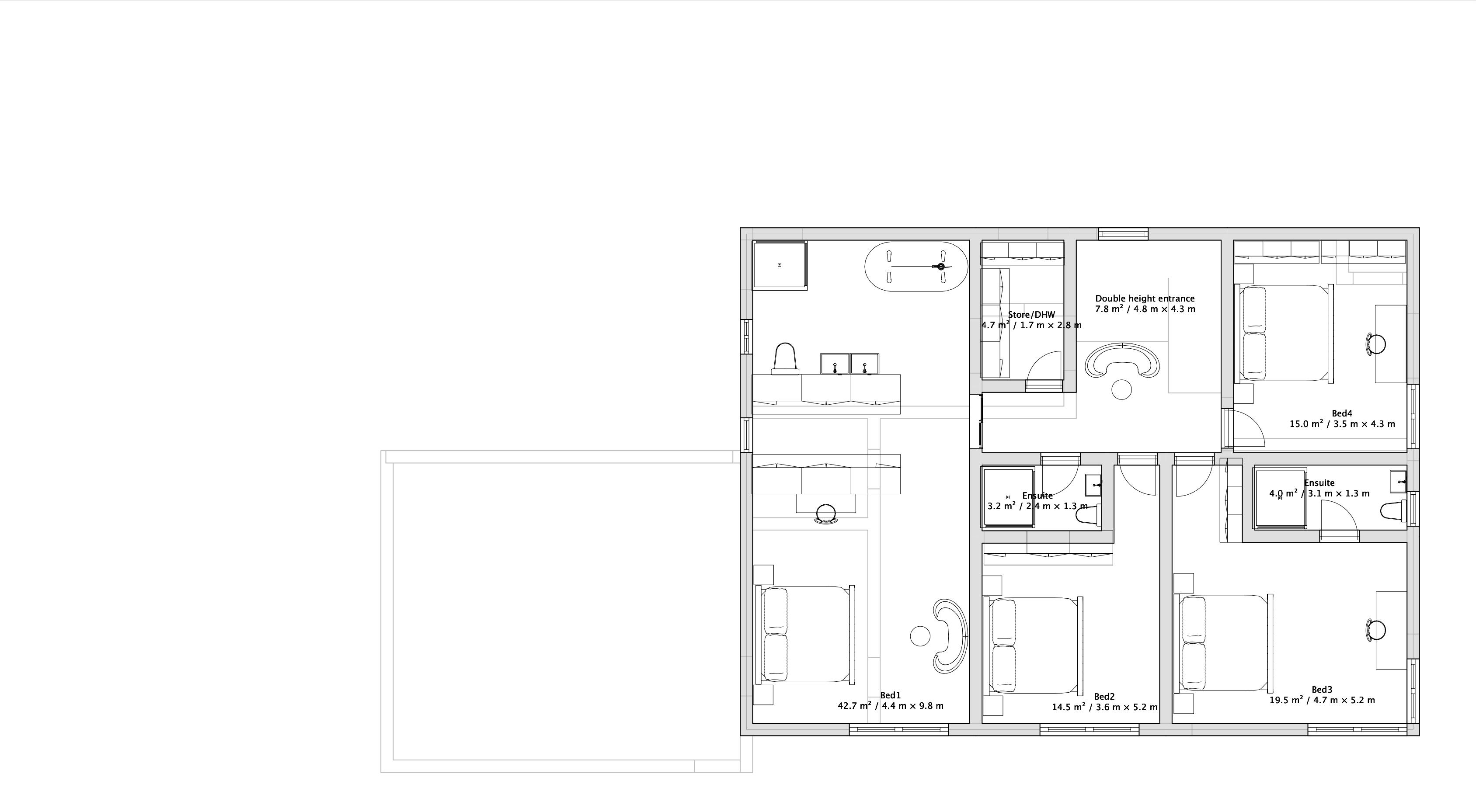

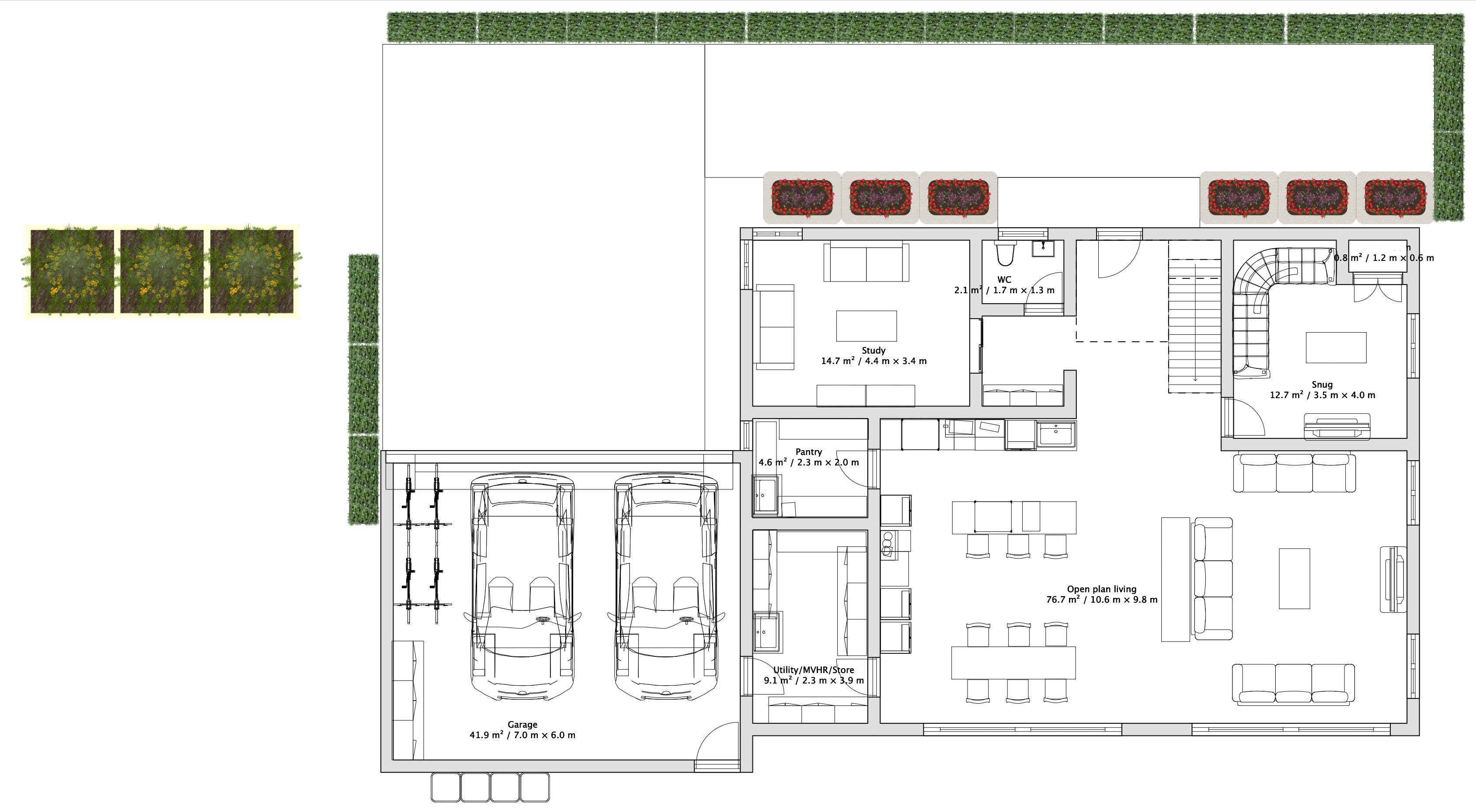

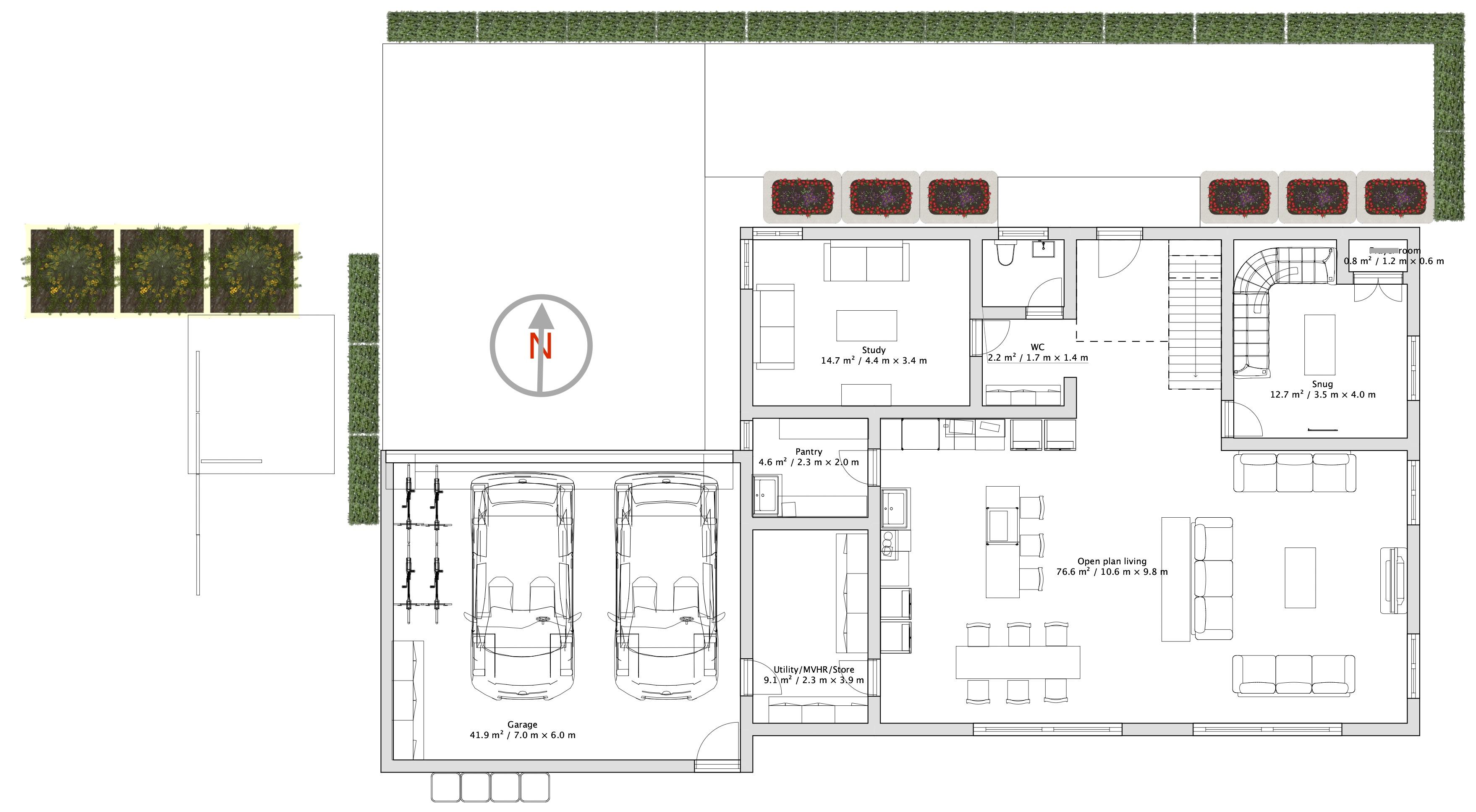

vk108 Posted February 22, 2019 Author Posted February 22, 2019 Hi All, I really appreciated your feedback and was really helpful. Please find the updated plans with room measurements. Views and Garden are towards South east so windows orientated mainly south and SouthEast. I am going for near passive house due to some personal circumstances. any help with passive house principles will be helpful like summer over heating. I will be project managing myself using mostly subbies by using TF supplier for main shell erection. To be honest I am on modest budget not like grand designs. Just need a well designed home with fabric first approach and to reduce my mortgage payments. any further feedback really appreciated.
ProDave Posted February 22, 2019 Posted February 22, 2019 Bedroom 2 en-suite appears to be accessed from the landing? No familly bathroom upstairs unless Bed 2 en-suite is supposed to be it? What is the little room in the snug with it's name crossed out all about?

AliG Posted February 22, 2019 Posted February 22, 2019 Thanks for the extra info. If you are on a budget, I would be definitely building standard wardrobes not fitted furniture, I don't know if that is just the way you have shown them. I would keep the sink in the utility room to wash your hands etc if you are working in the garden. You have tended to show doors hard in the corner of rooms, usually they need to be a little way out to allow for the frame and architrave. I am no structural engineer, but you have an area in the centre of the house where you will maybe need steel across between the study and the snug to support the upper floor joists. If the door to the snug is opposite the corner where you would support the steel you will maybe have an issue. Also you have a considerable number of stud walls above the centre of the kitchen, I don't know if this will have issues in terms of supporting them below. The first step on the stairs is also maybe too near to the front wall. I would get a kitchen designer to look at the kitchen for you. There are quite a few things you could do, for example moving the utility and pantry doors to the ends of the wall so you can have a single longer run of units. Are you planning on just giving your design to a TF company? I think you should maybe pay an architectural technician to look it over first.

Mr Punter Posted February 22, 2019 Posted February 22, 2019 Any chance of a large porch to: A) stop all the heat escaping when your groceries are delivered / someone is at the door and you need to communicate but not let them in B) give those in the kitchen / living / upstairs landing some privacy from anyone calling or entering
vk108 Posted February 22, 2019 Author Posted February 22, 2019 little room in the snug is a meditation and yoga room.... These days meditation making me feel bit better after 4 long years with Outline planning and Site purchase saga. Still yet to go for detailed planning and start construction so I need another 3 years of strong will power it seems. Sometimes I feel like I cant do this any more. But I never give up on anything easily I hope I can do it.. With regard to wardrobes I have good experience fitting Ikea. It's just a case of fitting wardrobes as and when money and time permits. My biggest worry is at the moment detailed planning and getting the build to completion stage and make it habitable for family.

PeterW Posted February 23, 2019 Posted February 23, 2019 17 hours ago, vk108 said: little room in the snug is a meditation and yoga room.... I applaud you putting that in but unless you’re going to isolate it from the rest of the house, it will be anything but tranquil. Taking what @Ferdinand has said, put a separate room in the garden for this away from the house - somewhere you can take time to be. Decent garden rooms are not expensive and if you’ve got a TF company doing your house, 4 extra panels and a roof aren’t going to be much more. I’d consider how you can then use that space as a hobby room, or just as somewhere to escape to.
PeterW Posted February 23, 2019 Posted February 23, 2019 One last observation - move the door / wall into the master bed back into the hallway by 8-900mm. It means the door opens into an alcove in and not into someone’s face as they walk from the en-suite to the bedroom ...
TerryE Posted February 23, 2019 Posted February 23, 2019 I can't understand the reason for the large northeast facing window in the bathroom. It seems like a peepers chartered to me: lot of cost, a loss of privacy, and for a little extra benefit. You seem to have more light in the bathroom than most of the rooms. I suggest you lose the corner window and stick with a standard window on one of the walls. I know that some of the posters here have advocated the benefits of using an architect. Others including myself and @JSHarris found using an architect technician as more flexible and cost-effective. You seem to have very clear idea of the architectural drivers for your house so I'm personally qnot sure what an architect would add. As to the master bedroom another alternative is to have an outward opening door. This would save the cost of creating the alcove.

vk108 Posted February 25, 2019 Author Posted February 25, 2019 (edited) Hi All, I really appreciate all your inputs and really thankful to everyone.. Basically I am going for passive solar gain having large windows on South and minimal glazing on North. I had some windows on East because it has got nice big garden and wood land views towards South East One of the reasons we have chosen Passive house because We have a noisy road on north boundary 100 meters away and looking healthy, comfortable environment Could you please provide any tips on how to avoid summer over heating either using overhangs on South glazing and shutters on east side windows in Ground floor Open plan living 2 windows 4m*2m I am going for standard size windows on First Floor unlike Ground Floor Looking MVHR design tips issues as well, like best place to have ducting and any noise issues Reducing noise issues with en suite bathrooms I have tall thirsty row of Poplars on South boundary of around 14 meters away from House foot print and being in clay soil, Foundations is going to be a big challenge. Just checking about Raft, Screw Piles or Helical Piles or Basement which ever is cheapest. Is it better to engage Structural Engineer and Building Regs Inspector now or is it ok to wait till we get planning for approved layout plans. I am definitely going for TF supplier, I think they provide SE calculations for Foundations and Shell house, any advice appreciated I am planning to dwell into sections, elevations and aesthetics once floor plans finalized. Edited February 25, 2019 by vk108 updated correct jpeg
