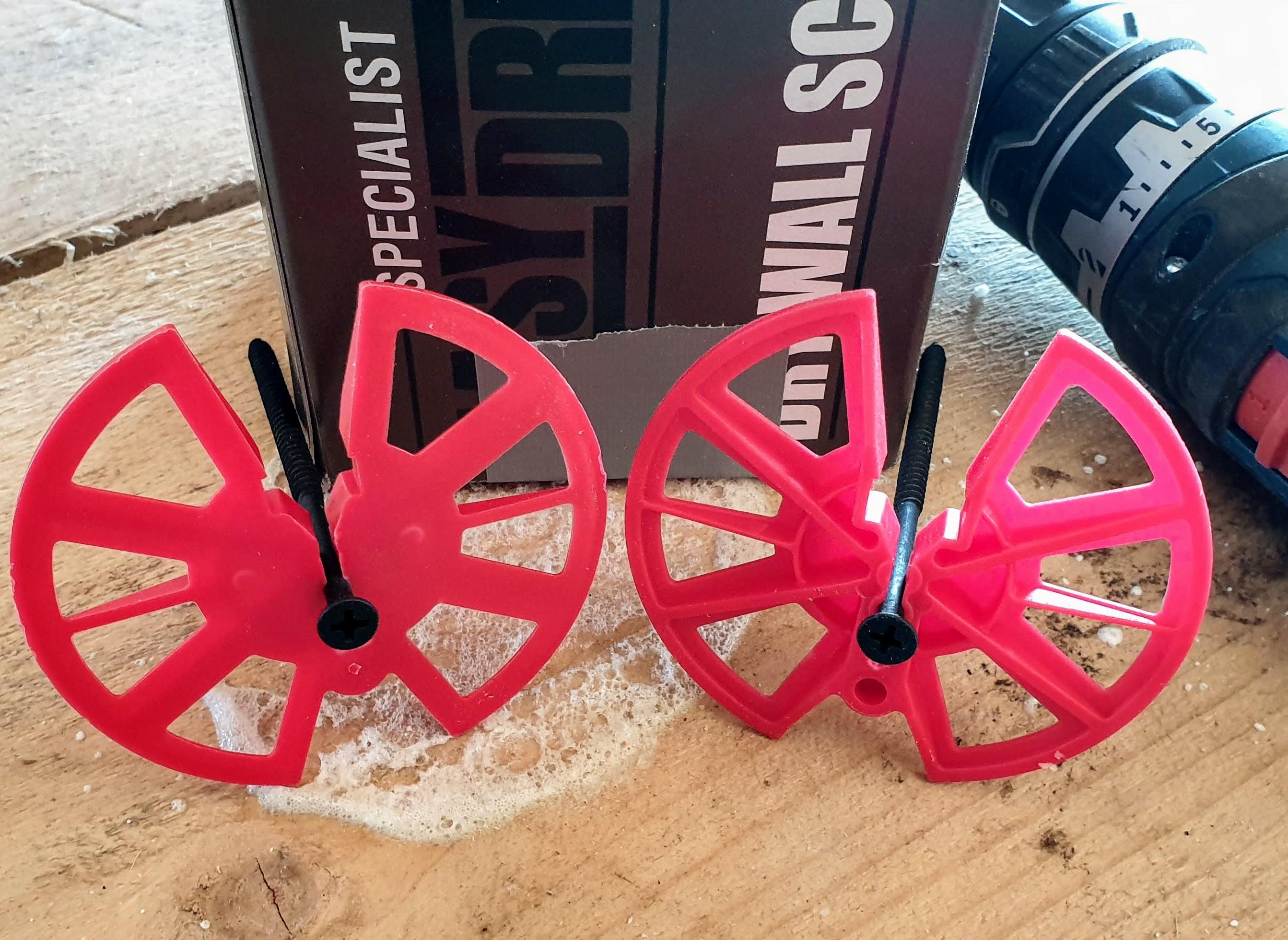

ToughButterCup Posted February 11, 2019 Posted February 11, 2019 I'm putting 70mm of insulation under my joists. Using 100mm screws and insulation washers. Pesky little things insulation washers; they don't tell you which way round to attach them ..... Wrinkly side-up or smooth side up? Theres a bit of me which thinks that I should have the smooth side uppermost. But you know me and thinking about stuff. Too much too often. Does it even matter?
nod Posted February 11, 2019 Posted February 11, 2019 6 minutes ago, recoveringacademic said: I'm putting 70mm of insulation under my joists. Using 100mm screws and insulation washers. Pesky little things insulation washers; they don't tell you which way round to attach them ..... Wrinkly side-up or smooth side up? Theres a bit of me which thinks that I should have the smooth side uppermost. But you know me and thinking about stuff. Too much too often. Does it even matter? One on the right
ToughButterCup Posted February 11, 2019 Author Posted February 11, 2019 5 minutes ago, nod said: One on the right Ok.... erm, why Gary? (sorry mate)
nod Posted February 11, 2019 Posted February 11, 2019 1 hour ago, recoveringacademic said: Ok.... erm, why Gary? (sorry mate) Normally the flat side Against the insulation I don’t supose it would matter The left one would dig into the insulation when you knock it on
Mr Punter Posted February 11, 2019 Posted February 11, 2019 The one on the left. You want it so it sits flush and the screw is a bit into the insulation as if the screws are left proud the plasterboard may not sit flat. 1
ProDave Posted February 11, 2019 Posted February 11, 2019 Another vote for the one on the left, it is designed to bite into the insulation.
scottishjohn Posted February 11, 2019 Posted February 11, 2019 (edited) left one - -how you fitting drywall on top of this ? direct with screws or batons ? maybe make sure your drywall fixings don,t clash with theses fixings fixings done like left one could break the foil on insulation ? Edited February 11, 2019 by scottishjohn
Declan52 Posted February 11, 2019 Posted February 11, 2019 Won't really matter as your going to have to screw it in far enough that it breaks the foil slightly so it sits flush or you will have bumps in the plasterboard. If you are going to batten over it then and board then it won't need to bust the foil.

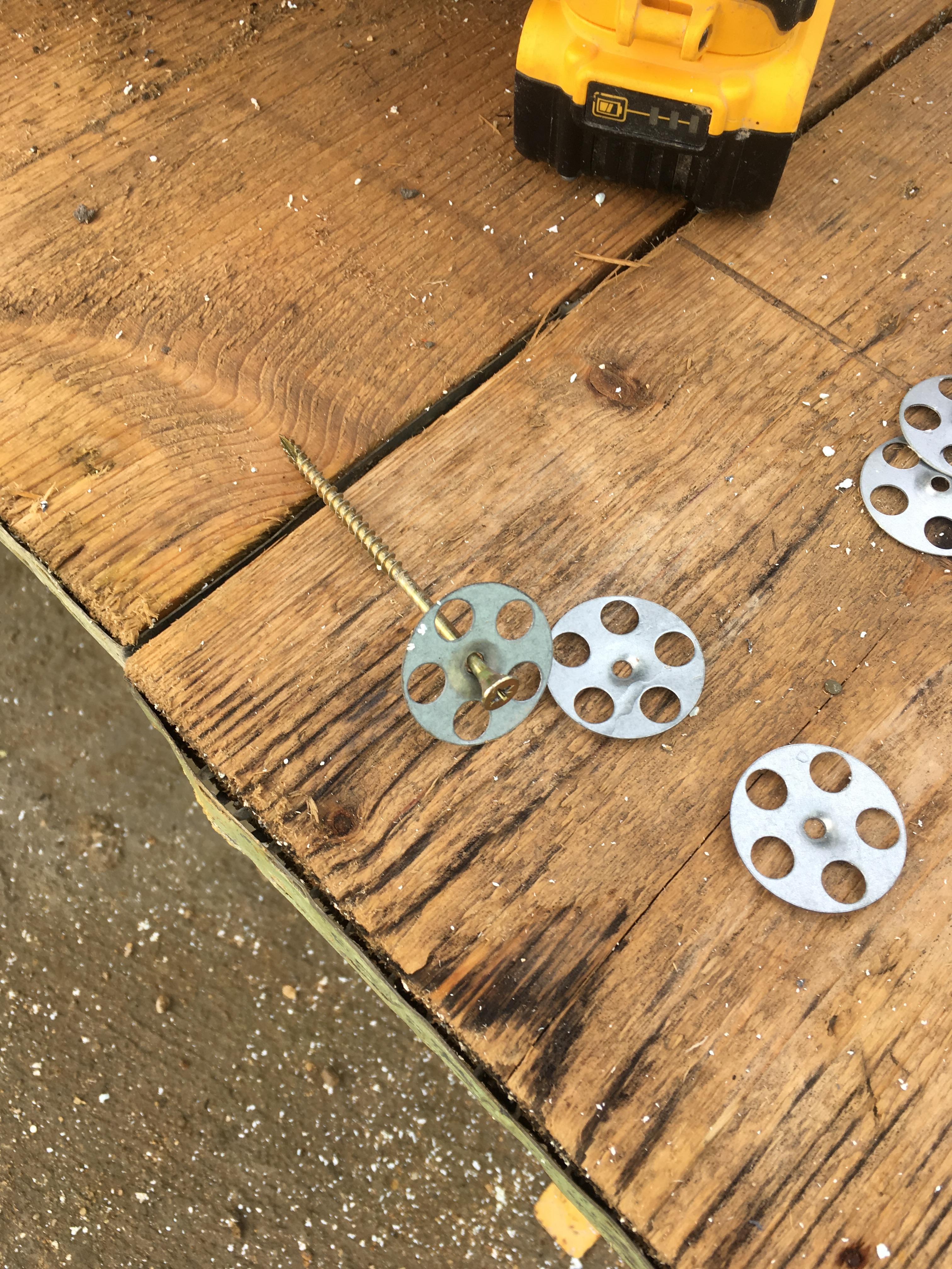

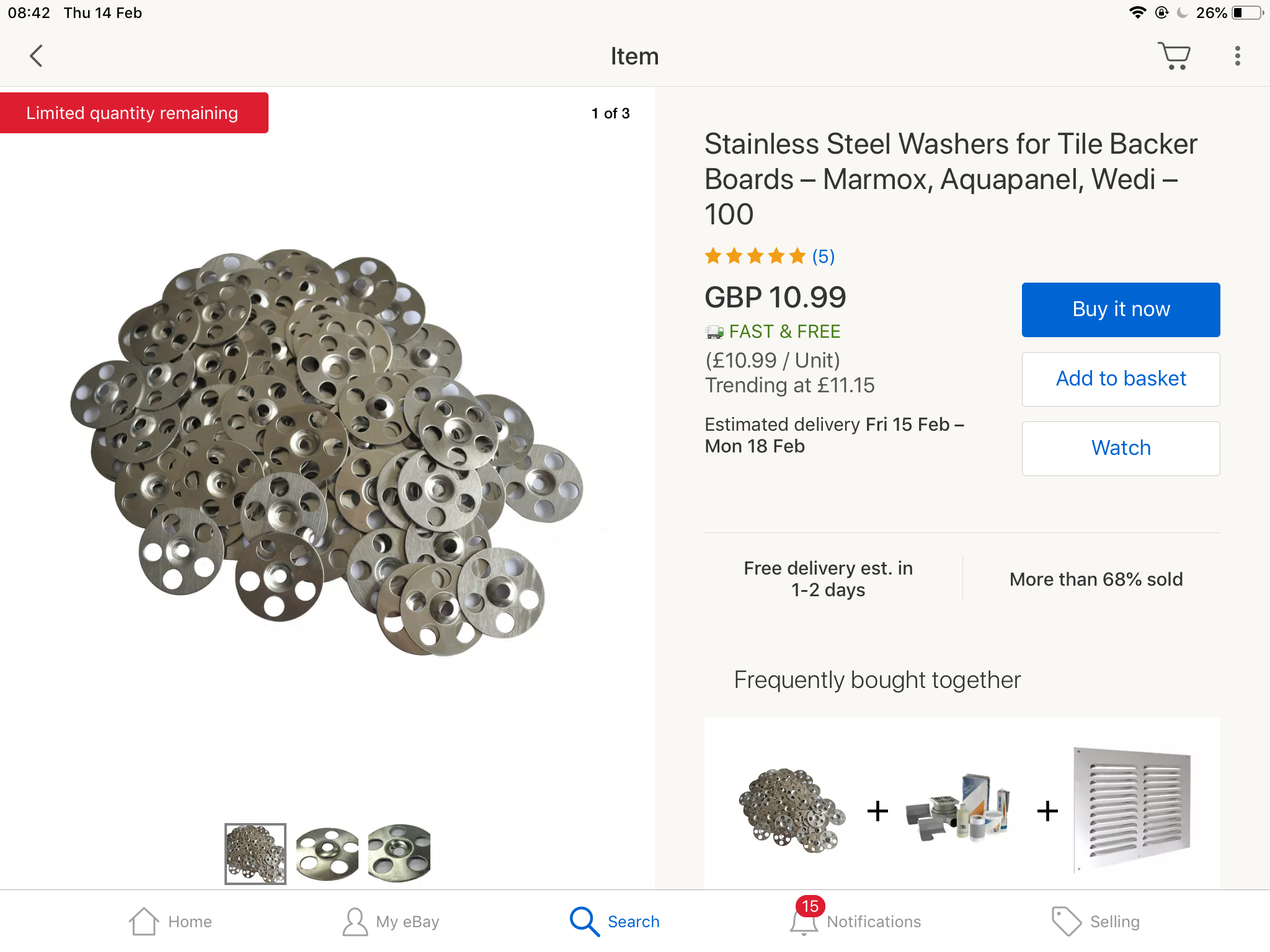

Russell griffiths Posted February 14, 2019 Posted February 14, 2019 @recoveringacademicJust a thought, if you run out of those dreadful plastic things buy some of these instead loads better, sit flatter, don’t damage face of insulation so much.
scottishjohn Posted February 14, 2019 Posted February 14, 2019 (edited) On 11/02/2019 at 16:11, Construction Channel said: Assuming you are battening. (I would. So I could use an auto feed gun for plasterboard) I can't see it would matter which way round. Just put a couple in per board and let the battens hold the sheets up properly. Also battens would allow a service void for all your lighting cables. (unless of course they already have a route) fixing batons will be interesting as the fixings screws will need to be very very long 70mm foam +50mm baton=120mm + fixing in rafters =150mm+ ? sorry, re read 70mm insulation --sure in another post you said 80mm insulation --still a very long screws Edited February 14, 2019 by scottishjohn
Onoff Posted February 14, 2019 Posted February 14, 2019 55 minutes ago, Russell griffiths said: @recoveringacademicJust a thought, if you run out of those dreadful plastic things buy some of these instead loads better, sit flatter, don’t damage face of insulation so much. Got a link? What are they called? ...other than "the blades from my old Mum's mincing machine"?

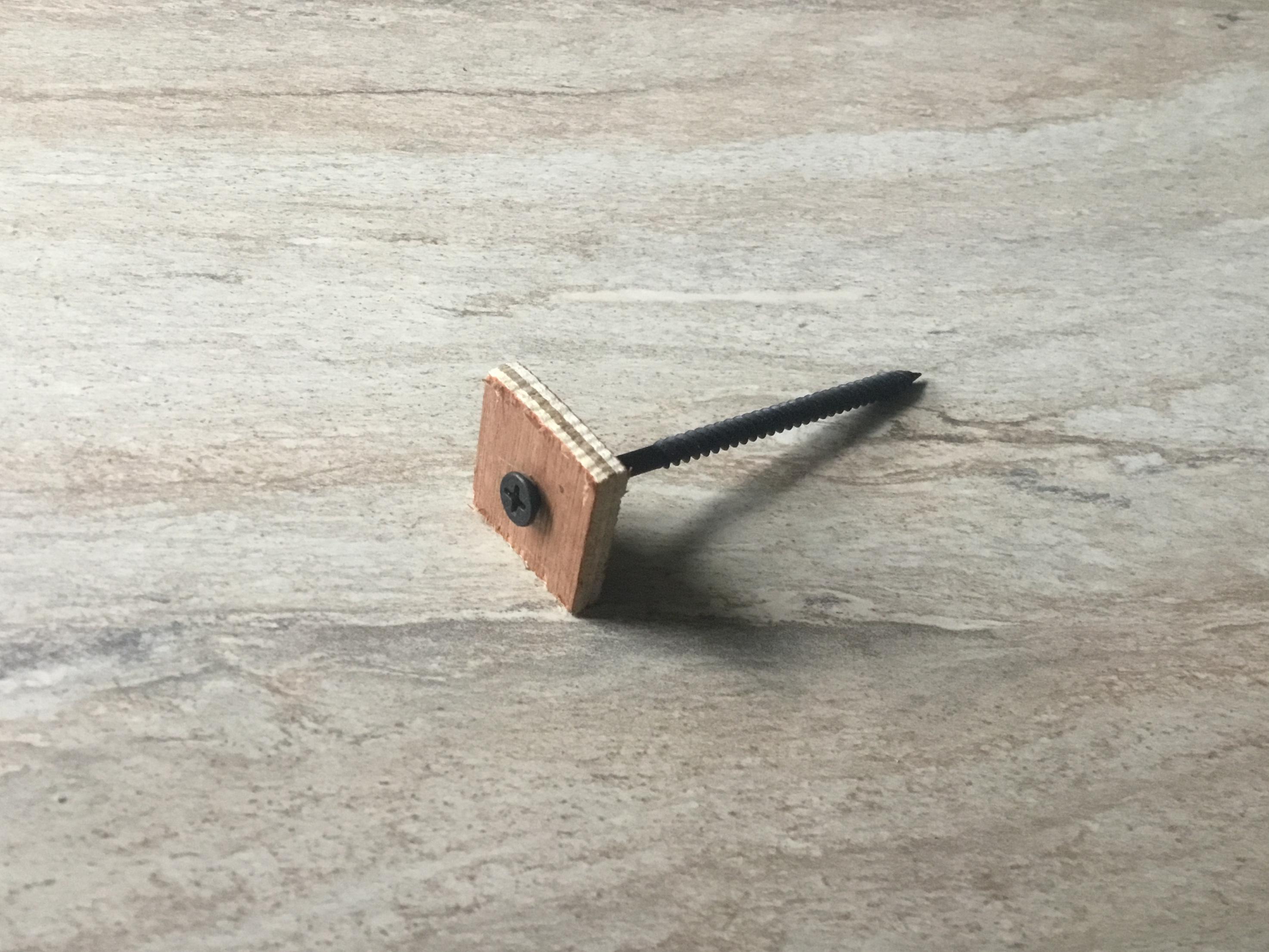

Cpd Posted February 14, 2019 Posted February 14, 2019 Wow @recoveringacademic your washers look like something from Hubble ! I ran out of penny washers to hold up my insulation and as the postie is away on holiday for two weeks I needed to improvise..... bandsaw, pillar - drill - bandsaws. Done ! Made about 100 in no time at all.
ToughButterCup Posted February 14, 2019 Author Posted February 14, 2019 4 minutes ago, Cpd said: [...] needed to improvise..... bandsaw, pillar - drill - bandsaws. [...] And I need to learn from you. Loadsa spare 3mm ply, a table saw, and drill. Job done.
Pete Posted February 14, 2019 Posted February 14, 2019 38 minutes ago, Cpd said: Wow @recoveringacademic your washers look like something from Hubble ! I ran out of penny washers to hold up my insulation and as the postie is away on holiday for two weeks I needed to improvise..... bandsaw, pillar - drill - bandsaws. Done ! Made about 100 in no time at all. Don't they need to be round!!
ToughButterCup Posted February 14, 2019 Author Posted February 14, 2019 1 minute ago, Pete said: Don't they need to be round!! Ok, I'll use a hole saw......?
