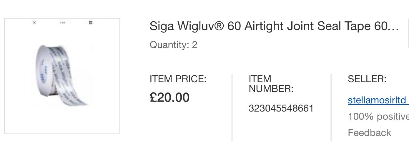

Cpd Posted February 8, 2019 Share Posted February 8, 2019 I used this one as I got it cheap, what an amazing tape ! Found this eBay seller doing it for about £30 a roll which is still good value for such a quality tape. https://www.ebay.co.uk/itm/SIGA-Wigluv-60-60mmx40m-Klebeband-10-Rollen/331905854819?hash=item4d47216d63:g:XpAAAOSwDNdVv2uu Link to comment Share on other sites More sharing options...
