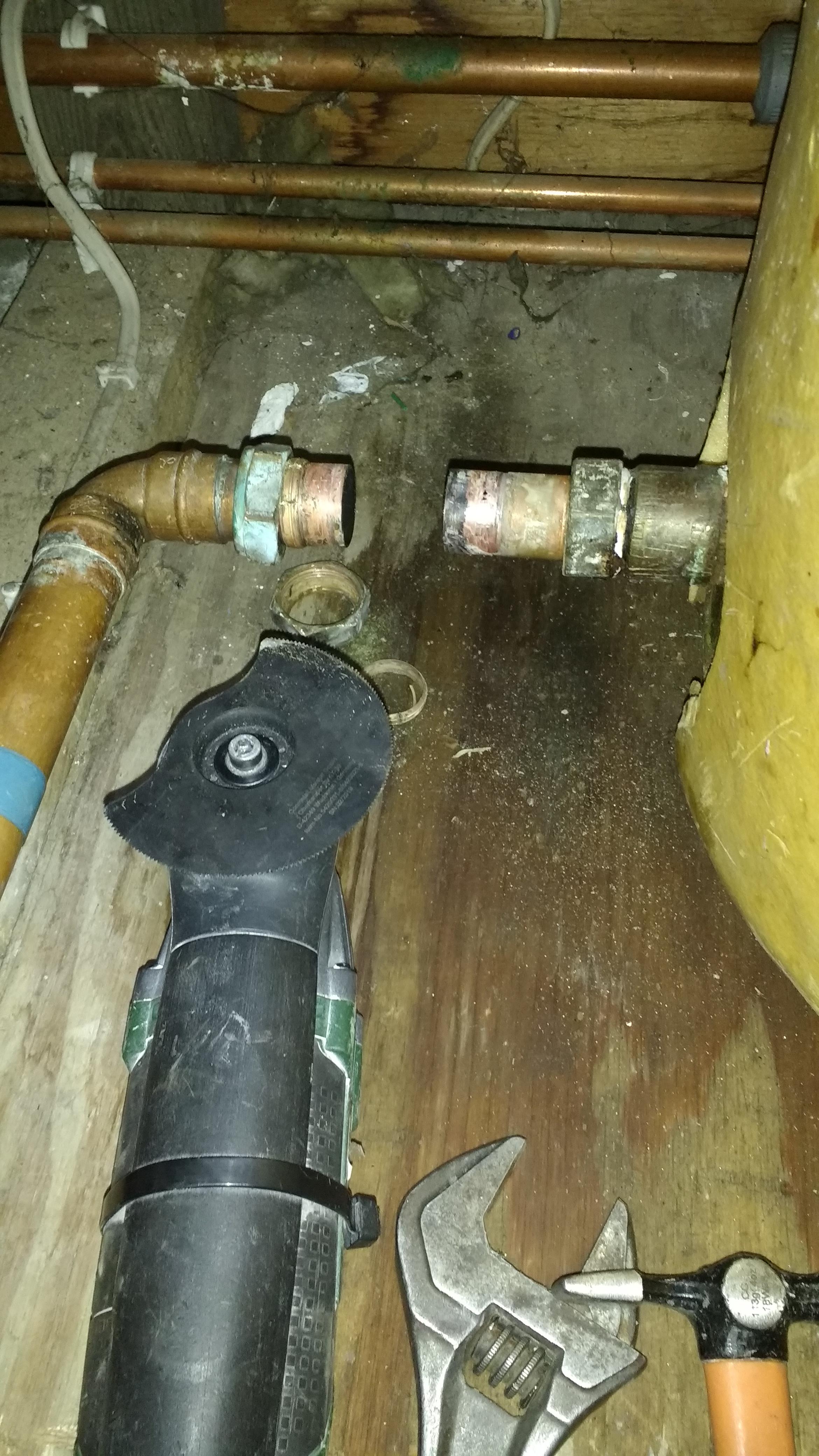

Threads in the nuts look different. As @MJNewton said, junior hacksaw and 2 mins and they will be off
Parkside multi tool with an always on on/off switch!

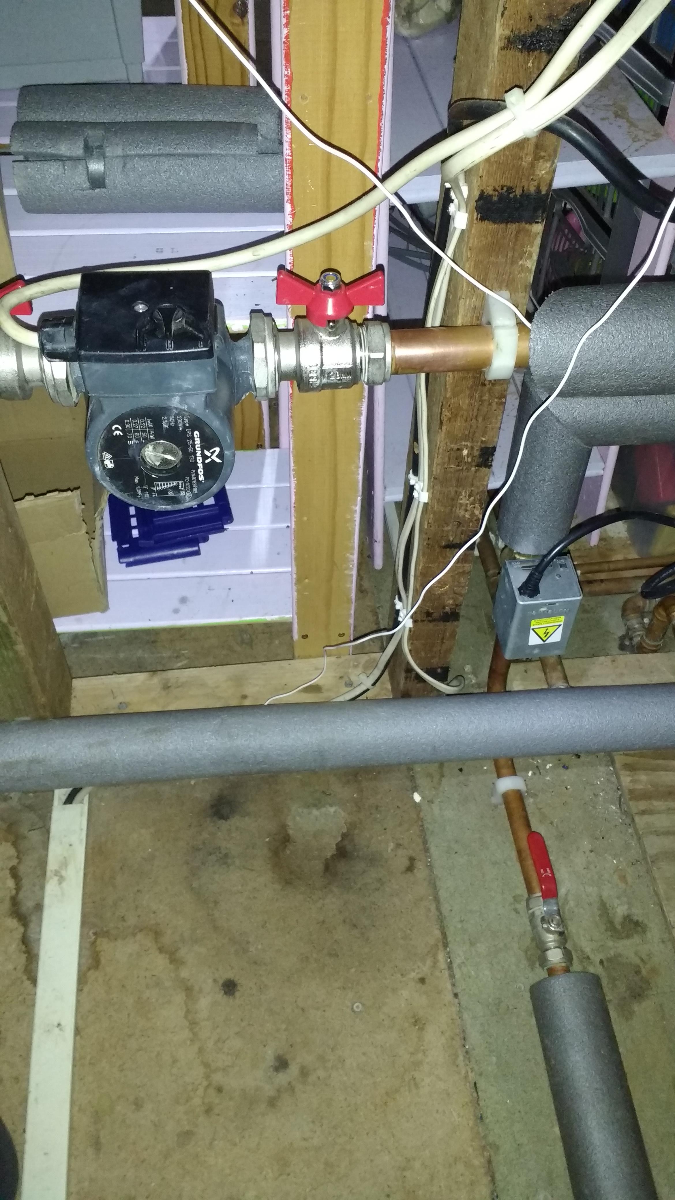

All up and running.
Very quick to fill and bleed!
1 weep on an old, previously revisited 22mm ball valve on the downstairs CH up in the loft - should have replaced the olives rather than backing off and retightening with compound. Then another on the 15 of the 22/22/15 compression T beneath the new rad.
Sorted now.
An oddity though. I'd say on the downstairs single pipe system, out of 8 rads, 2 to 7 are hotter than previous. These 6 are plumbed in at the top and  out at the bottom with swept tees. However, rad 1 being first after the boiler and rad 8 being last, are modern convector rads. These are on the single pipe but plumbed in at the bottom and out at the bottom. These are both bled but imo not as hot as before.

This just makes it easier to do so as in I can isolate the section of downstairs CH pipe I'm aiming to feed the llh off of without draining down the whole system.
The new rad, pump, pump valves, and balancing valve were unexpected bumps in the road.
The power flush happened as it was available for what it cost me in petrol to collect / take back.
Hopefully I have an all round healthier system now.

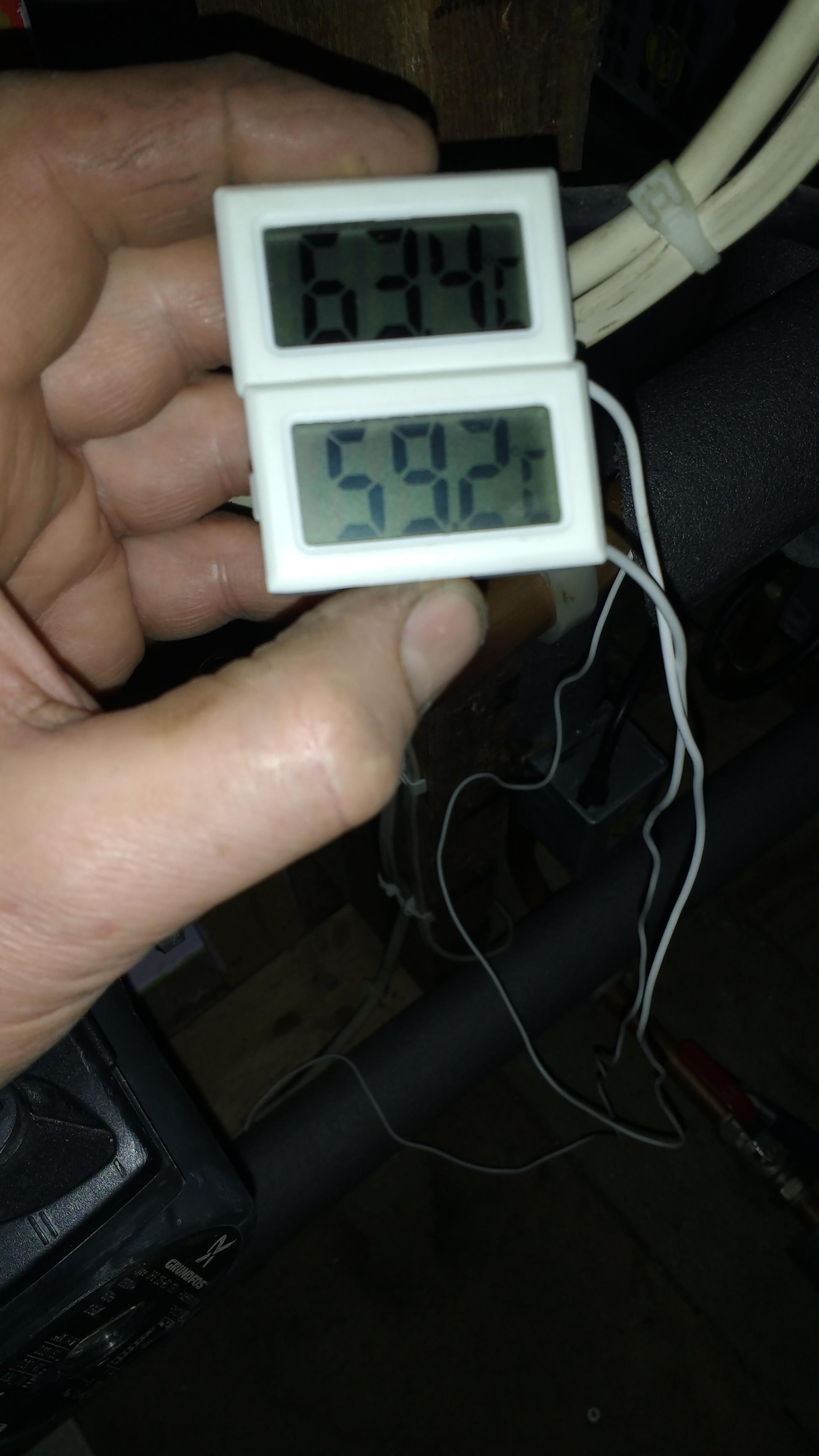

Out of interest I've placed a temperature sensor tucked under the pipe insulation on the return to the boiler after where the CH comes into the return, one of those little ones like @newhome used. It's reading 60deg c. Seems high. Is it maybe reading artificially high because of the insulation?
Tbh, by the boiler where the flow and return pipes go up the wall into the loft the two pipes feel about the same temperature... bloody hot. The boiler stat is set to 65degC. Could it be I have the pump set too high, it's on 3?
Yep, I have to pull the mag filter still to add the inhibitor. Was going to give it a week before doing so. Too long?
Cheers
Edited by Onoff
Week won’t harm it. And temperature will go up if you slow down the pump. It’s more likely that you have given the heat exchanger galleries a good clean, and everything is flowing a bit better. Worth seeing if you turn the boiler down if it drops off, also worth checking the stat is properly in its pocket.

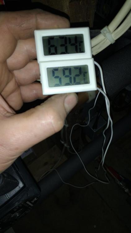

I've put a temperature probe just where the 28mm feed goes into the mid position valve (top). Then a second probe on the return (bottom), after the CH return tees into it.
So nominally <5degC difference between flow and return.
I've now put the pump on 2 to see what happens.

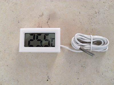

Nice. I fancy doing the same on my system to see if I can ‘optimise’ it.  Are those probes specific for pipes or just cheapy Amazon type jobbies?

Cheap as chips jobbies that Amazon/eBay are awash with. No idea of the accuracy. The white wire just terminates at a little cylindrical sensor maybe 12mm X 3mm. Like this:
Just slipped in and held against the copper pipe by the lagging

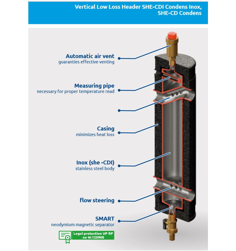

Plan is at the mo to feed a low loss header from the single pipe downstairs CH. The manifold will be fed from the llh. A few real newbie questions if I may:
1) Does using the llh mean I'll have two separate water circuits, one in the single pipe and then what's going through the manifold?

5) My temporary! Can a llh than be used in place of a buffer as in because I have an oil boiler I need a buffer I believe? Wondering how big a llh I'd need to do 6/7/8 circuits if I was to get one now and be done with it. The CH system here is likely to stay rads upstairs and maybe a combination of UFH and rads downstairs.
Edited by Onoff
Low loss header may struggle with an oil boiler as they don’t really modulate well. No way you could change the current hot water cylinder for a thermal store ..? Would then work as mains hot water and a buffer tank.
Any more bits with that manifold as it’s missing an isolator from the top row. And yes that could be used,  old pump may be a bit noisy but you could replace that when you finally finish the rest of the circuits.

A bit lost as to why a llh wil struggle...it's ME not understanding! This is the generic guts of one then I've come across...struggling now to see how it would work even. YouTube it is later!
