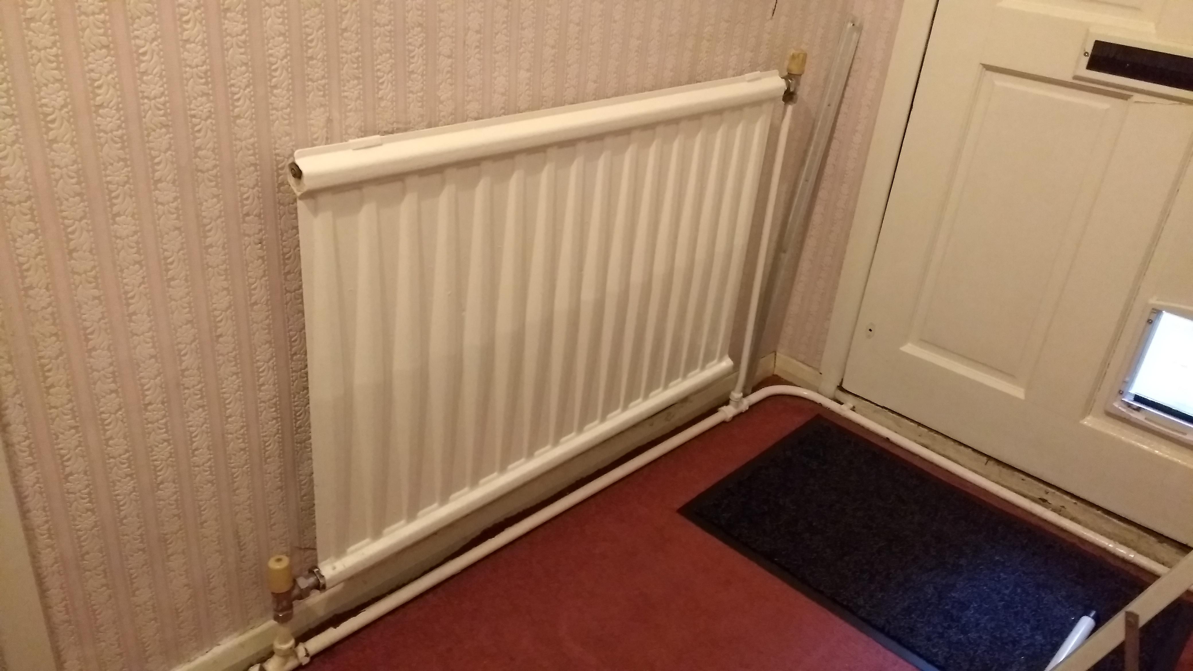

Is it absolutely imperative, on a single pipe system, to have the flow to the rad in at the top and the "return", diagonally opposite at the bottom? Like this original one:
Out of 8 in total, I've two downstairs rads here that are in/out at the bottom. One new, double convector rad I fitted (what is now the first downstairs rad) and then the last rad on the downstairs system the previous owner fitted. I have the opportunity when I next drain down to make them both "in at the top". (I'm replacing the last one anyway as that has the broken bleed screw).

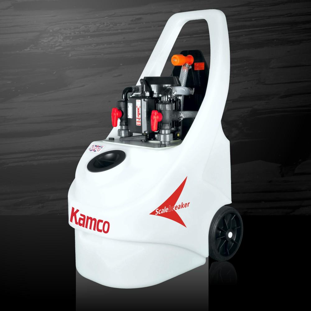

I've got the OK to borrow one of these for as long as I need within reason!
https://www.kamco.co.uk/c90-fwf-descaling-pump.html
Need to read the book now!

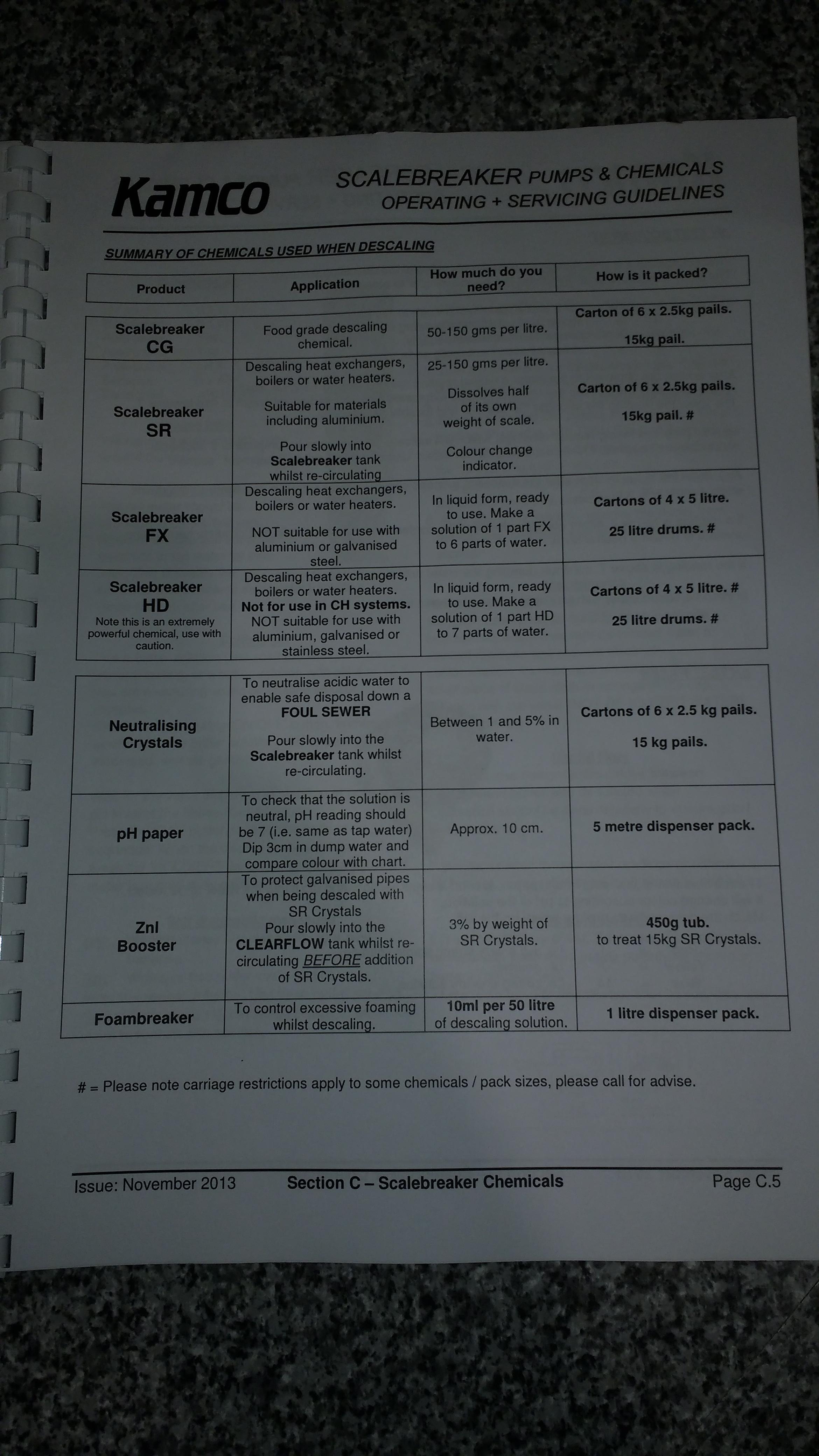

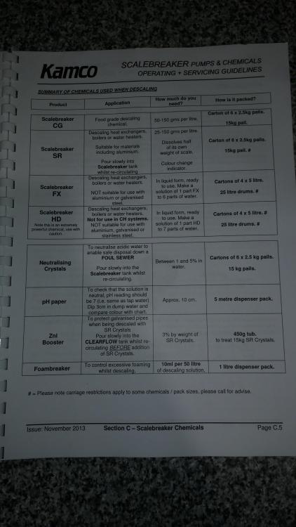

Interesting reading the ScaleBreaker manual. You can add various chemical agents for descaling from mild to strong.
I wonder if their "CG", in white crystal form is just citric acid?

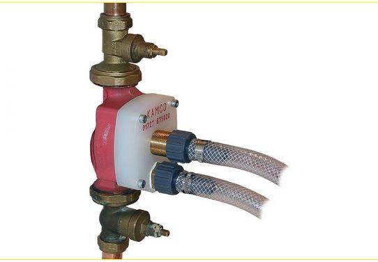

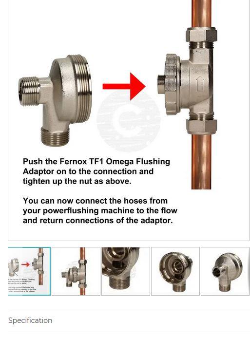

Seems if I'd have bought a different "magnaclean" then attaching a power flusing rig is a doddle. This is the Fernox one:
There's also ones you attach in place of the pump motor. This is circa £100 from the people who make the power flushing rig:
A quarter of the price this generic one:
Both though mean getting the power flush rig up into the loft.
Still planning to connect something where the IntaKlean unit fits.

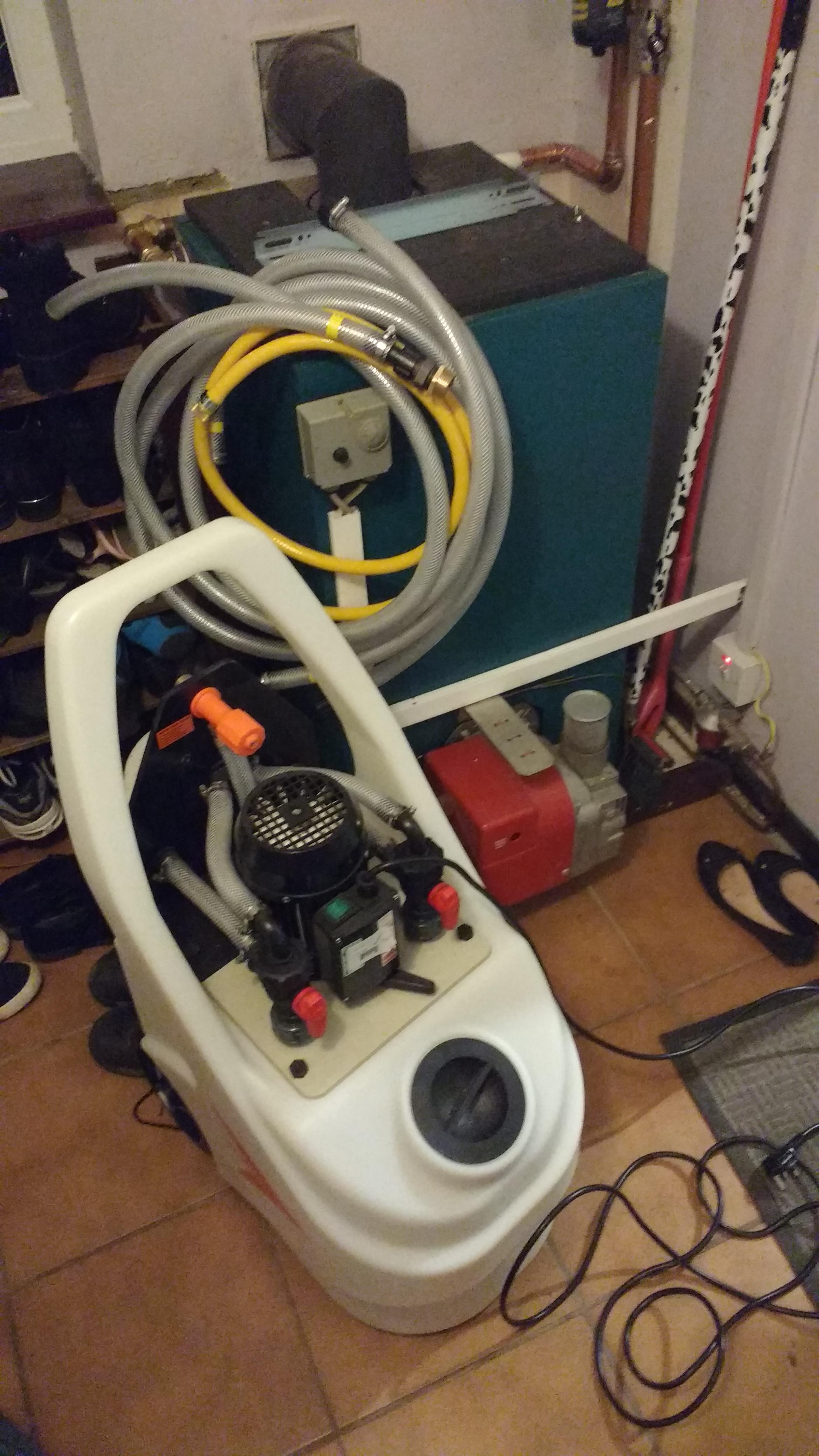

The ScaleBreaker power flushing rig is a beast!

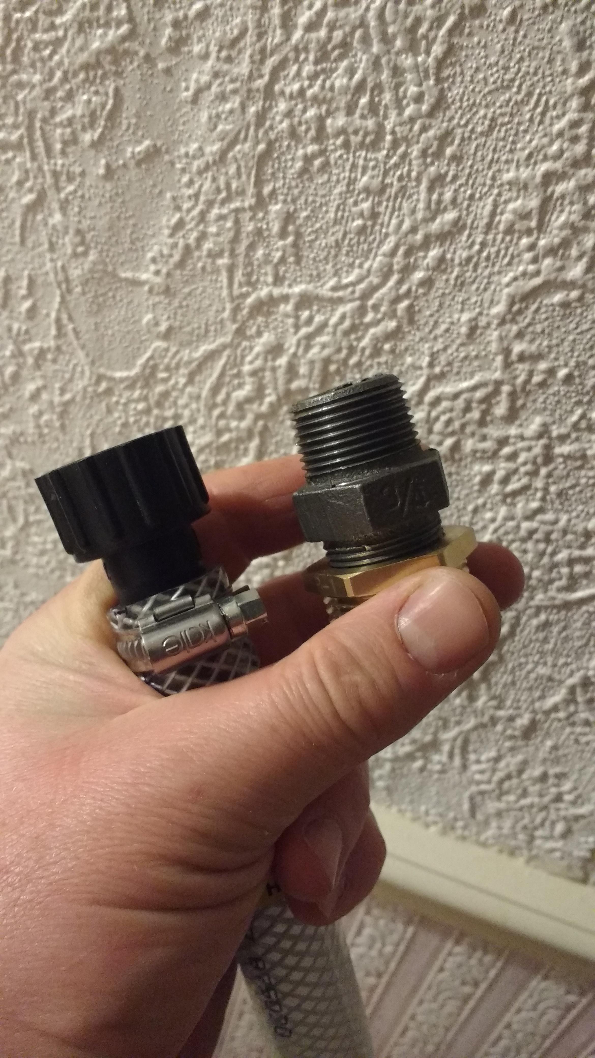

I'm aiming to plumb it into the return line just before the boiler as aforementioned. I've brass & iron fittings to go from 3/4" male to 1" male BSP which I'll assemble with PTFE tape. (Just hoping the 1" BSP is correct but I won't know until I remove the IntaKlean mag filter).

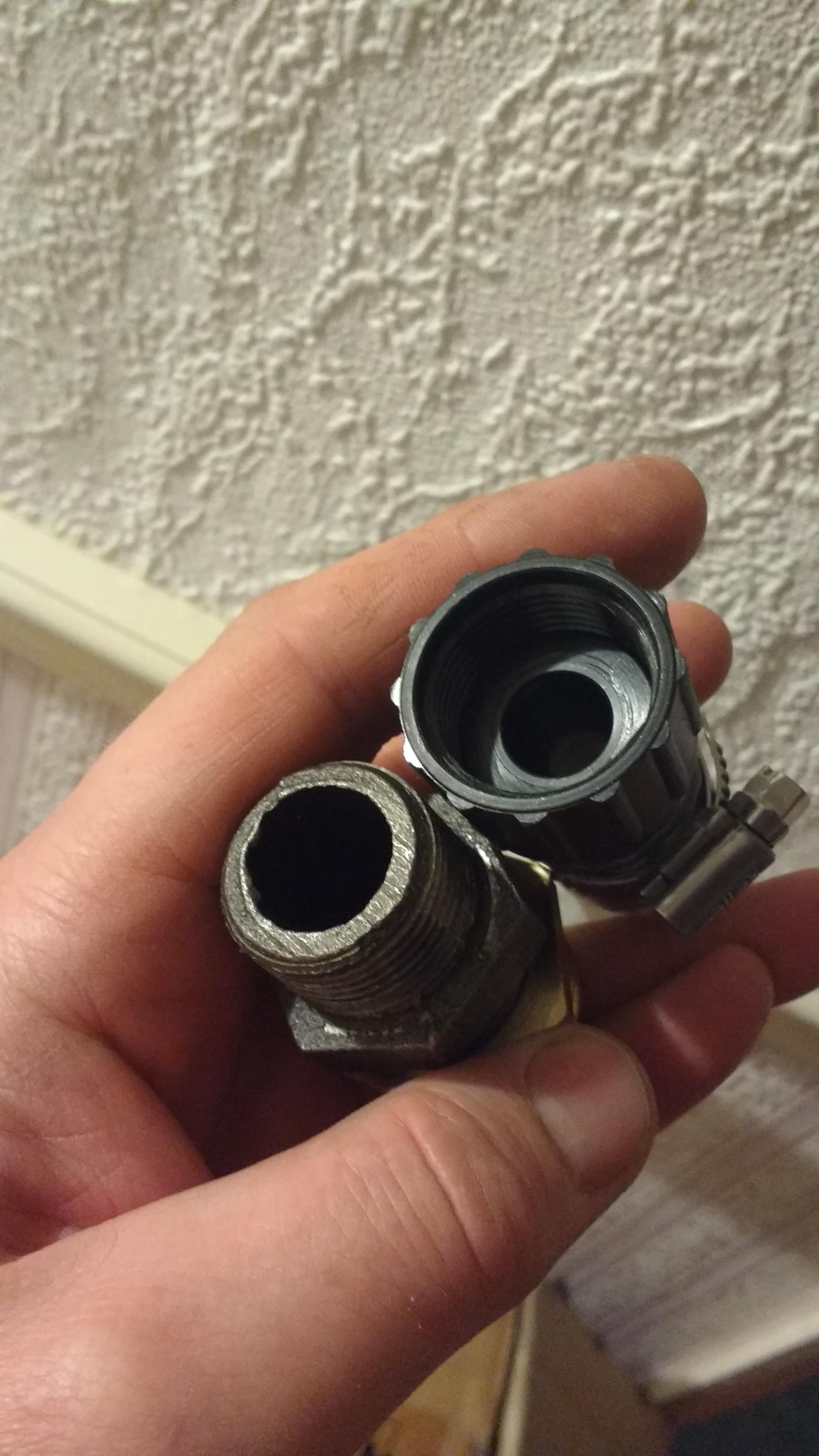

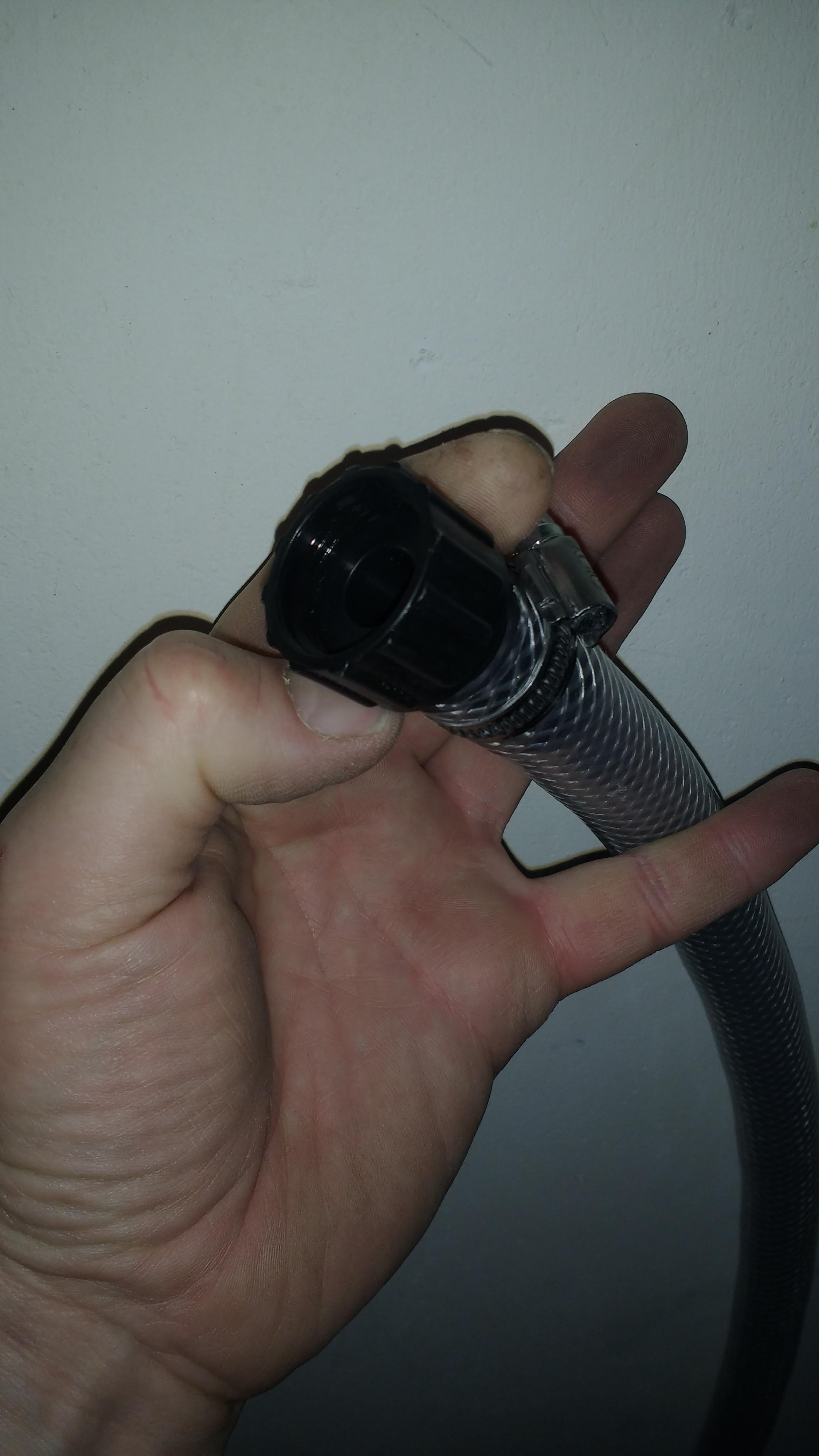

The rig's flexible pipe fittings are black plastic, 3/4" BSP that come prefitted to reinforced hose attached with a jubilee clip.
However there is no plastic or fibre washer.
Maybe just more PTFE tape on the plastic to iron connection?
if it's a loose nut, you'd be best with a rubber washer
Yes, the nut above the jubilee clip in the last picture rotates freely. Got one of the hoses with me today so it's off to the plumber's merchants later for some washers.
