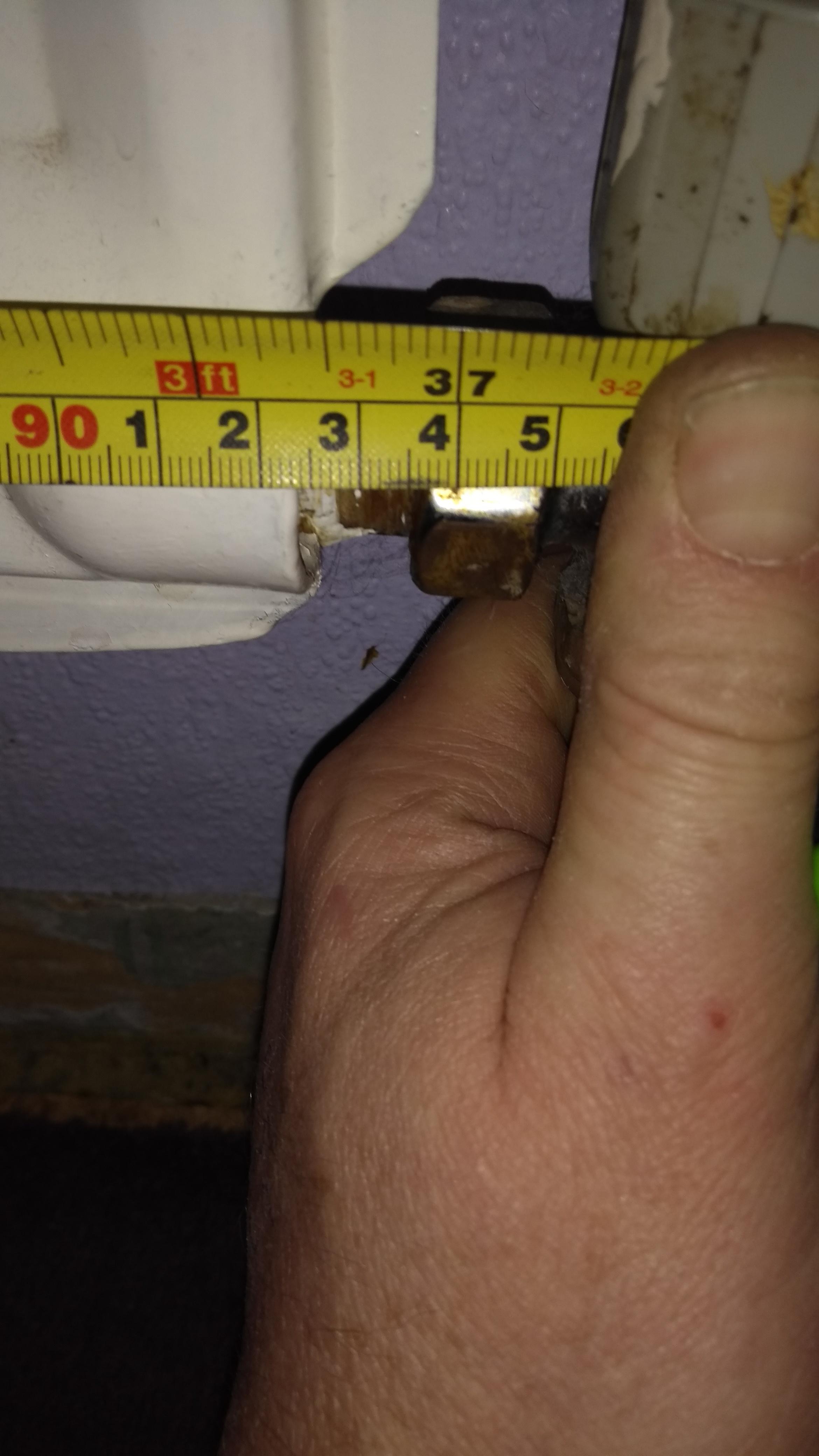

Radiator is quite old I guess. Overall size 945x530 nom. Just over 920mm between valve faces:

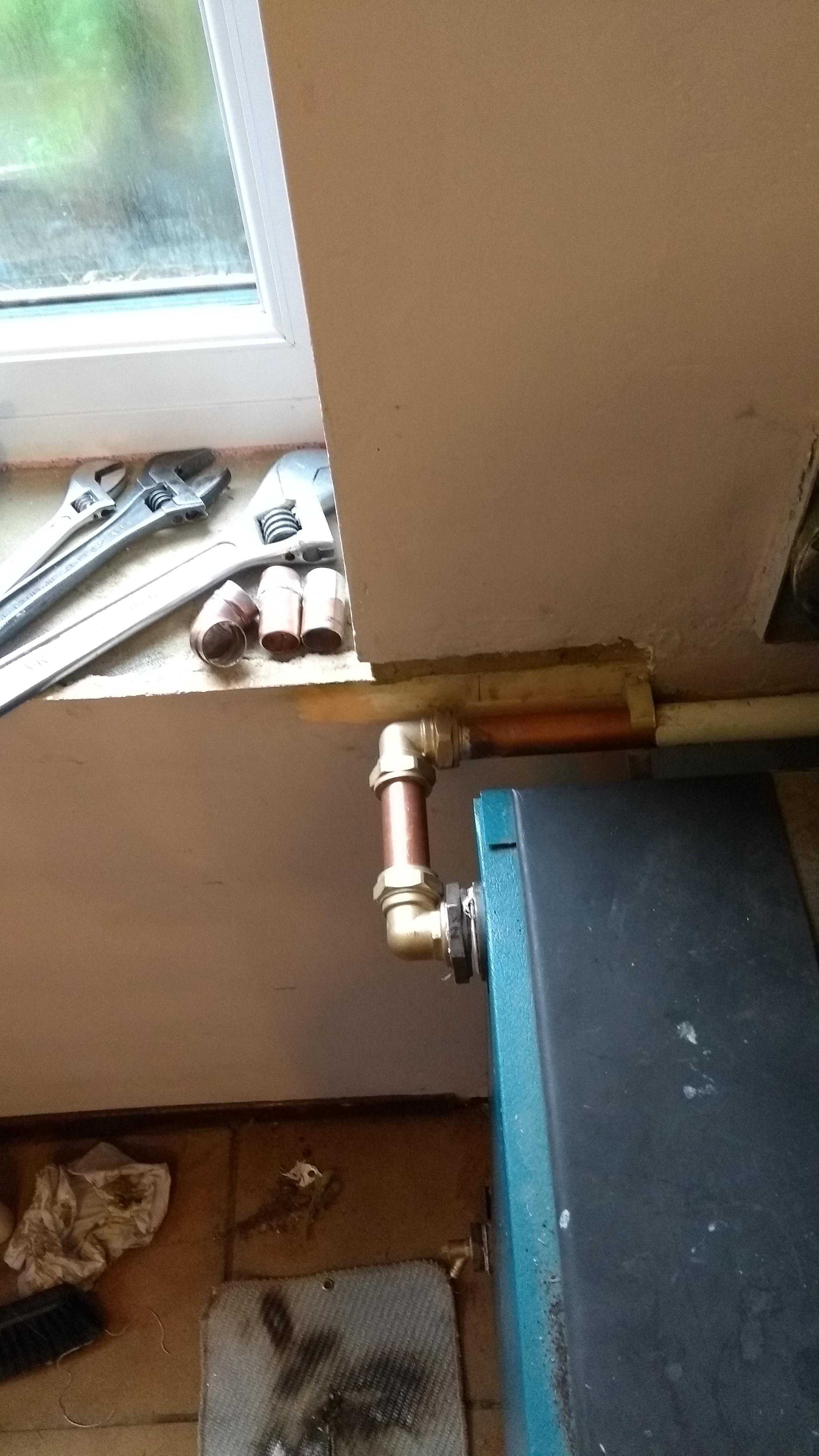

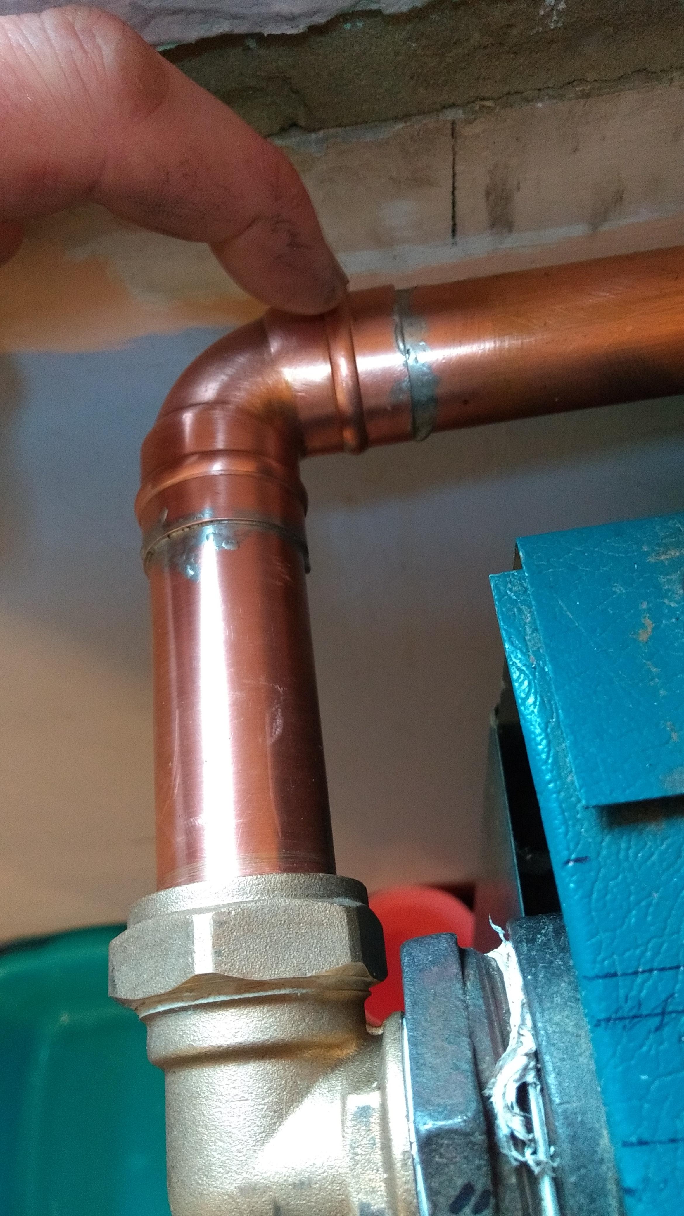

Bollicks!
Leak on the 28mm soldered elbow!
Maybe swap out for a compression?
Drain down time again! ?
Are you putting flux on the solder as well as the pipe and fittings? With 28mm it’s good to re-introduce flux during the soldering of the joint.
And yes, I could have told you that a few days ago, but I thought you were all trained up on soldering after the bathroom / other plumbing. ?
Flux on both. It didn't seem to run round the joints as well as I've had it go before. Some water in the horizontal pipe anyway that comes out periodically.
Going compression now.

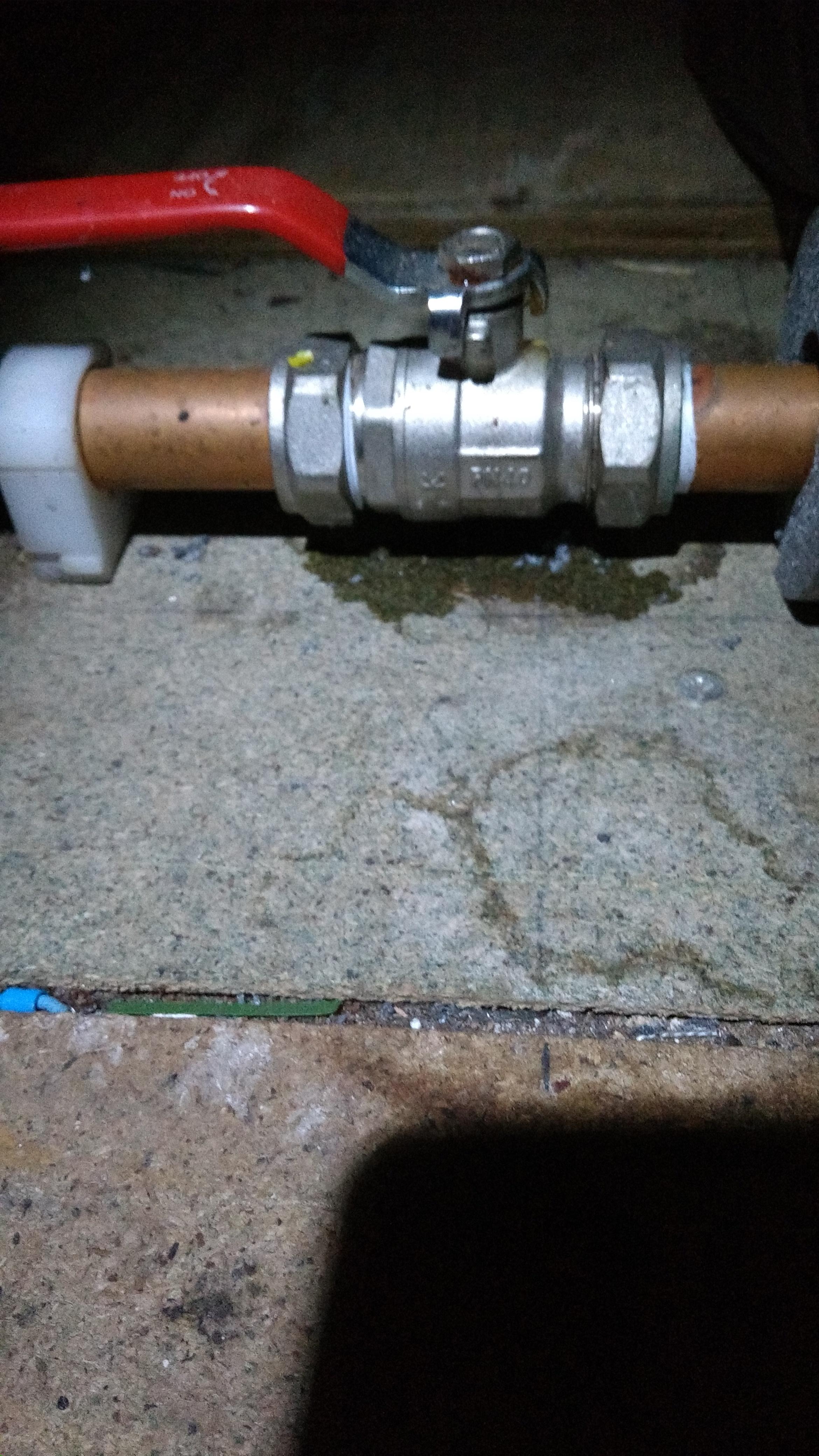

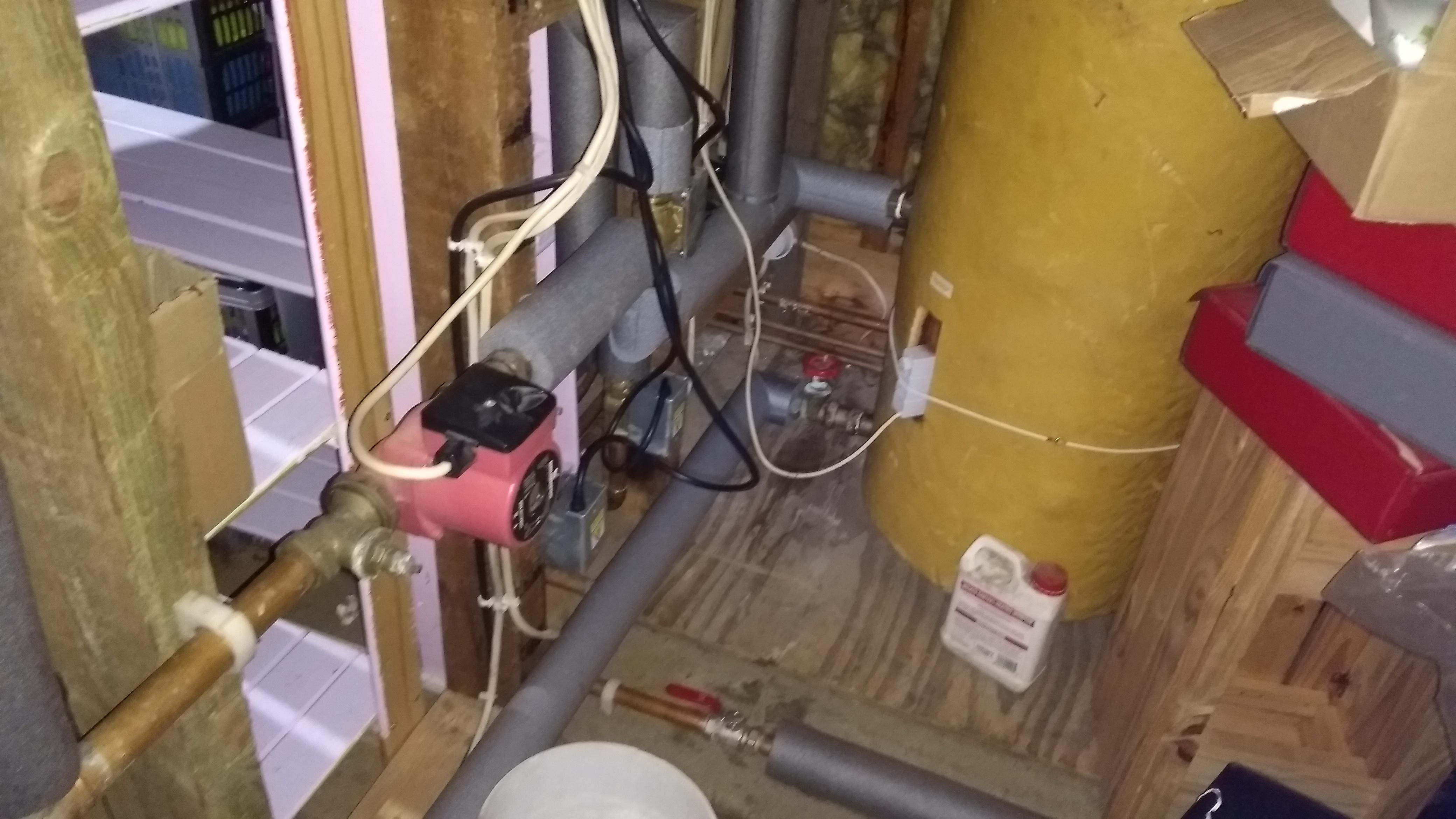

Years ago I put a ball valve after the downstairs 2 port valve up in the loft. That's got a weep. I only used tape on the olives there. Jet Blue Plus would sort it. Might be able to do in situ without draining down and just some isolation here and there:

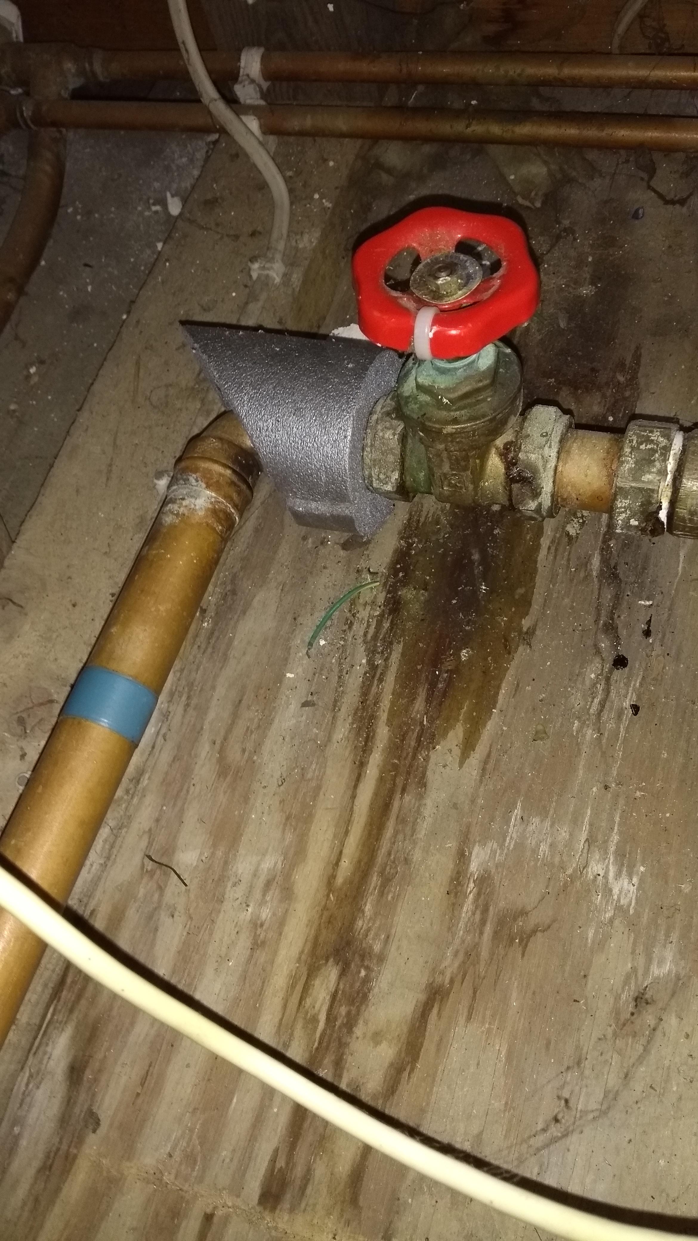

Then on the return from the coil on the bottom of the HWC there's a "balancing", gate valve. Doesn't look well:
One of the existing pump valves had a weep, backed the nut off and packed with Jet Blue Plus. Seems to have worked.

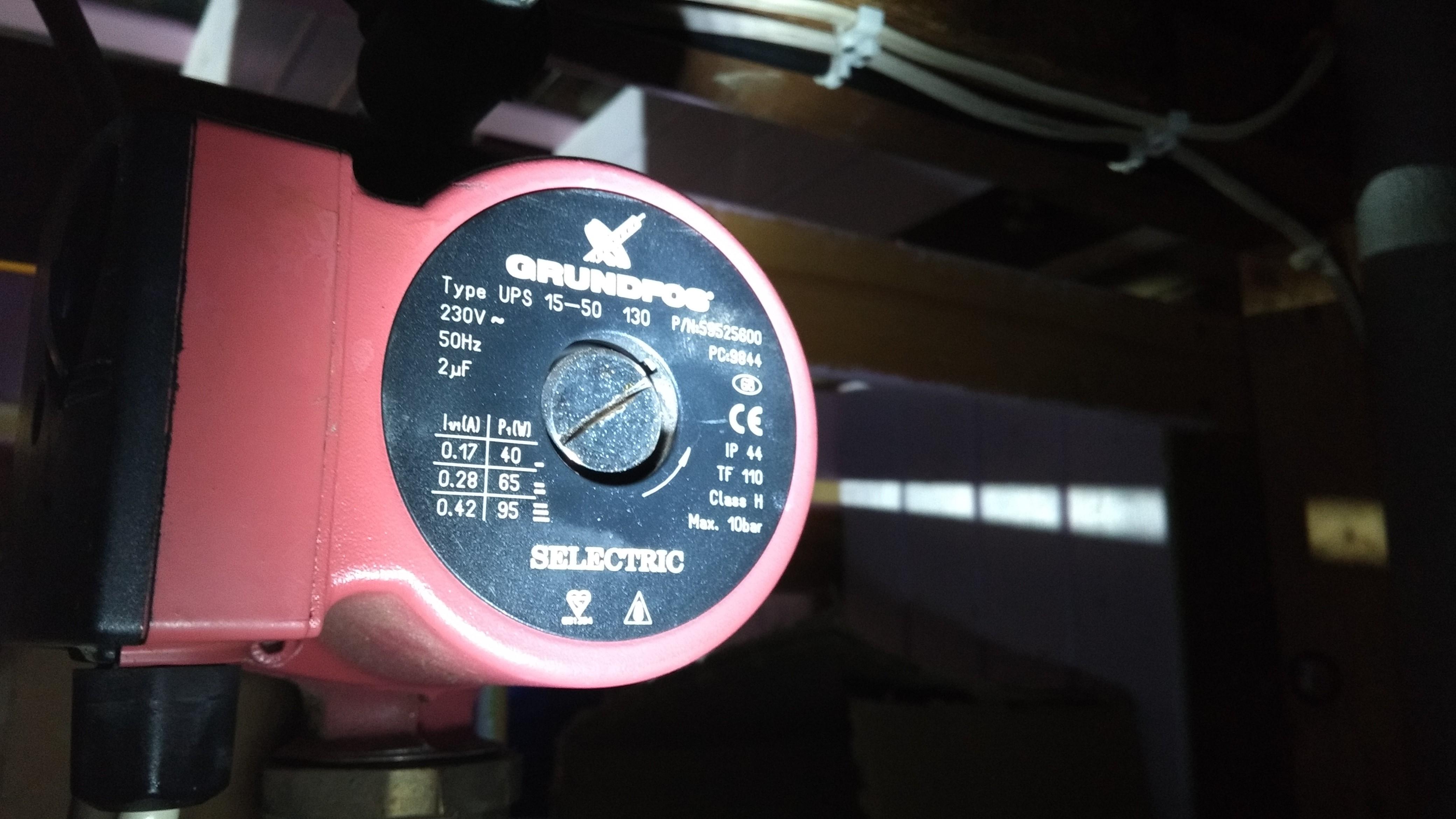

The pump though is for want of a better word, "hunting". Not a nice steady whirr. Sort of goes, vroom, vroom, vroom about 2 ) 3 times a second. On speed 3, the highest.

Circulation or lack of it will be down to air locks most prob. Single pope is a da k of ? on a good day.
Putting a cold mains on drain offs and firing short sharp 2-pints-at-a-time blasts of water in under pressure may help shift things a bit.
The pump ‘hunting’ is knackered.
That’s all the good news I can give you for today. At least until I’m pissed later and then I’ll let rip ?????

Though I defer to your wisdom, struggling to see how pump was working but not now with what I've done (as is SWMBO ?). Was it on the brink? Why now, all of a sudden, just interested. Hoping against hope but could it just be fighting all the crud in the system?

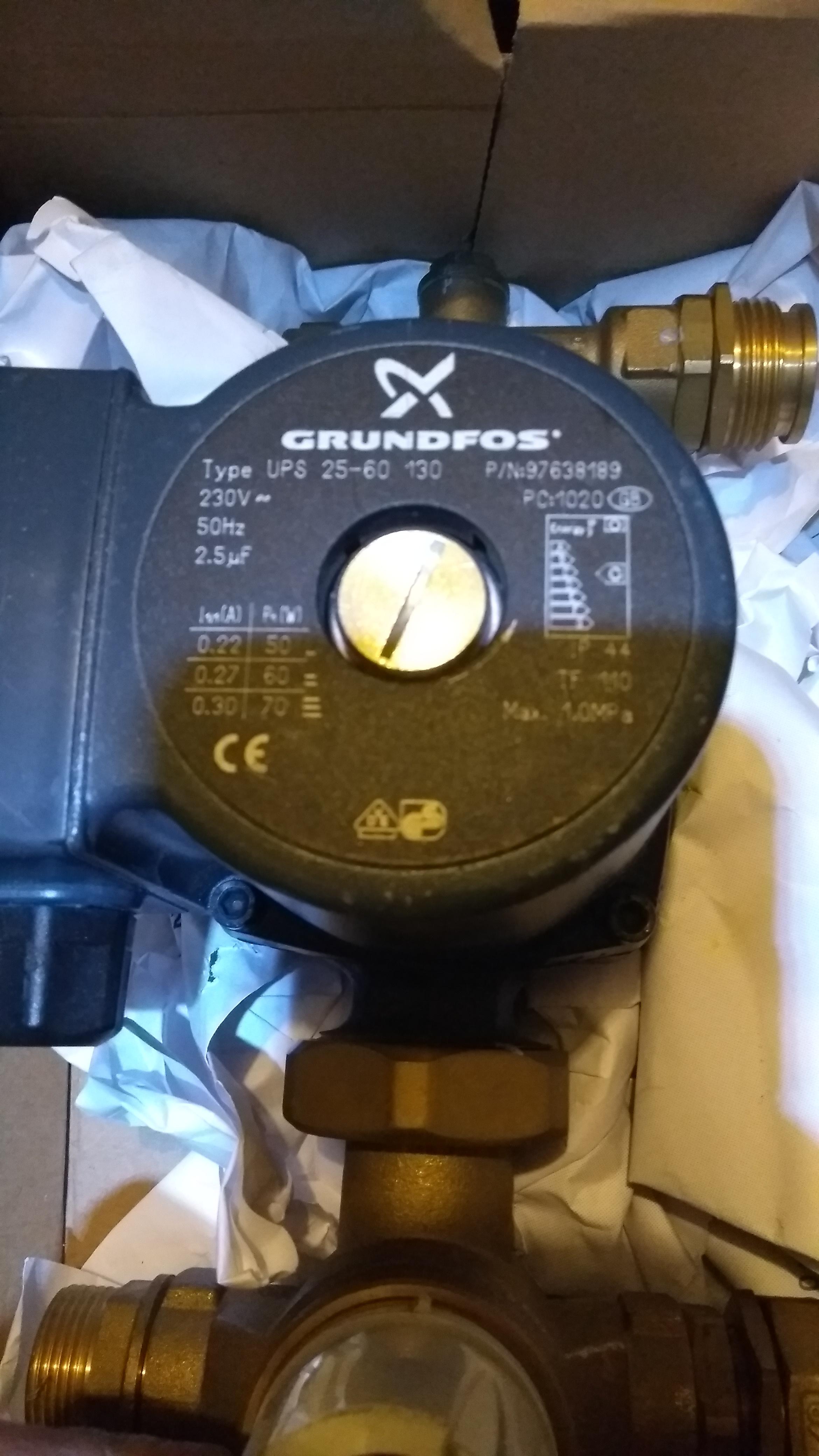

If no then this is the existing pump (I have to bend double to take this):

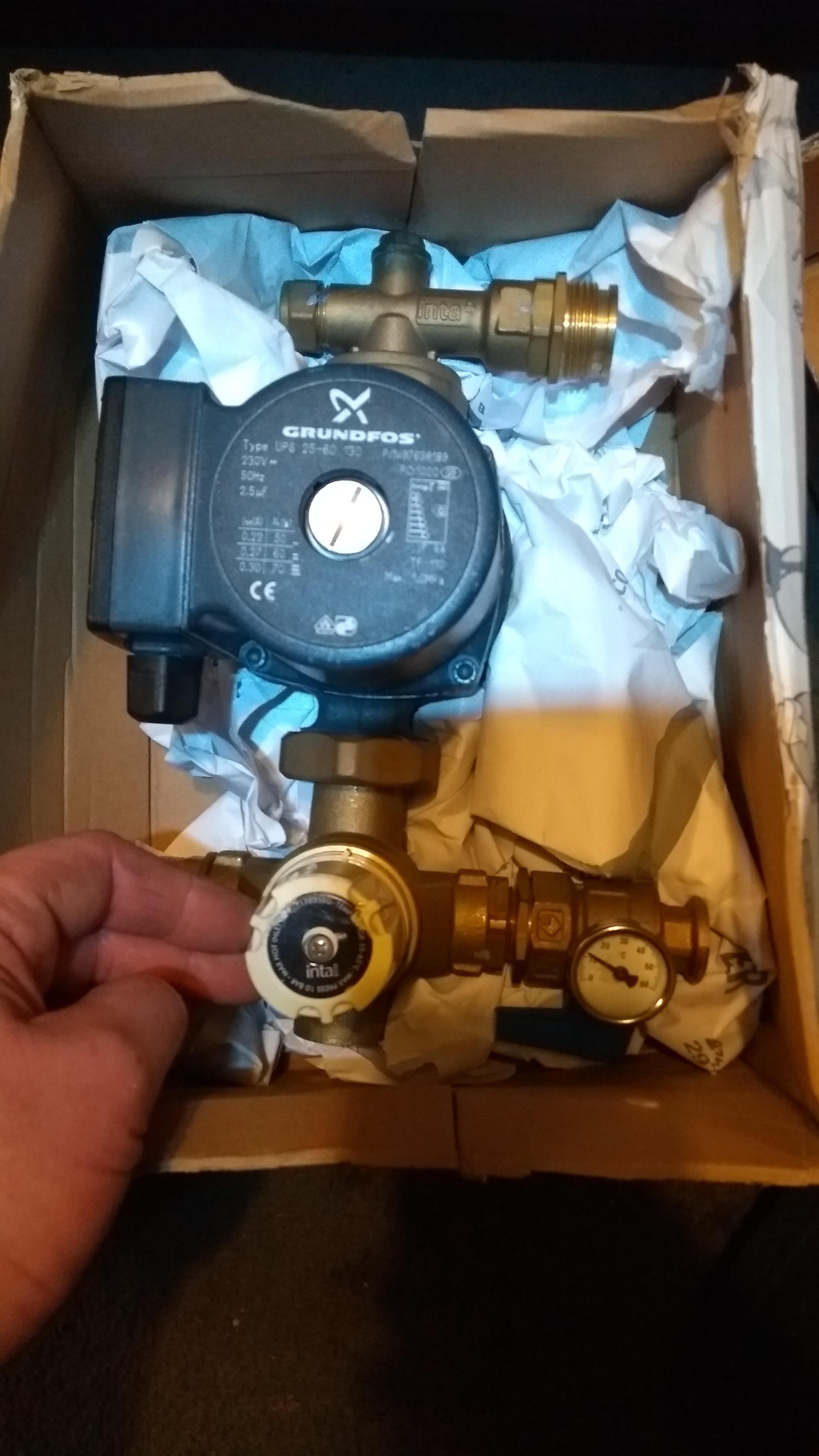

I do have this pump you pointed me at years ago and has sat here doing nothing.
Straight swap?
Cheers
(I've taken a video clip with sound of the existing pump working on all 3 positions. Waiting for it to upload).

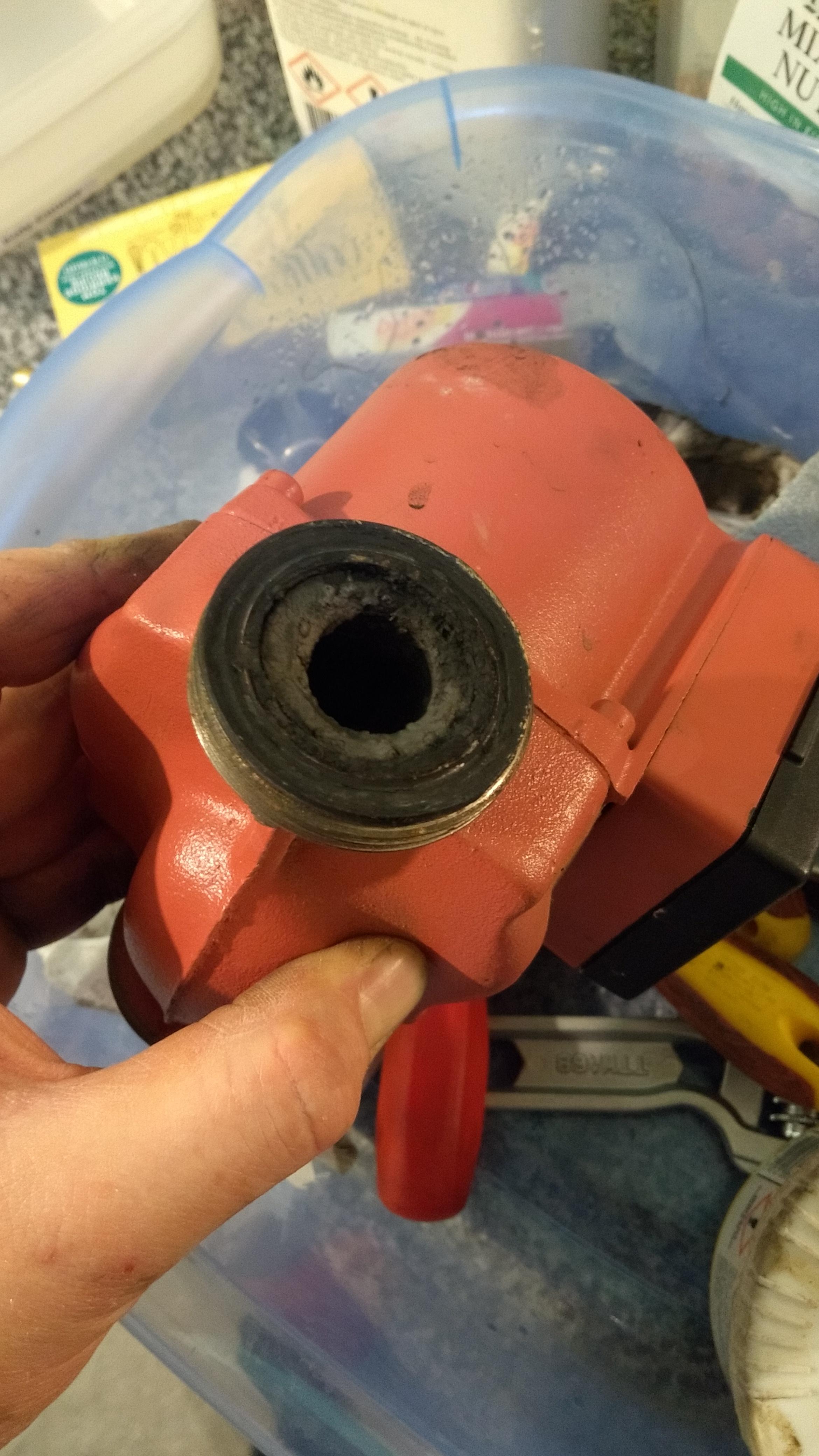

New pump fitted! That was easy.

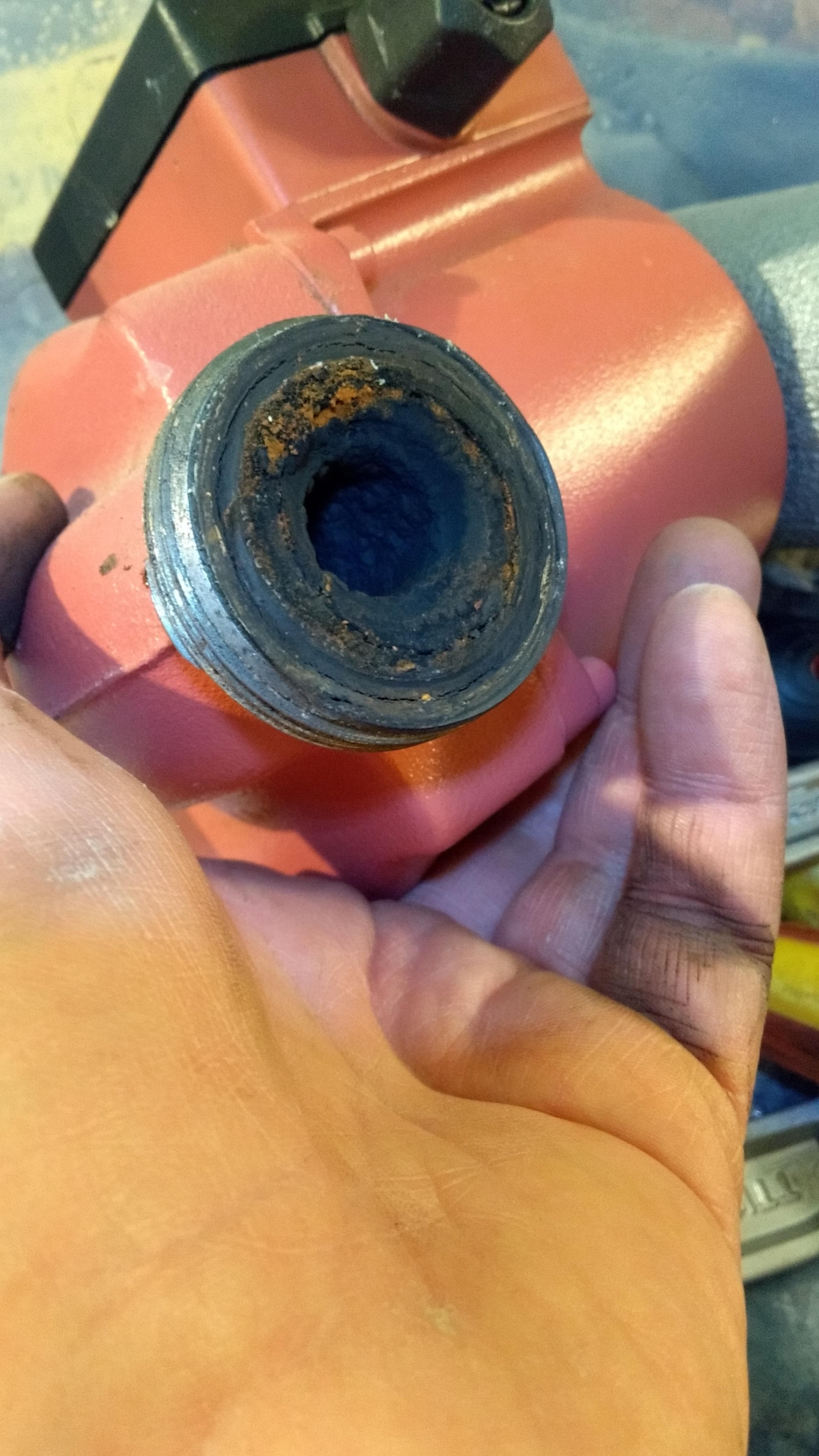

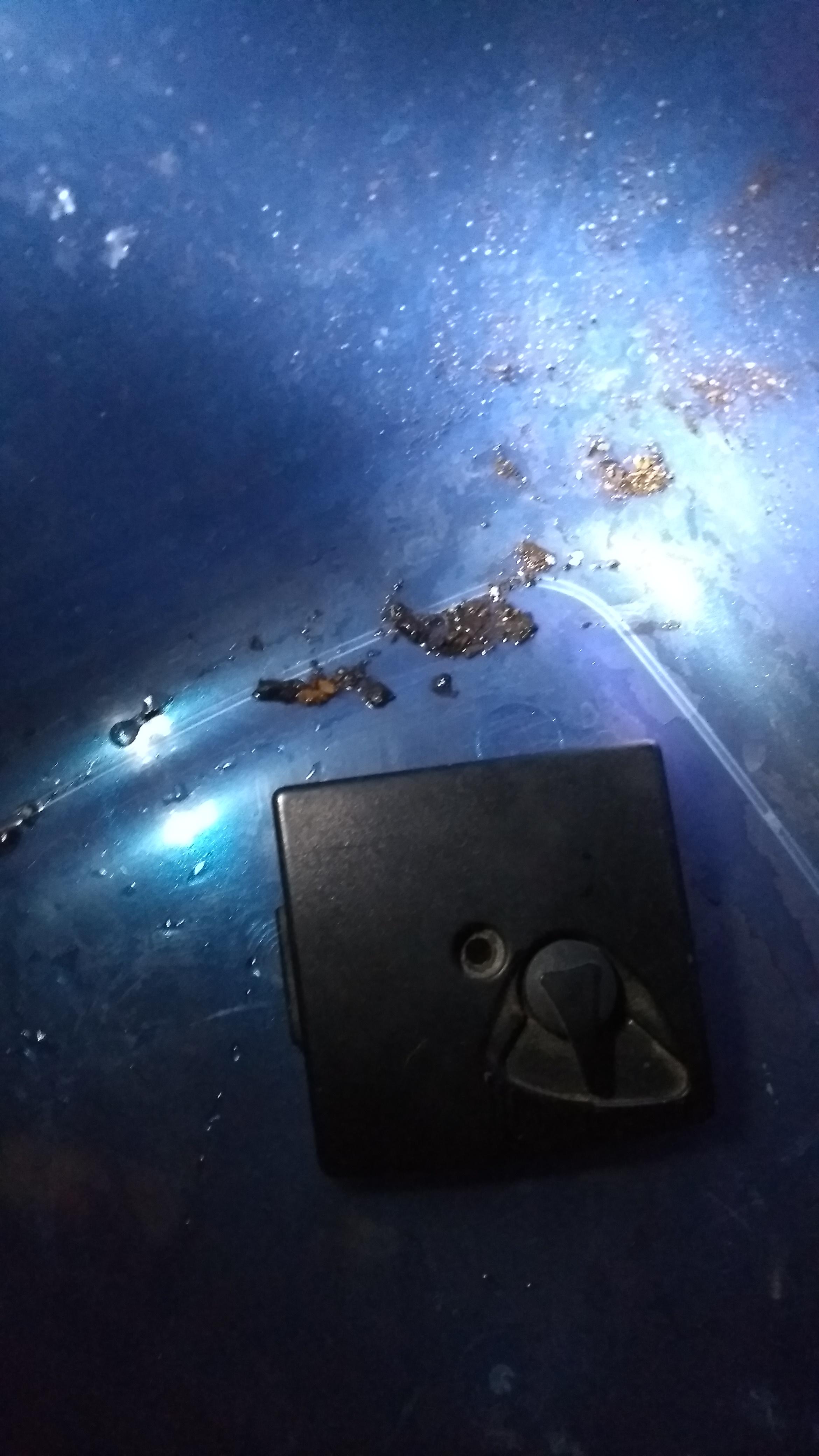

With the old pump removed I took the silver screw out and rotated the shaft. Tbh it feels perfect. Looking down the end of the pump and I can see the impeller. Looks intact.
Really thinking this is just grot in the system. As evidenced by some of the crap in the bottom of the bowl next to the old pump lid. Very, very black and rusty/ferrous:
Thinking the original pump might in fact be OK.

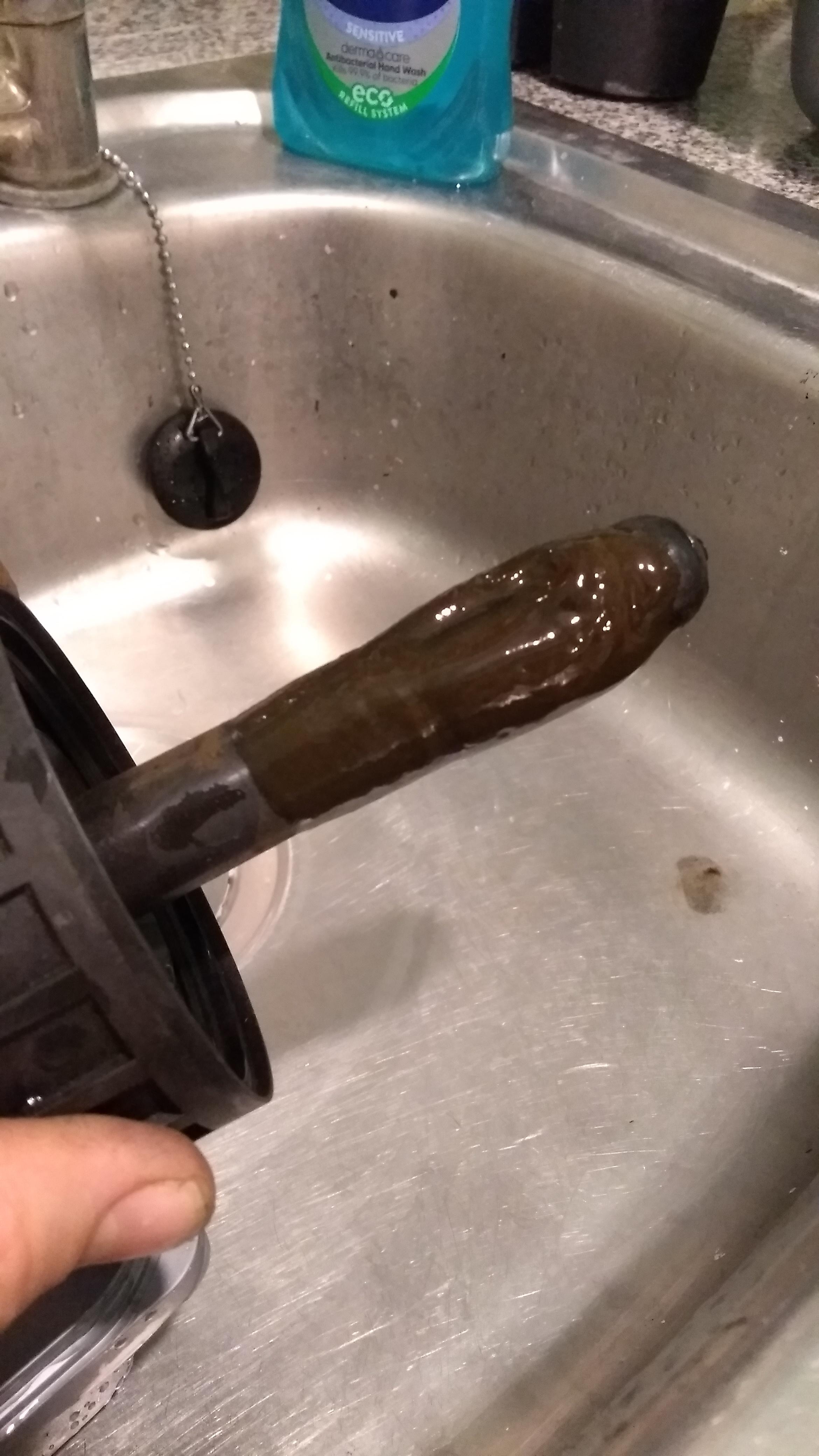

Sounds like borrowing that power flush unit may be helpful but I would have a couple of containers of system cleaner going round before I did anything as invasive as use a power flush. You need to make sure all the joints are good as they can get a bit fierce. That magnaclean will also start taking some crud out as it starts working.
13 minutes ago, dpmiller said:
there's a lot of crap in that pump.
Just undone the IntaKlean and the crud is impressive. Lots of visuble, ferrous debris encased in a black sludge. The mesh case surrounding it was pretty grubby as well:
Added half of the first litre of Sentinel X400. I'll let that run round for a bit and add some more!
Stuck 2L of Sentinel X400 over the course of the evening in 6 doses. Every time the magnet is coated in crud. Leaving the last lot in to circulate. Next weekend I'll drain down again at least and fit the new rad and pump valves,

Video of the Grundfoss 15-50 130 pump I took out (25-60 130 now fitted):

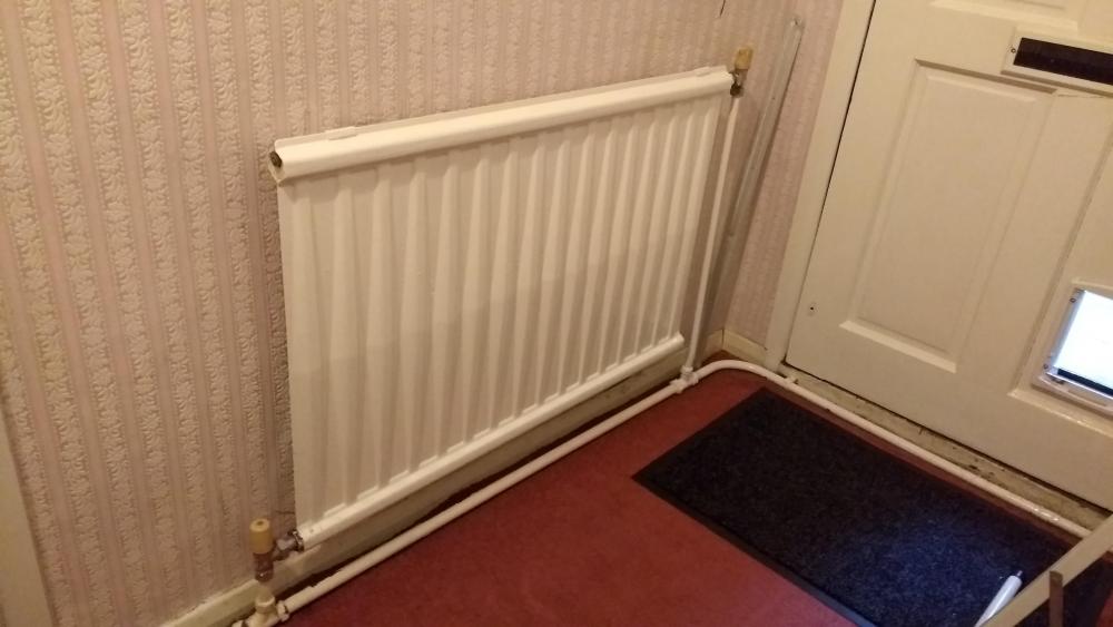

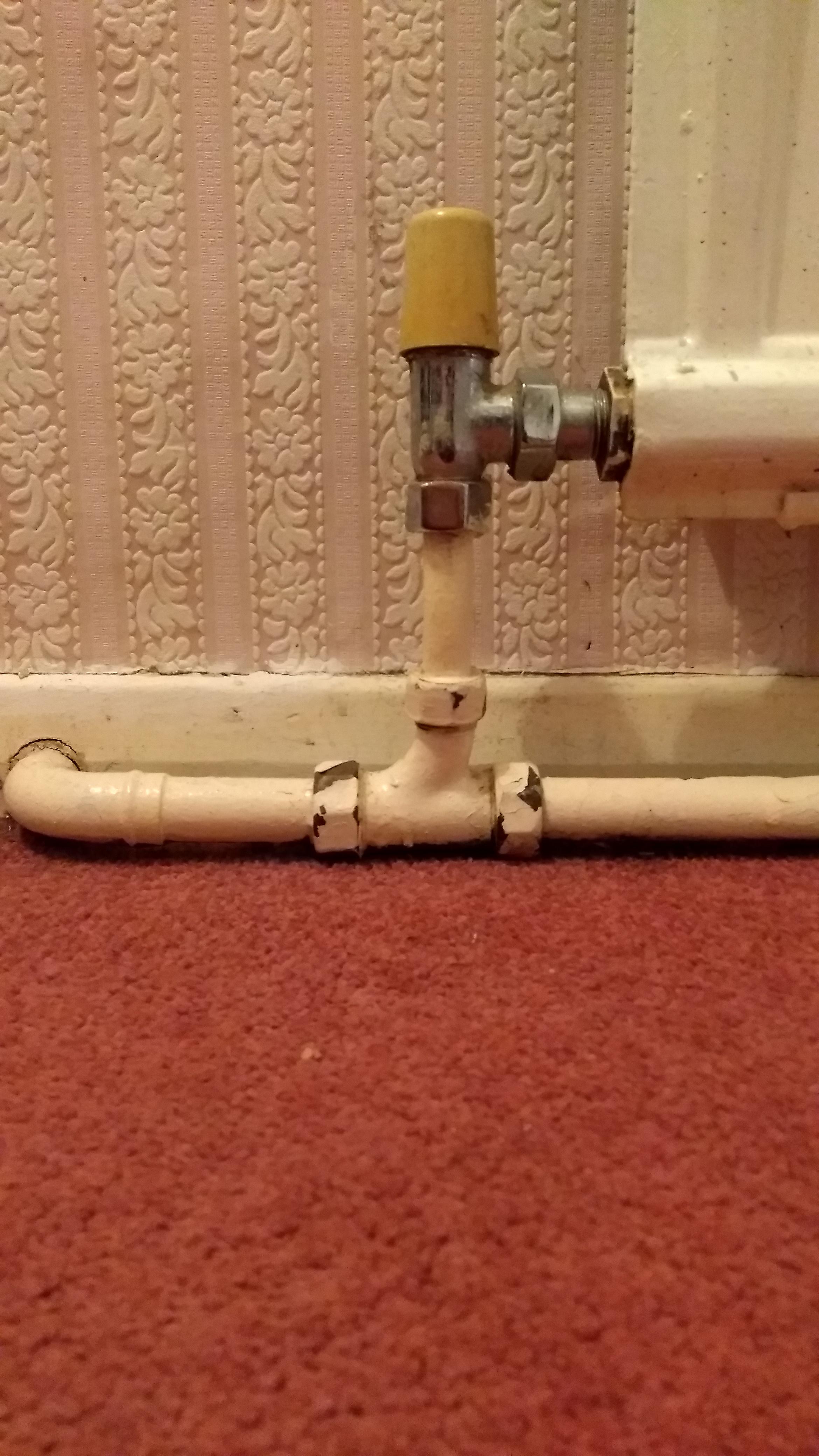

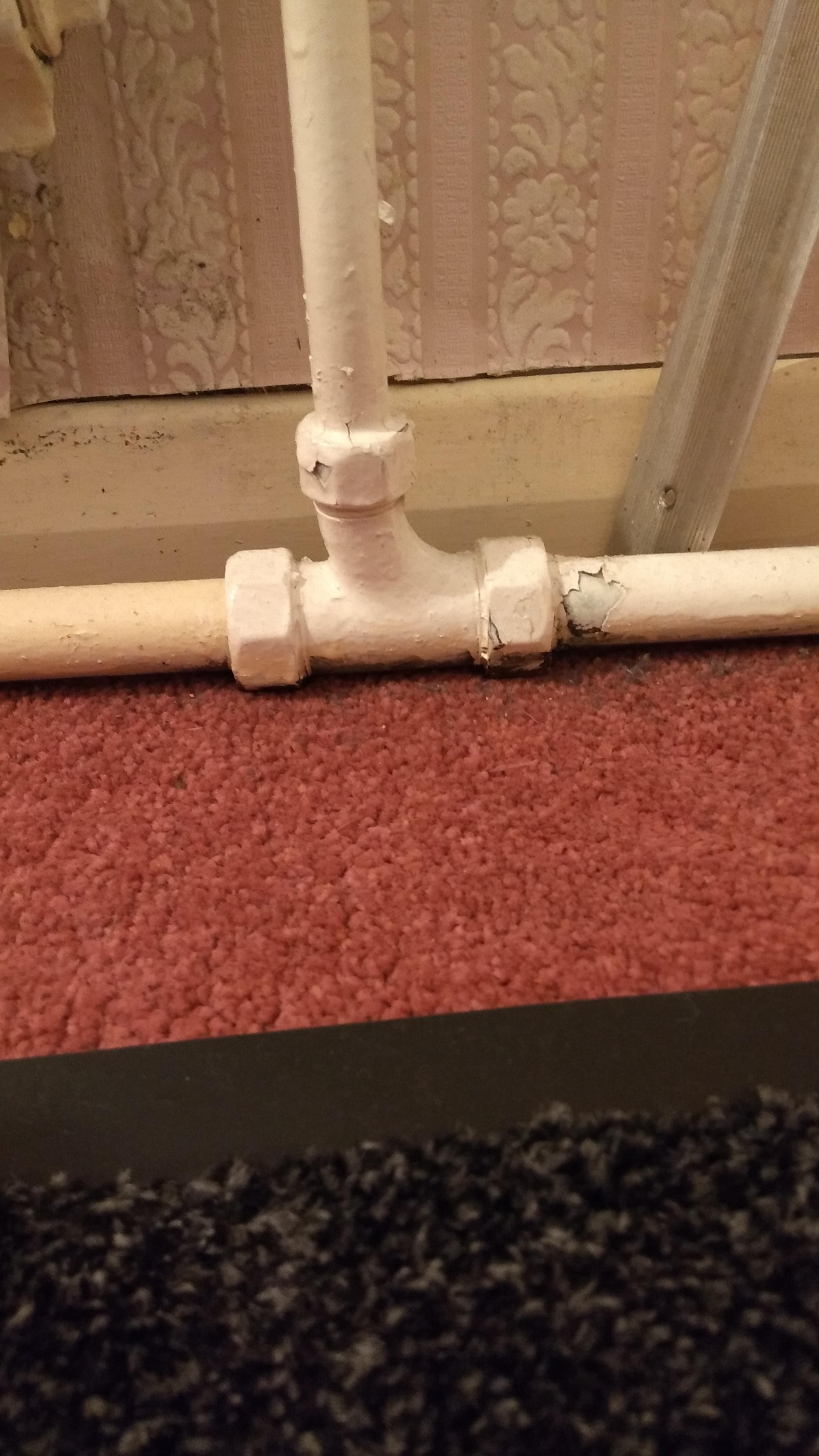

Typical old rad. Flow is right to left. Interesting how "hot" comes in at the top on the right and out at the bottom in the left. Did half wonder if the flow is in the right direction!
Swept tees too, I imagine to aid the flow in/out.
Into the top of the rad, flow right to left:
Out at the bottom of the rad, flow right to left:
Sometime the single pipe goes through the skirting / wall like in the first photo. Elsewhere it goes down through the floorboards. Puts the (possibly) lowest point under the suspended floor somewhere. Inaccessible without a major room clear out. I bet that's sludgy there!
Edited by Onoff
6 minutes ago, Onoff said:
As an aside if, in the single pipe running below each rad, there was an isolation valve, would that force "cleaner" through just the rad?
Yes but by the time you have cut and inserted this lot, you would be better re-piping the whole lot with new rads and new pipework..! Use 10mm Hep2O to a manifold per floor and you can lose it behind skirting boards anyway. Your issue with using an isolator in the flow pipe is that if someone turns a rad valve off then you’ve lost flow
