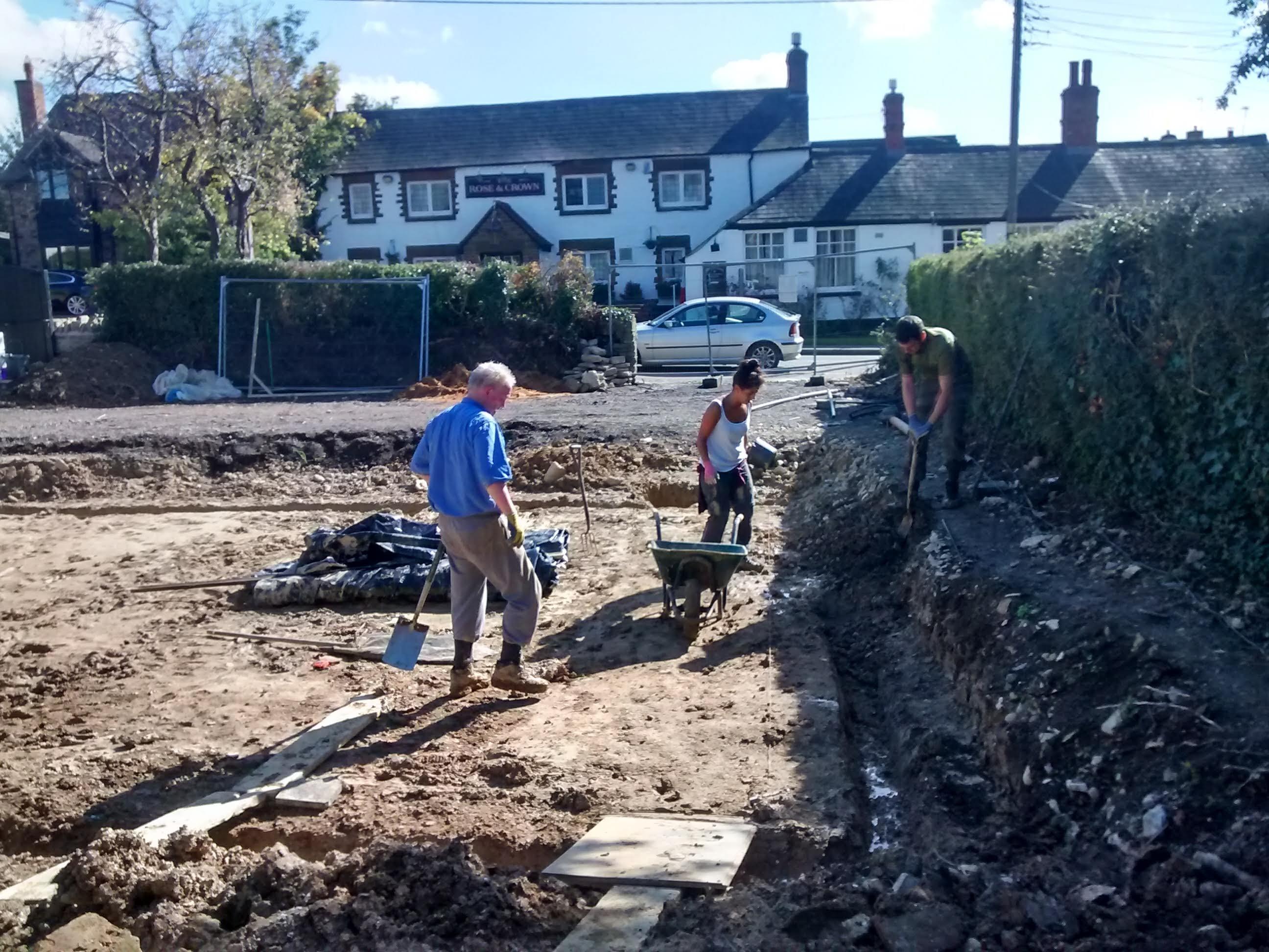

JanetE Posted January 9, 2019 Posted January 9, 2019 (edited) We have the same slab as @JSHarris all done by MBC. We are on clay and before the slab was laid the area was basically a lake as the water table is high. We were advised by the MBC engineer to lay a land drain 1m out around the area of the slab which we did in advance of laying the slab as you can see from the attached picture. This has done the trick as we have no problem at all now. Edited January 9, 2019 by JanetE 1
