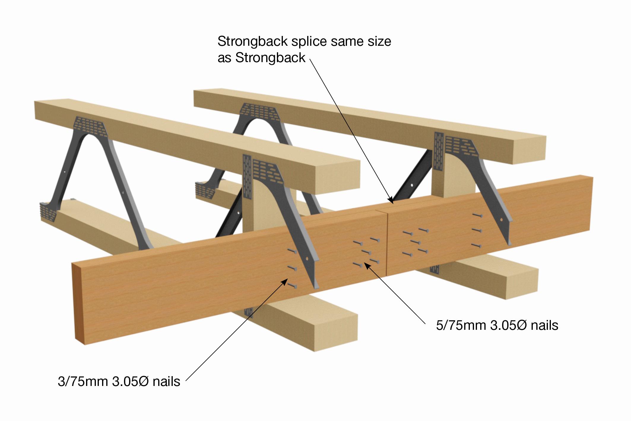

ToughButterCup Posted December 13, 2018 Author Posted December 13, 2018 @Big Neil, that's a Meat Head. Here's a strongback, @Moira Niedzwiecka Its a bit like a spine.... Ian
jamiehamy Posted December 13, 2018 Posted December 13, 2018 I nailed mine first as per diagram. Then coach bolted. Difference was noticeable. No reason why not other than services as mentioned. Belt N braces.

ToughButterCup Posted December 13, 2018 Author Posted December 13, 2018 2 hours ago, Moira Niedzwiecka said: [...] Any thoughts? The guidance I have read about strongbacks (in the context of both Easy Joists and POSIs) is that a strongback can only be installed during the construction of the floor - while the joists are exposed.

Ferdinand Posted December 14, 2018 Posted December 14, 2018 16 hours ago, recoveringacademic said: @Big Neil, that's a Meat Head. Here's a strongback, @Moira Niedzwiecka Its a bit like a spine.... Ian Looking at that diagram, I'd say that Strongbacks are as much about dampening vibration, as they are about reducing deflection. F
