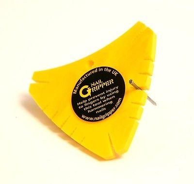

Onoff Posted December 5, 2018 Share Posted December 5, 2018 A bit late for some... https://www.ebay.co.uk/p/Nail-Gripper-Grips-Nails-Whilst-You-Hammer/28005957839? or https://www.prezzybox.com/nail-it-finger-saving-nail-holder.aspx? etc Link to comment Share on other sites More sharing options...

PeterW Posted December 5, 2018 Share Posted December 5, 2018 I used to have a rare earth magnet glued on the end of a pencil - poke into bag to pick up a nail and easy to move out when I’d hit it once. 1 Link to comment Share on other sites More sharing options...
ToughButterCup Posted December 5, 2018 Author Share Posted December 5, 2018 Hmmmm, every challenge an opportunity. Let's see if I still have 6 working fingers after they are all in (935) ? Link to comment Share on other sites More sharing options...

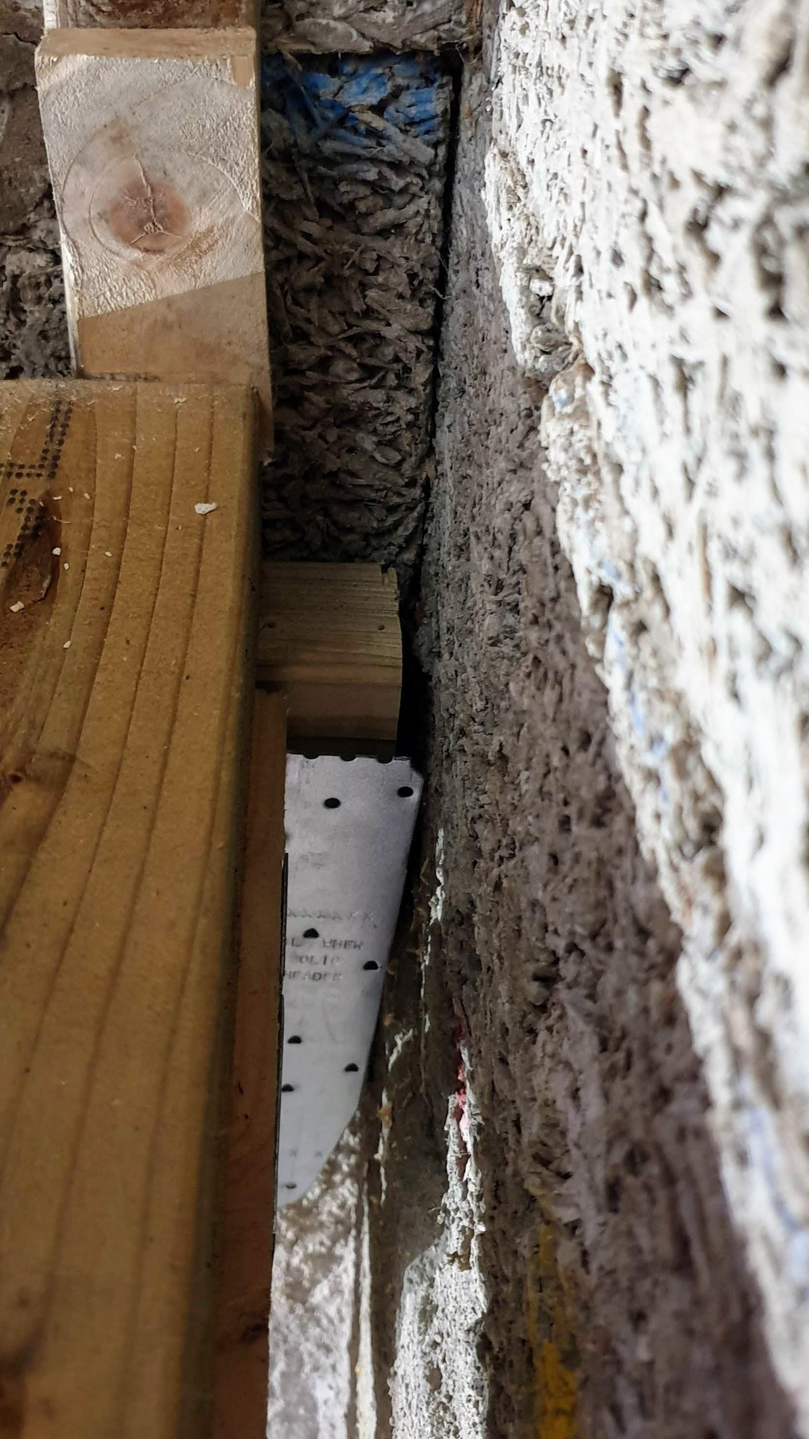

ToughButterCup Posted December 10, 2018 Author Share Posted December 10, 2018 And now down to practical nitty gritty bits.... The guidance from POSI says leave a 50ml gap between the wall and the first joist. Hmmmm.... look at this There's no way even an eight-fingered self-builder like me can whack that hanger in place. So,erm ? Put the hanger in first? Get Debbie to do it? Put up with the moaning and gurning? Its only the end of run / beginning of run joists that'll have this little quirk. Link to comment Share on other sites More sharing options...
ProDave Posted December 10, 2018 Share Posted December 10, 2018 The problem is nailing the hanger to the joist down that gap. So nail the hanger to the joist, slide the joist into position, then nail the joist to the wall plate. A magnet on a stick to hold the nail, and 50mm is enough room to swing a hammer. P.S. To me the hanger looks too short. Every one I have done, the hanger is long enough to fold over at the top and also nail into the top of the wallplate 1 Link to comment Share on other sites More sharing options...

joe90 Posted December 10, 2018 Share Posted December 10, 2018 (edited) I’m with @ProDave on this one, and have done this myself, hanger fixed to joist first, difficult to hold the nail but you can swing a hammer in a 50mm gap. I like the magnet on a stick idea ?, wot about https://www.amazon.co.uk/dp/B001C7NN86/ref=asc_df_B001C7NN8657405348/?tag=googshopuk-21&creative=22110&creativeASIN=B001C7NN86&linkCode=df0&hvadid=309816003291&hvpos=1o2&hvnetw=g&hvrand=7569780515085895972&hvpone=&hvptwo=&hvqmt=&hvdev=t&hvdvcmdl=&hvlocint=&hvlocphy=9045292&hvtargid=pla-425415221212&th=1&psc=1 Edited December 10, 2018 by joe90 Link to comment Share on other sites More sharing options...

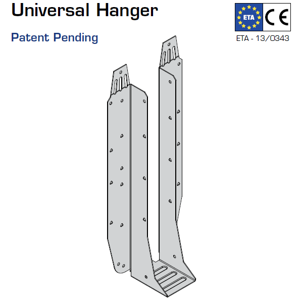

ToughButterCup Posted December 11, 2018 Author Share Posted December 11, 2018 13 hours ago, ProDave said: [...] P.S. To me the hanger looks too short. Every one I have done, the hanger is long enough to fold over at the top and also nail into the top of the wallplate The BCO and I both asked Cullens (hanger manufacturer) about that and were assured they are correctly designed Link to comment Share on other sites More sharing options...

ProDave Posted December 11, 2018 Share Posted December 11, 2018 7 minutes ago, recoveringacademic said: The BCO and I both asked Cullens (hanger manufacturer) about that and were assured it was correctly designed It might be "correct" but I always tend to over engineer things and I just like the security of the hanger folded over the top of the wall plate and a few more nails to keep it there. 1 Link to comment Share on other sites More sharing options...
ToughButterCup Posted December 11, 2018 Author Share Posted December 11, 2018 Hmmm. There's a bit of me which thinks I should screw doublers to the ends of the joists. Maybe a triangle of plywood (right angle triangle) either side of 'endplate'.... hard up against the wallplate. Link to comment Share on other sites More sharing options...
