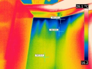

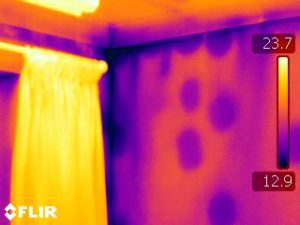

Jeremy Harris Posted November 18, 2018 Posted November 18, 2018 It's near-impossible to stop cold air getting behind dot and dab plasterboard without sealing the blockwork, as several tests have shown. The main problem is that blockwork is inherently porous, especially at the corners of mortar joints, so air will flow through and around any slight gap behind the plasterboard, bypassing any insulation that may be in the cavity. Doesn't really matter how you do the dot and dab, this will always be a potential problem, although using continuous beads on all edges and around all openings makes a slight improvement. Parging the blockwork before applying the dot and dab plasterboard is probably the cheapest and quickest fix, as that should seal up any porosity at source. Easy to test to see whether cold air is getting behind the plasterboard, just point a thermal camera at it on a day when there's a cold wind blowing. If it looks like this then you may as well not have bothered putting insulation in the walls:

Jeremy Harris Posted November 18, 2018 Posted November 18, 2018 1 minute ago, Ed Davies said: My opinionated opinion: airtightness testing should be done before the insulation, let alone the plasterboard, is installed. The only exception to that might be for a design where the insulation forms an intrinsic part of the airtightness, such as when pressure blown cellulose or a thick layer of a spray foam like Icynene is used. Both these types of insulation are highly resistant to "wind wash", so contribute a fair bit to the airtightness of the structure. 1
