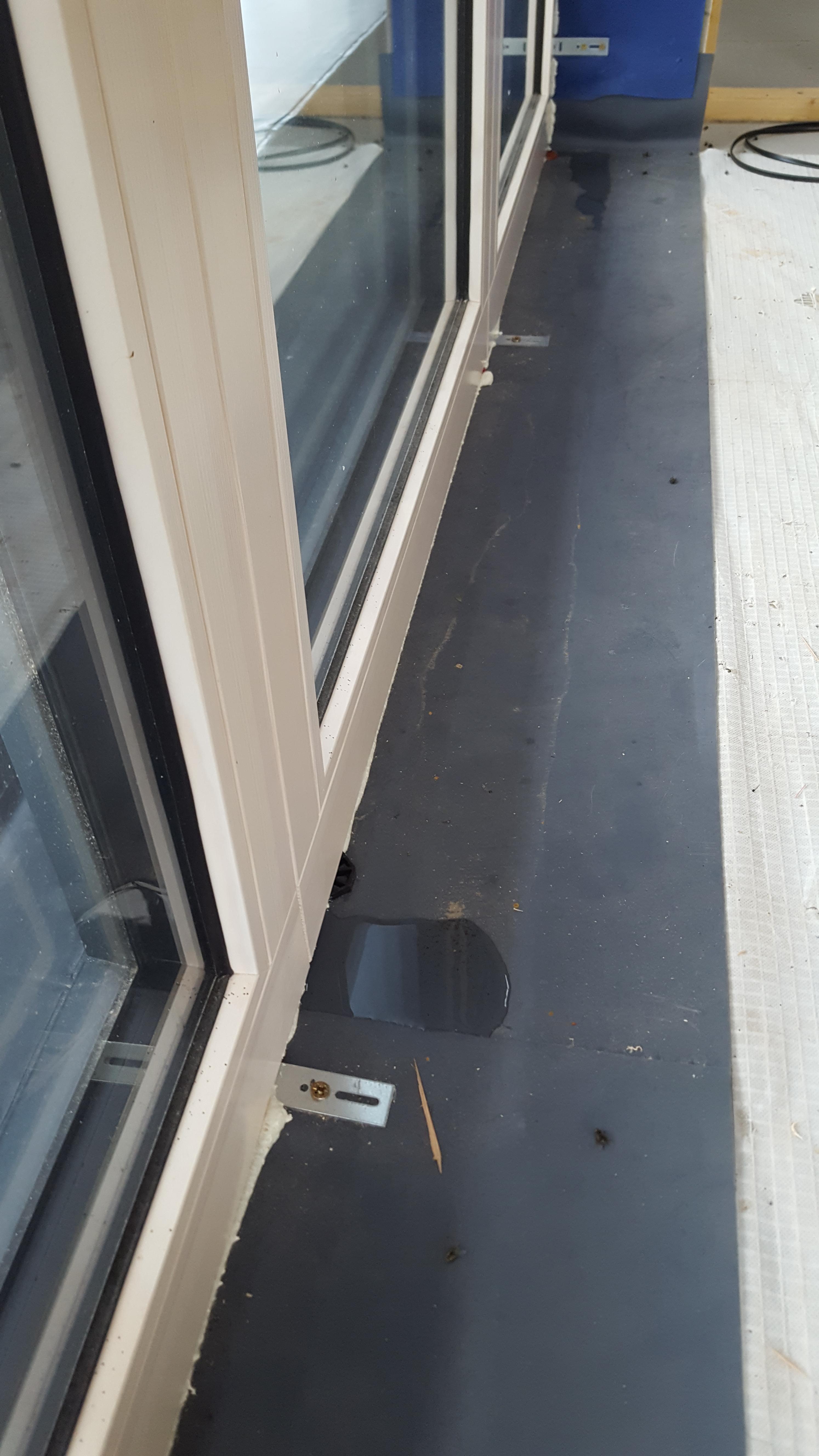

Am re-opening this in the hope of some help / advice.
Got home tonight to find this:
GmlC8fwIi68KDz7dbrtEFp5OriJq_o-bKgJ9PcQ7wSQwHU5hPS_rWZ-r6zcwg2rj47TsRYEtkgRTJAaabOP0ANlHw5jykZ0LnmYr542qh0xzgyV5WTcaLwziJ5Q81eZr8dwP3ZpENWETWQ0bdUCE7FFdUKuLA2XipIjO0hHcoGXLv3mhFqSl8BY4_uf_QA0kxDaeBRa8WQXz1BSkzbKxxxDeKNvx2rm50ef4_XmyegE8Pb3e0DgG3EWLAykOGG9B6NiueRaaax1nlQtOz5Nk1jVw6BZFrI3OlqpaoApzywdeDZcK57IIESRkanZvY5ufTDJV6R0EeEuj3bqLni7hicDF2OSIlqW4VWXA1QP42ACZZ43xw-Ij1MsSUQ2O2Z7frqHPuCDh2KWf36HxKfPRCSgwhtzpgdEsMZtdV1qTIa7lEhx_DrIGJLnwb2K3t592NruMZeQXNRDPAHxUHAGo7Keg7azaoyE_ZXkjp7z-4txdJKD1FtMm0HjazyzUmhKVW2aH8AFSHzMHTjFmsXaeXG-HsQnoFj79jf9_8NjFzSK3biXq7DGr0l09cdQ8xQh2RfD-Xr4OlU1k8Vu3ln3ujHdQXeppX6TP6JkN6_R1CnIG4evgQWaj4DKpU2PBCCBQw7TFajcYhSddRl38IeOjIBzoLQ=w704-h938-no
MBC frame and slab.  All battened out and air tested (when I get time I will update the blog).  Insulation being blown in and some had collected in the corner and under the sliding door (to the right of this photo) and was sodden after the rain today.
House still not rendered but don't think it is this as the render board is on in this location and its alot of water.  So looked outside and saw this:
0SPGBftaHYIbQLLOFdTyVccWYuXhO1v2K7V0ddBNltjO3CIiSEYvpLGrt8bKi1rNBwZlsyu6zpsvIb8BezM3k0XyCoa-sVUes5zx21cYp9jq0G0ELlJeg1BZY68qDTkbv2VQbBZnyLI5YSt-ovxzCFrW5Lc7yAblmz_8Ay_zwaaxXGnnxEKFDdY_2e1nzeLCF1EZT7Uvza_Je_HBdT7ULXVu0LVXSQQOptvQaDPmXOZI3iTkmZVtRaAz87PuXkLkrx1NumyK1GajTy5MWk4EMq-kqwYSpZxrpBrI2I78JqvNkSk_h0oDMPkluJ-jEF1vnOlt5BSJ8C2T2iRnYP9UK-h1Fshwj3n-YLHkFLHV3Q_qutiq3P1x7PRMQ6Sj-ocek5Rvz3Id4deidIvzhkYWpQqcGgixWYd6xdSxt0djG17Tw2mZkLNXvYe573637dhpPJT7EgepXZz6fgKdYTth6dfzsMyQAFhPnRH7md-v6t1Ng2SkJN2xd_8aCoWx3jDnJu9yC1NlIc_jcO9nMaNoH8-dcIck3Yy7PWd0vrAVBwwpH-W_Qer9vL1FPpwEhgHjn7aLqGIQ7FZeqe2xTiHf3-P-Y2Mim0BXiSF1q5vsEeufmRfZybQEK_HubZTL8ibQ8P_c0ZxTPrH7Fllen7jccwM0Vw=w704-h938-no
Apologies for the photo in the dark.  This shows the EPC from the foundation, the DPC over the top of it, and then the sliding door cill sitting on top of that.  We poked a tissue in the gap between the DPC and the cill and it was sodden so I think we have found the issue.
Any tips on how to solve it please?  How do we seal this?

I'd be tempted to peel the dpm/membrane back and run a decent bead of clear ct1 along the full length where it meets the window (dry it and clear all dust/debris). With your finger, run along it and make sure its pushed right down into the concrete. That should provide some respite, however the main issue appears to be the fact there's a vertical dpc but nothing to stop water travelling horizontally, hence your issue. The above will go someway to help but you need to get the edge of the membrane sealed properly. Possibly then get rubbery mastic and paint it thick over the concrete and embed the rubber down onto it.
On the inside where I could see foam under the window, I'd be tempted to push that in under the window/compress it, and again, a good bead of ct1. I did that there for an almost identical issue. Never leaked again even in driving rain.
(I should add, I had this issue twice both at the level thresholds)
Link to comment
Share on other sites
Window fitter came out and suggested trimming down EPS so water naturally runs away from the window on top of the DPC rather than in under the window. So will do that. Then clean and dry it and use @jamiehamy sealant tip. And then mastic the hell out of it.
The inside has already been latexed in so no access to the underside any more. In a way we are pleased that we have been able to see the effects of heavy rain before doing any internal finishes.

Should this not have been done before the doors went in.
I thought it would be standard practice to have a 5 degree slope on a cill with a cill pan installed
and then seal window onto cill pan.
Link to comment
Good point @Russell griffiths wish you had been supervising not only my window install but also slab pour when no cill pan recess was created.
Have no idea on Weebles install but ours had no cill pan and was just stuck straight onto the slab, no provision for drainage at all, ours were level thresholds.
We ended up having to cut out the eps and some of the slab and then get waterproofing membranes under as best we could (as with weebles inside was already stuck down).  Then as stated mastic etc.  The threshold underside drainage holes on ours had to be left exposed so water can drain ....I am left with level thresholds 10mm off the ground, still hoping someone will come and be able to fix this for me.
