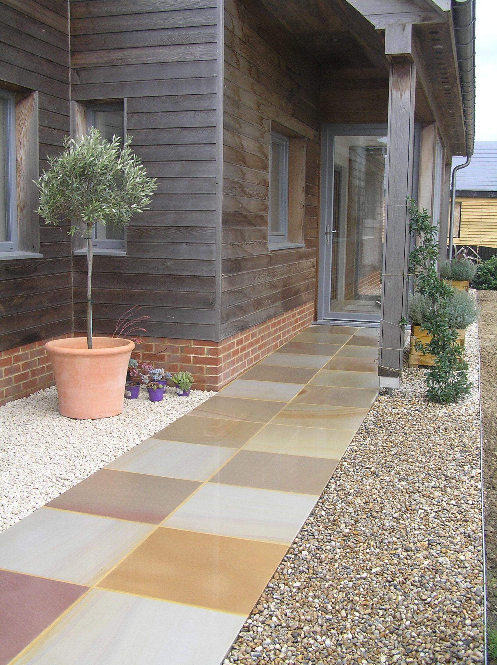

Jeremy Harris Posted September 23, 2018 Posted September 23, 2018 The only one I have of the ramp to our back door is this one that shows our solar powered outside lights. The furthest light is over the back door, so you can just make out the flat paved area there for turning a wheelchair more easily. The black recycling bin is sat off the ramp on the gravel that's all around the house. The wheelie bin flat area is where the lump of left over foundation EPS and other rubbish is sat, at the bottom right. This photo shows the front steps and in the background the start of the ramp from the end of the drive, again it was taken to show the solar outside lights at the front. My car is parked a lot closer to the front door is this photo that it normally is; where it's normally parked there is loads of space to get a wheelchair, wheelie bin or whatever past. You can just make out the wheelie bin storage area, behind the timber screen fence in the background, where the ramp turns around to run up to the back door:

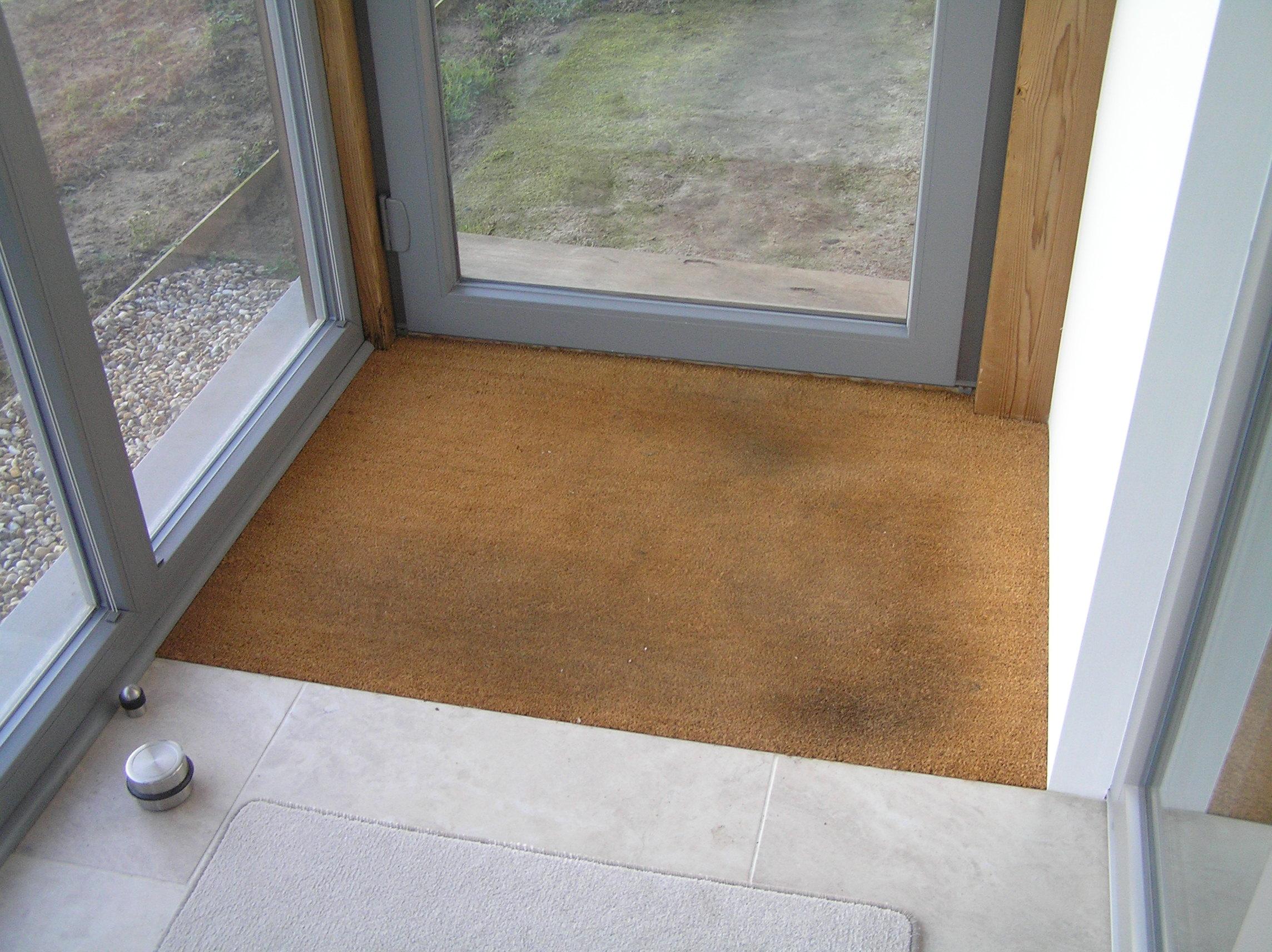

joe90 Posted September 23, 2018 Posted September 23, 2018 I am just about to sort the floor to our new front door and porch which is our level access, er indoors wants a good thick front door mat but these are nearly 20mm thick and we are only allowed 10mm upstand from tiled floor to door threshold.
Jeremy Harris Posted September 23, 2018 Posted September 23, 2018 8 minutes ago, joe90 said: I am just about to sort the floor to our new front door and porch which is our level access, er indoors wants a good thick front door mat but these are nearly 20mm thick and we are only allowed 10mm upstand from tiled floor to door threshold. The solution I've ended up with is to use thin (6mm) microfibre mats. The smaller ones weren't great, so we've ended up with ones that are wider than the front and back doors by a fair bit, as these stay in place better on the travertine flooring. What I should have done is left mat wells by both doors, so that thicker doormats could have been dropped into them, but at the time we were having the floor tiled it hadn't occurred to me that mats would be a problem.
newhome Posted September 23, 2018 Posted September 23, 2018 14 minutes ago, joe90 said: I am just about to sort the floor to our new front door and porch which is our level access, er indoors wants a good thick front door mat but these are nearly 20mm thick and we are only allowed 10mm upstand from tiled floor to door threshold. You’re lucky. I wasn’t allowed anything. Threshold had to be level with the tiles. Apparently rolling a wheelchair could be dangerous ? over a 10mm drop. If a wheelchair rolls away due to that they’d have a lot more difficulty getting from the parking area up to the front door where the disabled access is!
PeterW Posted September 23, 2018 Posted September 23, 2018 2 minutes ago, JSHarris said: What I should have done is left mat wells by both doors, so that thicker doormats could have been dropped into them, but at the time we were having the floor tiled it hadn't occurred to me that mats would be a problem. I fit mat wells into flooring as it looks better - usual problem though is the edging and I’ve now got a good local supplier of stainless angle who will TIG and polish the joints for £10 each. 1

Gone West Posted September 23, 2018 Posted September 23, 2018 Our neighbours were told they had to fit a permanent access ramp before sign off. We devised our ramp as part of our landscaping design. The first part of the paving is flat up to the edge of the house then it slopes gently over the next 3.5m up to the porch door. The BCO was happy as long as there weren't any steps greater than 15mm high. 2
nod Posted September 23, 2018 Author Posted September 23, 2018 2 hours ago, JSHarris said: The only one I have of the ramp to our back door is this one that shows our solar powered outside lights. The furthest light is over the back door, so you can just make out the flat paved area there for turning a wheelchair more easily. The black recycling bin is sat off the ramp on the gravel that's all around the house. The wheelie bin flat area is where the lump of left over foundation EPS and other rubbish is sat, at the bottom right. This photo shows the front steps and in the background the start of the ramp from the end of the drive, again it was taken to show the solar outside lights at the front. My car is parked a lot closer to the front door is this photo that it normally is; where it's normally parked there is loads of space to get a wheelchair, wheelie bin or whatever past. You can just make out the wheelie bin storage area, behind the timber screen fence in the background, where the ramp turns around to run up to the back door: Very nice and more practical than some of the ramps you see outside public buildings More of a gradual slope Thanks
