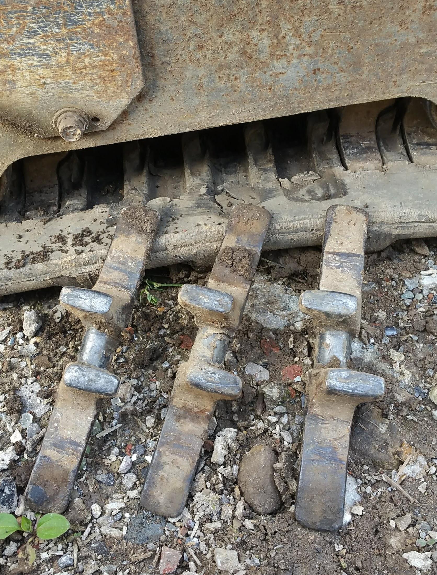

ToughButterCup Posted September 11, 2018 Posted September 11, 2018 It was all going too well. Made myslef a nice big hole, popped the poo tank innit, (?) made myself a nice ramp up and down which to choogle the ballast and 20mm stone. Digger going nice. Then click, bump, click, bump, click . Tek naw notice: noisy + bumpy anyway. Looked down: whassat? And that, and that? See for yourself. Bugger. New track I bet eh @Russell griffiths, and @Construction Channel ?

Declan52 Posted September 11, 2018 Posted September 11, 2018 It didn't damage any of the guiding wheels. Have they worn away that much that the steel teeth popped out or did it just rip.
Ferdinand Posted September 11, 2018 Posted September 11, 2018 I take it those are track-articulations rather than scoop teeth. Desperately hunting for consolation, did it happen to be in a useable position when it broke?

ProDave Posted September 11, 2018 Posted September 11, 2018 What am I seeing in that picture? It varies from machine to machine, but mine was like big links of a chain with strips of metal riveted on to form the "treads" Has the track actually "snapped" or is is just these bits fell of but the "chain" is intact? Can I see a picture of where they came from? You can lift that side of the digger by pushing down with the bucket to allow the track to run free in mid air to assess the damage and rotate the damaged part tot he top to fix it. At one point when idly searching on ebay I found someone breaking the same digger I had, and should I have needed it he was selling a pair of tracks for £500
Jeremy Harris Posted September 11, 2018 Posted September 11, 2018 Some continuous rubber tracks just have the driving teeth moulded in when they are made, so the steel is bonded to the rubber a bit like the way an engine mount is made. Those driving teeth have been loose in the track for a while, I suspect, and have now made a bid for freedom, almost certainly buggering up the track itself. Having said that, I once repaired a broken engine mount by using Sikaflex to bond the steel bit back to the rubber bit. That worked OK for a year or so, and was still OK when I sold the car. Not sure if Sikaflex would bond a digger track, though, there's probably a fair bit of damage where the loose teeth have torn out of the rubber.

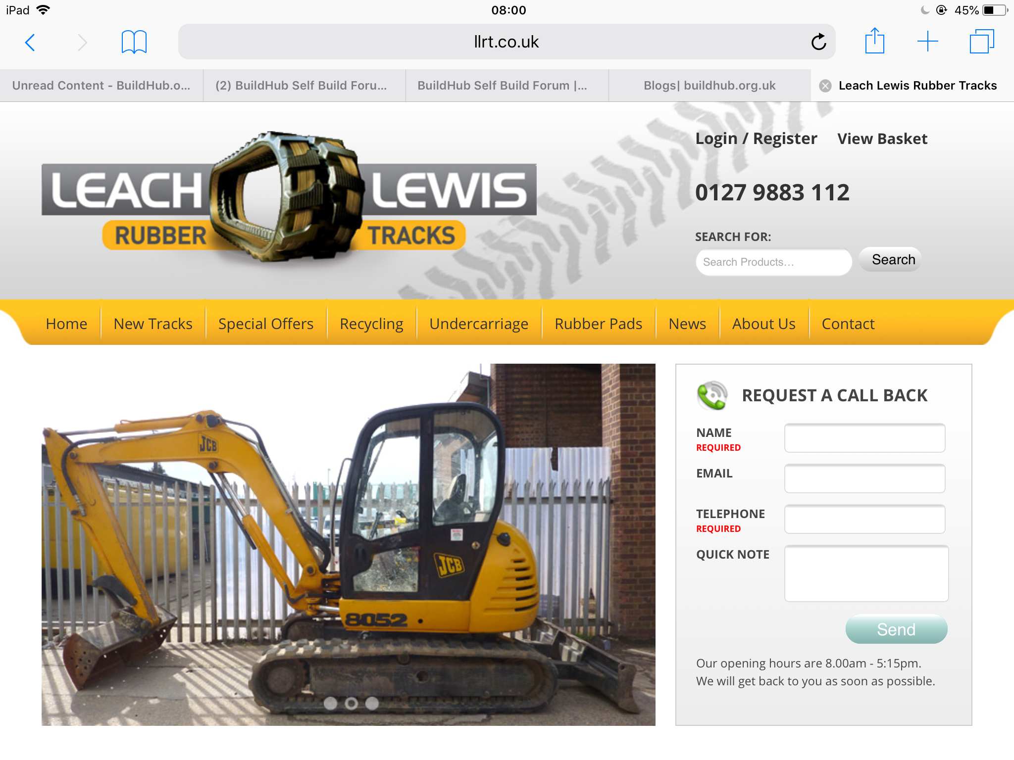

Russell griffiths Posted September 11, 2018 Posted September 11, 2018 I have just put two new ones on mine i will find the company out, if your not using it to earn a living, then I see no need to have top of the range tracks, cheapies will probably last you years.
ToughButterCup Posted September 12, 2018 Author Posted September 12, 2018 On 11/09/2018 at 22:16, Russell griffiths said: I have just put two new ones on mine i will find the company out, if your not using it to earn a living, then I see no need to have top of the range tracks, cheapies will probably last you years. Expand Thanks. Errrrmmm, by the way , what's with the less-than-instant-response , you had me worried for a minnit.
Russell griffiths Posted September 12, 2018 Posted September 12, 2018 Sorry been on holiday then delayed on a plane with NO BRAKES FOR 6 hours. Will find receipt soon.
Russell griffiths Posted September 12, 2018 Posted September 12, 2018 @recoveringacademic This is the company i just had mine off, very quick service, cheapest I could find. If you get some let us know if you need a hand changing it. I brought a pair as both both of mine are fairly worn, but you can get away with one if you want to save a couple of sheckles
