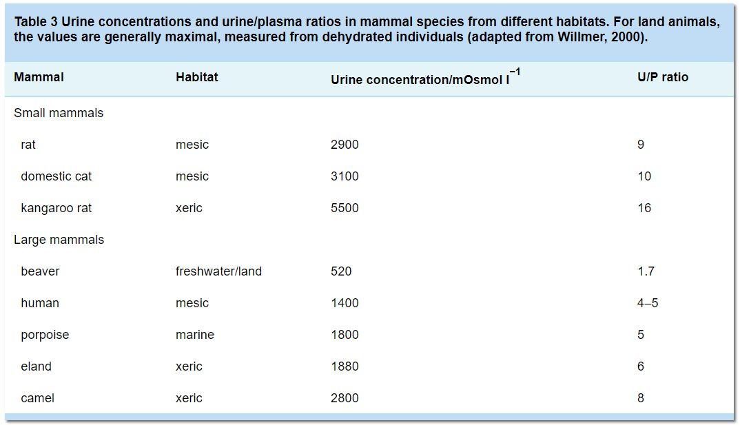

Ferdinand Posted November 7, 2018 Share Posted November 7, 2018 On 05/09/2018 at 09:01, divorcingjack said: I have just found myself weeing on a limestone tile sample. It's a new low. In my defence, it was part of an extensive testing regime to see if they will work in our bathrooms, and we have a 6 year old with poor aim and a baby. Anyone got real life experience of living with honed grey limestone? If you *really* want to test this, you need to get a camel to wee on it. Or - more boringly - Tibbles the Cat. Link to comment Share on other sites More sharing options...
