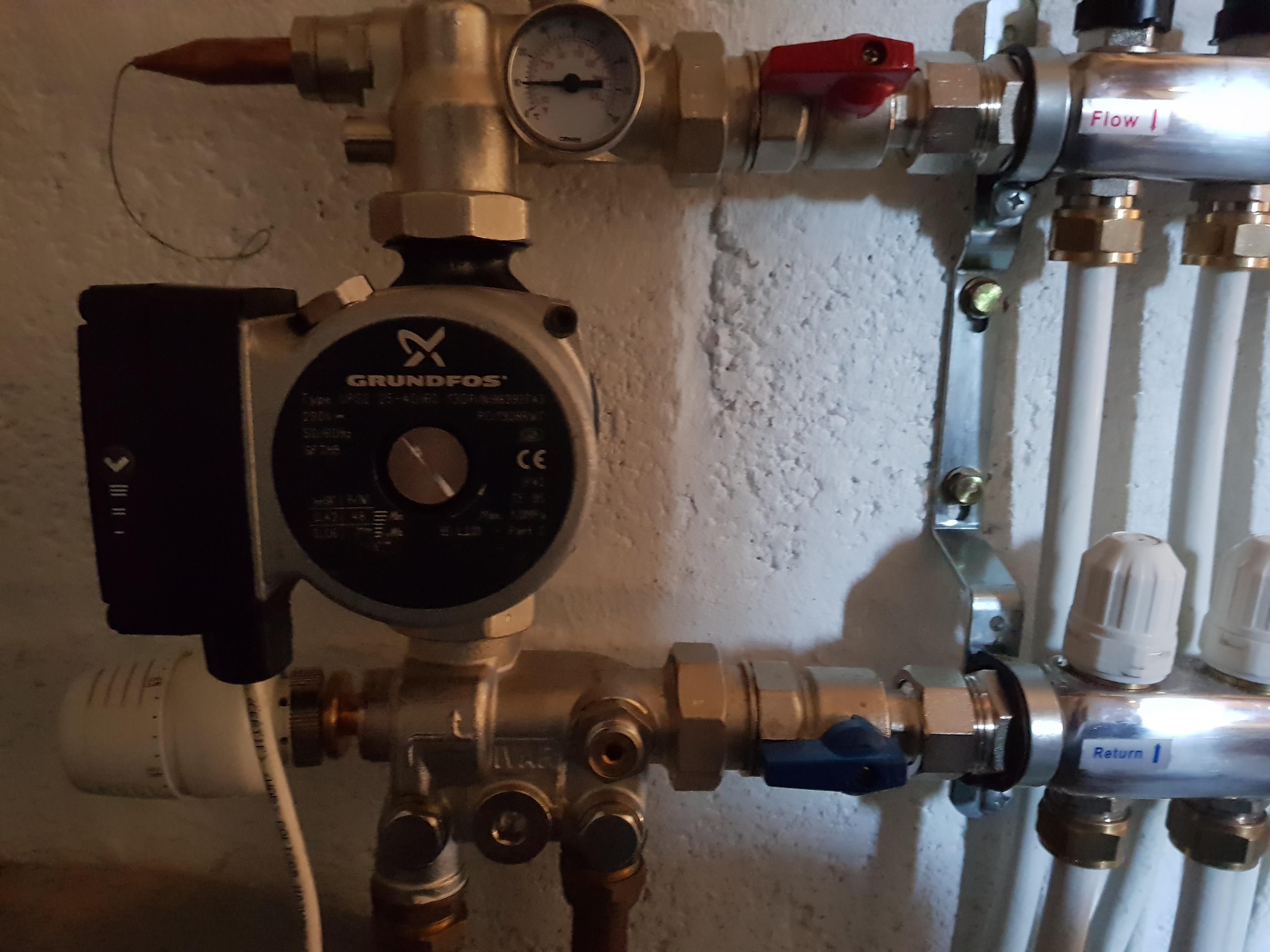

MikeSharp01 Posted August 1, 2018 Author Share Posted August 1, 2018 Thanks all. @PeterW I can make a continuous loop so I may do that and then pressurise it a bit. Thanks @TerryE we have the UFH pipes tied to the lower mesh and pressure testing yesterday @ 7 bar went OK once we found that the pressure tester had a slight leak, one, one more loop to test today - concrete pour is tomorrow so no great exposure for the pipes. Link to comment Share on other sites More sharing options...
Nickfromwales Posted August 1, 2018 Share Posted August 1, 2018 You really would have to be careless or malicious to damage pert-al-pex / pex-al-pex pipework tbh. My screeders wheel full barrows of screed over them and tramp back and forth without even a bump. Ive caught the odd numpty up-ending the wheelbarrow onto the pipe, but it just seems to compress the insulation. Flow rates are typically between 2 and 5 lpm as dictated by the weir flow gauges on the manifold. Pressure can be near zilch, or up over 2 bar and I cant honestly say ive ever heard an ufh pump tbh they're almost silent. If the manifold is between 5 and 9 ports you'll be on pump setting 2. Id recommend the Ivar Dualmix pump and blending set, coupled with a Wunda manifold. The Wunda manifold is telescopic so you can adjust the centres to match whichever 3rd party manifold arrangement you bought. Link to comment Share on other sites More sharing options...
PeterW Posted August 1, 2018 Share Posted August 1, 2018 27 minutes ago, Nickfromwales said: recommend the Ivar Dualmix pump and blending set, coupled with a Wunda manifold. Whats the benefit of this @Nickfromwales as the Ivar is more expensive and the only difference seems to be for a capillary thermostat which is useful on the low temp flows. I think the auto balancing heads are the way forward on a lot of this tbh... Link to comment Share on other sites More sharing options...
Nickfromwales Posted August 1, 2018 Share Posted August 1, 2018 The generic thermostat blending valves fall over when you ask them to run at low temp. They choke the flow when the return temp raises enough to leave no differential temp between flow and return. You cant blend hot with cold if your cold is the same temp as your flow which is exactly what happens when your up to temp. All gravy whilst your cold and getting UP to temp, but when your there the TBV just goes into meltdown. Many who think it doesn't should sit and listen whilst its running and you can hear them whining and attempting to strangle the flow. If you have an adverse installation which requires a primary circulation pump, then be 100% sure to fit a full 22mm gated bypass to allow flow back to the heat source when the TBV has had its fill. This is as always case specific advice and most are PH / similar, so you really need linear heat influx and the Ivar with the capillary blend set does work like a dream. Absolutely whisper silent. I suspect there are cheaper ones, but the Ivar comes with a top-notch Grundfos pump which is super energy efficient ( >A+ iirc ). £300 with the Vodka and Tonic but money well spent imo, and also has in-built adjustable bypass in the control group so one less bit of kit to buy and install.. 2 Link to comment Share on other sites More sharing options...

le-cerveau Posted August 1, 2018 Share Posted August 1, 2018 I used ESBE valves in my setup. VRG 130 rotary valve with a CRA 110 thermostatic controller for the mixing valve. MY setup is custom with one mixing valve supplying the two pumped manifolds. This draws heat from the SunAmp (PCM34) and blends with the return, temp set at 26C and fully adjustable. I also have VRG 230 diverting valves used to select the no-heating required/cooling setup. Not cheap, but totally configurable, though my plumber didn't have a scooby on how to install them and had the inserts 180 degrees out so initially it wasn't functioning as expected. I resolved this by simply removing the controllers, rotating the drive shafts to the correct positions and re-assembling, just a question of reading the instructions! 1 Link to comment Share on other sites More sharing options...
Pete Posted August 1, 2018 Share Posted August 1, 2018 38 minutes ago, le-cerveau said: I used ESBE valves in my setup. VRG 130 rotary valve with a CRA 110 thermostatic controller for the mixing valve. MY setup is custom with one mixing valve supplying the two pumped manifolds. This draws heat from the SunAmp (PCM34) and blends with the return, temp set at 26C and fully adjustable. I also have VRG 230 diverting valves used to select the no-heating required/cooling setup. Not cheap, but totally configurable, though my plumber didn't have a scooby on how to install them and had the inserts 180 degrees out so initially it wasn't functioning as expected. I resolved this by simply removing the controllers, rotating the drive shafts to the correct positions and re-assembling, just a question of reading the instructions! Not many blokes read instructions! 1 Link to comment Share on other sites More sharing options...

Alexphd1 Posted October 15, 2018 Share Posted October 15, 2018 @Nickfromwales Can you confirm which ivar pump has the low temp setting. I bought the above one and it's mim is 35 degree. Link to comment Share on other sites More sharing options...
Nickfromwales Posted October 15, 2018 Share Posted October 15, 2018 33 minutes ago, Alexphd1 said: @Nickfromwales Can you confirm which ivar pump has the low temp setting. I bought the above one and it's mim is 35 degree. You want this one ? Link to comment Share on other sites More sharing options...
