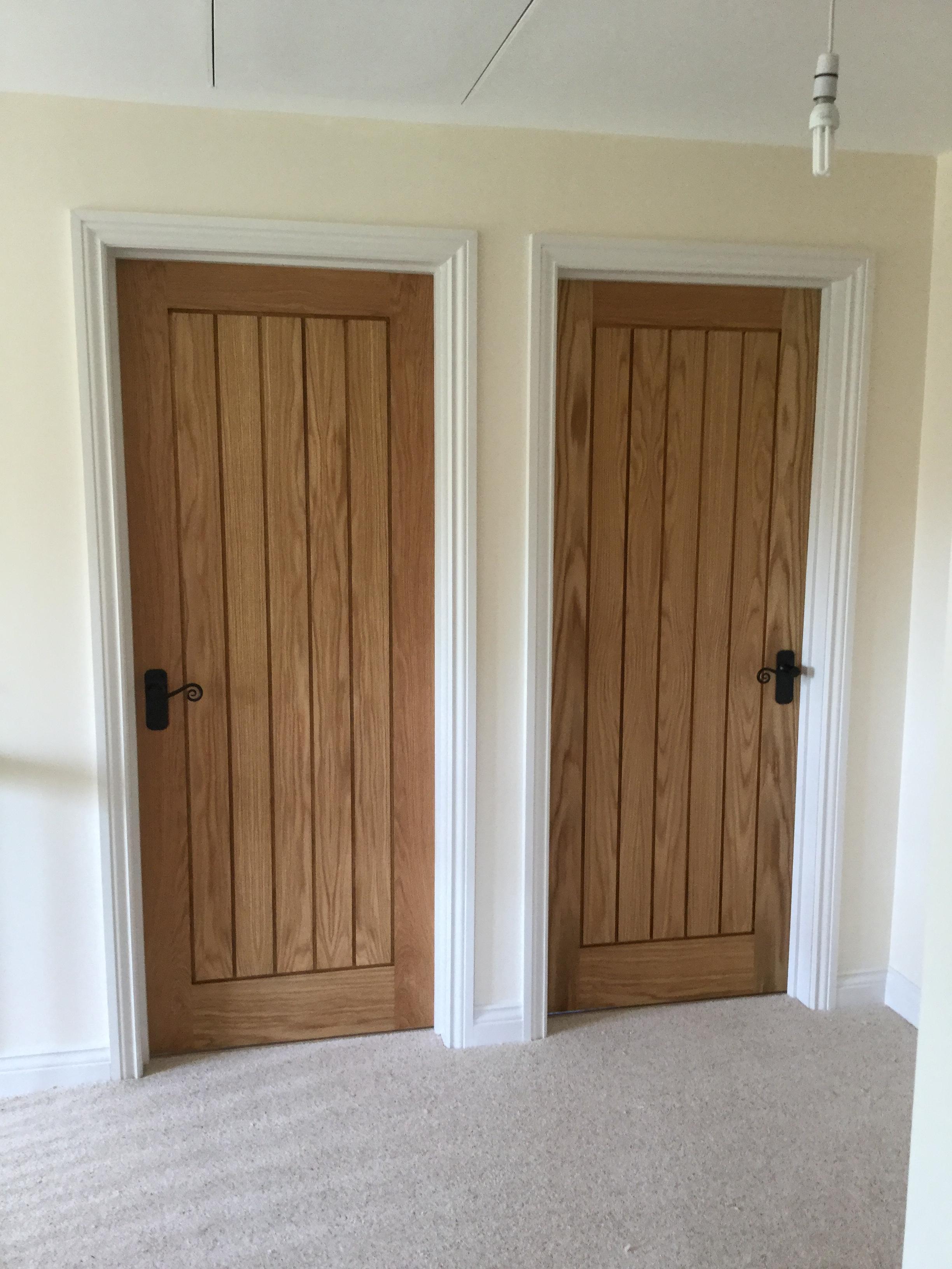

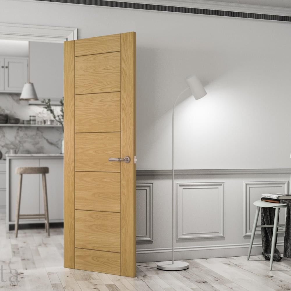

oranjeboom Posted May 17, 2018 Share Posted May 17, 2018 Rightio - about to plasterboard some more rooms but not sure whether to adjust the current door openings (2200 x 930) or leave as is and get chippie to source doors that will fit that size. No idea why architect went with that size bt, but then he often just 'assumed' measurements and this is one I did not spot in time! Door linings will obviously reduce that opening by a bit, but not many online places seem to do doors taller than 2.1 metres. Also leaves me very restricted in their range of doors and i really don't want to be forking out more than £150 for a customised door. Does anyone know of places that do doors above 1980mm? Ideally I am after a panel door like this: or like the one below which goes by various names (Mexicana, geneva, cottage oak...), which @JSHarris and @PeterStarck went for: Again, pretty std at 1980mm. I suspect that it will be cheaper to adjust the openings (in the timber framed walls) to accommodate a std door size, but would really prefer taller doors to 'suit' the higher ceilings (2.6m). I think I've already made up my mind to just got for std 1980 size as I'll be limited in getting ready made door lining kits also....unless someone has a source for a company that does do customised door sizing at a reasonable price?? OB Link to comment Share on other sites More sharing options...

joe90 Posted May 17, 2018 Share Posted May 17, 2018 (edited) I have just installed the doors above like Jeremy etc, and they look fab, I used 2’ 9” downstairs and 2’6” upstairs, had to pack all the openings slightly but this enabled me to get the linings accurate to fit the doors as so many doors have very little to plane off nowadays. Edited May 17, 2018 by joe90 Add photo Link to comment Share on other sites More sharing options...

RandAbuild Posted May 17, 2018 Share Posted May 17, 2018 @oranjeboom we're looking at doors at the moment. The first one you've pictured looks like a Seville. Deanta do the largest lippings of any door manufacturer, allowing them to be trimmed to the opening. They're a good, solid door whether you have them in 35mm or 45mm fire door thickness. But I would say go for a standard door every time - ideally 1981 tall. You'll get by far the best choice (those Deanta Sevilles can be found online for about £112 each, incl VAT) and for any bespoke ones you'll be paying through the nose and waiting 14+ weeks for them. If only we had followed this advice! We have 2 cupboards on the first floor (airing cupboard and MVHR/plant cupboard) that cut into the sloping roof. These will require double doors 1950 and 1886 high, involving trimming them by 100mm. We are pondering whether to have specials made or get someone to make them. I just wish we had made the linings to fit a 1981 door and made life simple. Link to comment Share on other sites More sharing options...

PeterW Posted May 17, 2018 Share Posted May 17, 2018 You can get that Suffolk Oak in 2032x813 as a standard size from Todds for £81 inc VAT Its a standard size - add 60mm all round for linings and you’ve not got much to pack out https://www.todd-doors.co.uk/cottage-oak-door Link to comment Share on other sites More sharing options...

AliG Posted May 17, 2018 Share Posted May 17, 2018 (edited) 9 hours ago, Ferdinand said: I believe metric doors, available from the same suppliers, are 2040mm - 2.5 inches more. Enough? F This is exactly what I did, I thought with 2.7m ceilings I needed taller doors so I went metric. I would have liked 2.2m doors, but was too tight to pay to have them made. I think our openings were around your size to take a 2040mmx826mm door. It is, however, surprising how few doors are available in metric sizes and even fewer fire or glass doors in metric sizes if you need them. I have the walnut version of this Deanta door and they are very nice with the added benefit that they make them as fire and glass fire doors. They are around £100 ex VAT. https://www.leaderdoors.co.uk/doors-c14/internal-doors-c111/internal-oak-doors-c119/internal-oak-fully-finished-seville-solid-door-p38437# Edited May 17, 2018 by AliG Link to comment Share on other sites More sharing options...
Ferdinand Posted May 18, 2018 Share Posted May 18, 2018 I used Geneva pattern to add perceived height to openings which were lower. Link to comment Share on other sites More sharing options...
