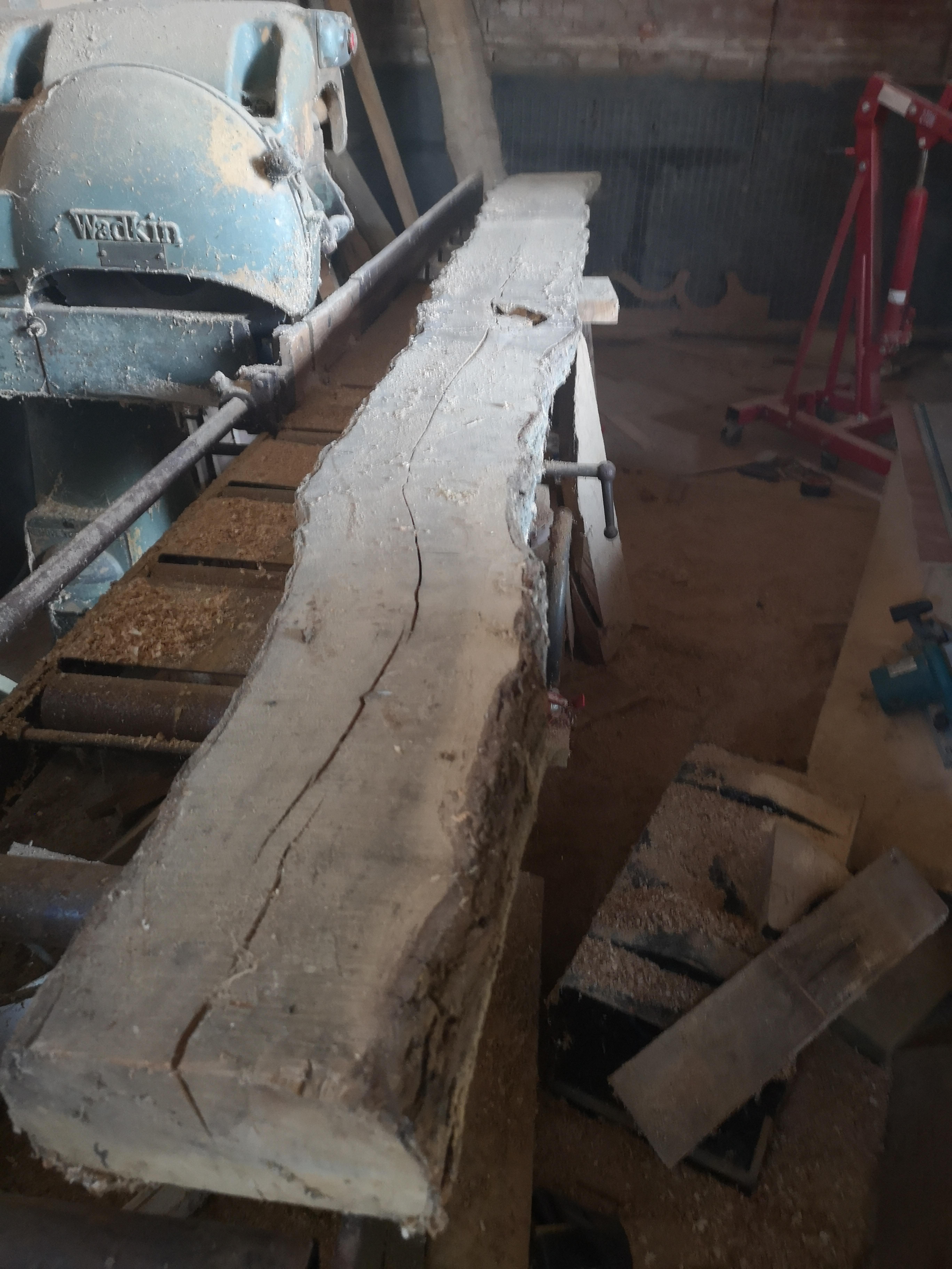

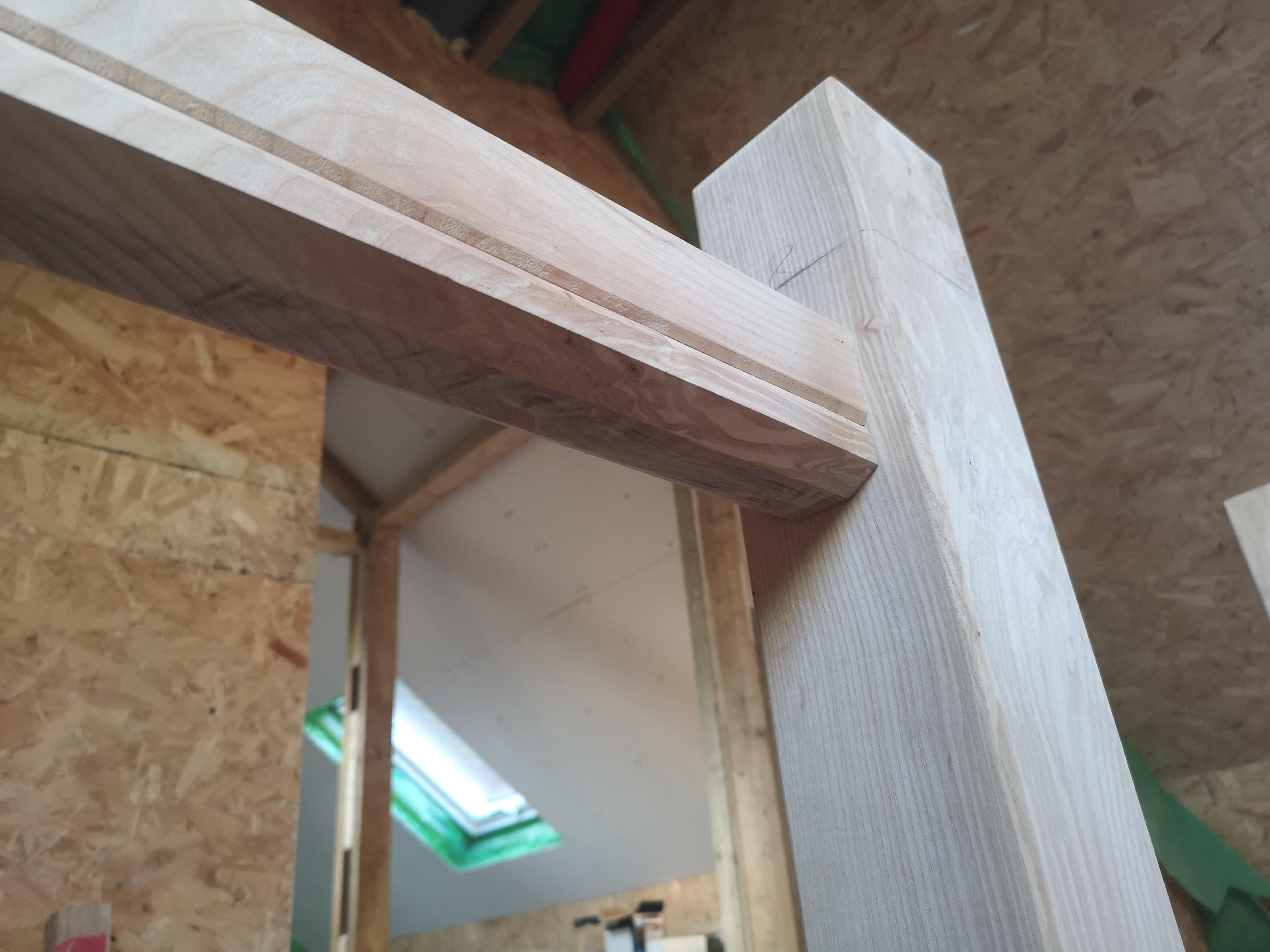

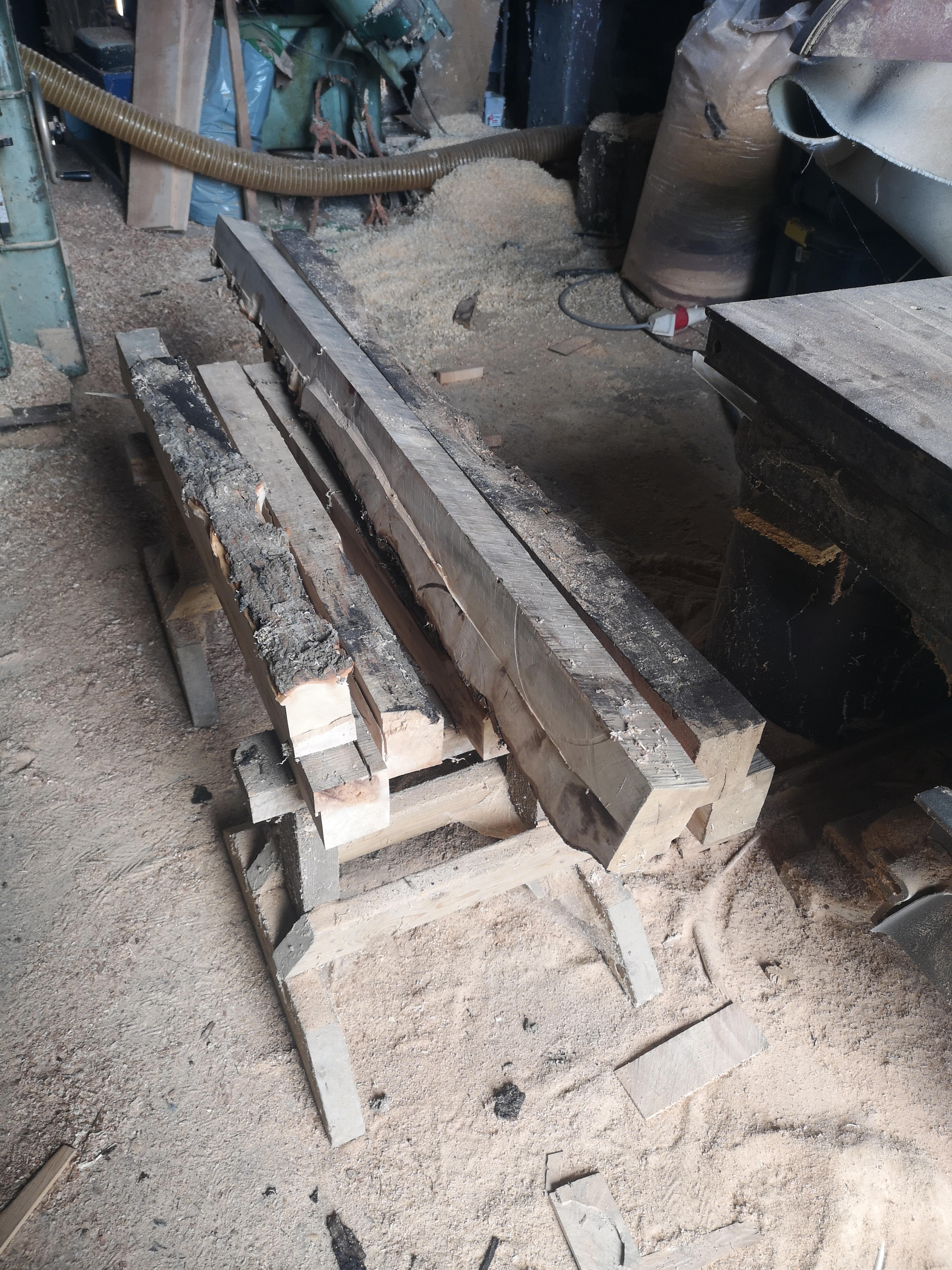

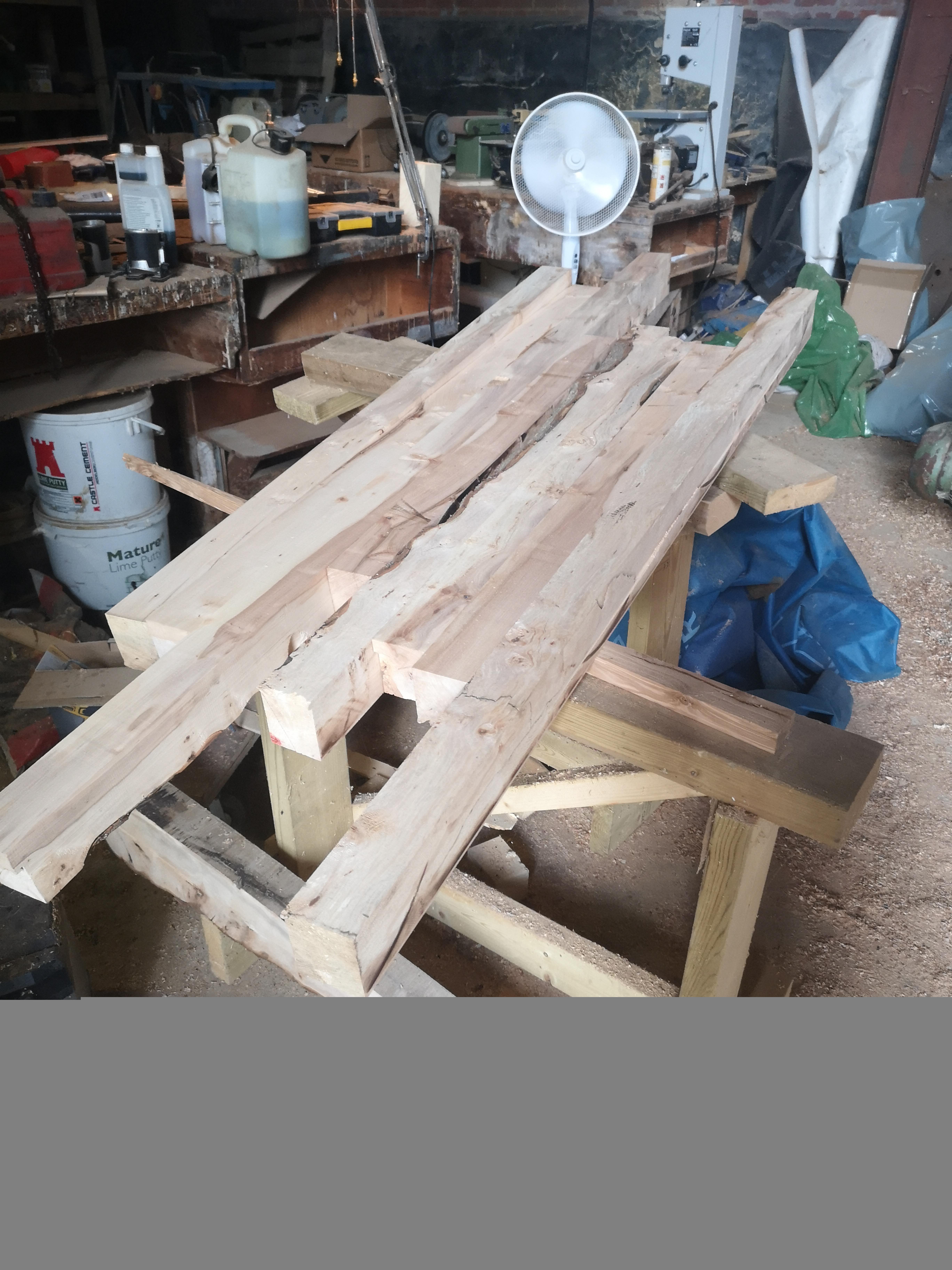

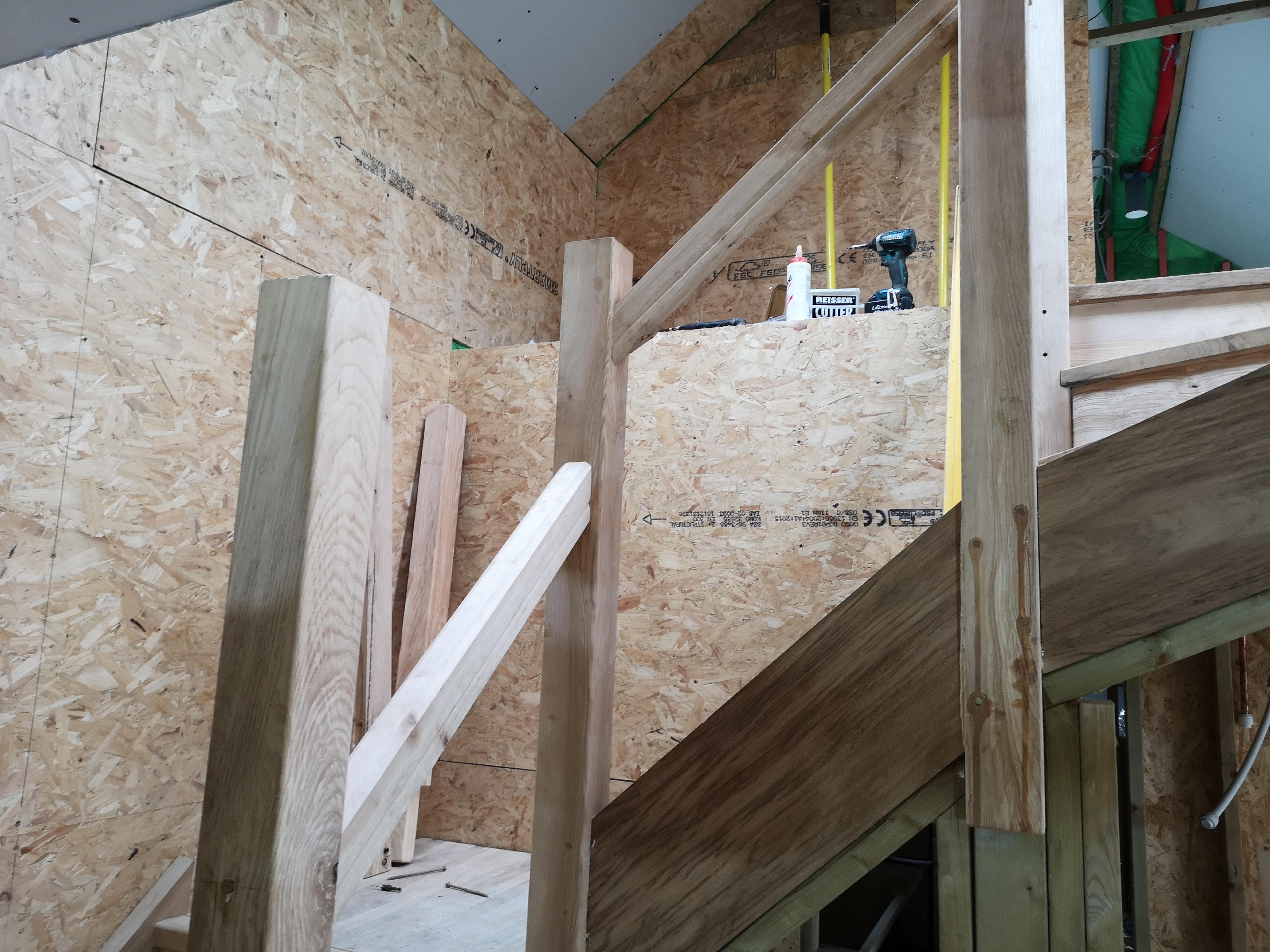

Construction Channel Posted July 6, 2019 Author Share Posted July 6, 2019 I know it's been a while but I have decided to go back to working on the stairs. Annoyingly I just couldn't get enough usable timber out of the elm tree to do everything but I managed to get enough for the stairs. ? I'll probably just use ash for the landing handrails. 5 Link to comment Share on other sites More sharing options...

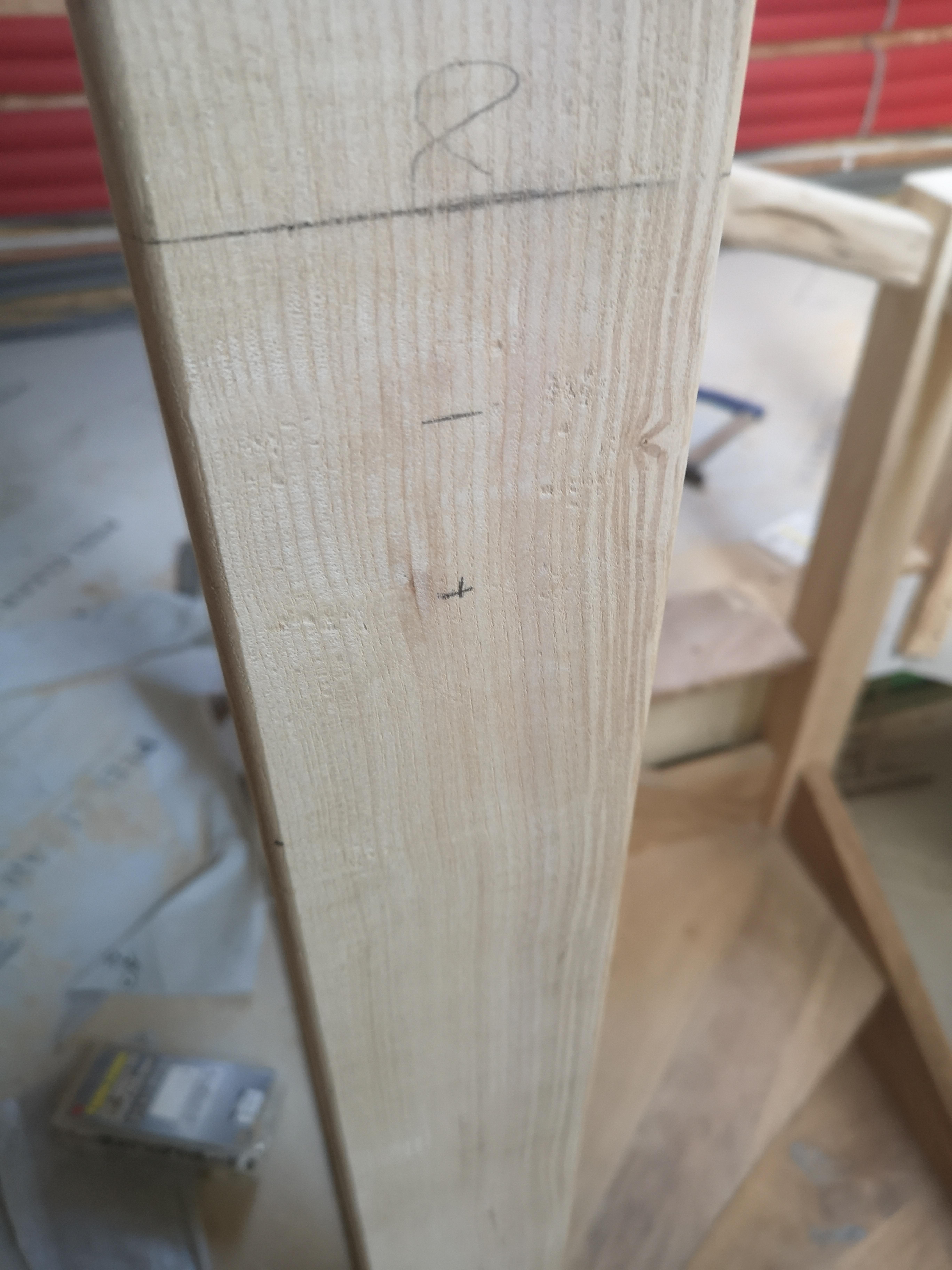

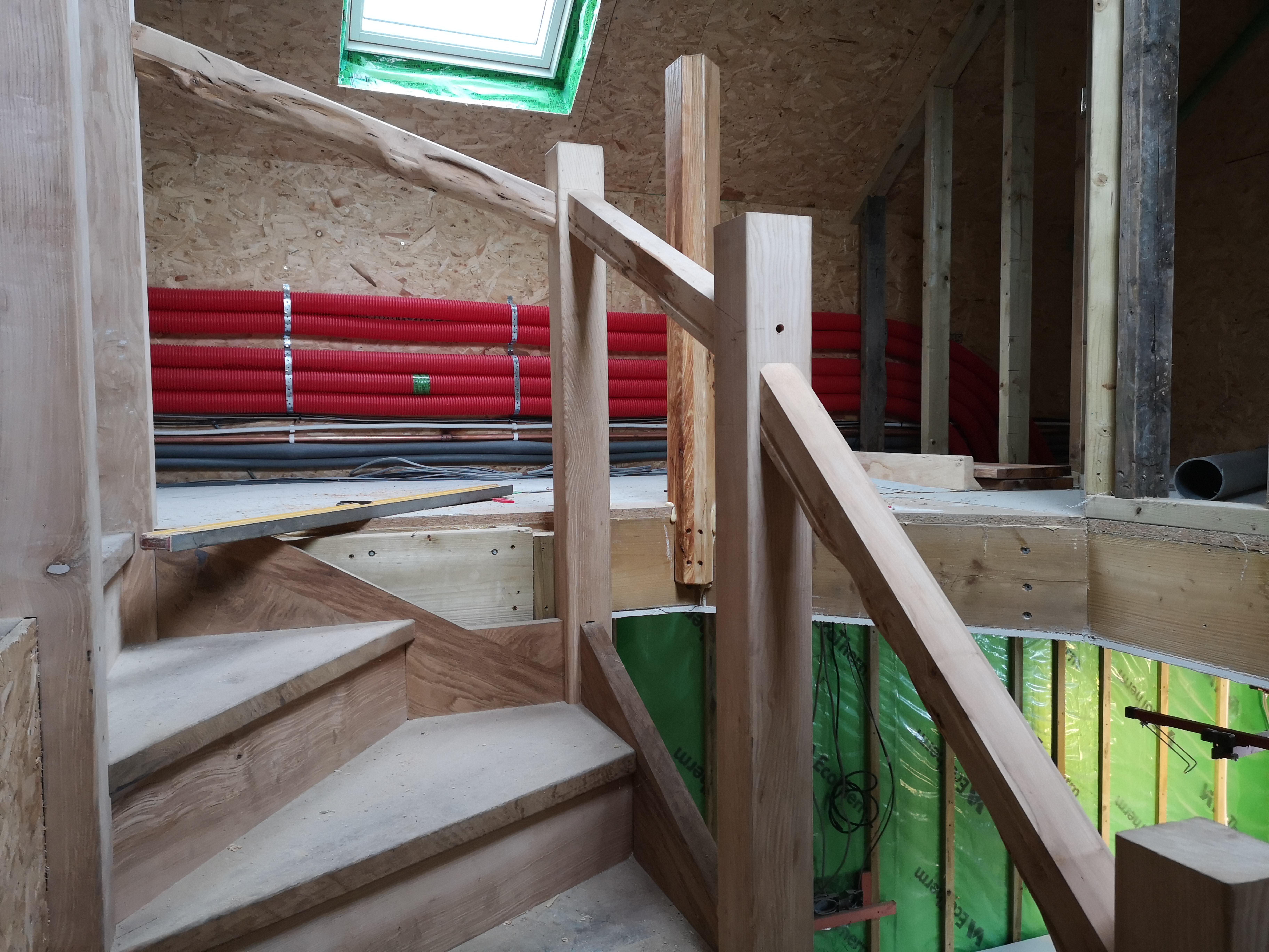

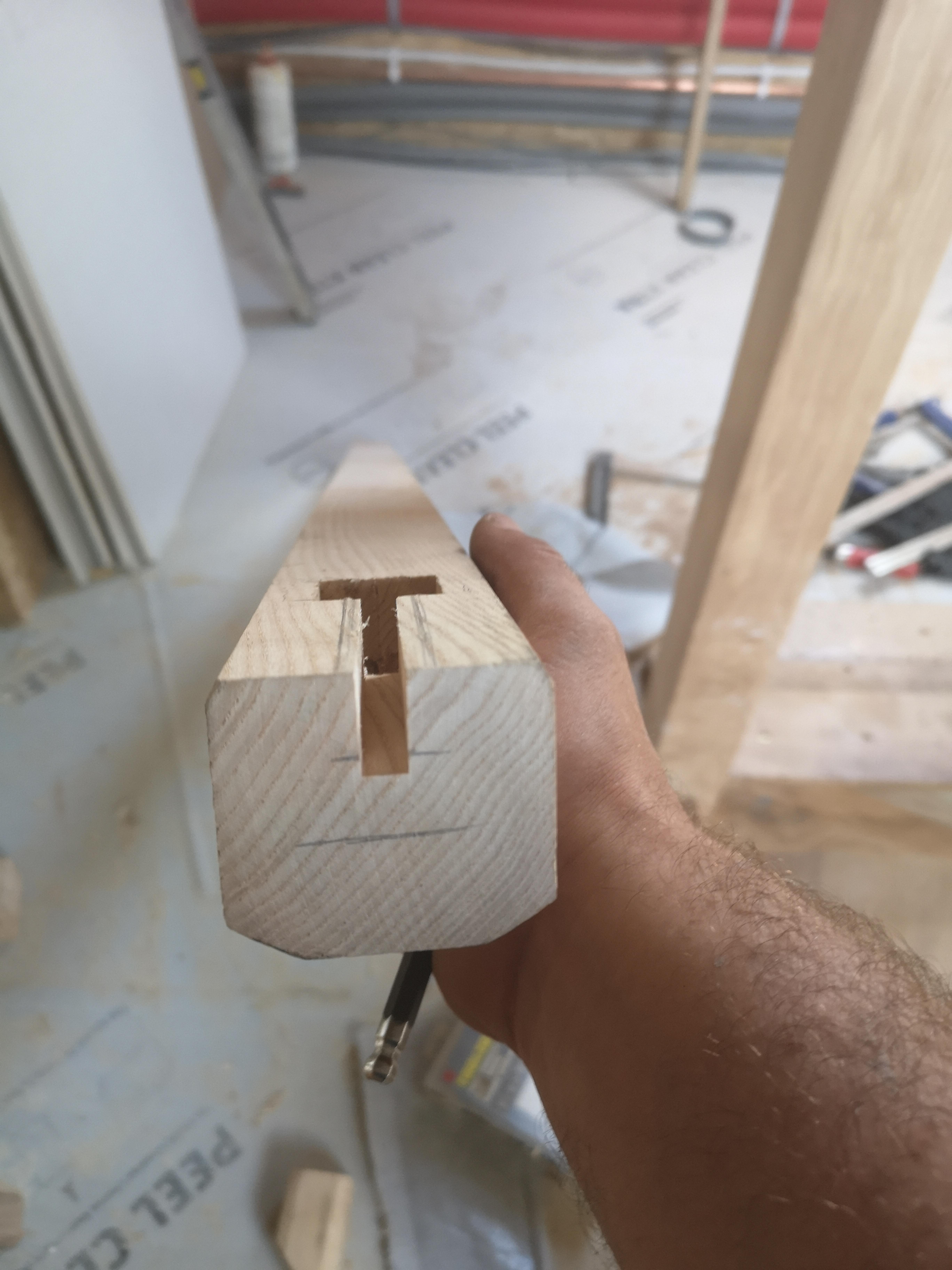

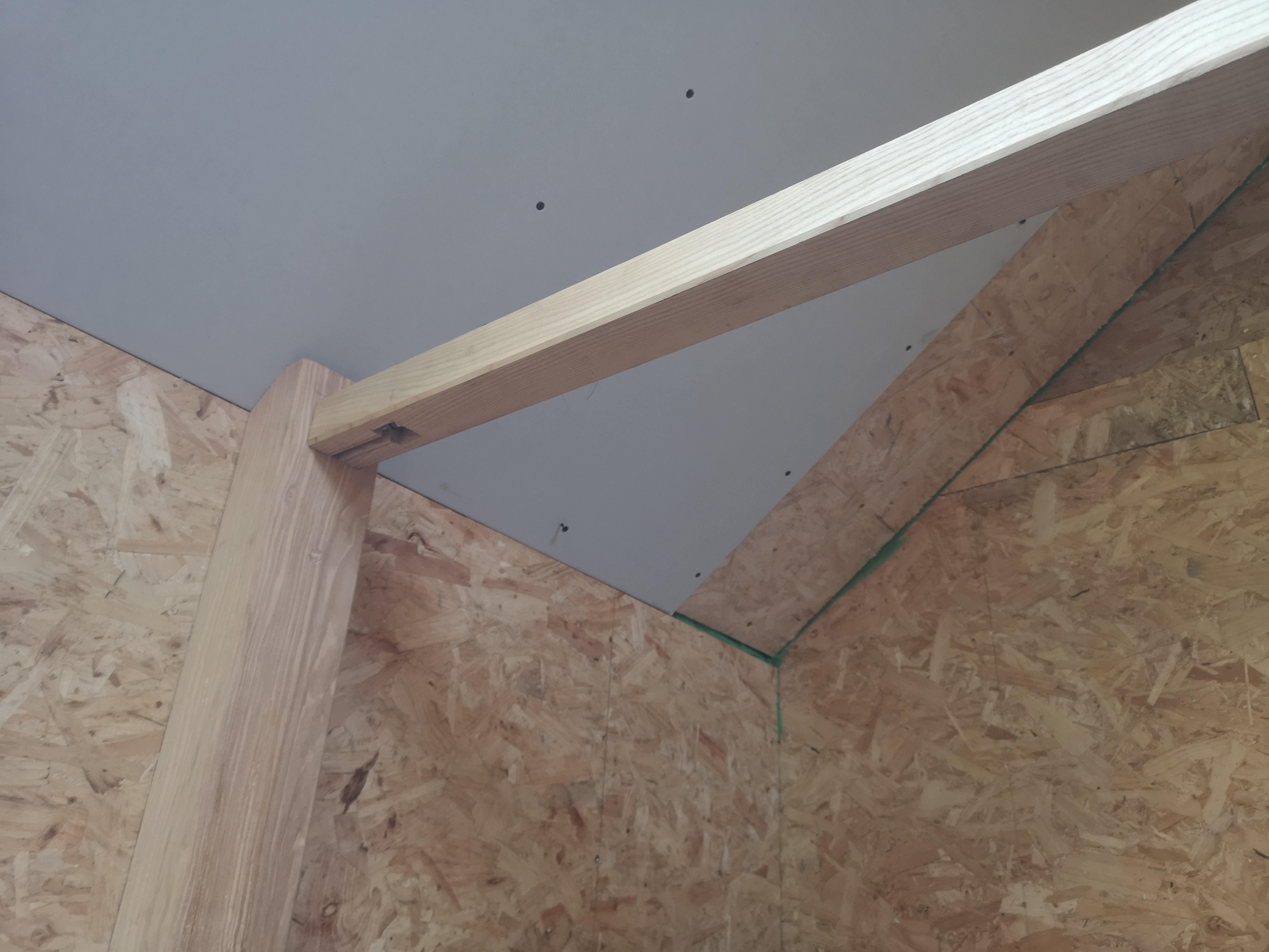

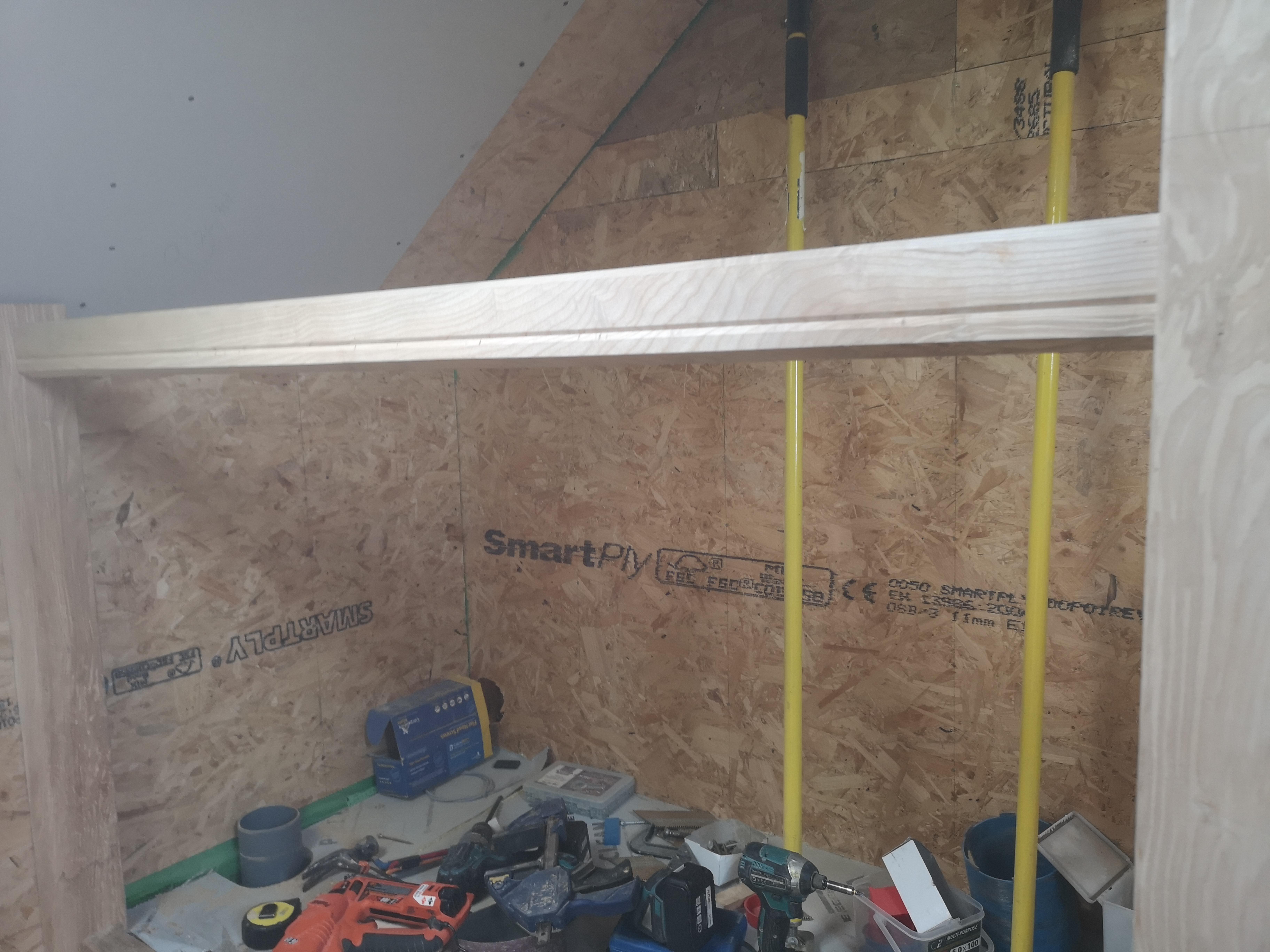

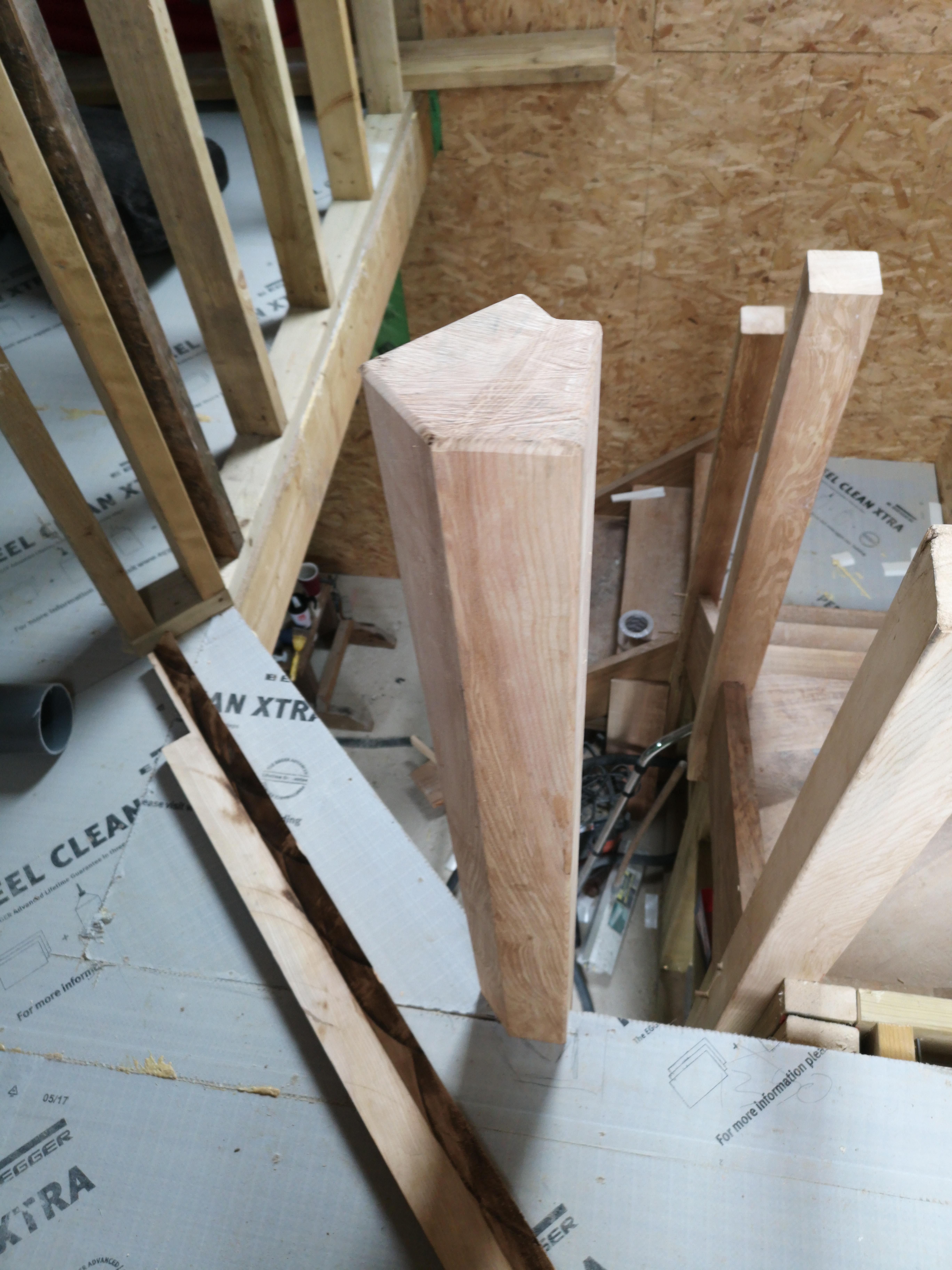

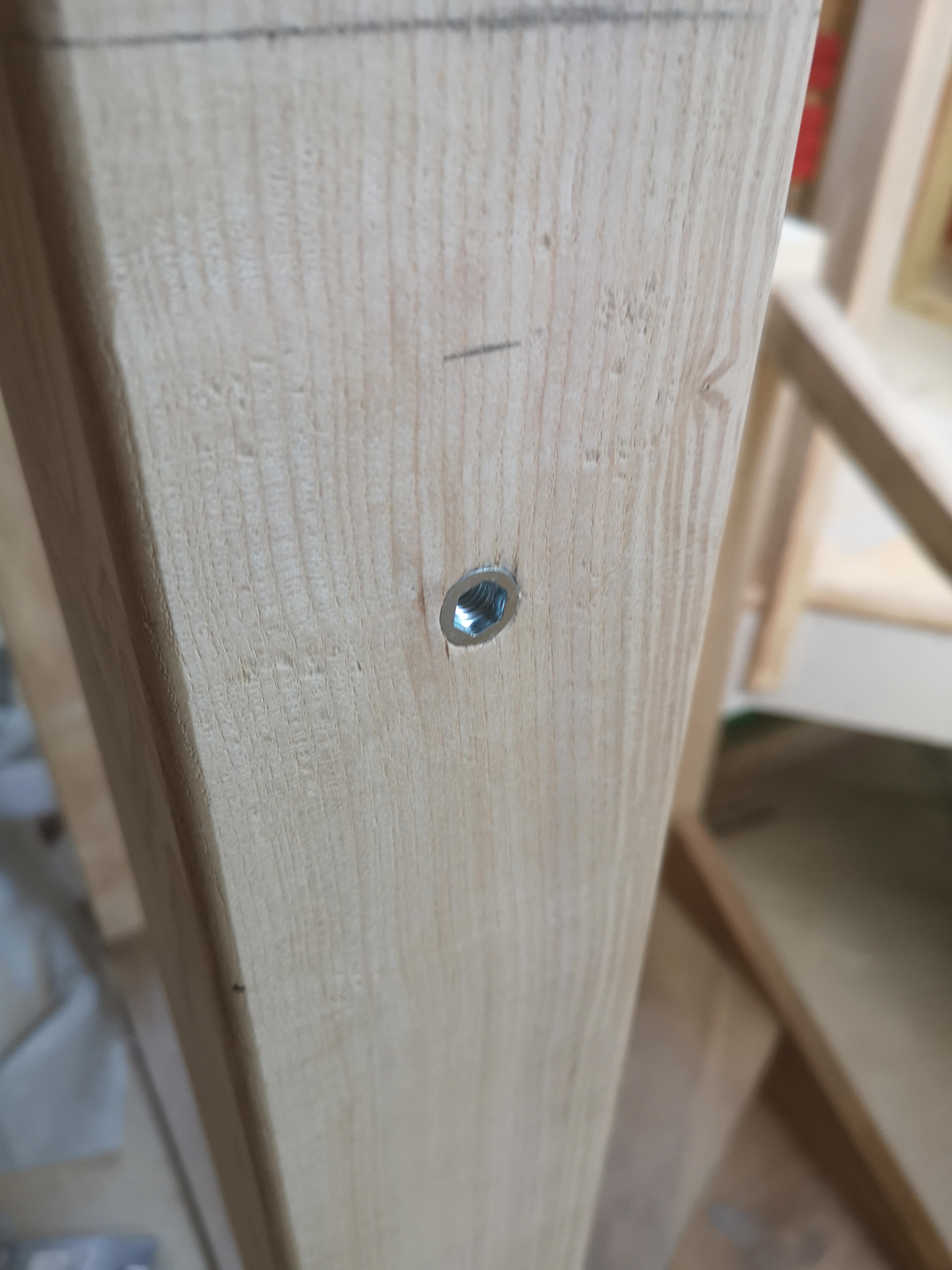

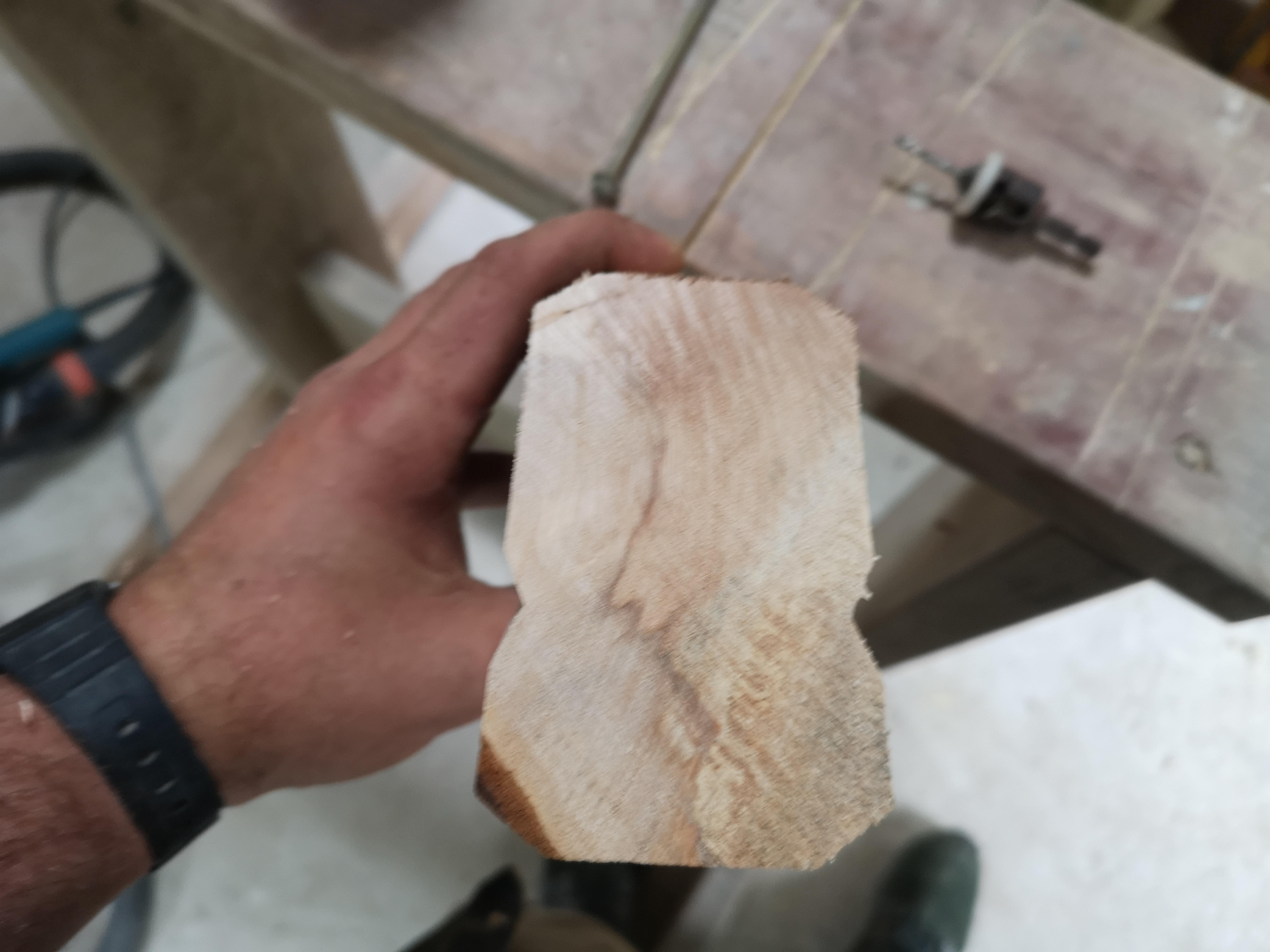

Construction Channel Posted July 19, 2019 Author Share Posted July 19, 2019 Turns out I only needed to use ash for one handrail. But I was advised to fit the landing ones in a rather sneeky way by a joiner friend of mine. Obviously I had to cut the rail along the crease first but once back together it's almost invisible. Link to comment Share on other sites More sharing options...
Construction Channel Posted July 19, 2019 Author Share Posted July 19, 2019 2 Link to comment Share on other sites More sharing options...
Jeremy Harris Posted July 19, 2019 Share Posted July 19, 2019 I like that a lot. Brilliant way to make a neat, strong joint, especially in a location like that where it would have been difficult, if not impossible, to mortice the rail to the post. Link to comment Share on other sites More sharing options...

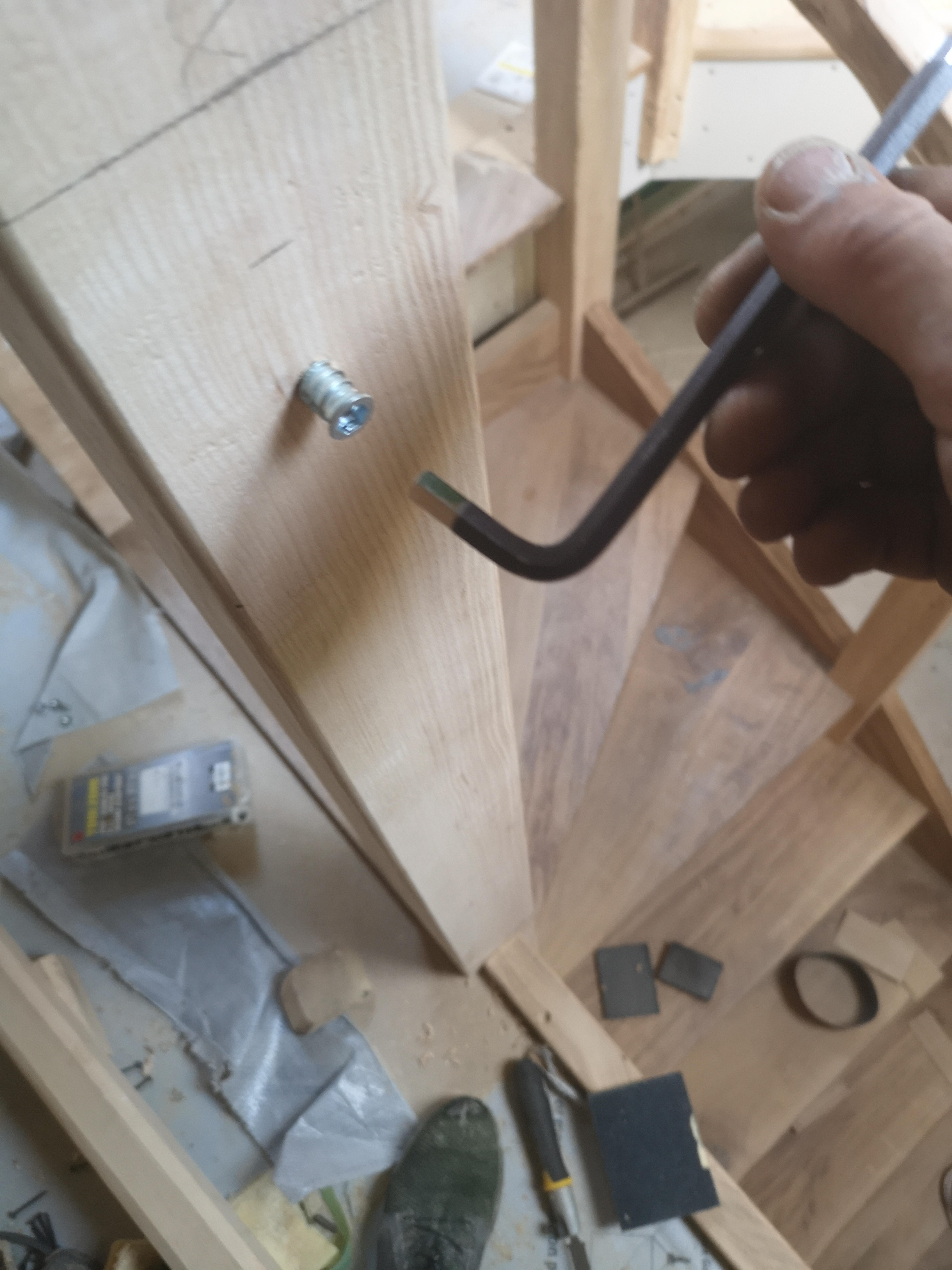

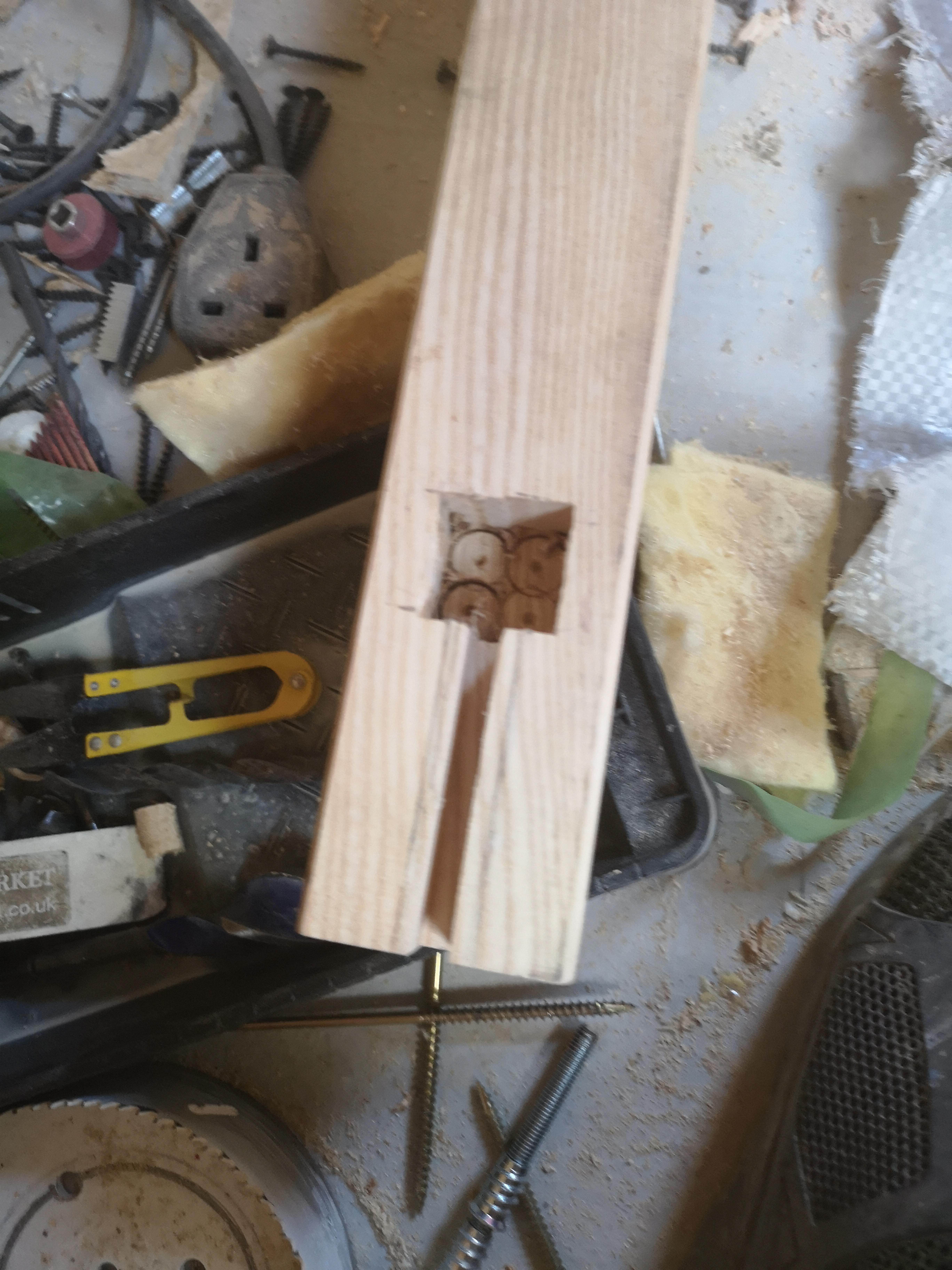

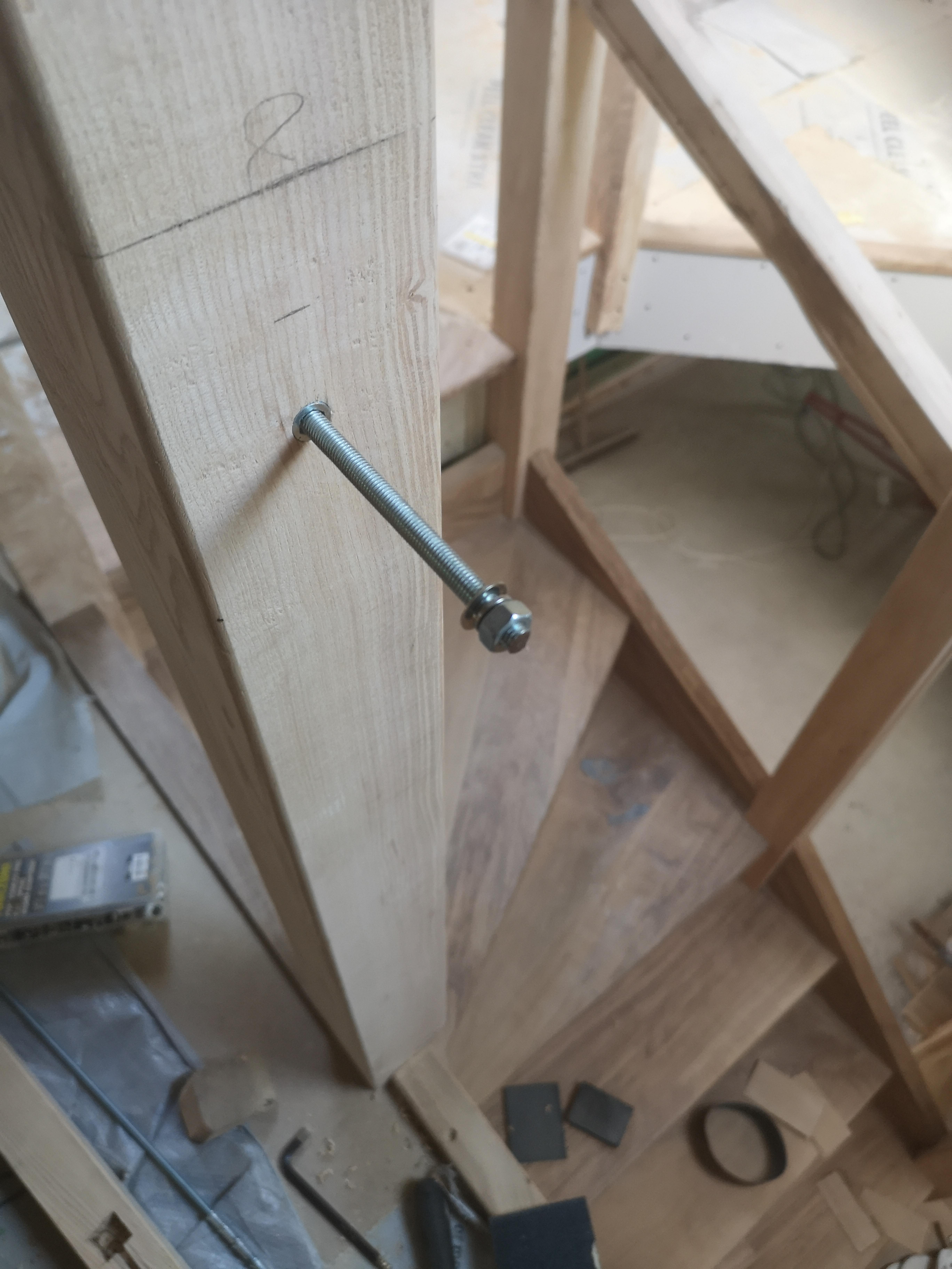

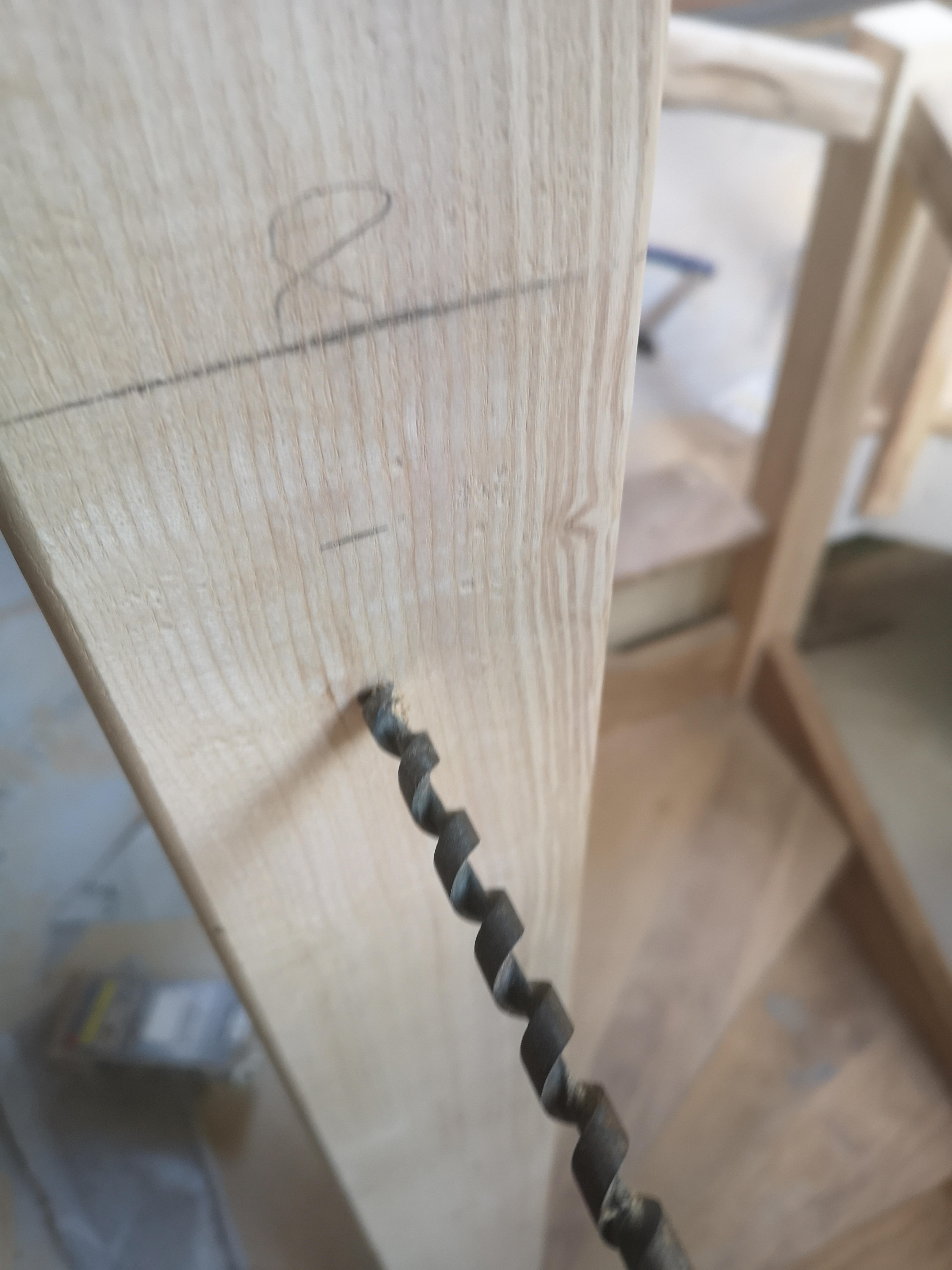

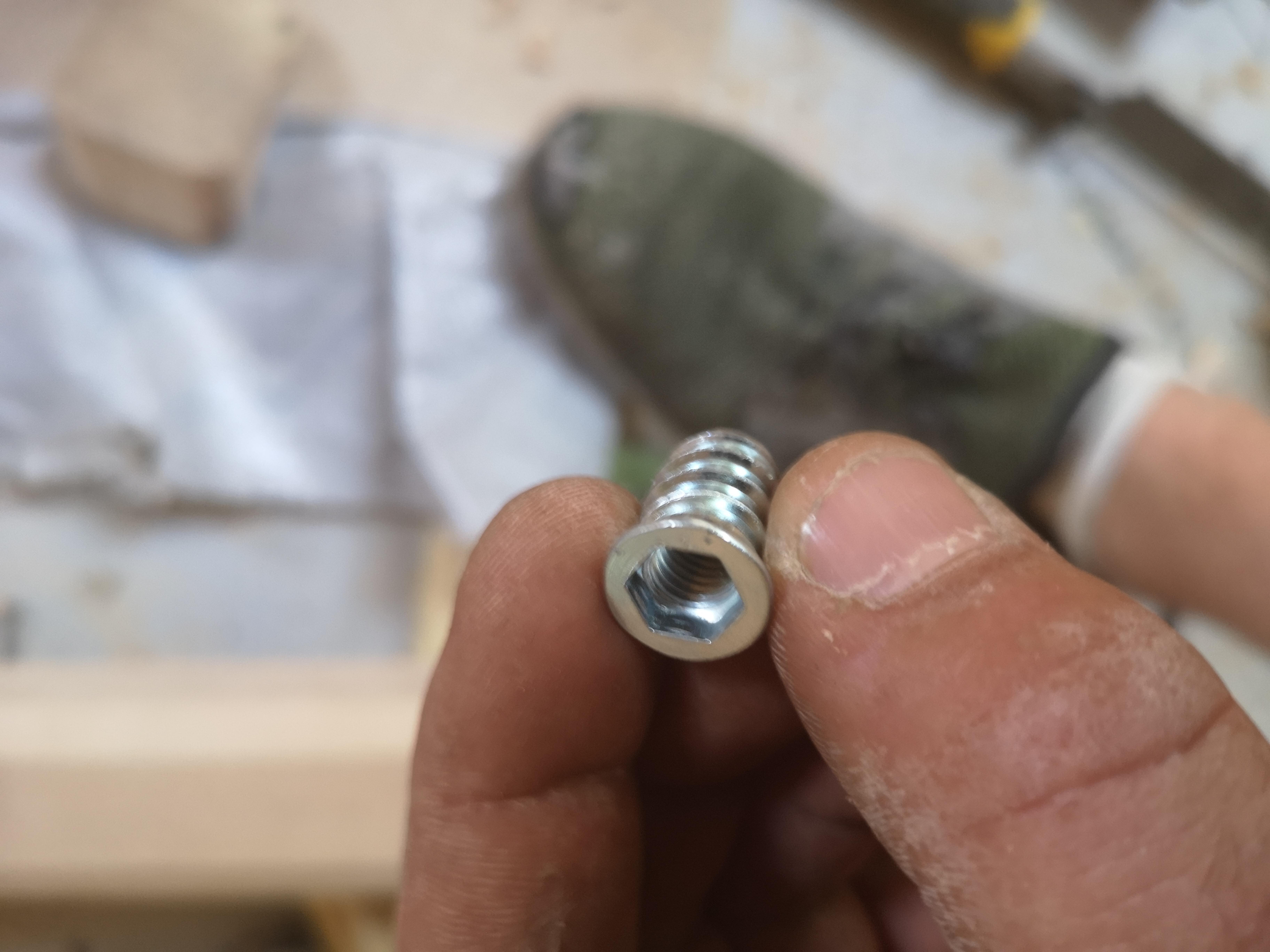

Construction Channel Posted July 19, 2019 Author Share Posted July 19, 2019 That's why he suggested it. There's nothing worse than hitting a dowel in and on the final hit it going loose from snapping the tennon.... And then you're in serious trouble. IMG_20190718_191821.jpg Link to comment Share on other sites More sharing options...
CC45 Posted July 19, 2019 Share Posted July 19, 2019 fantastic idea - what's the small metal insert called? Link to comment Share on other sites More sharing options...
Construction Channel Posted July 19, 2019 Author Share Posted July 19, 2019 18 minutes ago, CC45 said: fantastic idea - what's the small metal insert called? I think it's called threadcert nsert Nuts Type D M6 x 20mm 50 Pack" and thought of you! https://www.screwfix.com/p/insert-nuts-type-d-m6-x-20mm-50-pack/61859?kpid=61859&ds_kid=92700045993219437&gclsrc=aw.ds&ds_rl=1241687&ds_rl=1245250&ds_rl=1249413&gclid=Cj0KCQjw1MXpBRDjARIsAHtdN-1Q-9brjOTxQIfIBPWjxZdyv-l4QJjujBh67zy7QK3flQtBzeotILIaAhTGEALw_wcB Although mine are m8 and I was given them so I don't know where they were bought 1 Link to comment Share on other sites More sharing options...
