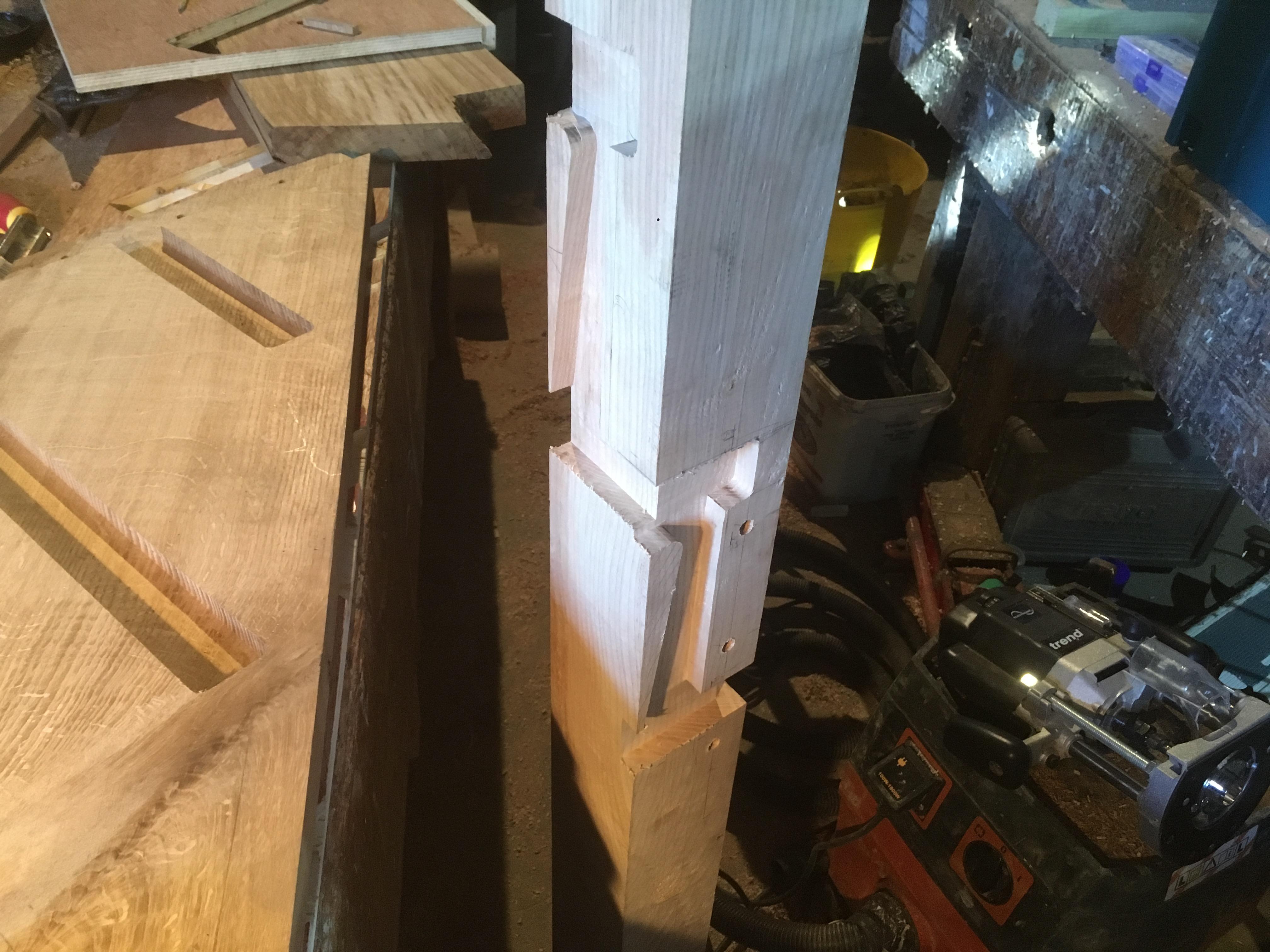

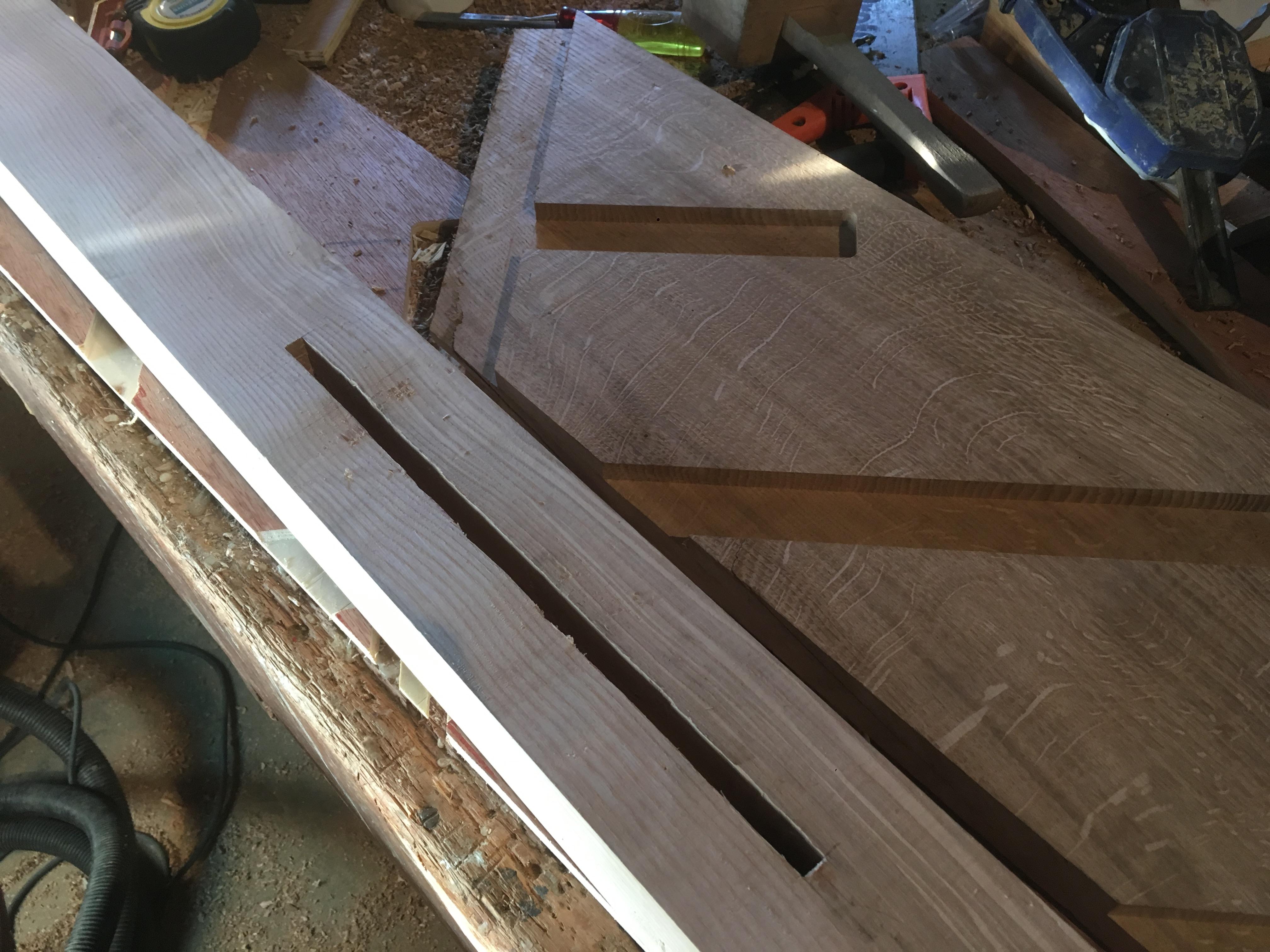

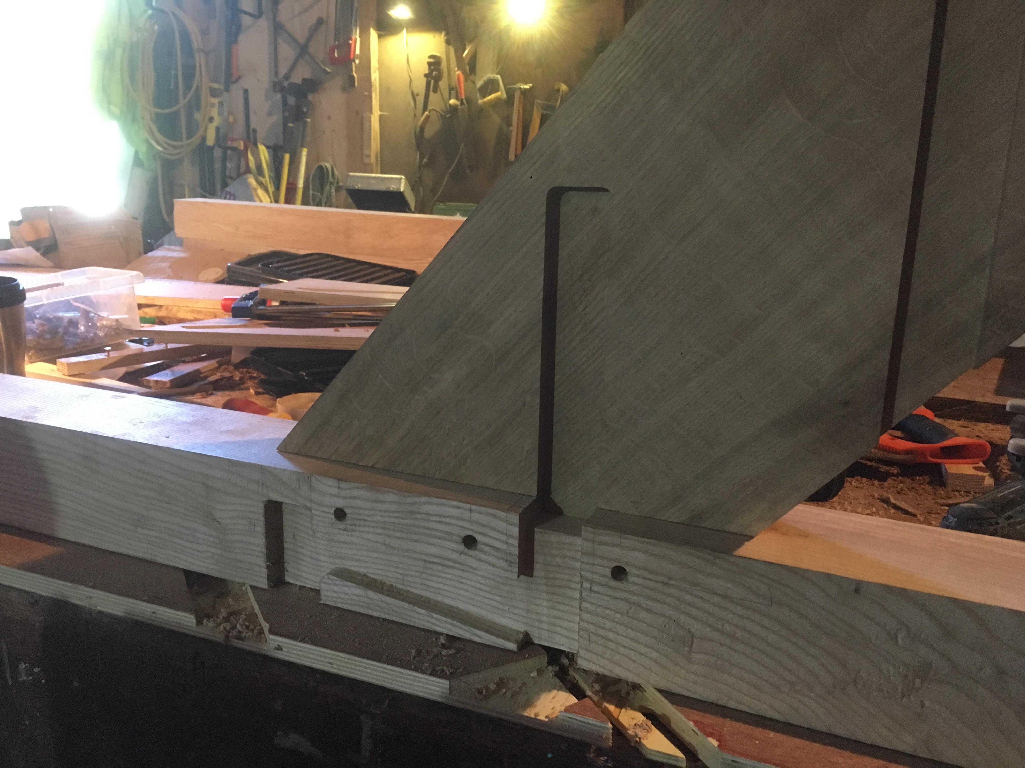

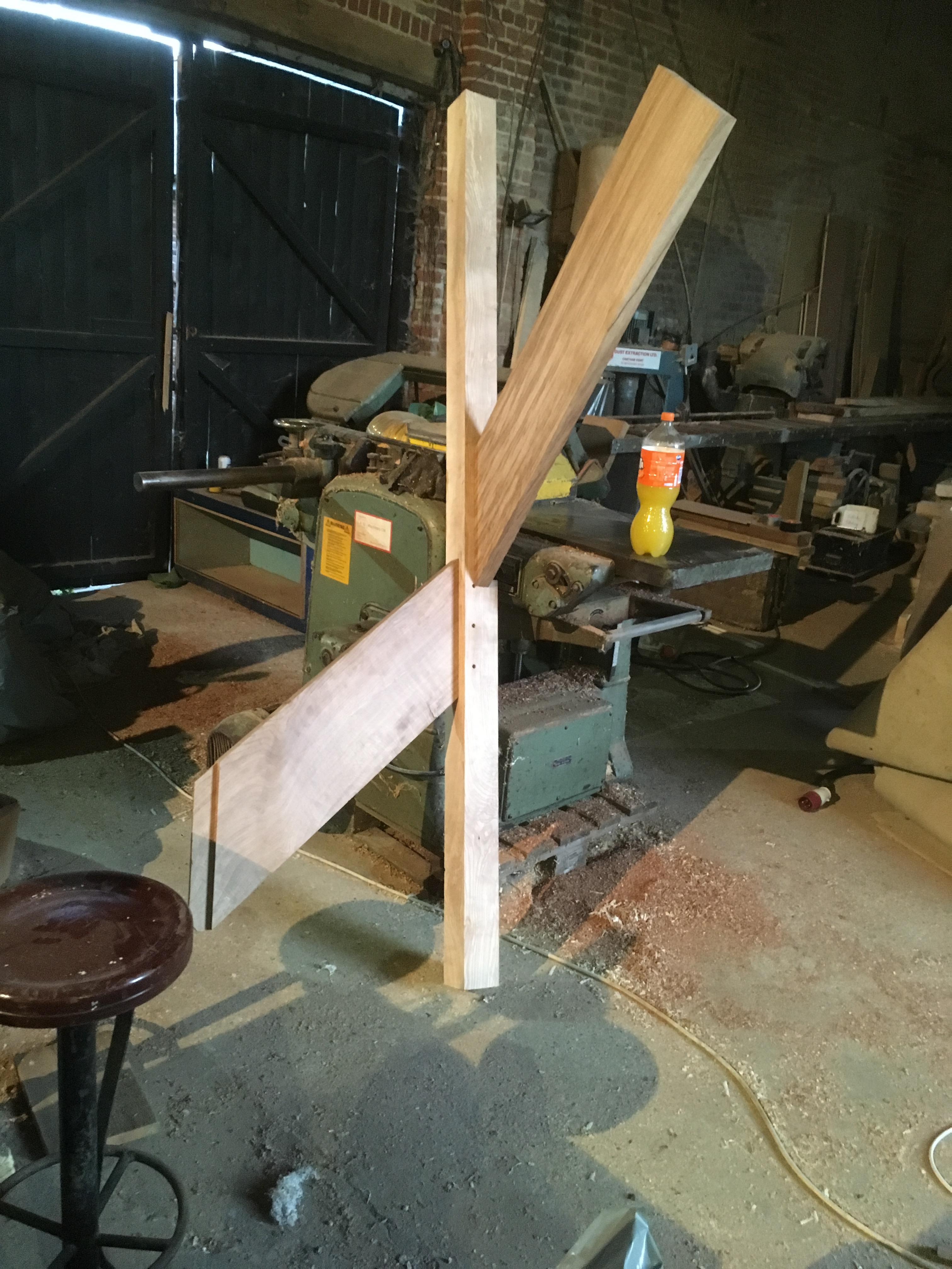

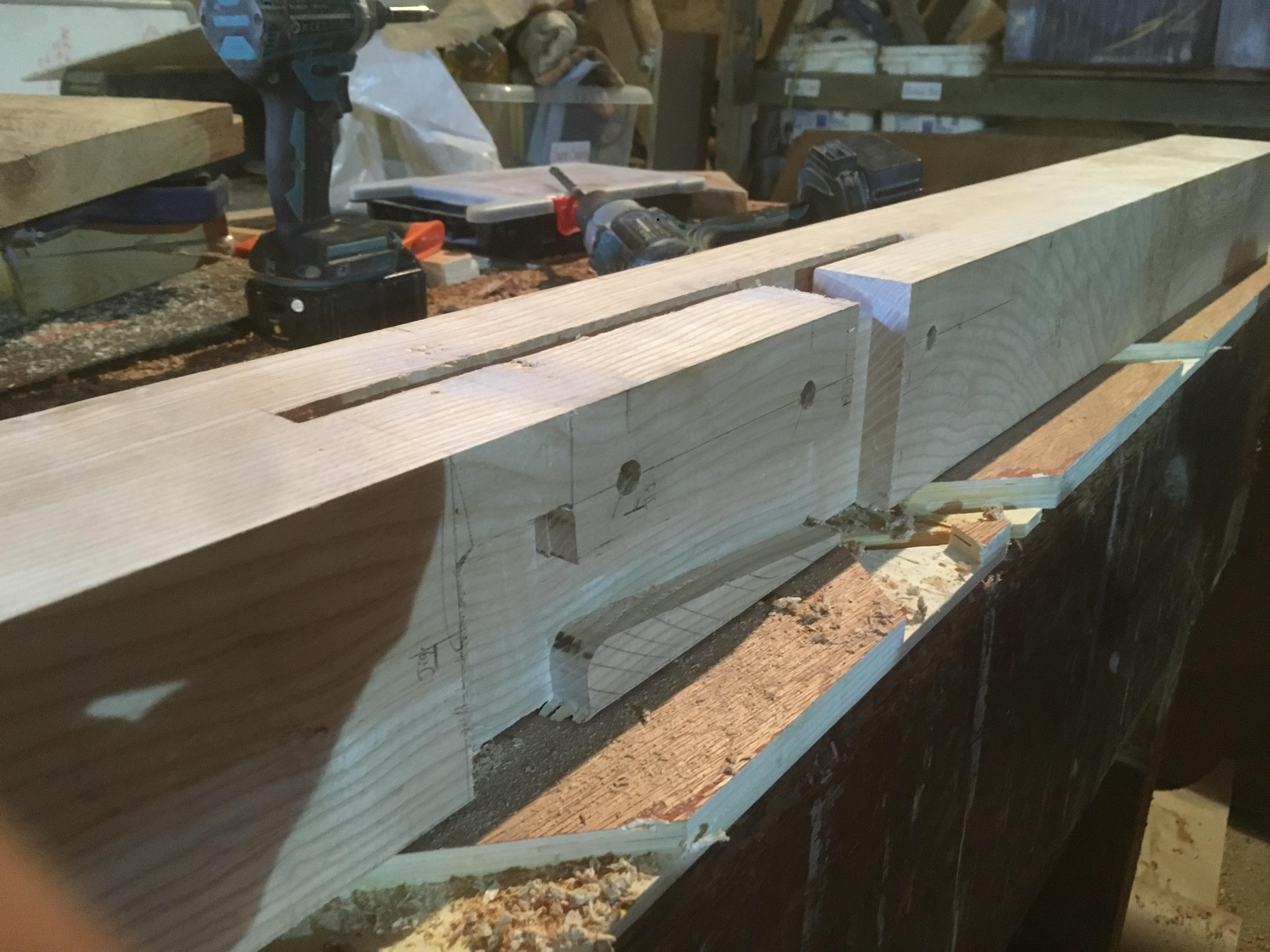

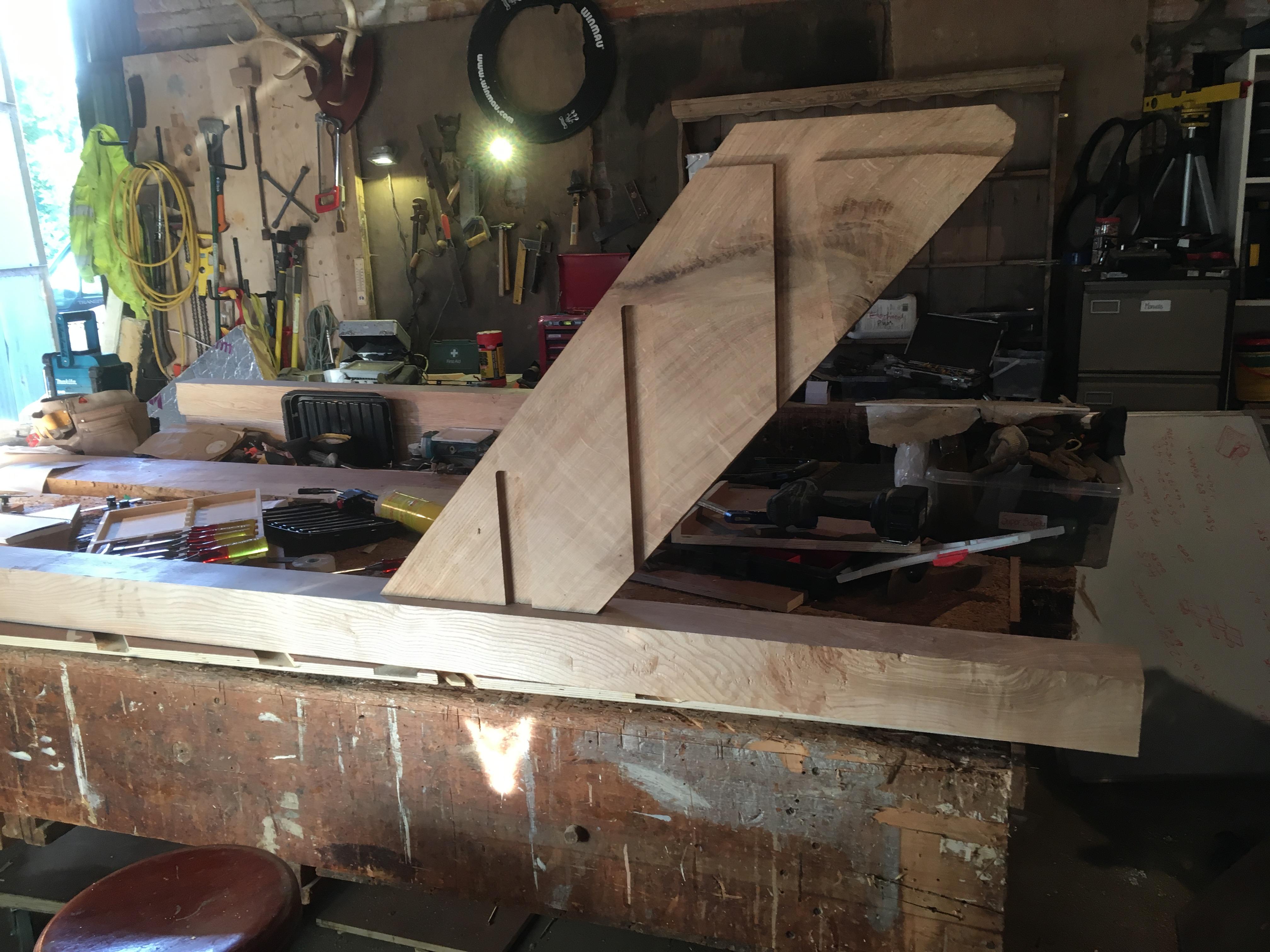

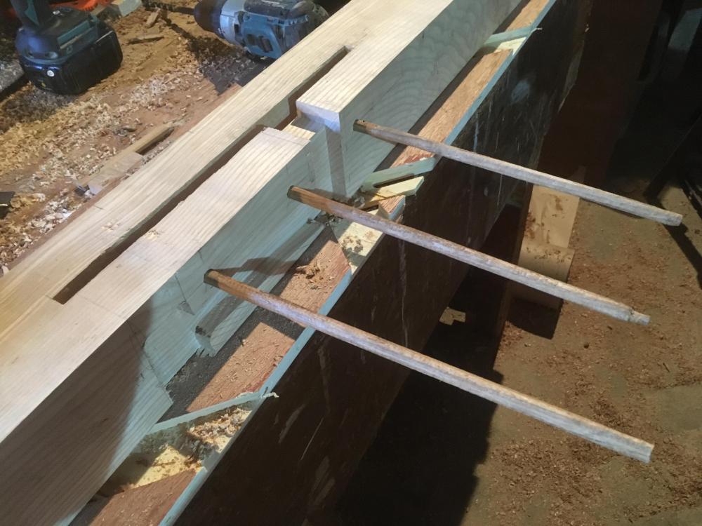

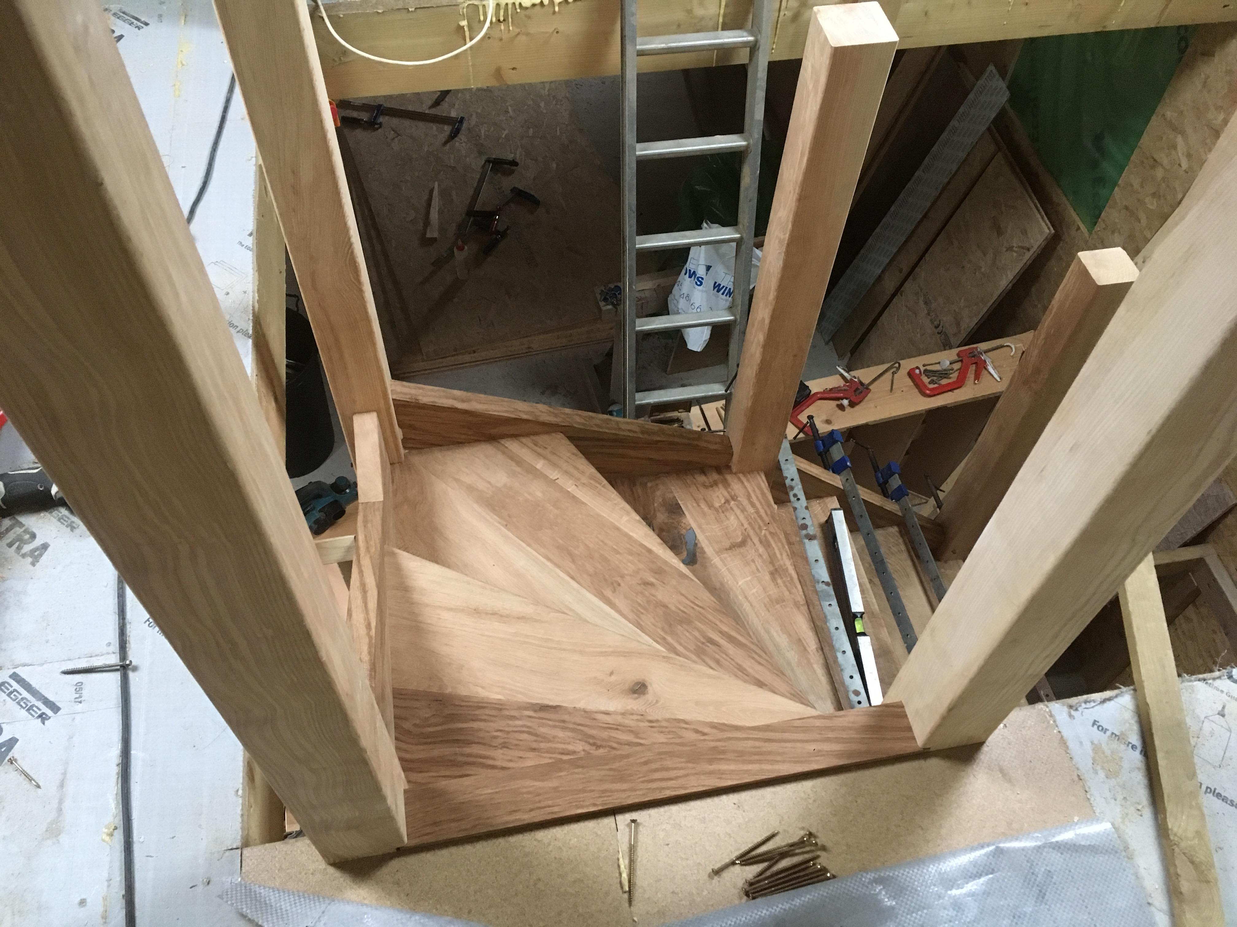

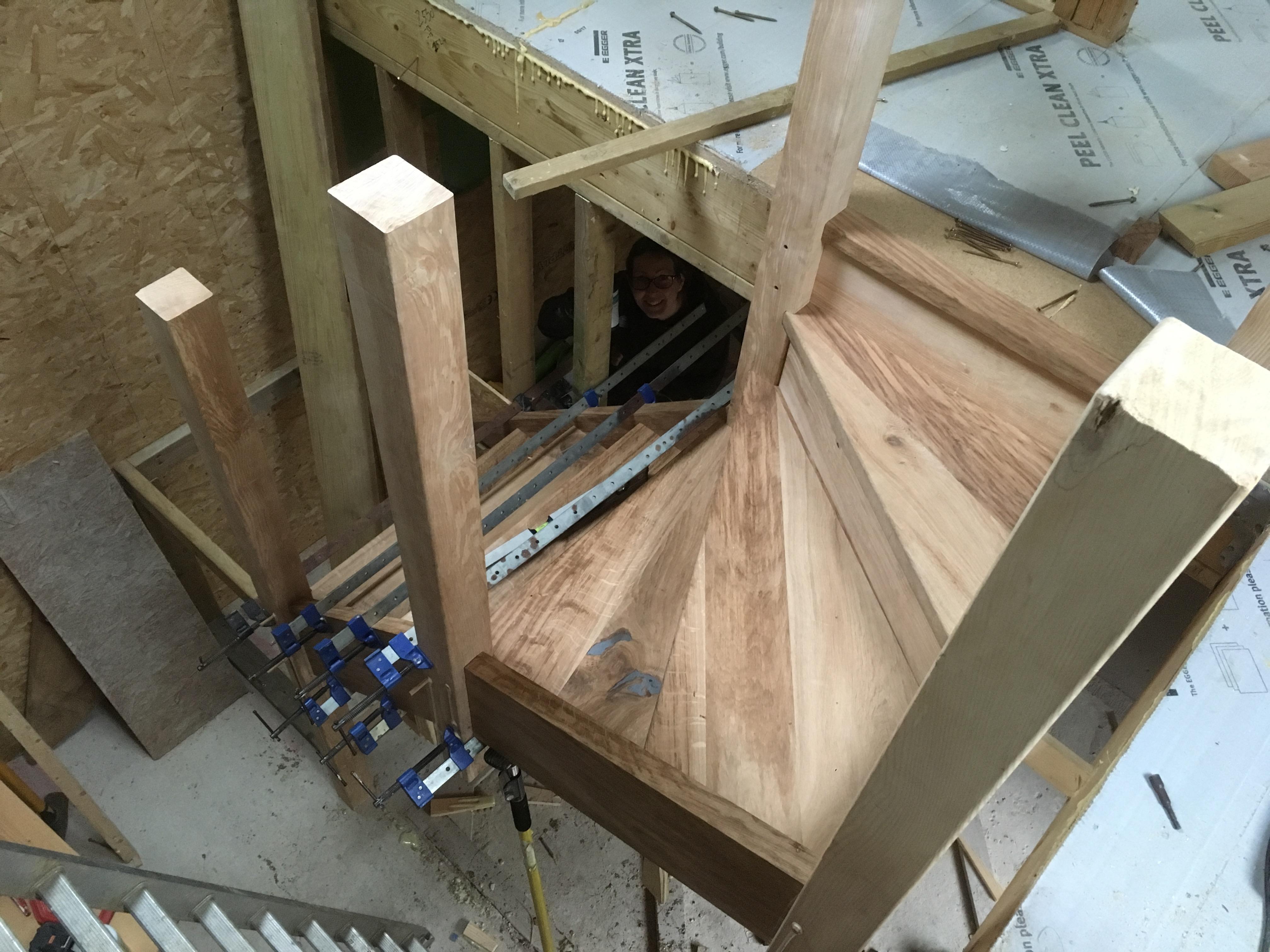

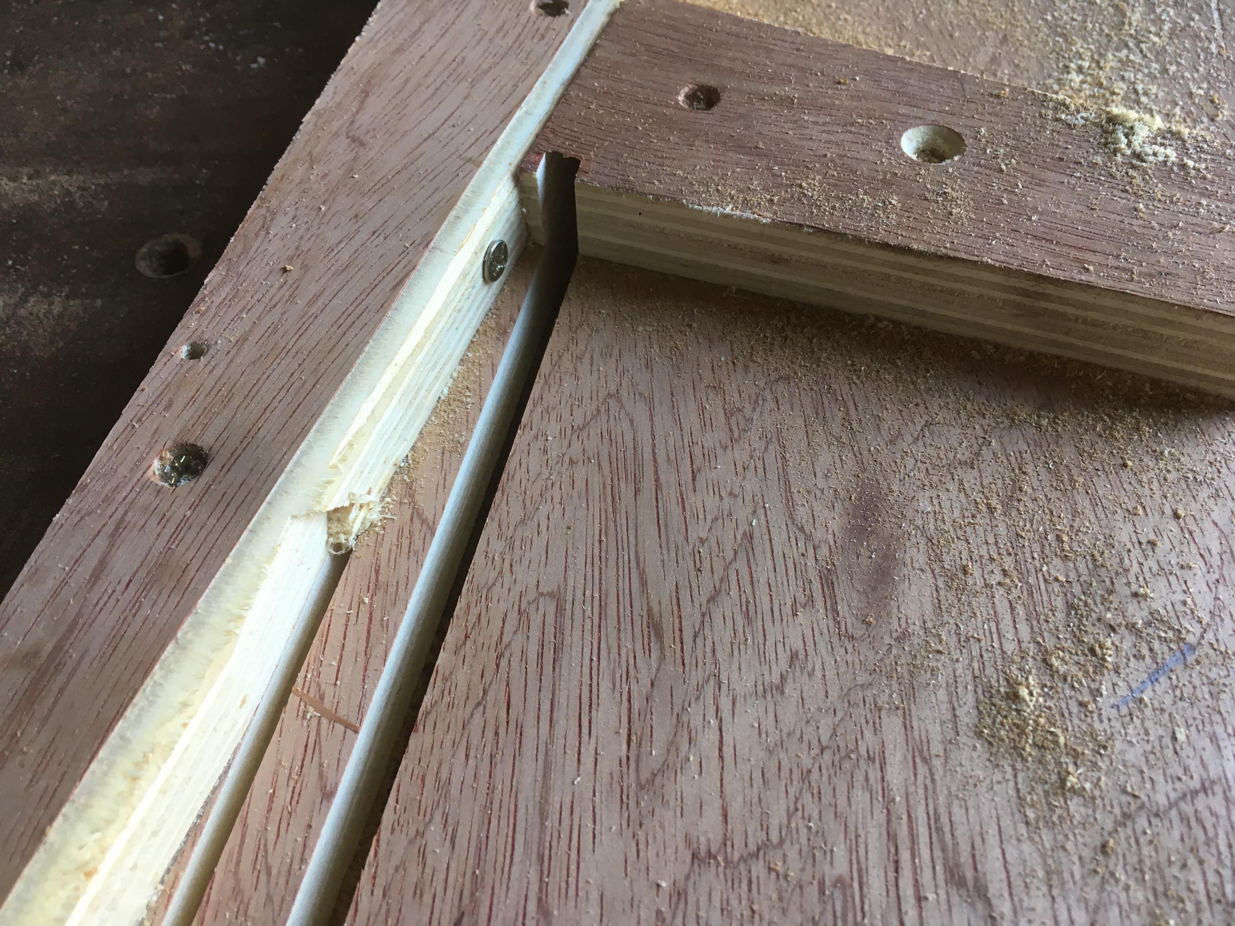

More progress! Physically cutting things really isn’t taking that long once I got the jigs sorted. Actually deciding the marks are in the rights place is proving to be very time consuming. Now the big question is do I start the next set of strings and house them into this newel on the bench OR do I get the lower part all glued, screwed and fitted and then try to fit the rest while this bit is in situ...... bench sounds the sensible option but I just don’t know.

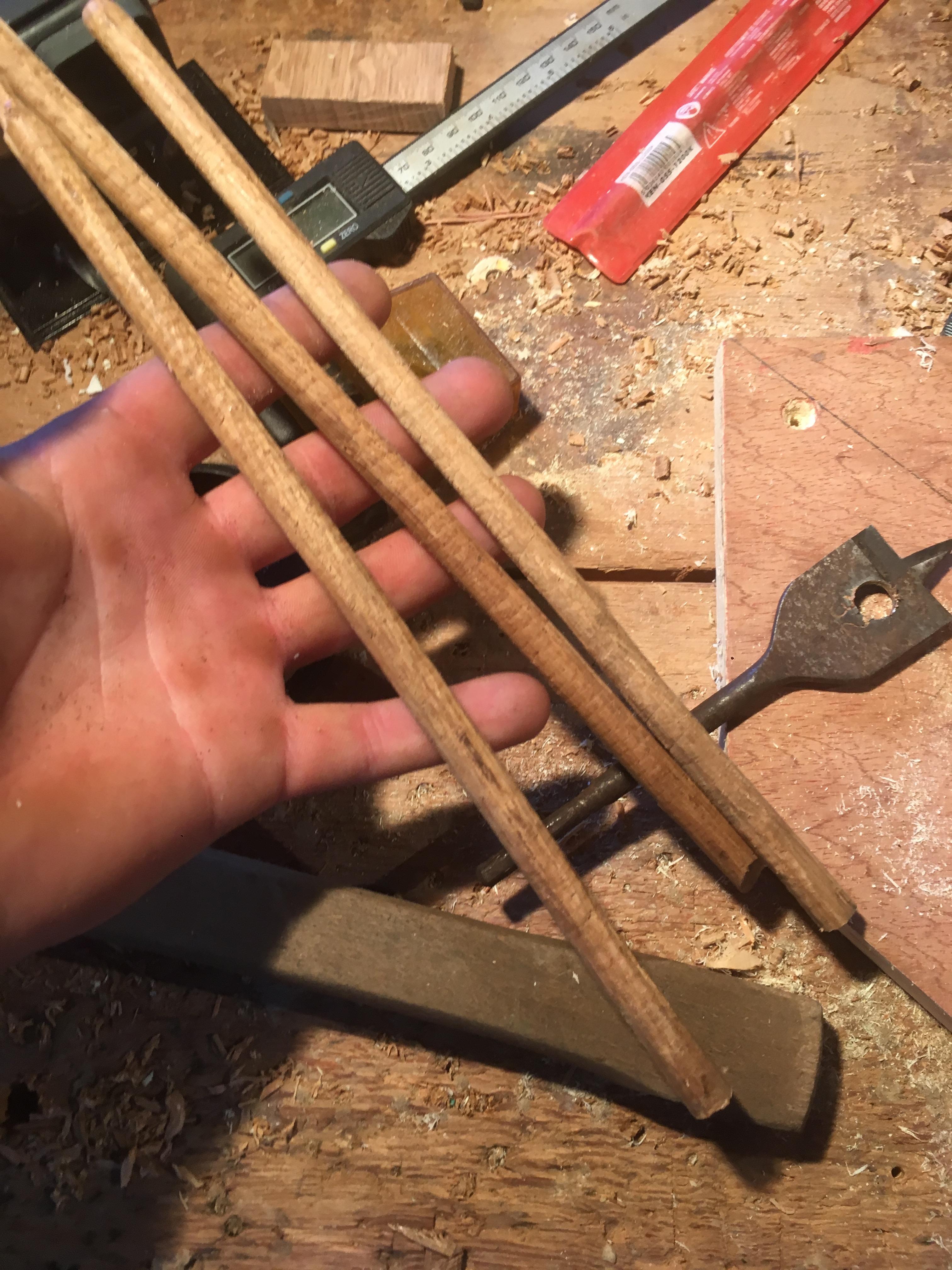

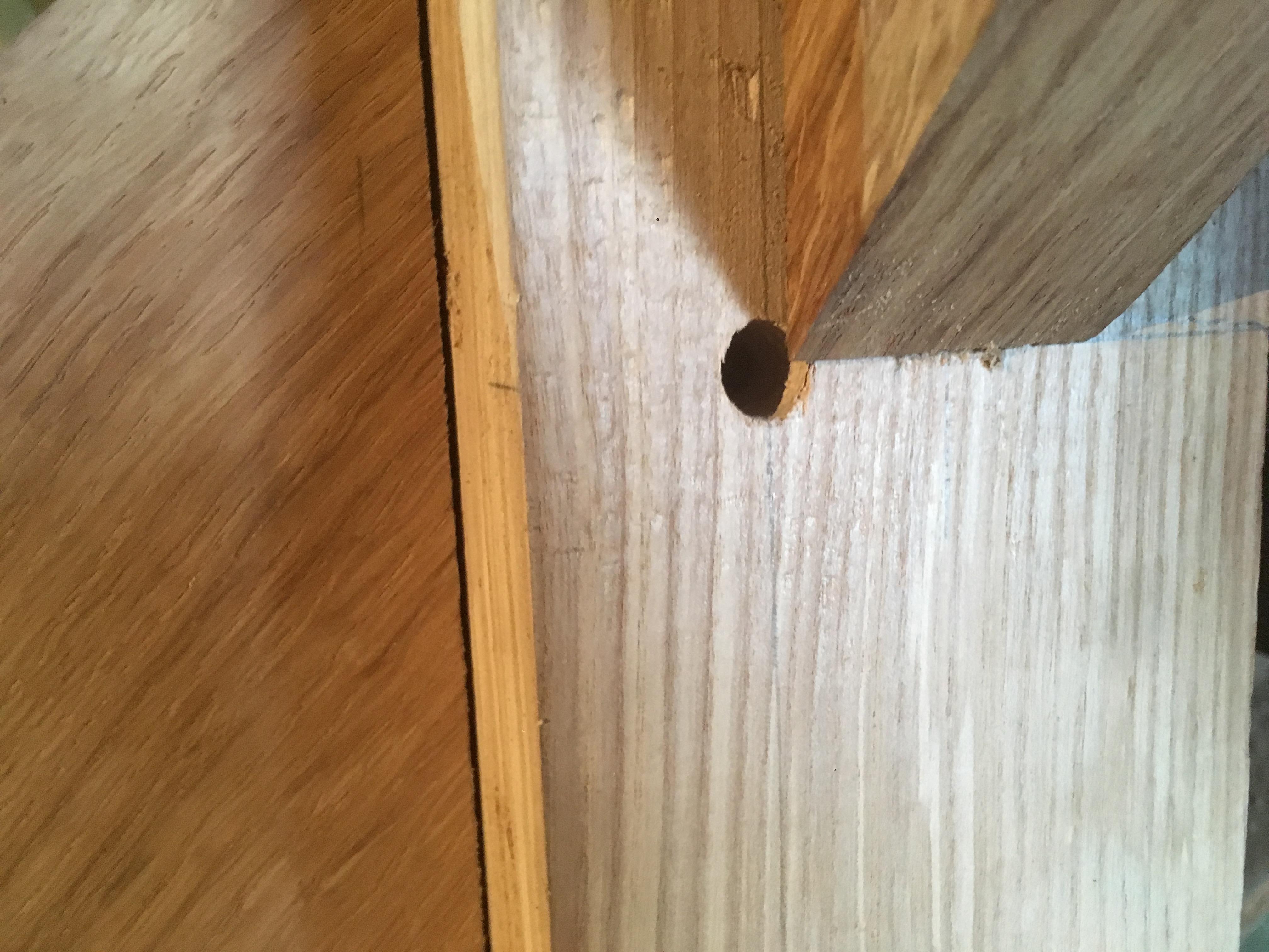

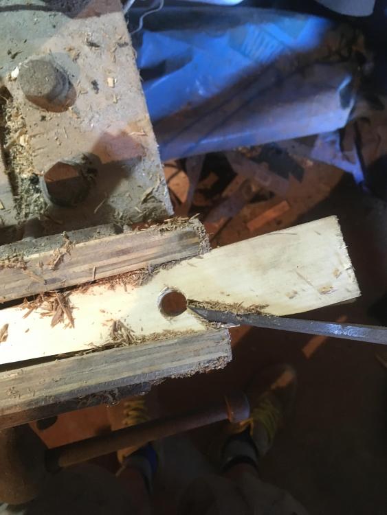

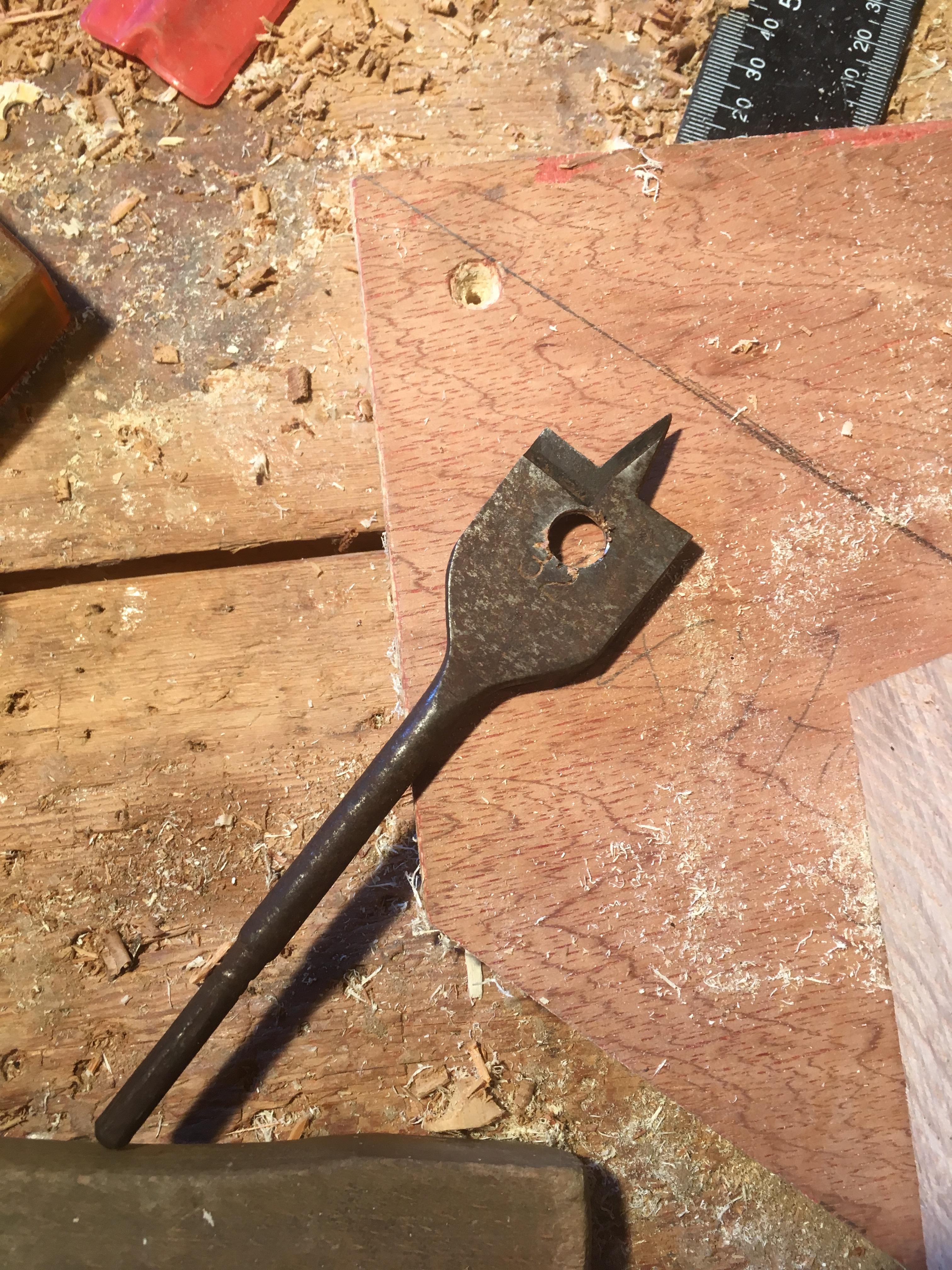

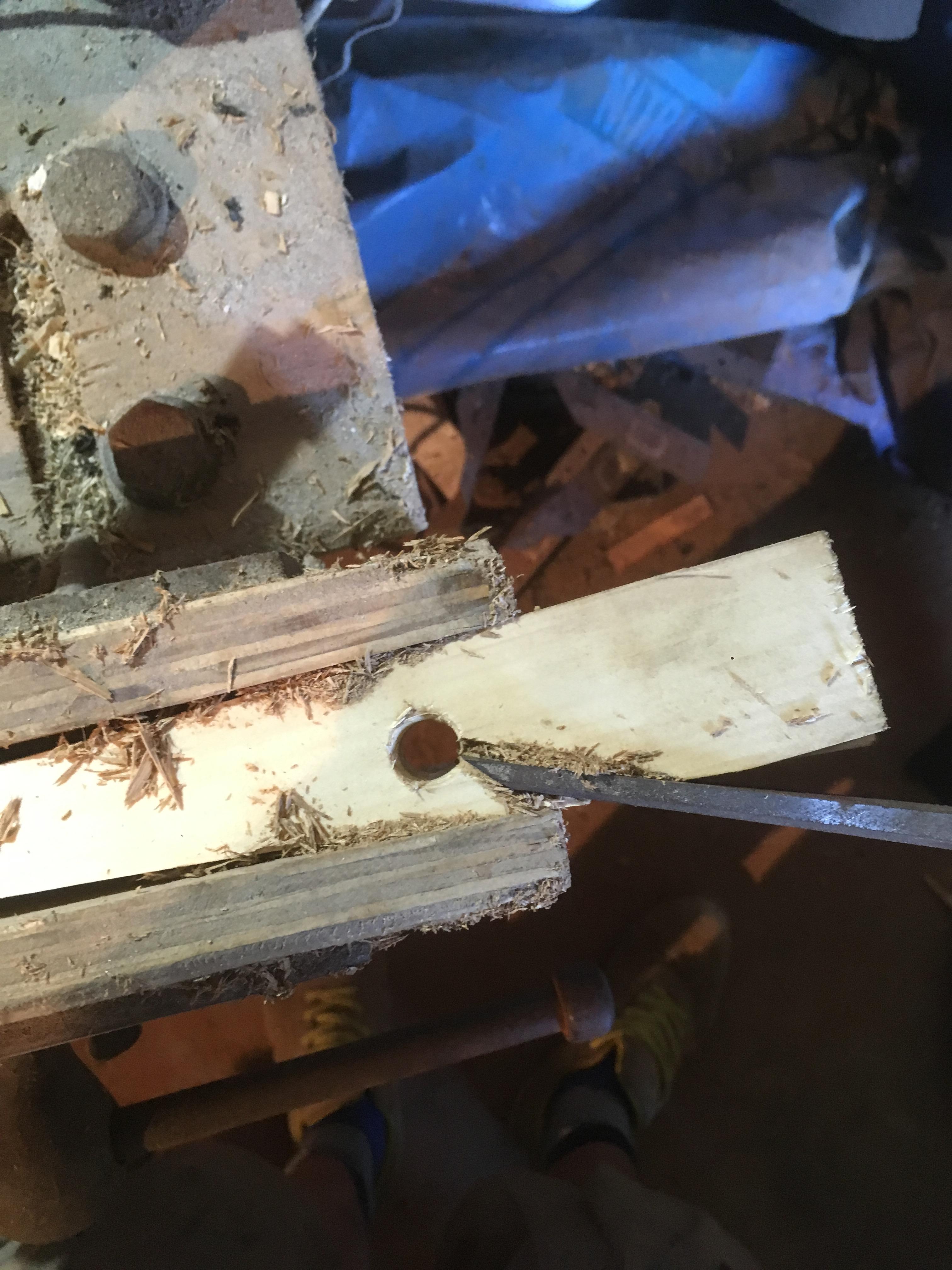

Also I make a pretty clever dowel making set up. First I cut a 11mmx11mm stick on the table saw. Mount that in a cordless drill and spin it through this very crude looking “thing”
then i I beat that through this 10mm hole I drilled in this drill bit. Seems to be working ok so far.

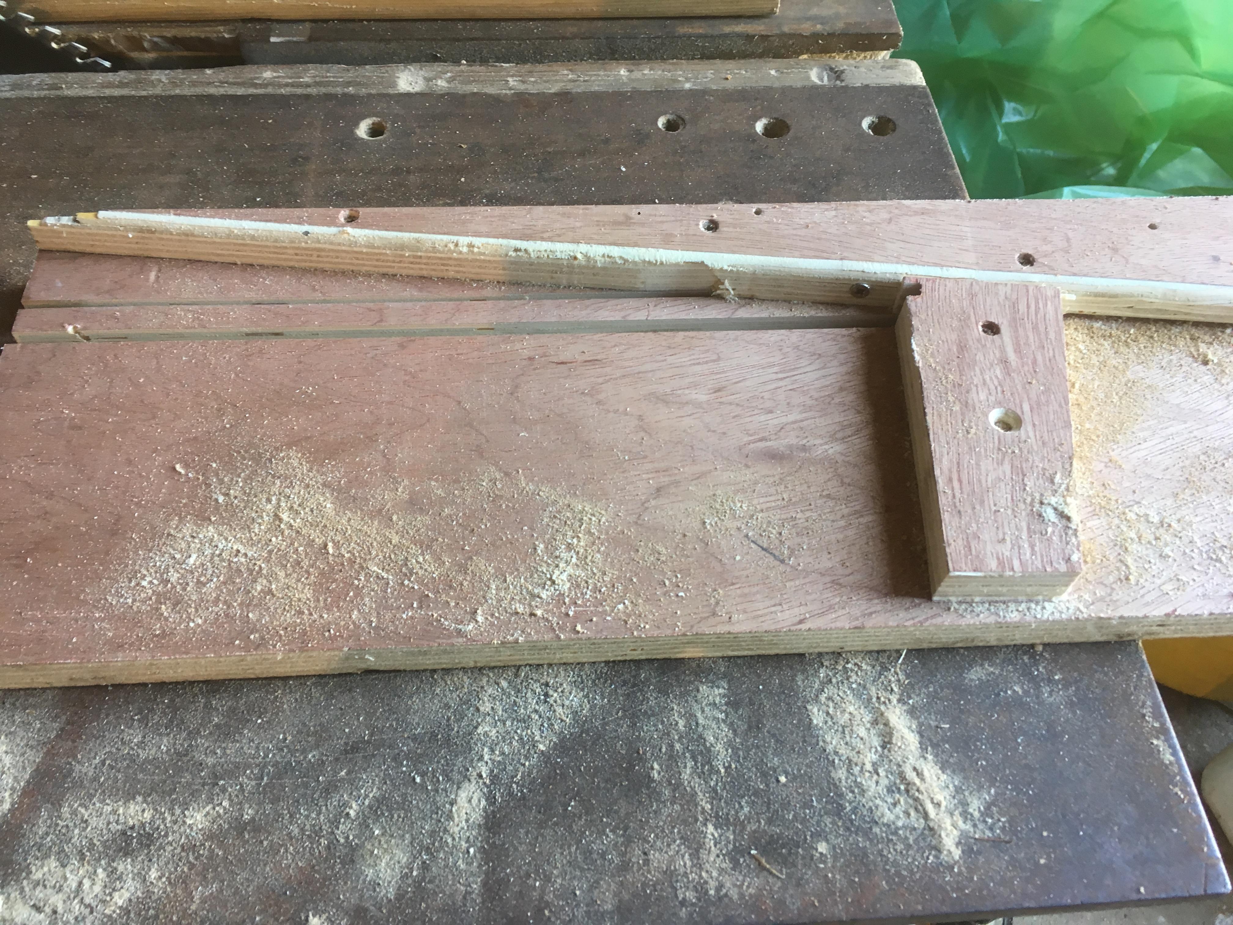

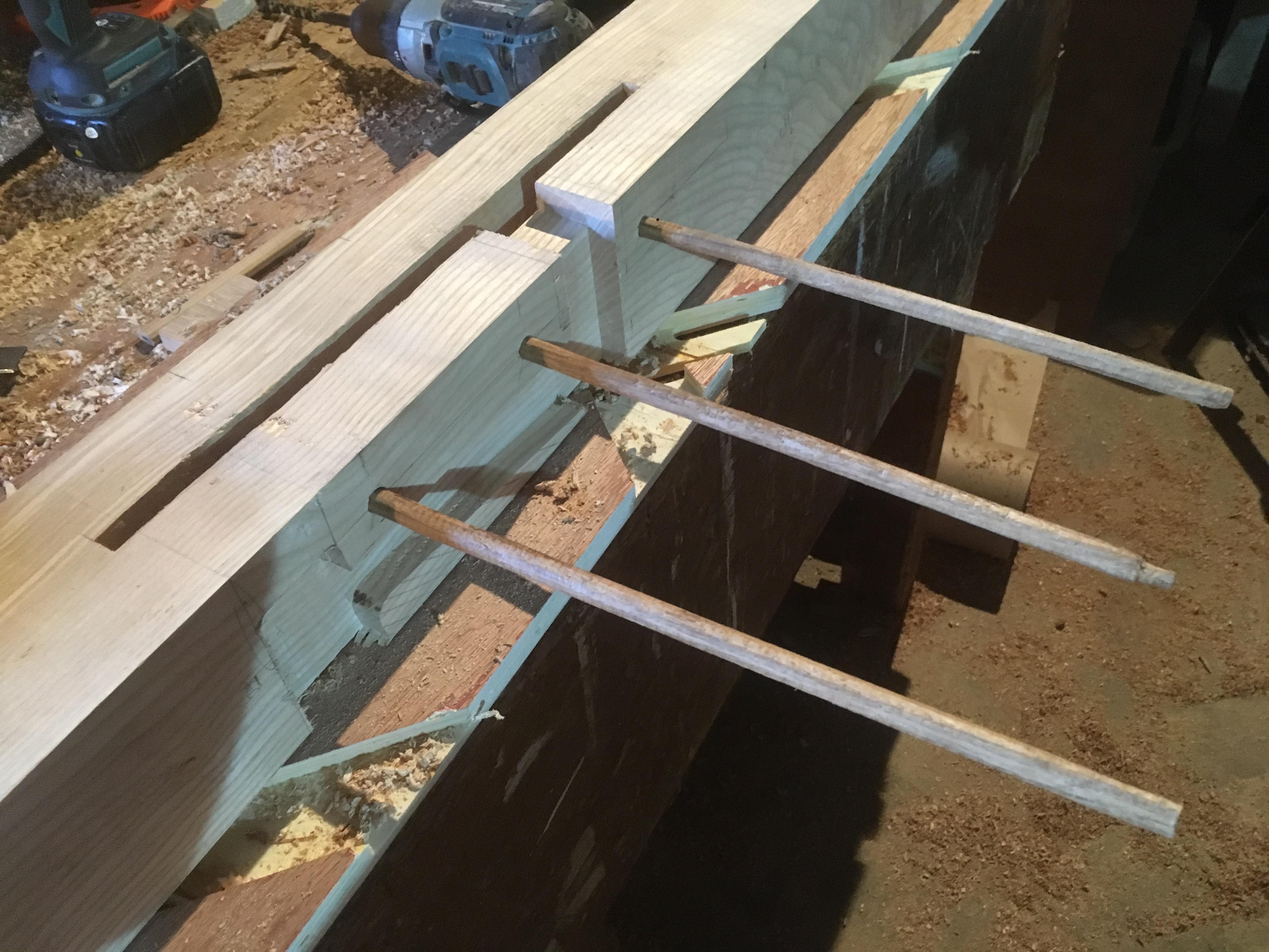

Also made a jig for cutting the wedges but that bit doesn’t look very impressive. The little screw at the back is for “adjustment”.

Decision made, I’m making the lot before I get any glue out. I have also decided this is far too complicated for a sober person so I’m going to the pub for some thinking juice. Let’s hope there isn’t anyone else there as I really do intend to only have a couple, possibly an early dinner.

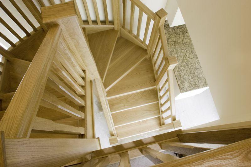

Oh dear, while “researching” I have just seen this.
its another complication but I kind of like it. I need to think about how it would affect the bathroom underneath but it could turn out quite well. ( the bit I’m talking about is turning the string with the winders instead of making it square).

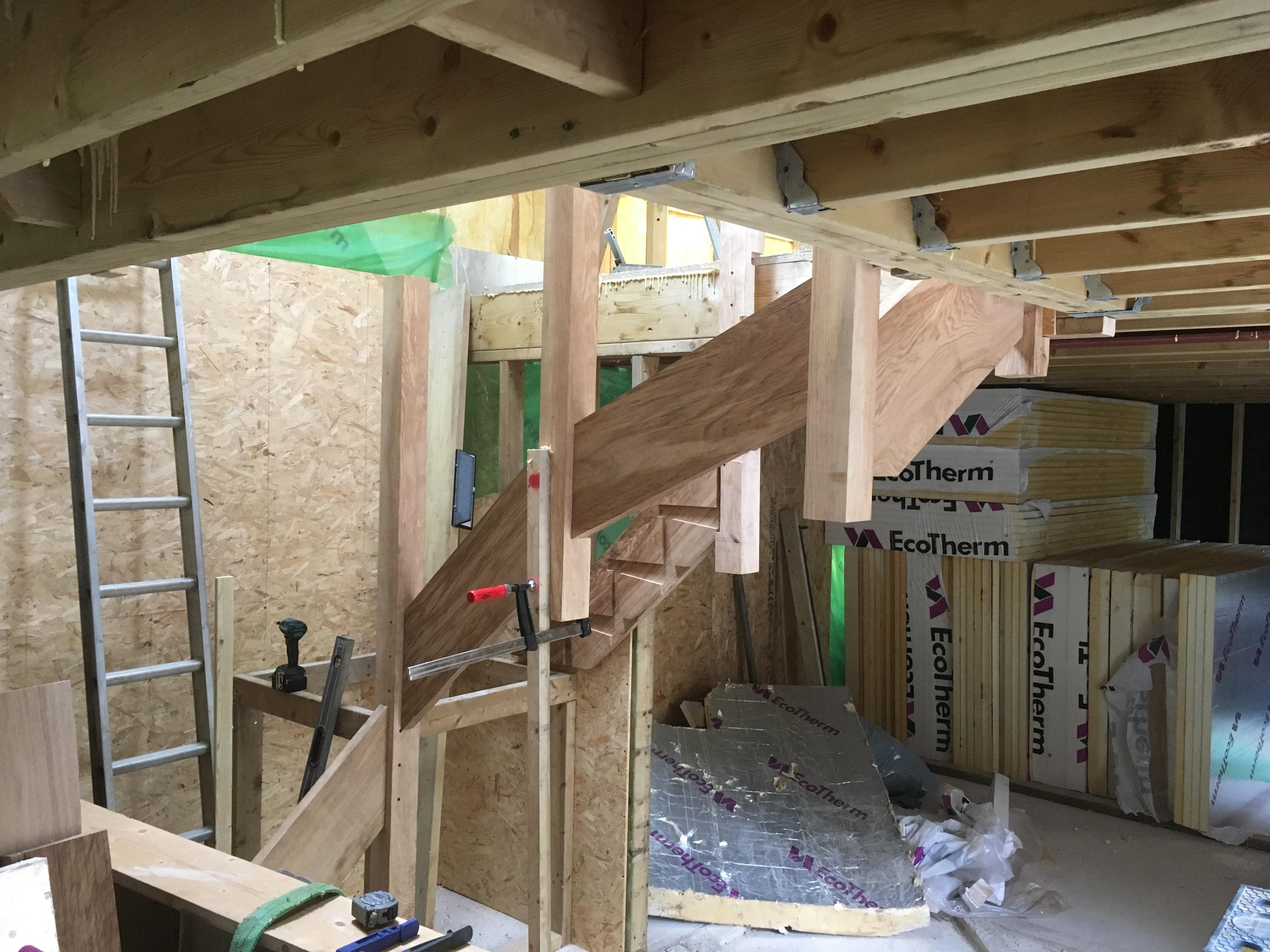

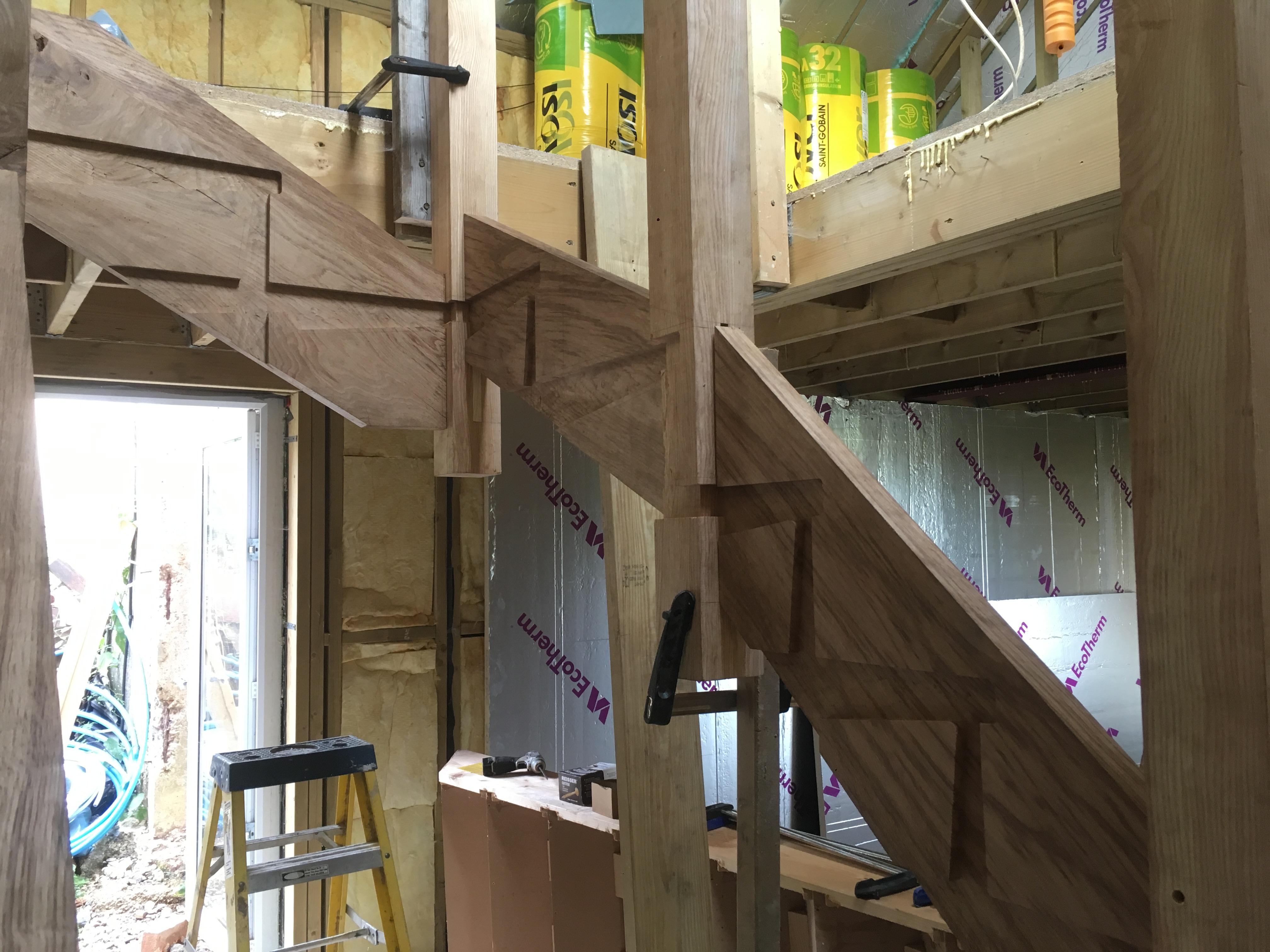

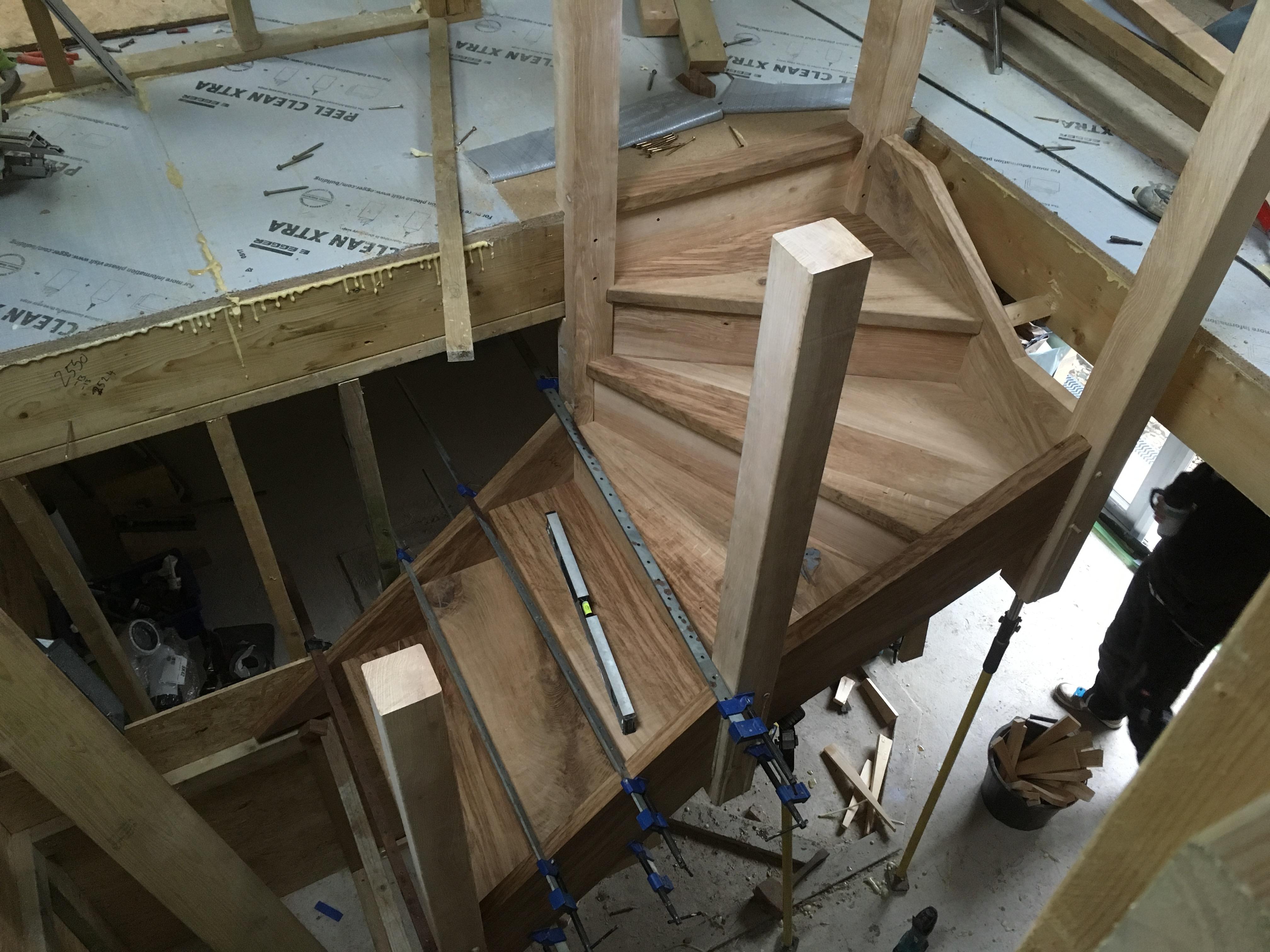

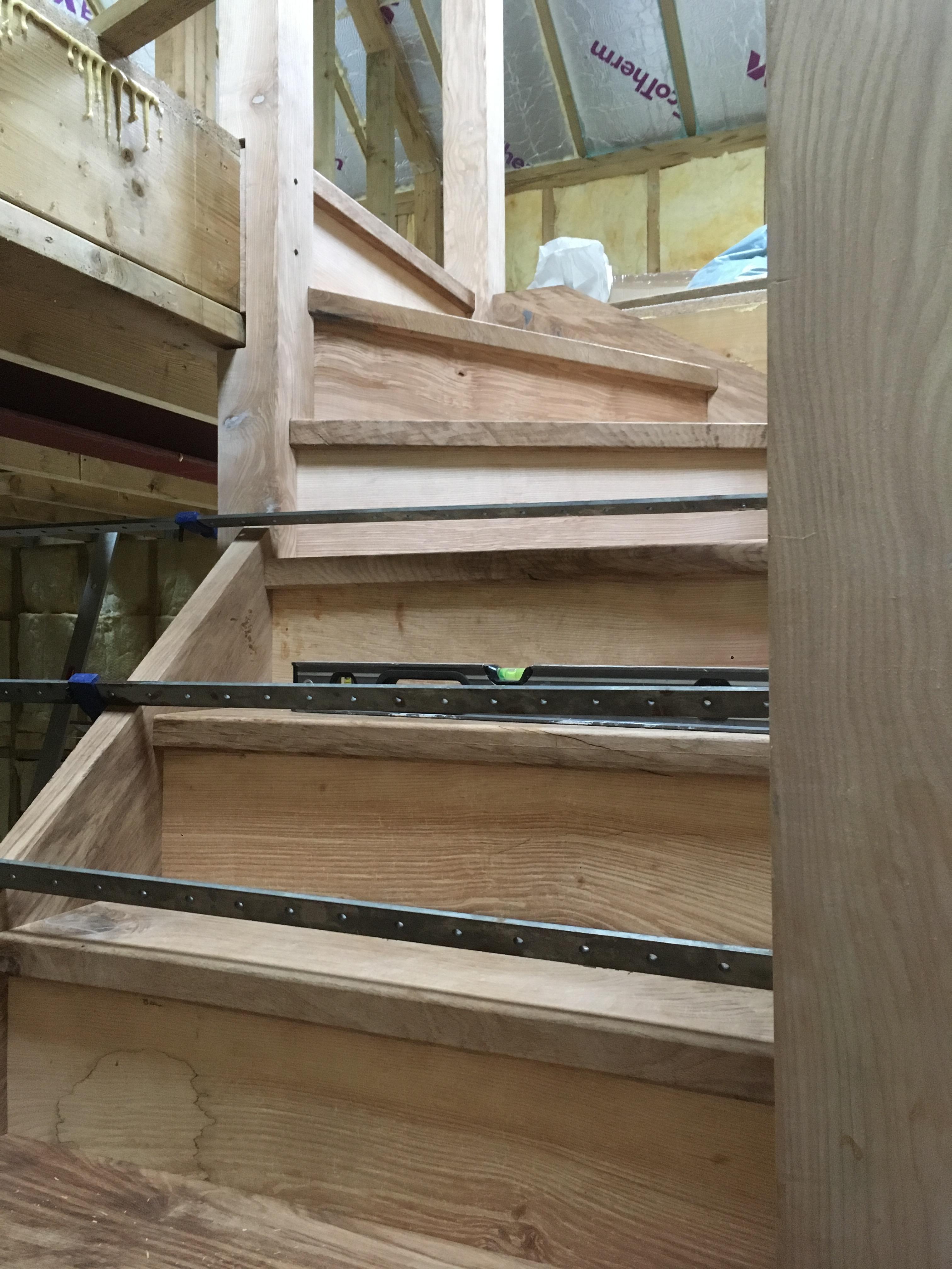

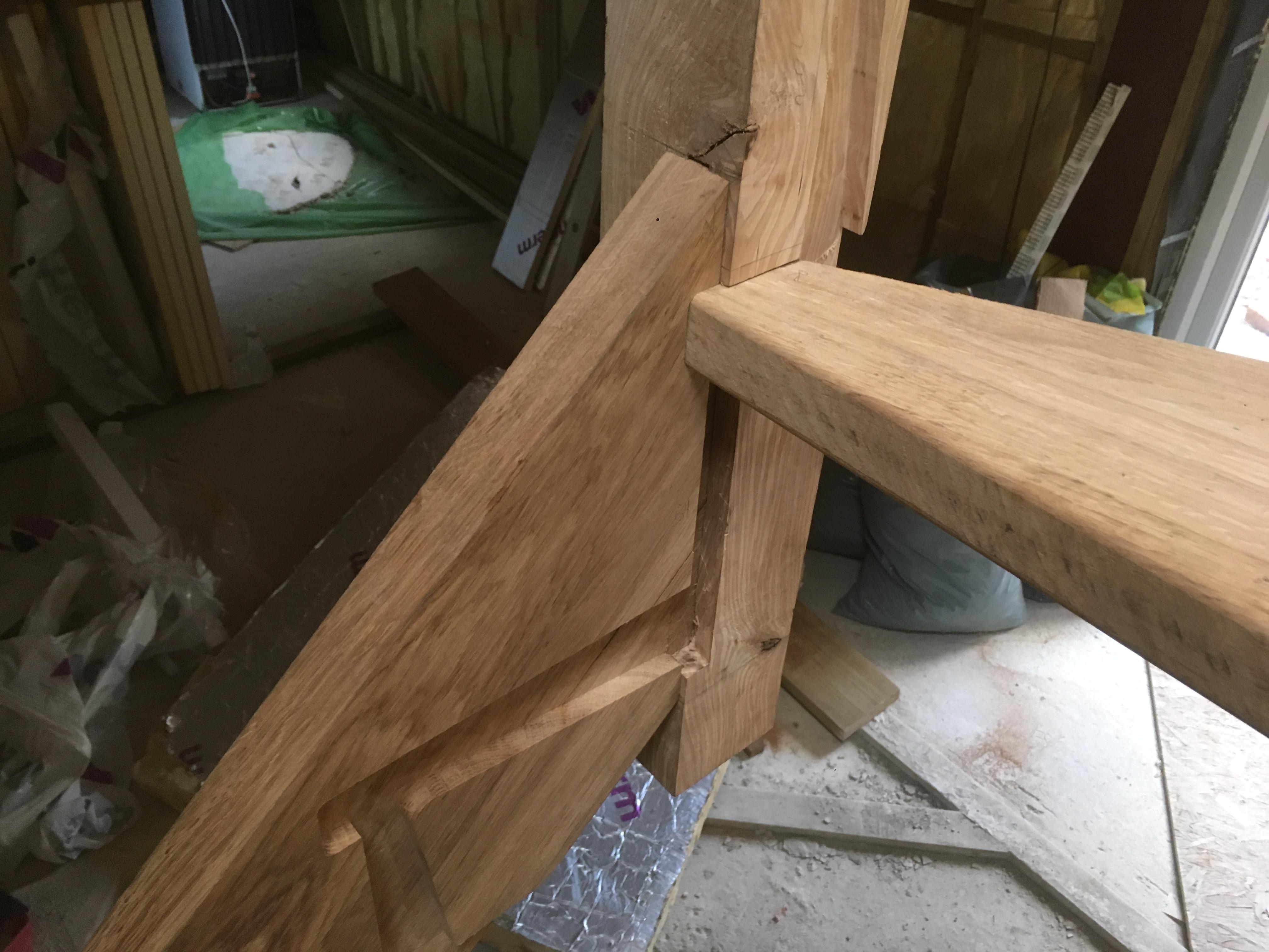

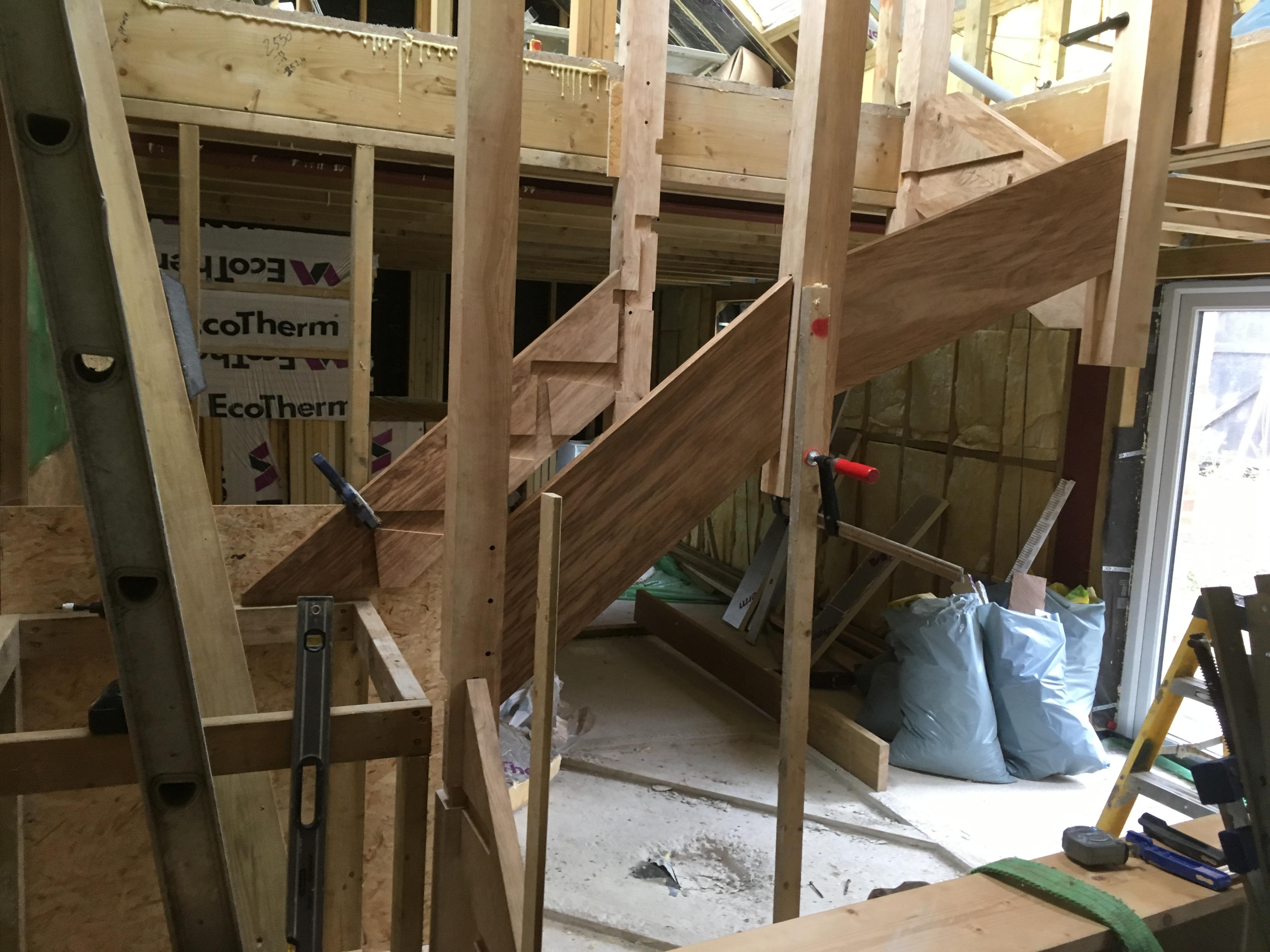

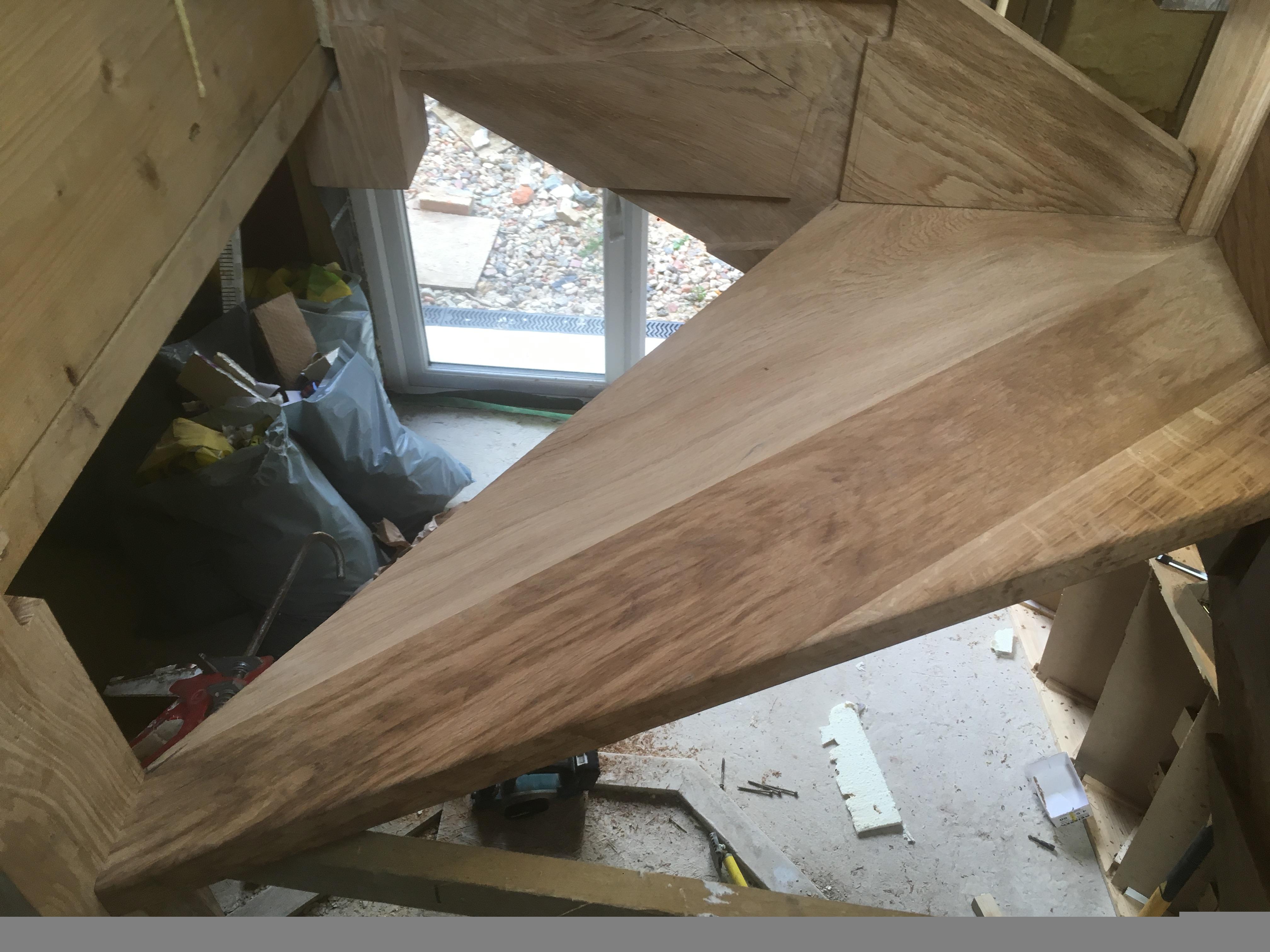

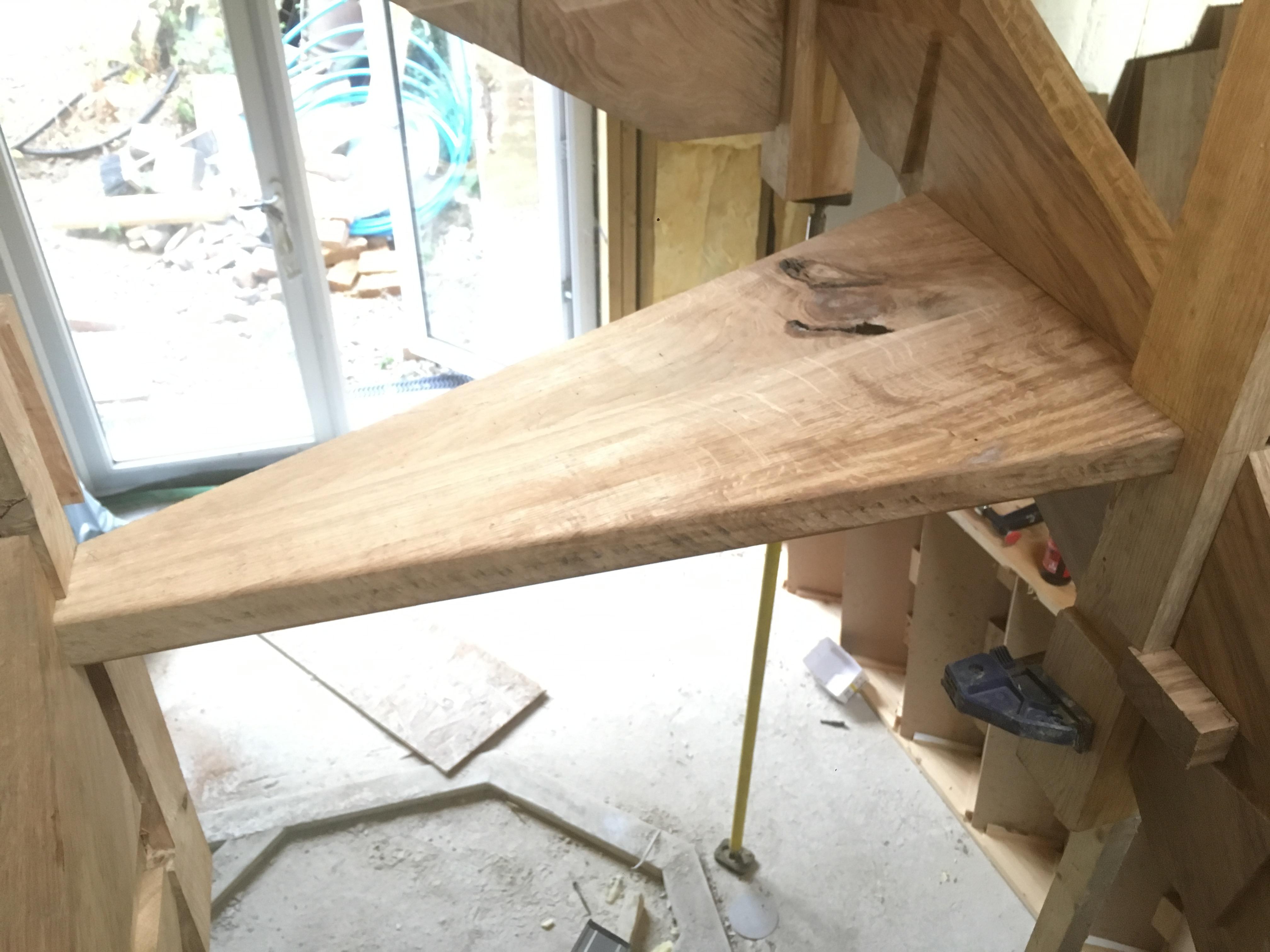

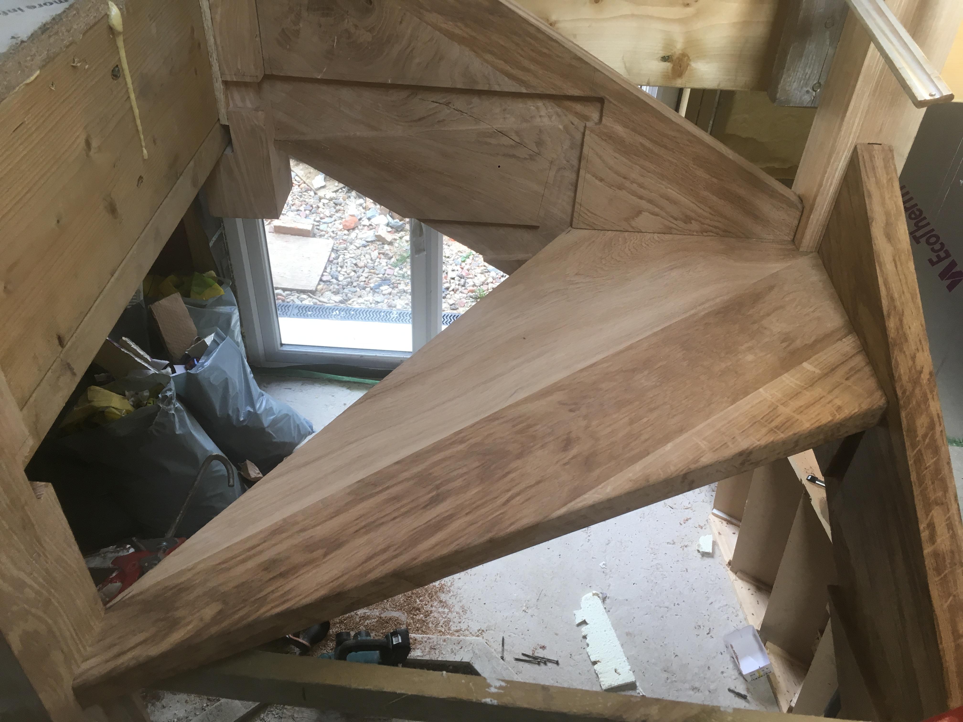

You would have thought having mocked it all up without the risers it would have all fitted together first time hey. Oh no! Every winder had to be adjusted ( including adding bits)... which I’m sure will come back to bite me in the arse. BUT they are in!!! I still need to trim the wedges, make the landing proper, and fit the bottom easy straight flight but Iv had enough stress this weekend. So we’re going to the pub, ( I might look at the landing tomorrow..... I might go shopping, I’ll see how I feel in the morning)

Putting it together was the most stressful part. Glue everywhere, tools getting covered, constant adjustment, I wouldn’t reccomend it to anyone.
