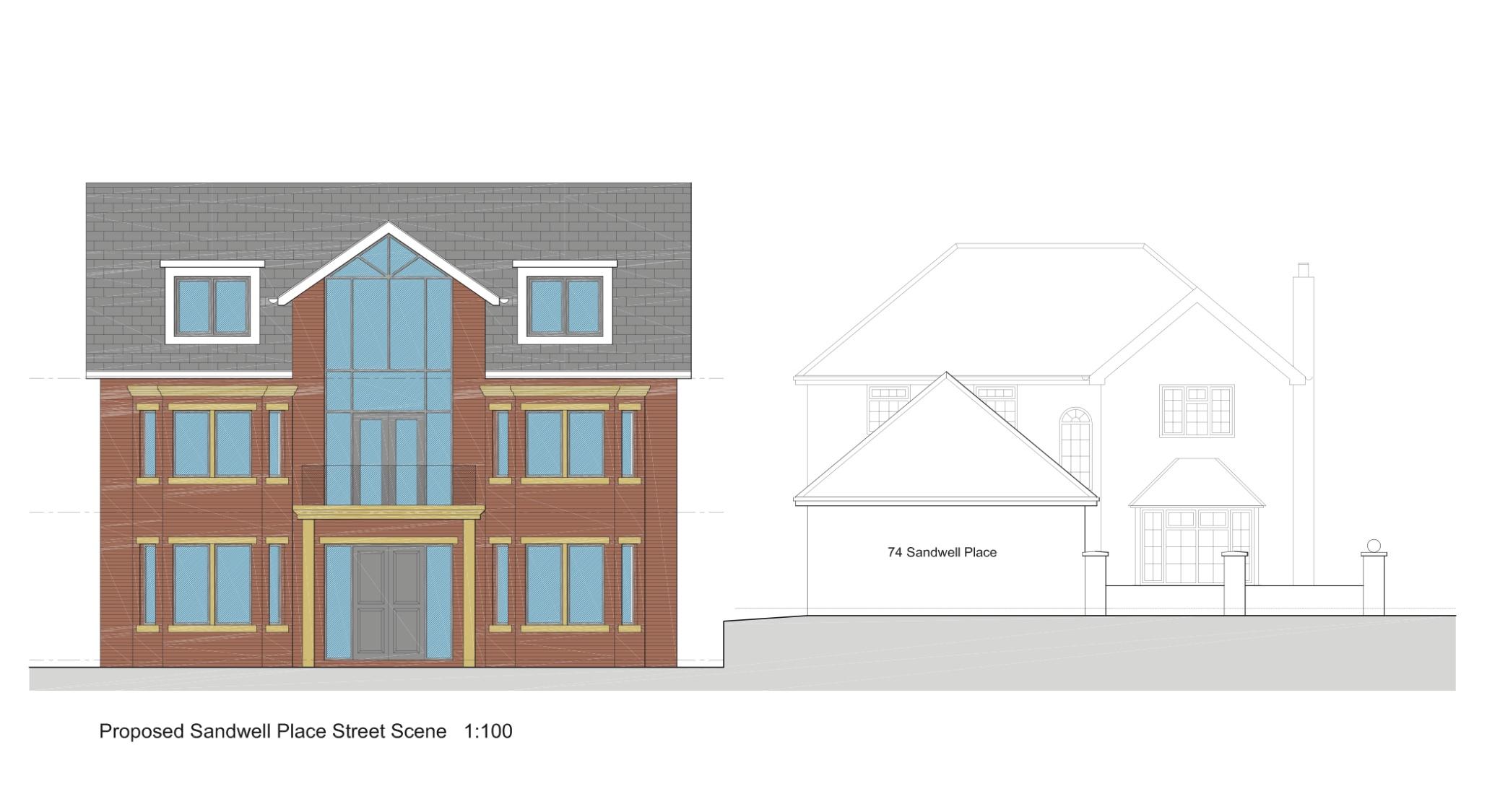

newhome Posted May 10, 2018 Share Posted May 10, 2018 (edited) Here you go: Original approved site plan (bearing in mind there seems to have been a lot of focus on the height of the house relative to the house next door during the planning application ) https://planning.stoke.gov.uk/online-applications/files/70FCAE28E96150419C9C72FD09150469/pdf/59699_FUL-AMENDED_DRAWING-198440.pdf It was always going to be higher than next door but the dormer windows were expected to end up lower than the house next door. In the BBC photo what they have built has the bottom of the dormers more or less starting at the same height as the top of next door's roof. Given the fuss made about the height of the house you would have thought that there would have been some care taken. Or he just thought he would get away with it anyway. Edited May 10, 2018 by newhome Link to comment Share on other sites More sharing options...

newhome Posted May 10, 2018 Share Posted May 10, 2018 (edited) Even in the first application (different applicant) in 2013 it looks like there were dormers in the roof https://planning.stoke.gov.uk/online-applications/files/03C3CEB17F9FFCFD5FC882C8AA2BCF9C/pdf/55746_FUL-PROPOSED_PLAN-108715.pdf Edited May 10, 2018 by newhome Link to comment Share on other sites More sharing options...

ProDave Posted May 10, 2018 Share Posted May 10, 2018 Looking at the plans in @newhome post above, the house is set too high on the plot. The gutter level of the new house should have been pretty much the same as next door but it is a lot higher. So no easy fix. I wonder at what stage of the build the planners noticed the error and started trying to enforce it? Link to comment Share on other sites More sharing options...

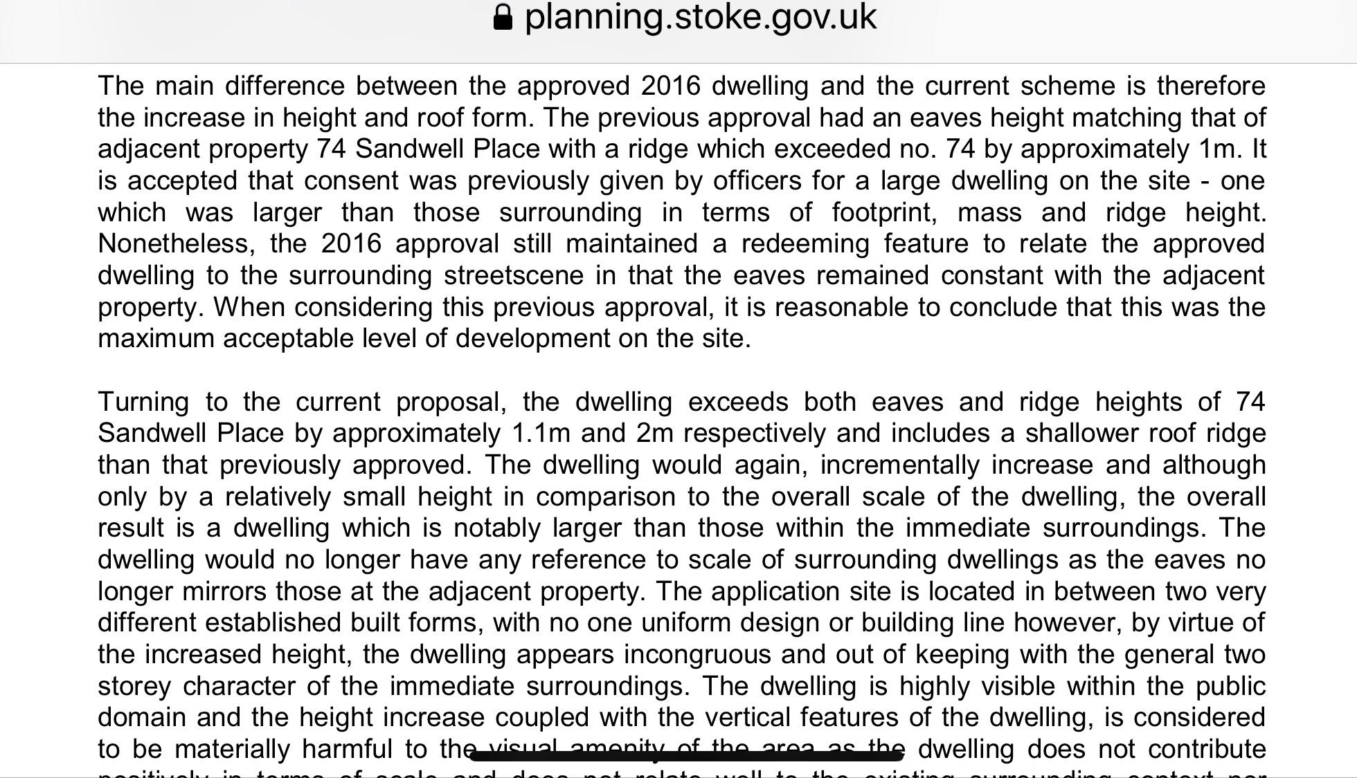

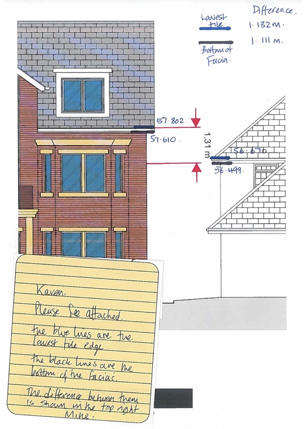

Ferdinand Posted May 10, 2018 Share Posted May 10, 2018 (edited) Looking at the PP, there was lots of work wrt soil contamination etc (former brickyard) and I wonder if they were just trying to save the expense of digging out all that ground and getting rid of potentially contaminated earth. It is a big erection for the plot, so it would be difficult to absorb all that earth on the site even if not contaminated. The attempted variation seems to me to be a little over-imaginative in its argumentation - and is attached. I note that the media reports quote the applicant's 0.75m alleged height increase, rather than the Council's 1.1m - presumably they didn't bother checking. The Council seem to me to have done a really professional job here. I would say that fixing the roof will be seriously expensive, since I think he would have to chop the top off that double storey central gable thing right through the middle of that (10k+?) two storey window, which would mean redoing all of that, then there's the two dormers which are wrong, and the bay windows are also above the original eaves line. Perhaps not £200k, but not far off, as the internal heights etc would also be buggered., and he would need full scaff again. Have attached the Council Report and the applicant's highly technical argument. F stoke-planning-demolition-case-62006_VAR-COMMITTEE_REPORT-262816.pdf stoke-planning-demolition-case-62006_VAR-TECHNICAL_NOTE-250219.pdf Edited May 10, 2018 by Ferdinand Link to comment Share on other sites More sharing options...
newhome Posted May 10, 2018 Share Posted May 10, 2018 (edited) 53 minutes ago, ProDave said: Looking at the plans in @newhome post above, the house is set too high on the plot. The gutter level of the new house should have been pretty much the same as next door but it is a lot higher. So no easy fix. I wonder at what stage of the build the planners noticed the error and started trying to enforce it? It says in the blurb that the house was still under construction when the retrospective permission was sought but that the owner pressed on and completed the build and occupied the building in the interim. Retrospective permission was applied for in July last year but they only made the final decision this week. This photo clearly demonstates the issue. The decision did also say that excavation was a condition of the planning permission to enable the height to be achieved as per the approved plans. Edited May 10, 2018 by newhome Link to comment Share on other sites More sharing options...
