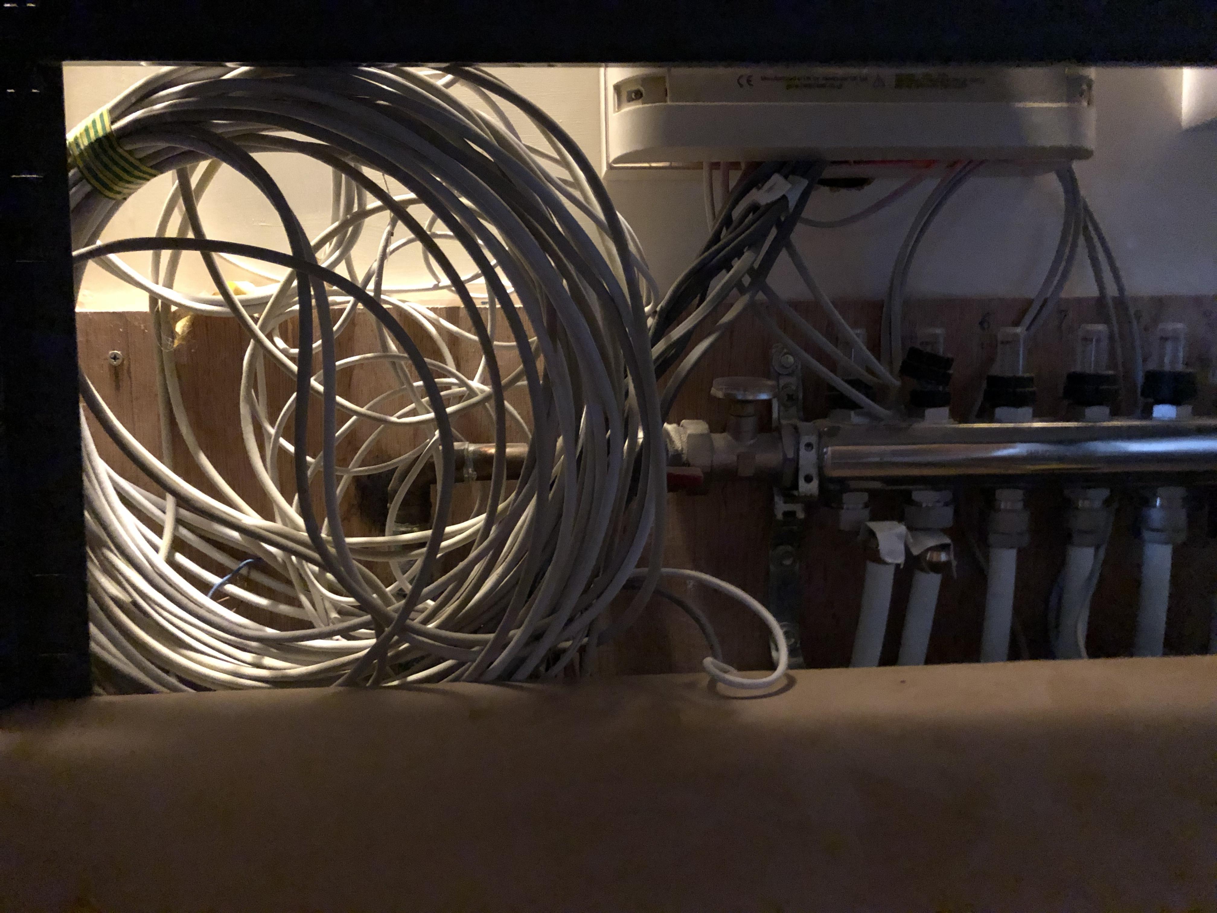

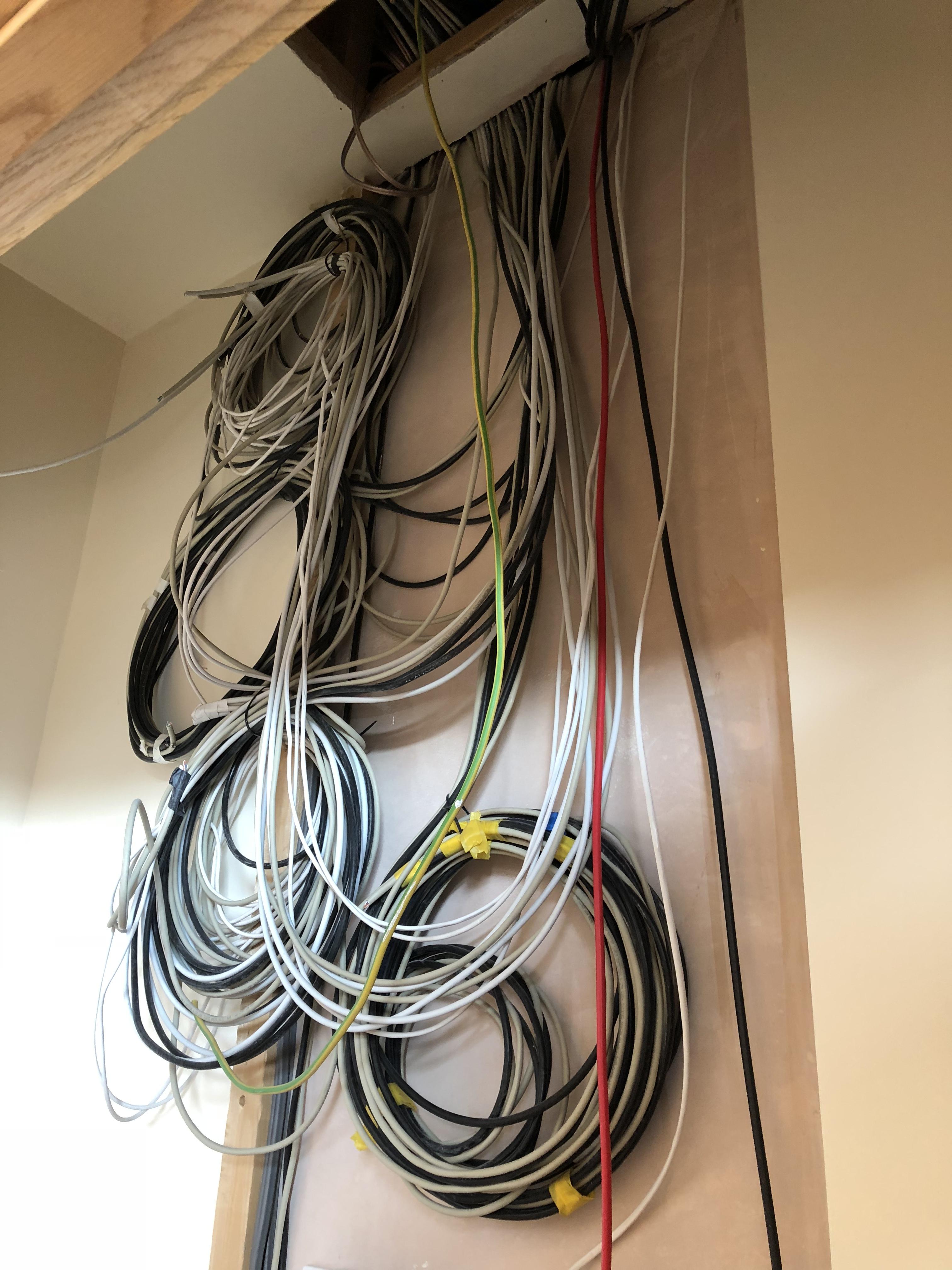

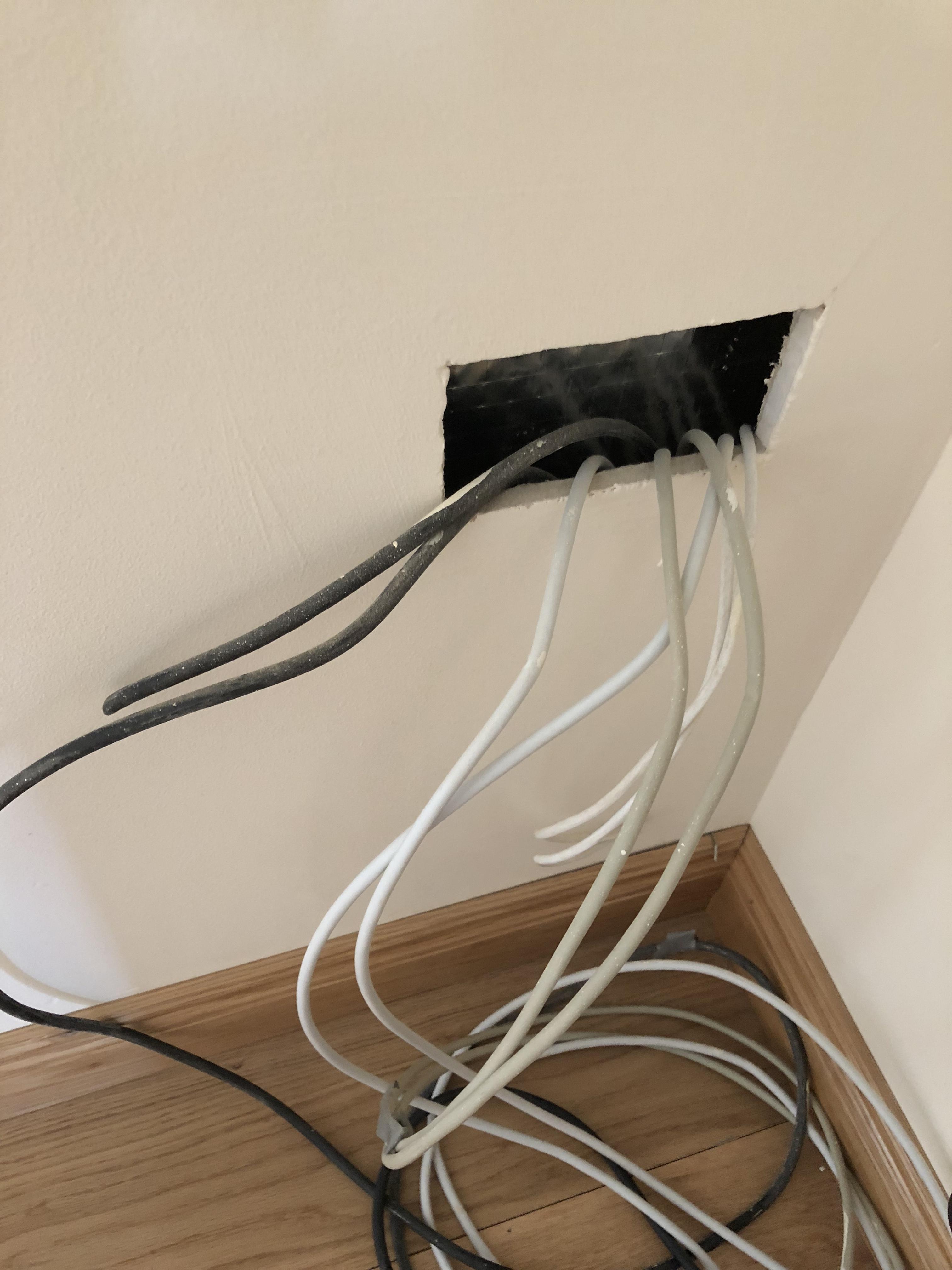

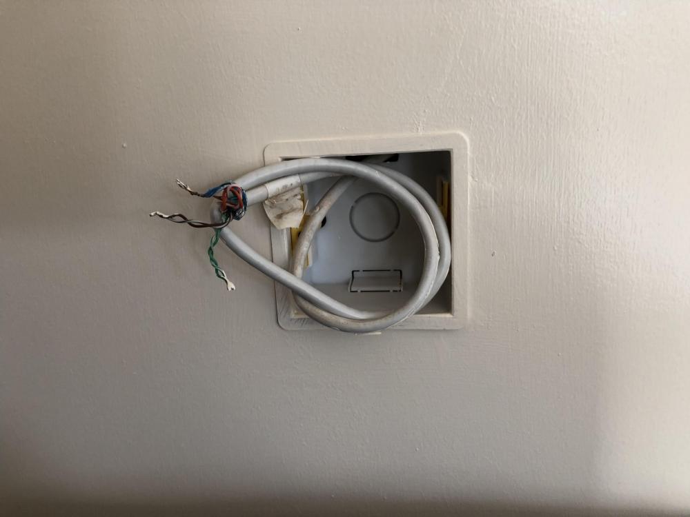

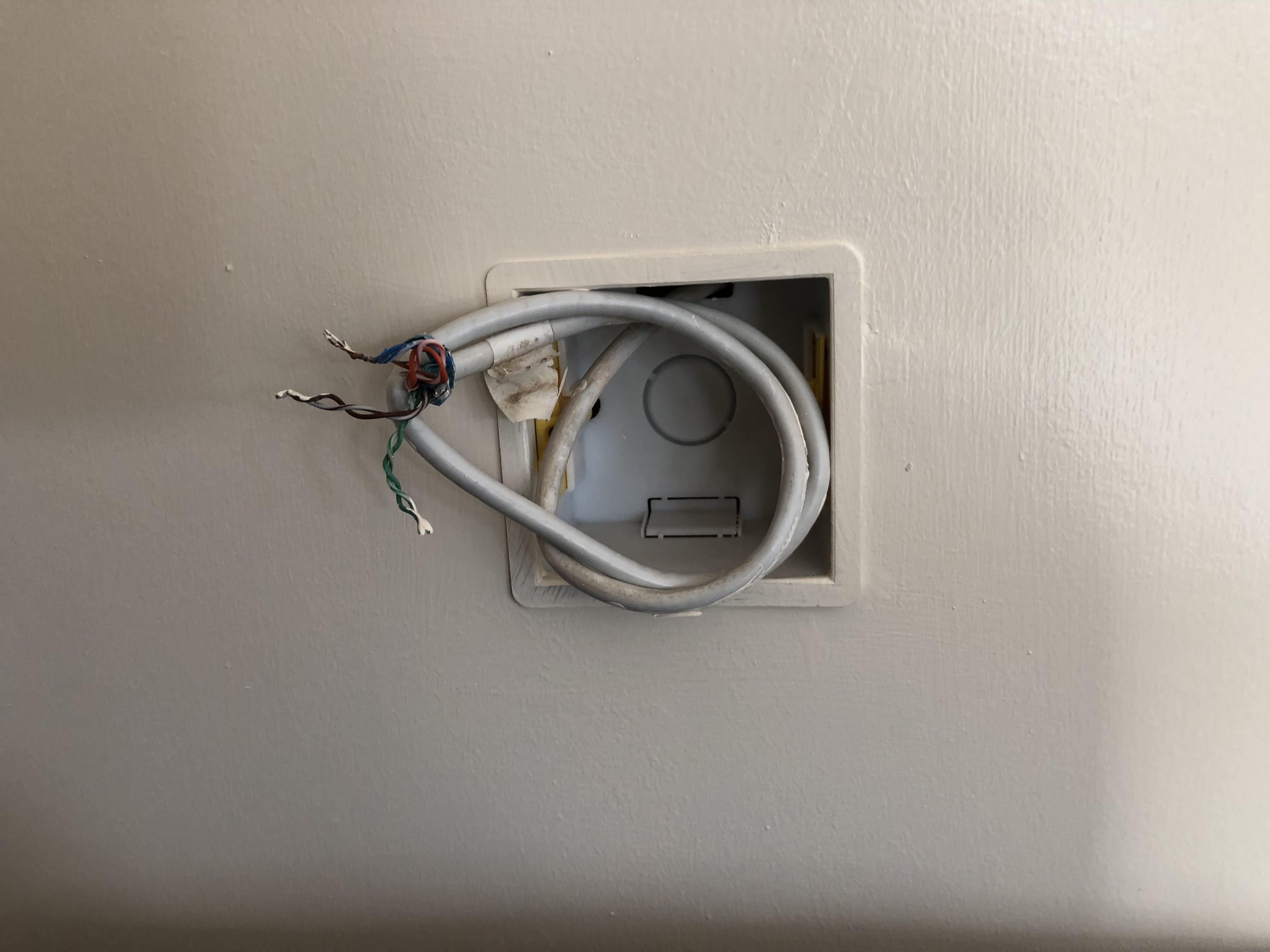

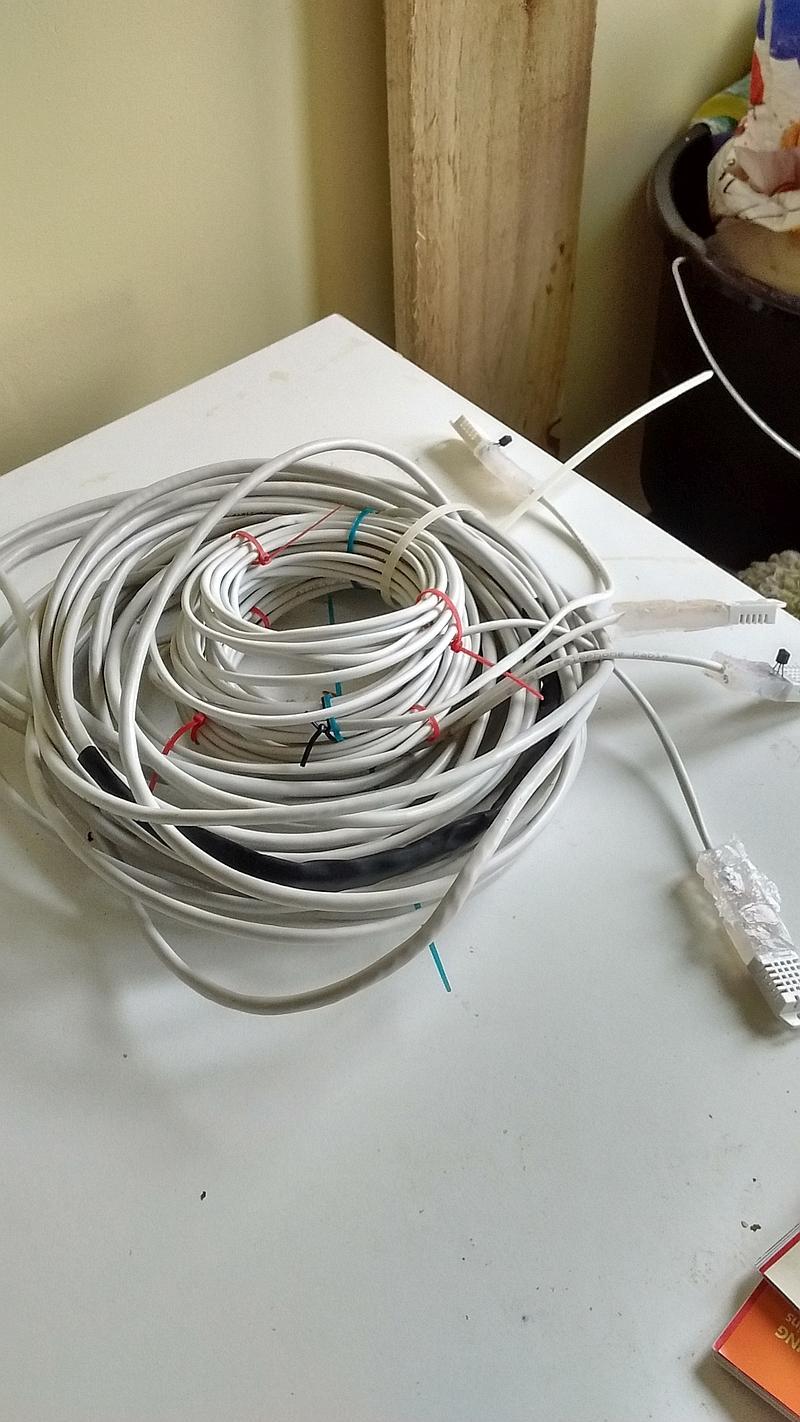

newhome Posted May 4, 2018 Share Posted May 4, 2018 3 minutes ago, SteamyTea said: Simple, plug in some monitoring equipment. Works for me. They are just cables sticking out of the wall though. As per photos! And there is something like this in every room, sometimes in more than 1 place. Presumably they were meant to be finished off somehow? Not been a priority up until now but now I’m not fighting the council or freezing to death I can get on with some of the final bits and pieces. They all seem to end up cupboards downstairs. It’s one of those ‘what the hell are these’ conversations I wish I’d had (there are many of those) Link to comment Share on other sites More sharing options...

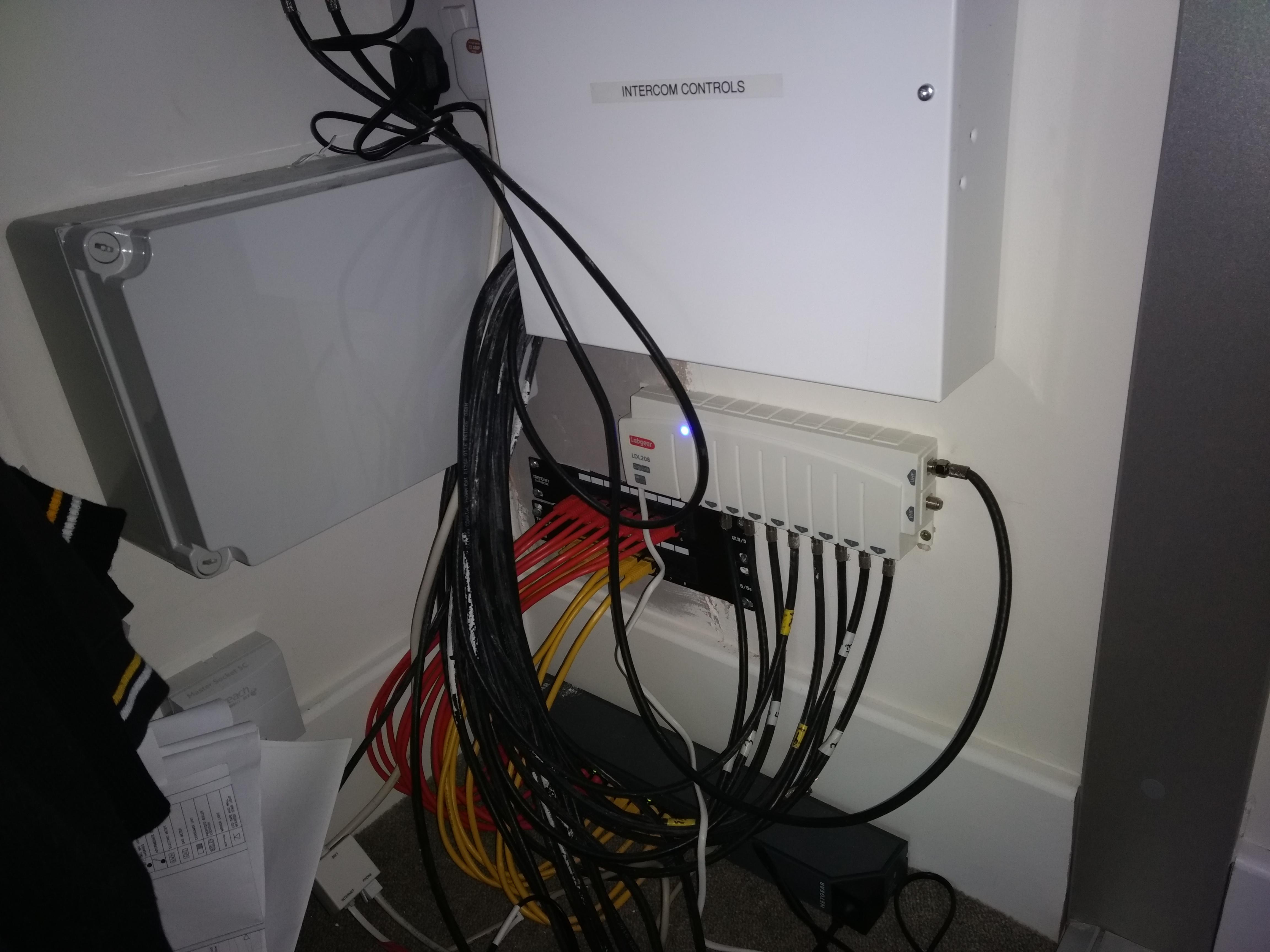

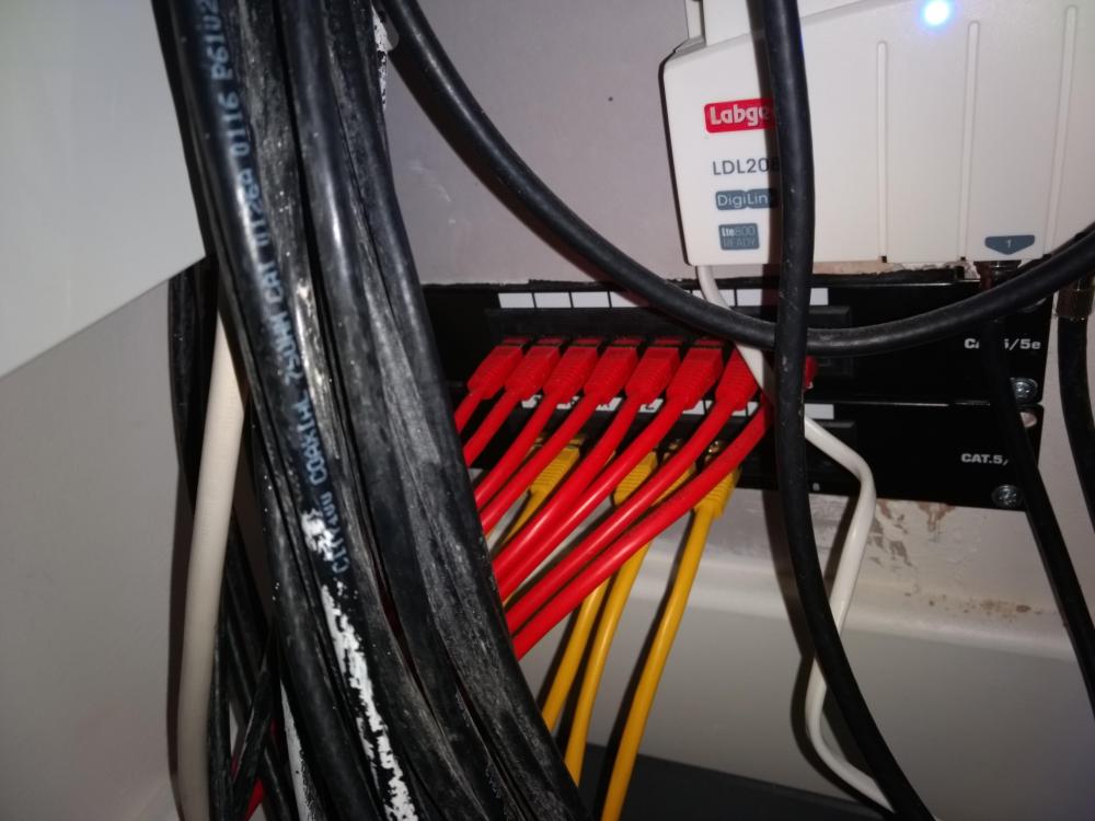

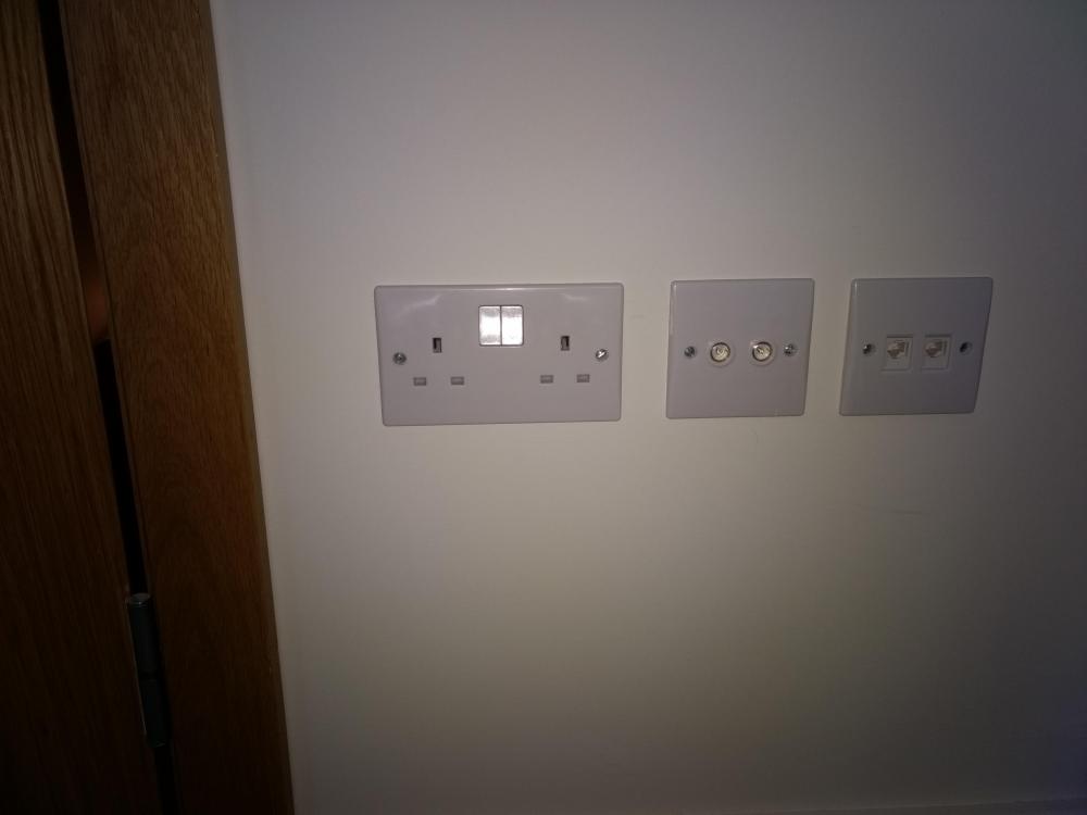

Mr Punter Posted May 4, 2018 Share Posted May 4, 2018 I would go for running 2 anywhere you are likely to use a tv, computer, printer or phone. Run back to a central location where you also have power. I terminated them into a couple of 8 port Trendnet patch panels flush mounted into the plasterboard and connected up with patch leads into a 16 port gigabyte switch. I went for a fanless one as it is a wardrobe and I didn't want any noise. Also ran all the tv coax to the same location. It is a bit of a cable fest, but it works well. 1 Link to comment Share on other sites More sharing options...
newhome Posted May 4, 2018 Share Posted May 4, 2018 4 minutes ago, Mr Punter said: I terminated them into a couple of 8 port Trendnet patch panels flush mounted into the plasterboard and connected up with patch leads into a 16 port gigabyte switch. I went for a fanless one as it is a wardrobe and I didn't want any noise. Also ran all the tv coax to the same location. Can you post a photo of how yours are finished off in your rooms please. Link to comment Share on other sites More sharing options...
Mr Punter Posted May 4, 2018 Share Posted May 4, 2018 Some pics 1 Link to comment Share on other sites More sharing options...
Mr Punter Posted May 4, 2018 Share Posted May 4, 2018 And in the rooms... 1 Link to comment Share on other sites More sharing options...

newhome Posted May 4, 2018 Share Posted May 4, 2018 3 minutes ago, SteamyTea said: Perfect. Can connect these too it. That’s good for a cupboard. Need something neater round the walls of the rooms. @Mr Punter‘s set up looks nice and neat. Job for @PeterW‘s little Willy probably Link to comment Share on other sites More sharing options...

billt Posted May 4, 2018 Share Posted May 4, 2018 2 hours ago, newhome said: They are just cables sticking out of the wall though. As per photos! The rooms should be easy to fix if you aren't going to use the cables, just fit a pattress box if there isn't one, push most of the cable back into the wall leaving a short end accessible in the pattress box and cover with a blanking plate. Simple and cheap. 1 Link to comment Share on other sites More sharing options...
