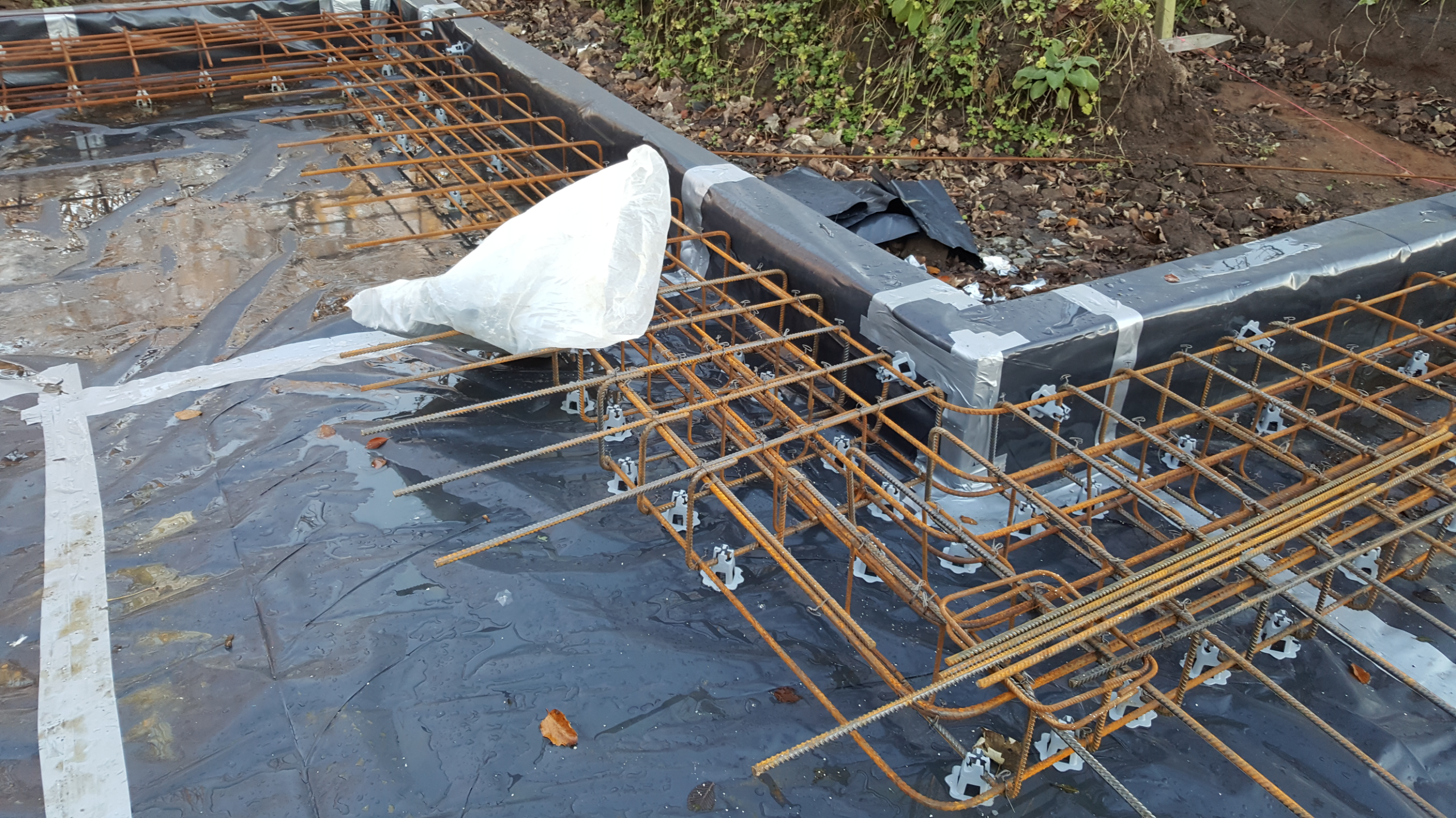

Alexphd1 Posted March 9, 2018 Posted March 9, 2018 we have never worked with rebar so we bought the machine off ebay. was impressed with it esp on slab we had a lot of steel work to do!

Alexphd1 Posted March 9, 2018 Posted March 9, 2018 (edited) we used tie wraps on UFH pipes to steel mesh and where we couldn't get the gun into, not a fan. Edited March 9, 2018 by Alexphd1
MikeSharp01 Posted March 9, 2018 Posted March 9, 2018 28 minutes ago, Alexphd1 said: Very tidy work with the dpc, what is the tape you are using and is it double sealed along both edges or one double sided and the upper edge over taped? I guess there is a rising section of EPS in the centre to be fitted as well. Why were you not a fan of the tie wraps?
Alexphd1 Posted March 9, 2018 Posted March 9, 2018 i cant remember what tape it was the stuff from the dpm manufacturer. TBH tie wraps was fine for UFH but for the steel it didnt really bite to firm up the structure.
