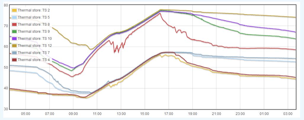

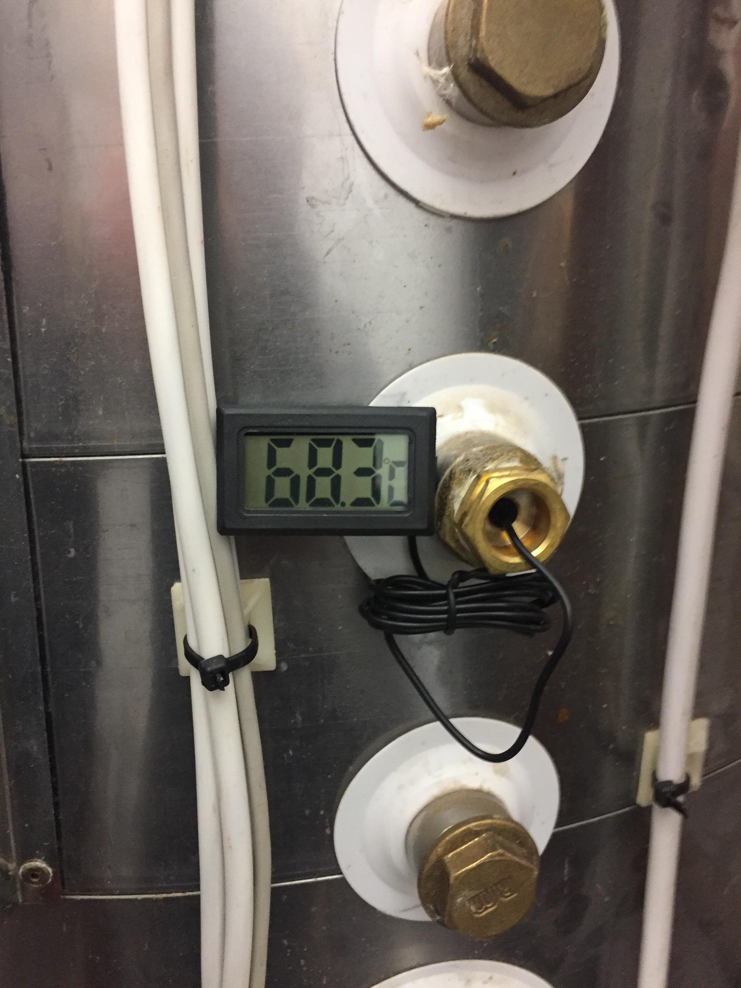

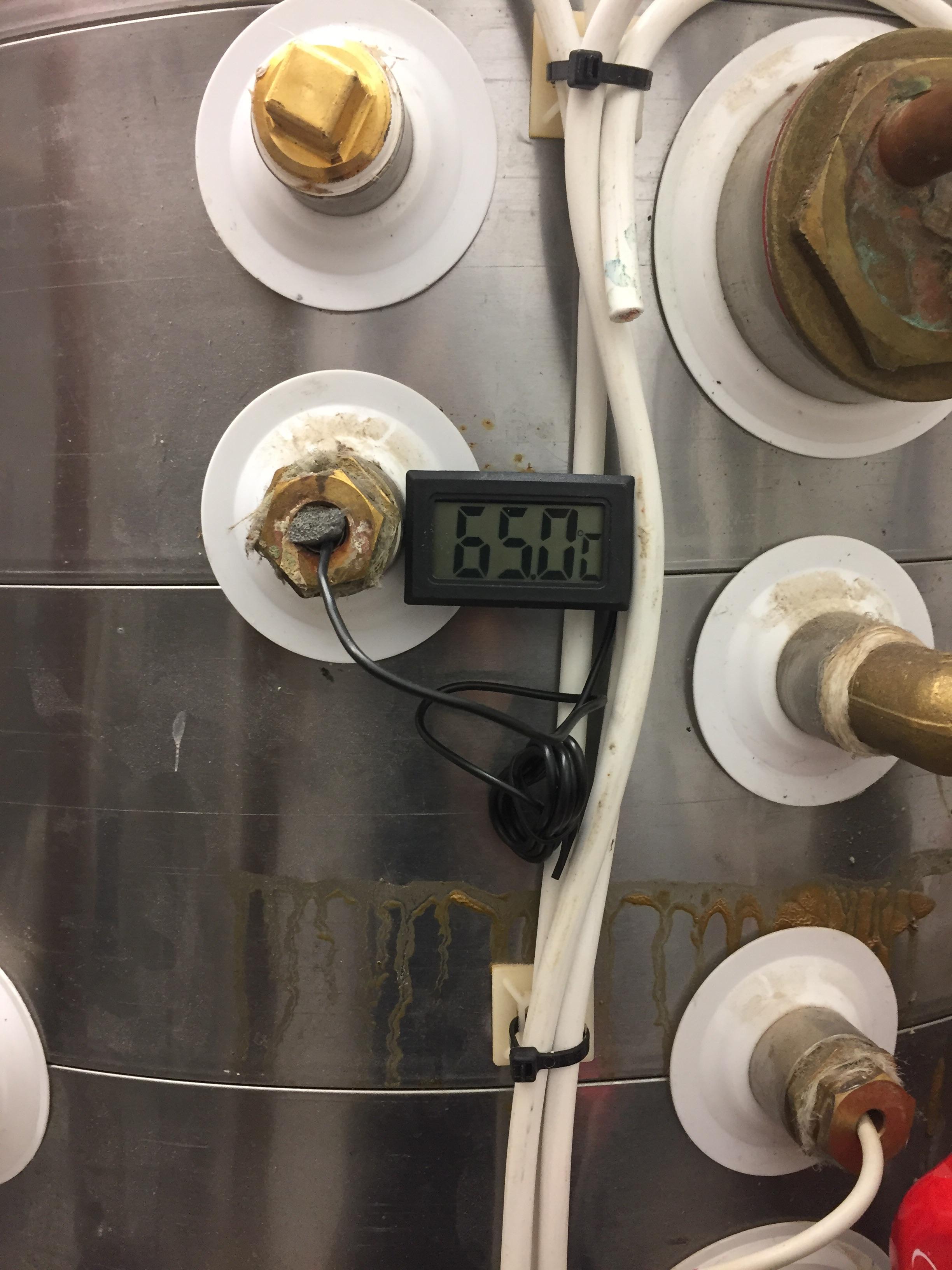

Nickfromwales Posted April 7, 2018 Posted April 7, 2018 39 minutes ago, Onoff said: Joking aside it's great this is getting done. Upper reading And the lower one. The weird world of the TS. Work that shit out. !
newhome Posted April 7, 2018 Author Posted April 7, 2018 (edited) @Onoff the temperature gadgets coming in handy! Edited April 7, 2018 by newhome
Onoff Posted April 7, 2018 Posted April 7, 2018 (edited) Are they the cheapo thermometers @newhome said about getting? Edit: Crossed posts! Edited April 7, 2018 by Onoff 1

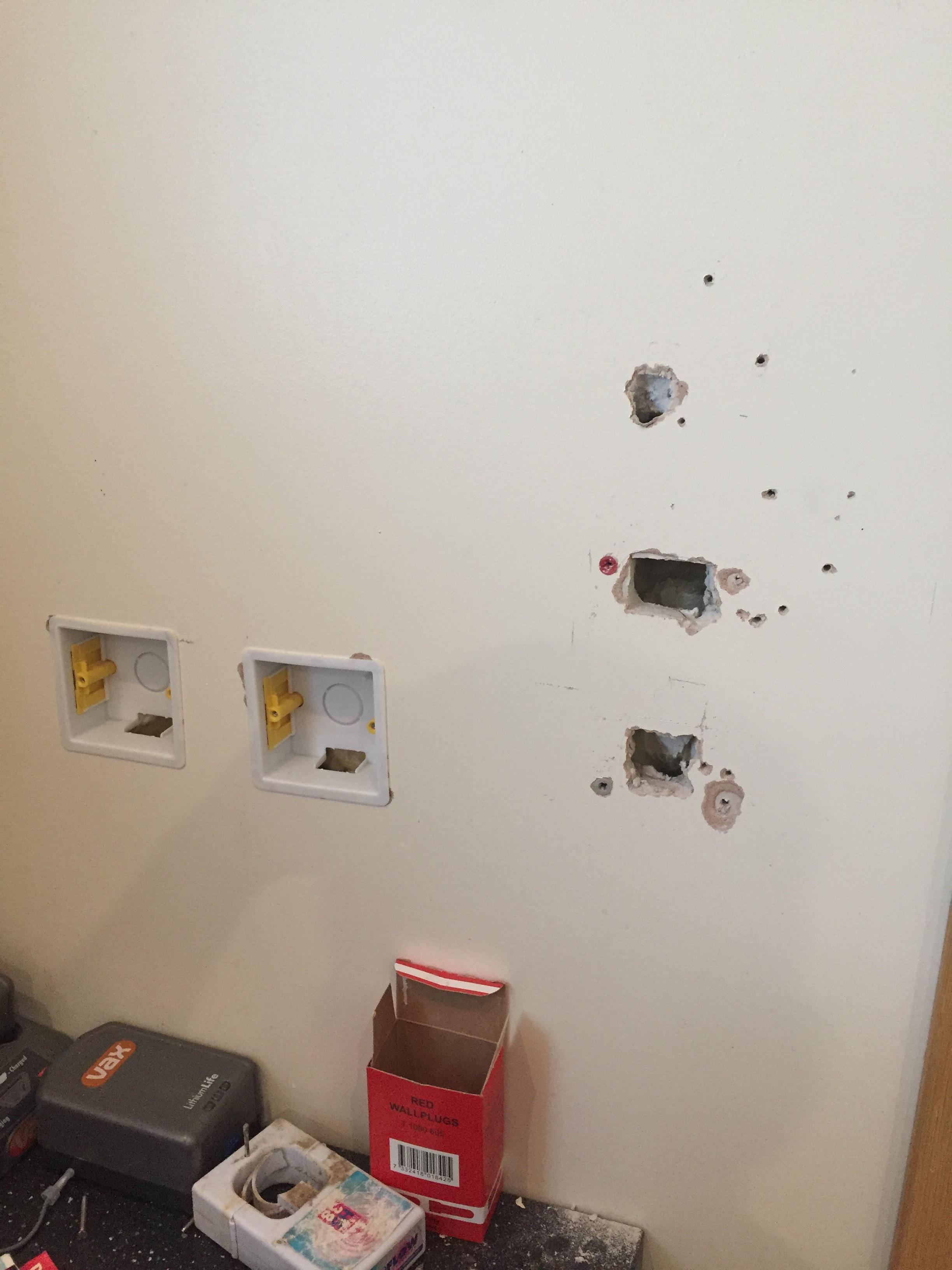

Nickfromwales Posted April 7, 2018 Posted April 7, 2018 This photo shows the controls that we retained ( that cock plumber fitted ). Polyfiller time........... 1 1
Onoff Posted April 7, 2018 Posted April 7, 2018 34 minutes ago, newhome said: @Onoff the temperature gadgets coming in handy! Are they accurate enough? Not sure what the tolerance is on them..... Swap 'em round on the TS and see if the same top/bottom oddity? I just use mine as a rough indicator. How many did you buy?
Onoff Posted April 7, 2018 Posted April 7, 2018 34 minutes ago, Nickfromwales said: This photo shows the controls that we retained ( that cock plumber fitted ). Polyfiller time........... Low exp. foam first?
Nickfromwales Posted April 7, 2018 Posted April 7, 2018 5 minutes ago, Onoff said: Low exp. foam first? Could you knock something up on CAD for me ?
billt Posted April 7, 2018 Posted April 7, 2018 1 hour ago, Nickfromwales said: Work that shit out. ! First thought is a measurement error. How deep are the pockets?, How good is the contact between the sensor and the pocket lining? Temperature sensors are very sensitive to contact quality. 3.3C isn't much of a difference and could easily be a measurement issue. If it's a genuine difference then the store isn't being heated in a stratified way or heat is being removed from the top first. Can't remember how big the store is, but maybe stratification isn't that good in fairly small stores. This what a 2,500l store looks like.

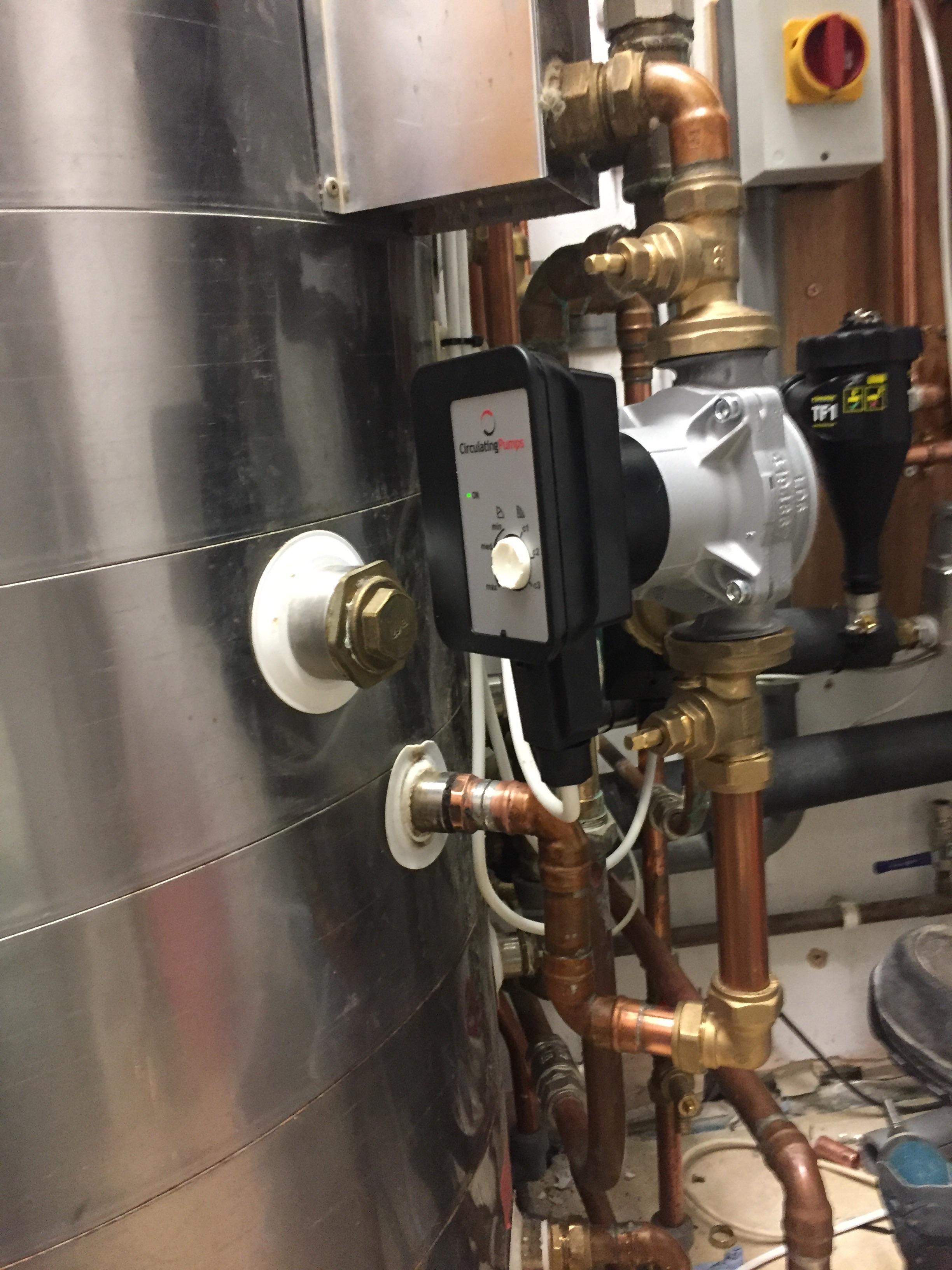

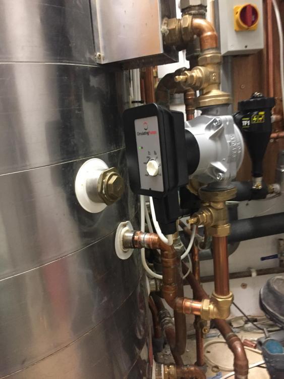

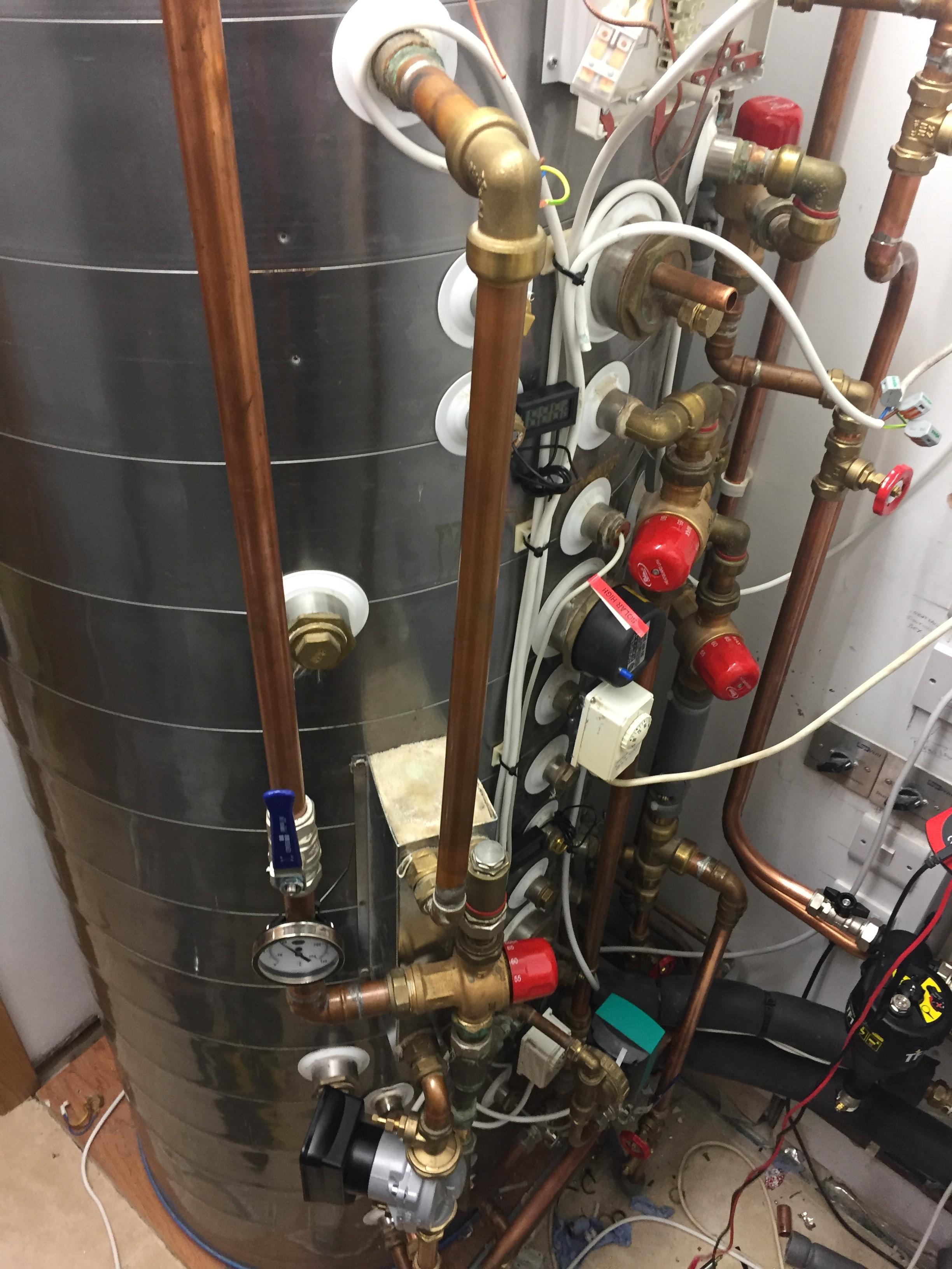

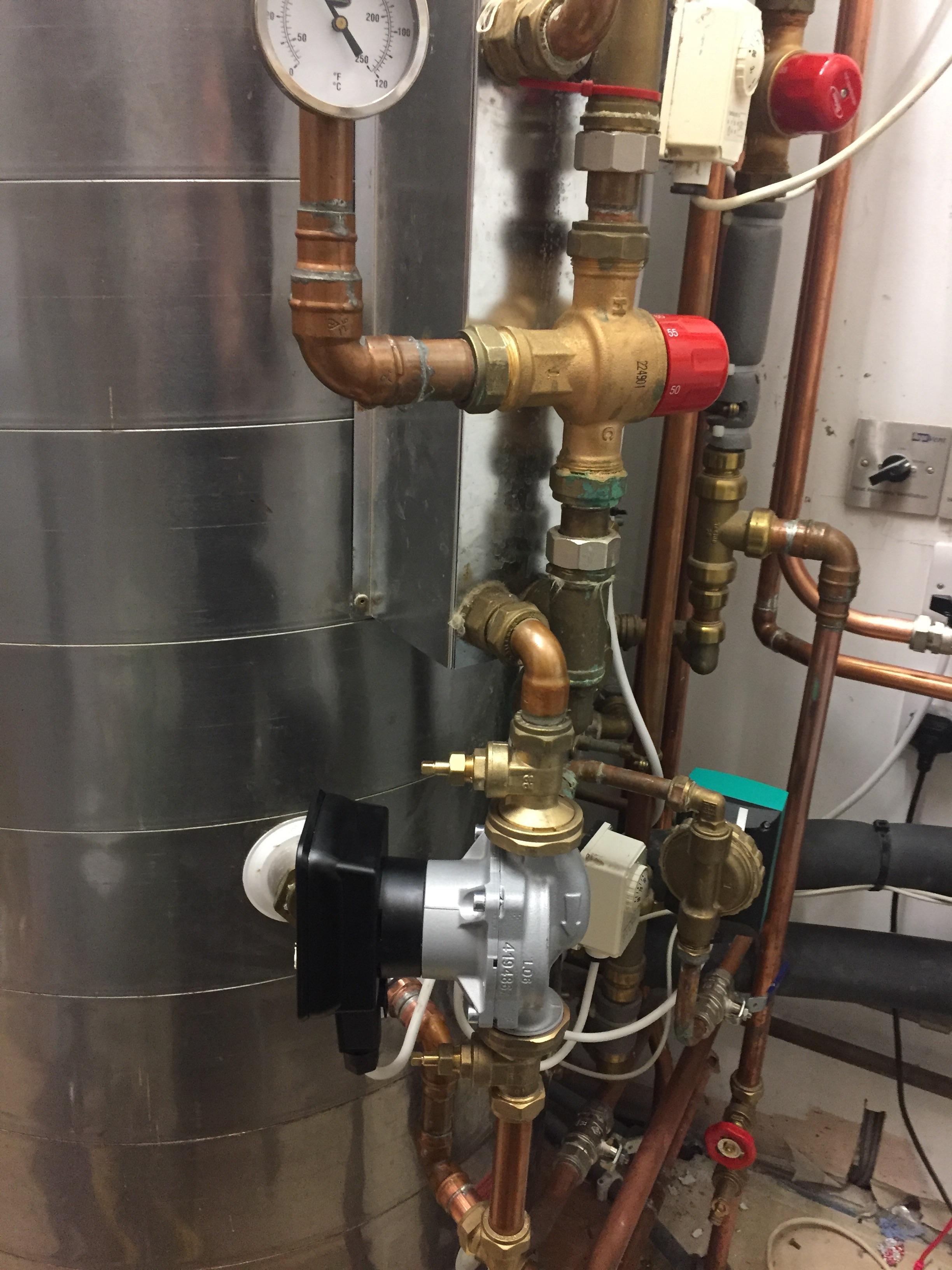

Nickfromwales Posted April 7, 2018 Posted April 7, 2018 22 minutes ago, billt said: First thought is a measurement error. How deep are the pockets?, How good is the contact between the sensor and the pocket lining? Temperature sensors are very sensitive to contact quality. 3.3C isn't much of a difference and could easily be a measurement issue. If it's a genuine difference then the store isn't being heated in a stratified way or heat is being removed from the top first. Can't remember how big the store is, but maybe stratification isn't that good in fairly small stores. This what a 2,500l store looks like. My fault for teasing. The DHW PHE pump sucks hot out of the top and returns it into the very bottom, thus 'stirring the pot'. That pump is controlled by the DHW flow switch, but seeing that cock end bypassed the relays that ran that pump ( and the HR pump ) and used the flow switch to run them direct it went into meltdown and ran the pump to its early death ( hence why the TS wouldn't hold heat for long after the boilers timed burn after cock end "fixed it" ). Out of the top and down into the PHE behind the DHW TMV. Out of the PHE, down through the DHW circulation pump, And into the lower 1/3 of the tank. Those little stats work well, as without that DHW pump running the heat can be seen to work its way down the tank. .

Onoff Posted April 7, 2018 Posted April 7, 2018 18 minutes ago, Nickfromwales said: Or we could go next level crazy with this extraordinary piece of technological wizardry You're so A to B! 24 minutes ago, Nickfromwales said: Those little stats work well, as without that DHW pump running the heat can be seen to work its way down the tank. . Nice to know my input was vital to the project! 1
