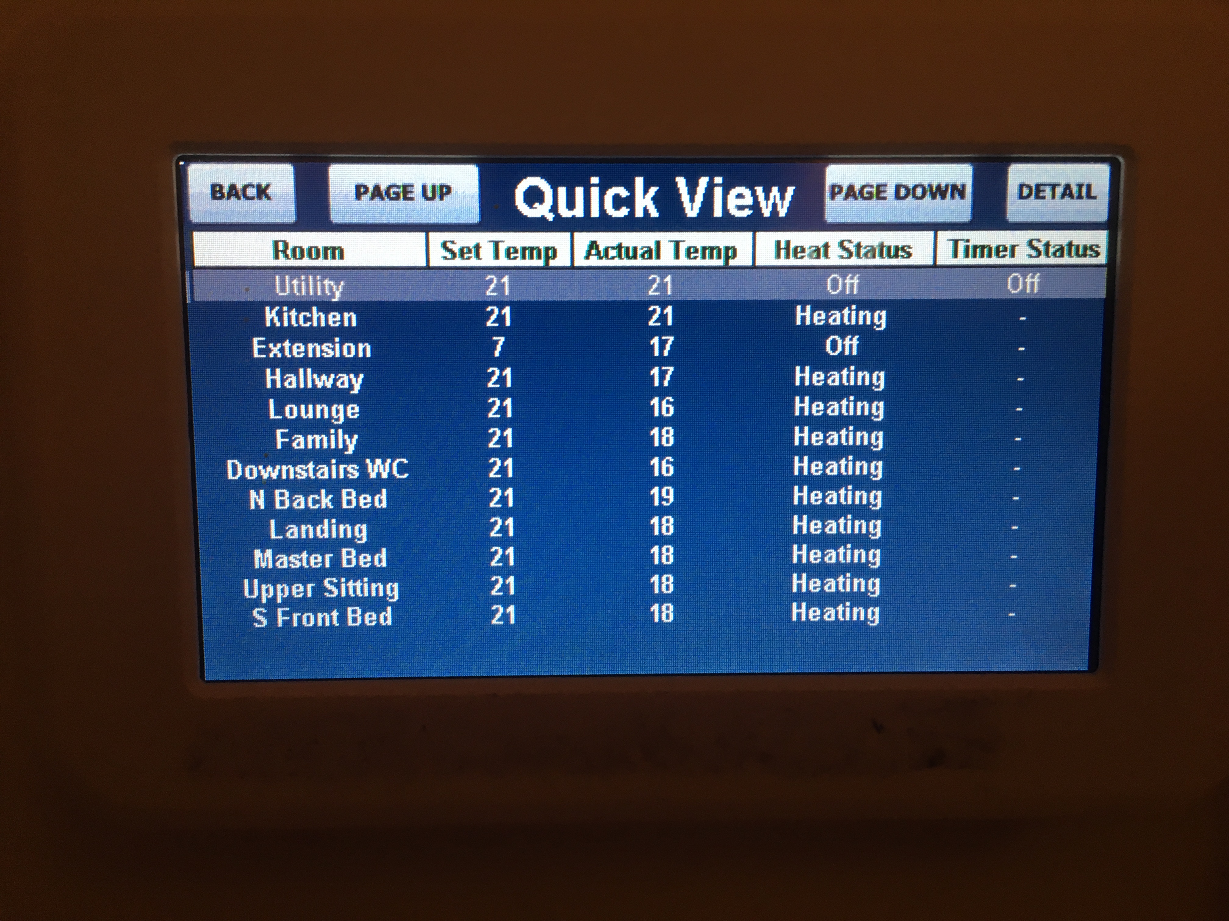

  • Will be leaving the technical speak to@Nickfromwales and @PeterW    From my perspective:   heating working in all rooms - tick! solar working - tick! rooms heating rapidl

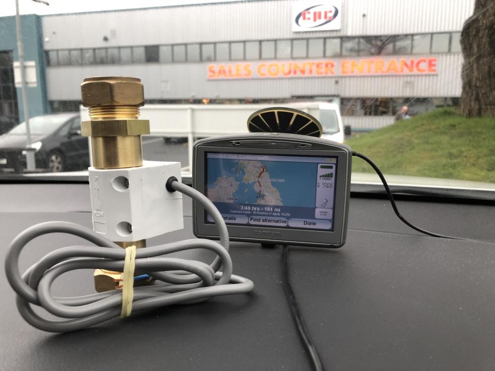

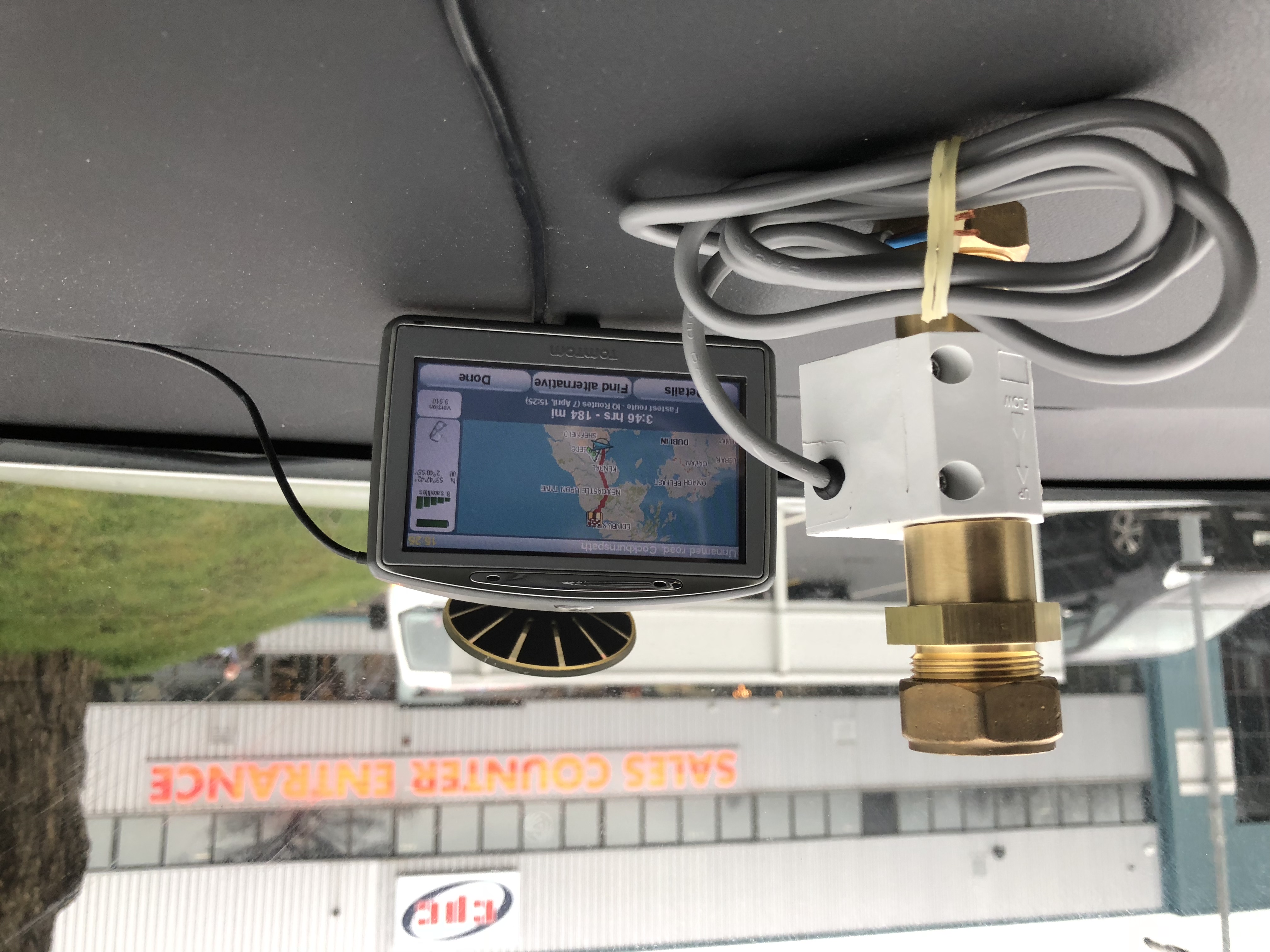

Don't even speak about CPC..!!! Sent a part by UPS on a paid for Saturday delivery and forgot to say it wouldn’t be delivered... til Tuesday ..!! Which according to the UPS Polish call centre is “Next Working Day”....!!
But on the up side, the main display now shows this ...
You must be well chuffed!
Your SatNav says 'Find Alternative'
Do they find plumbing parts now as well as speed cameras
5 hours ago, newhome said:
It is a thing of beauty! Homeward bound now
Not been without its challenges ..! Proper team effort and there is a growing pile of brass and scrap copper that is just surplus to requirements ..!
And an abject lesson to anyone who has a thermal store - order one with a built in coil rather than a PHE and save yourself half a ton of scrap ..!
