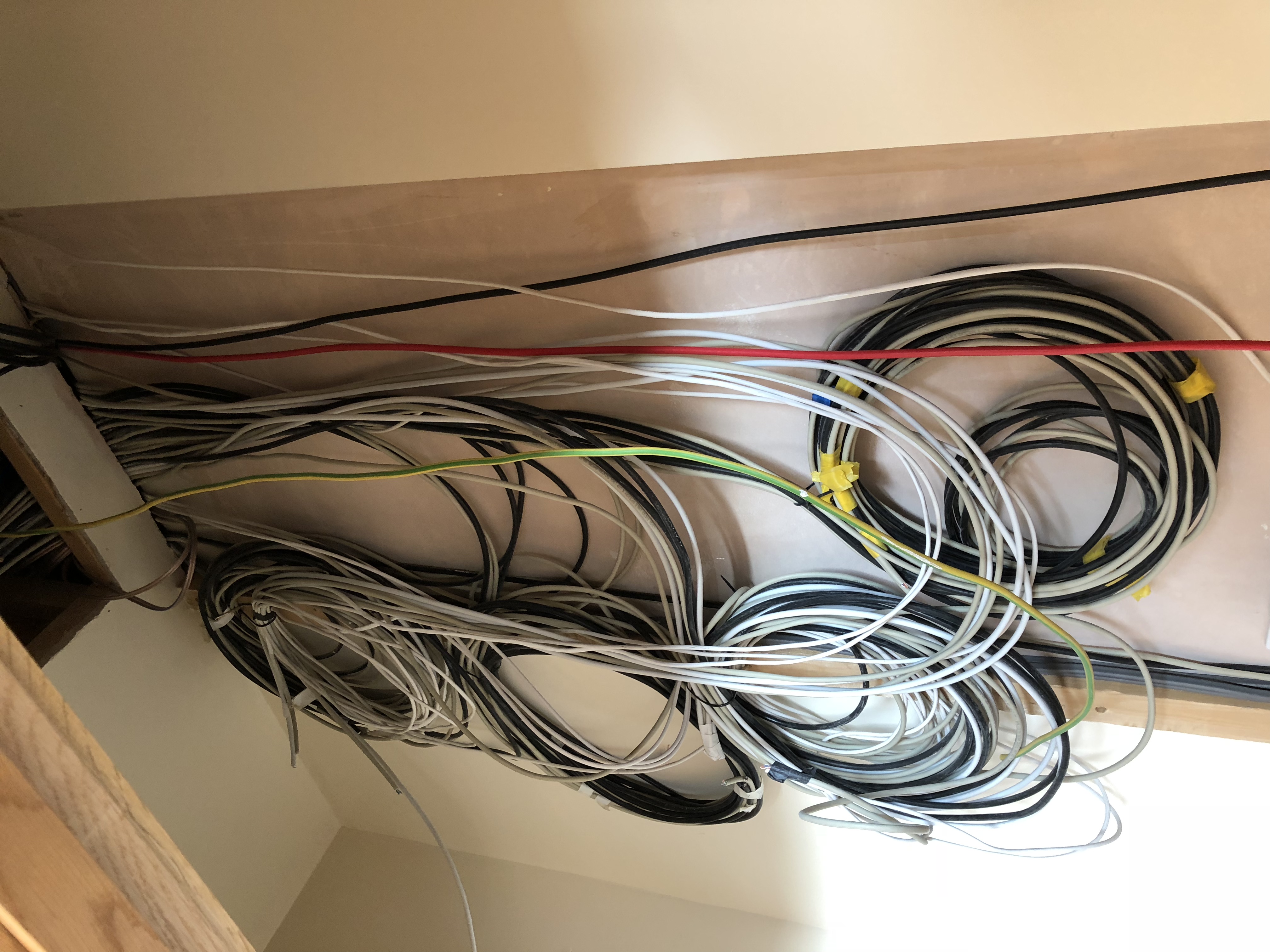

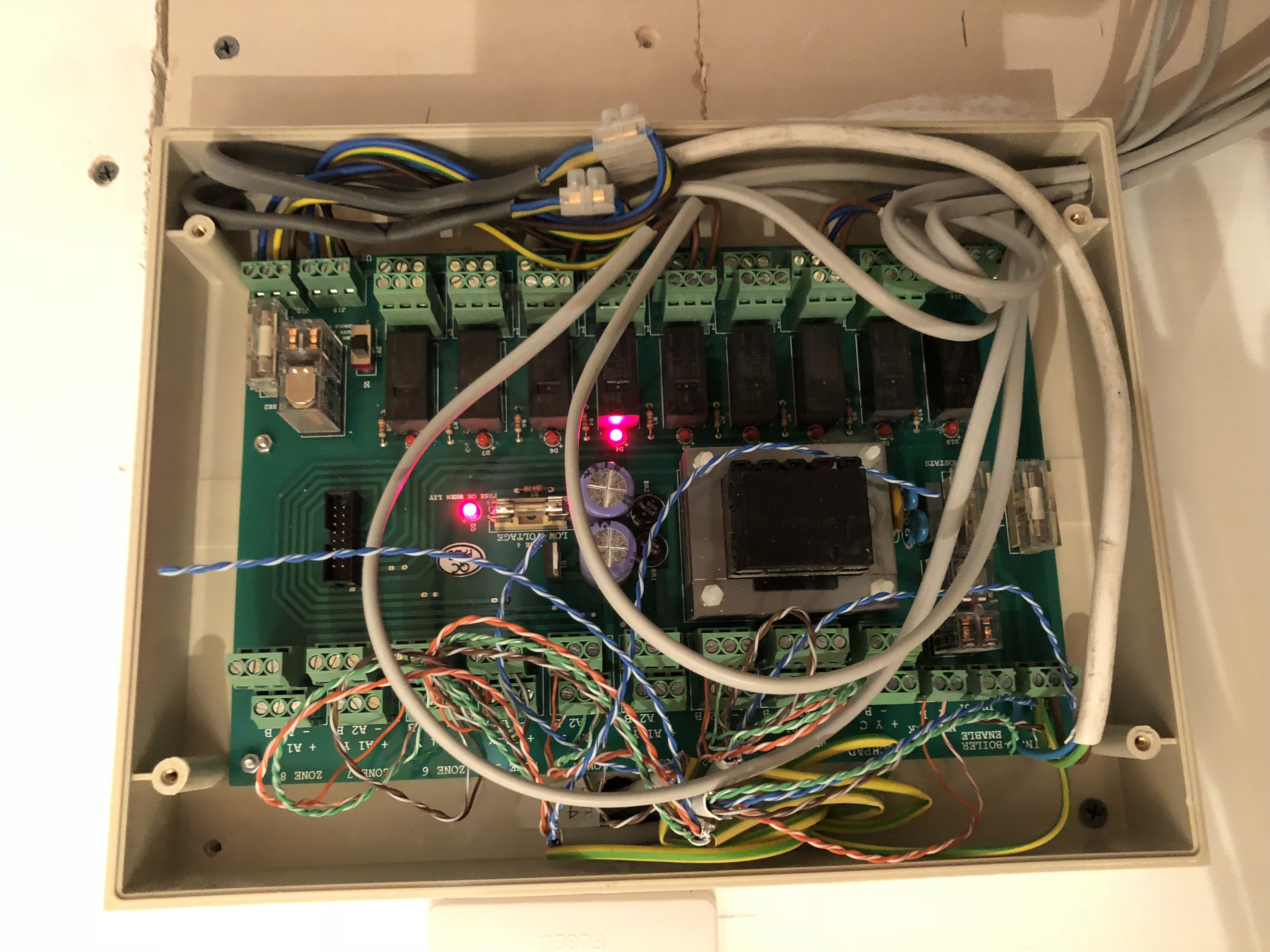

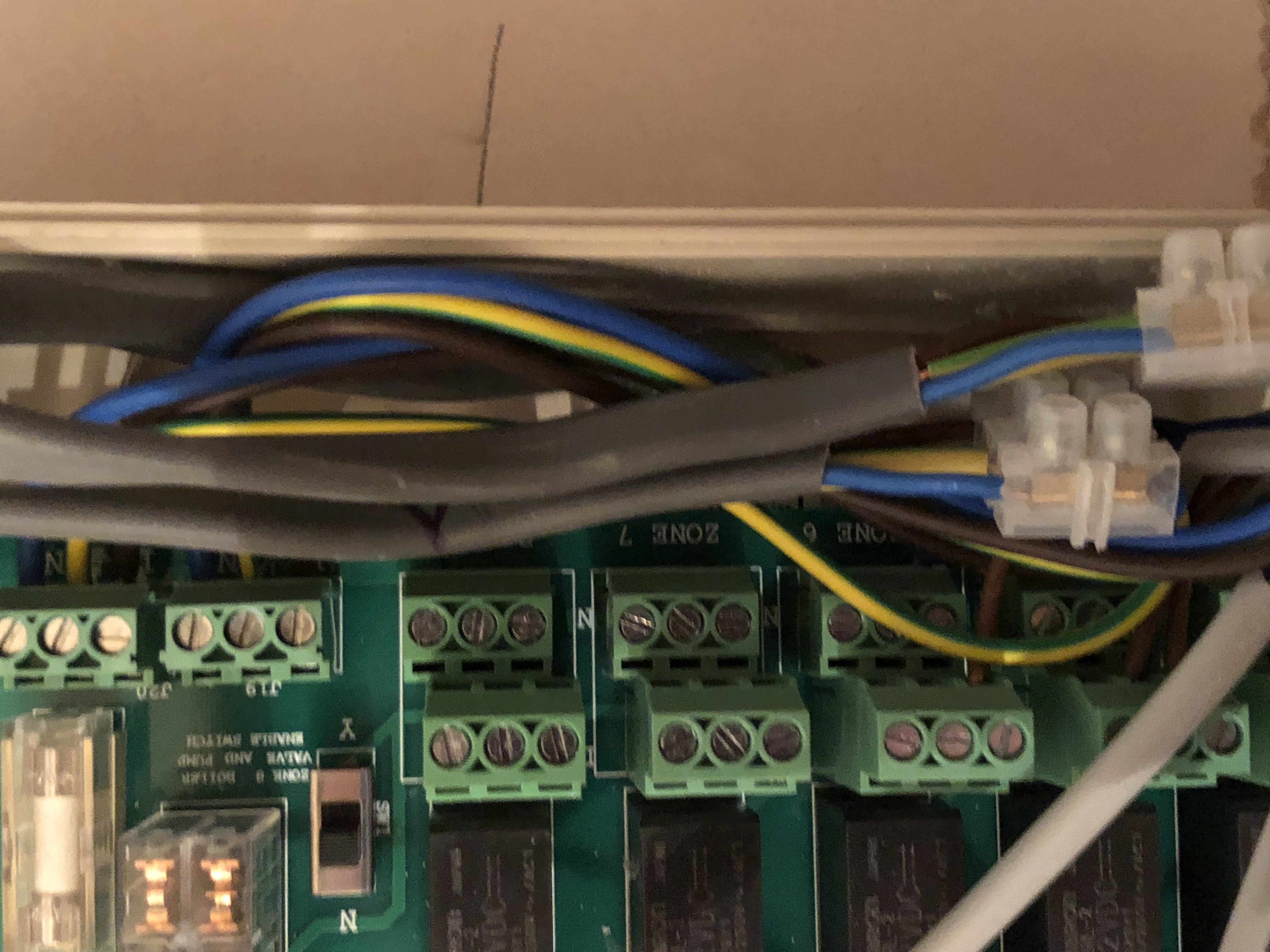

13 minutes ago, PeterW said:

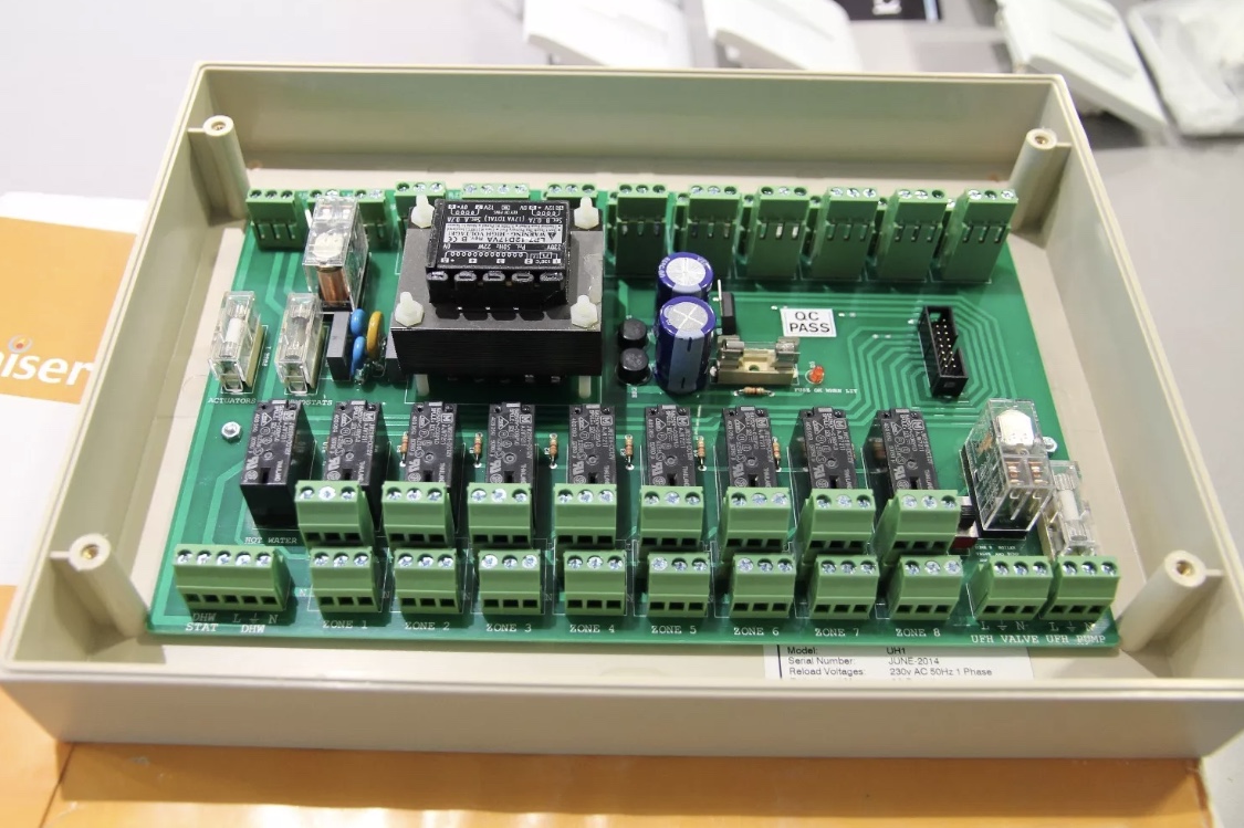

Oooh as you have the screwdrivers out..
any chance of taking the cover off one of the UH1 UFH units and posting a couple of pics of the inside ..? 9_9
Yeah, will do so tomorrow assuming one of the 51 new screwdrivers fits ;)
I’ll not electrocute myself I assume?
I didn’t need to unscrew the immersion cover as I keep it unscrewed as it was a pain in the arse keep having to take it off when the bloody thing tripped out. The last boiler fixer (not cock job) said that he reset the temps to stop it tripping out. I’ve not used it since so can’t say whether it’s working better.

1 minute ago, PeterW said:
It’s more to see what is and isn’t connected ...
Ah ok. Will sort tomorrow.

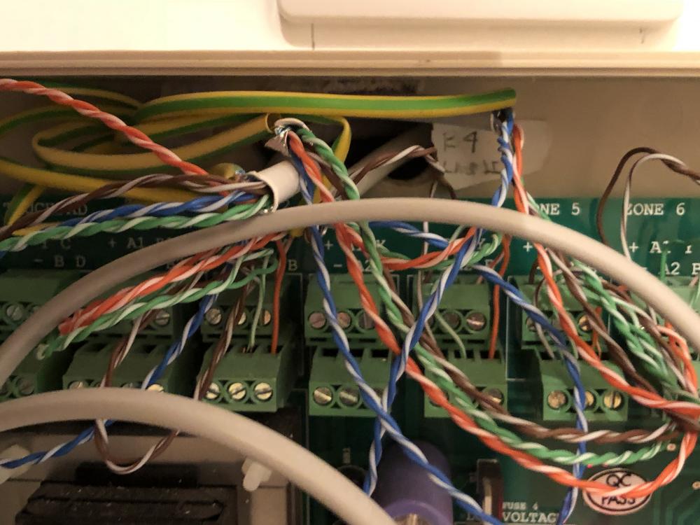

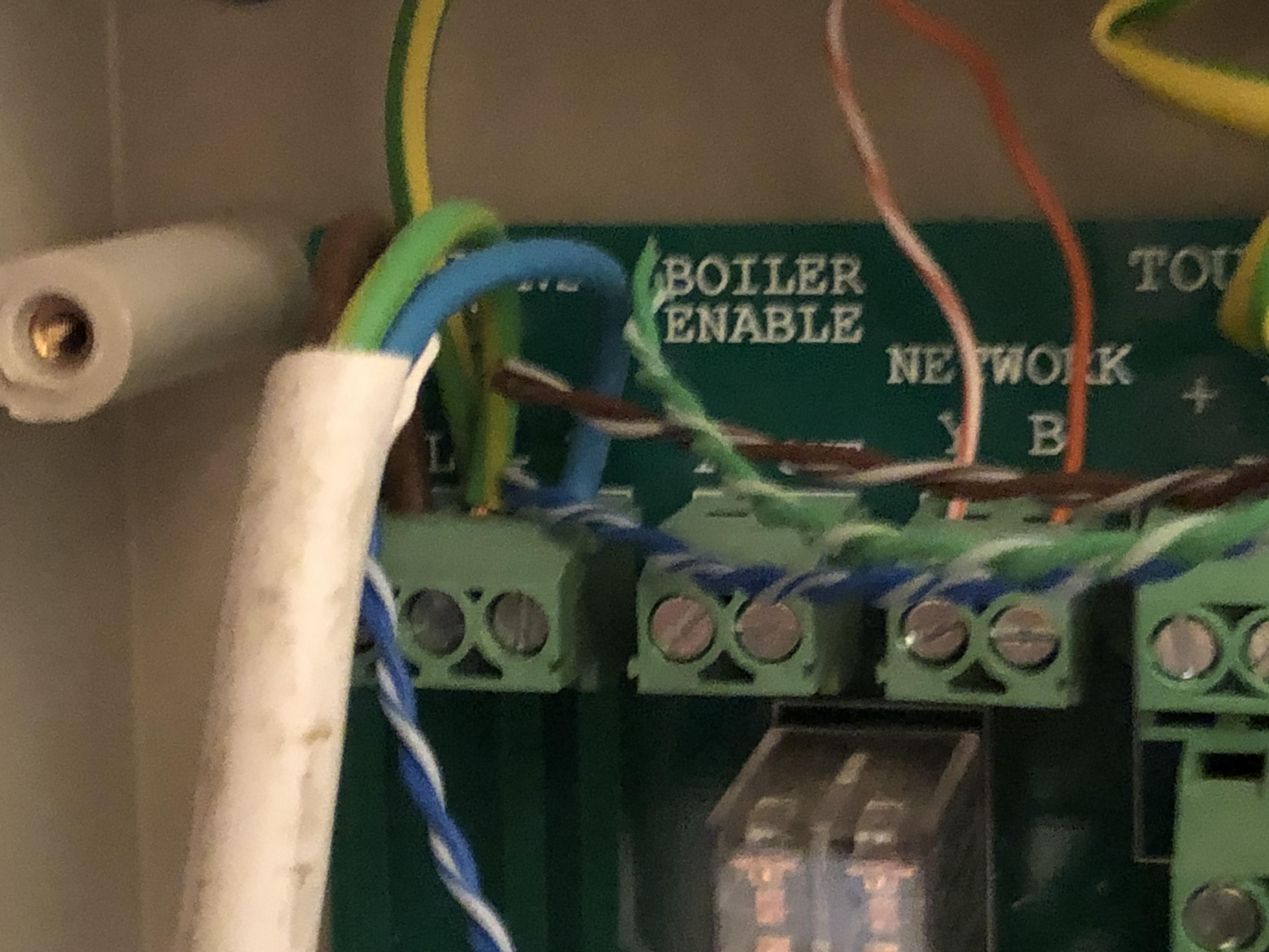

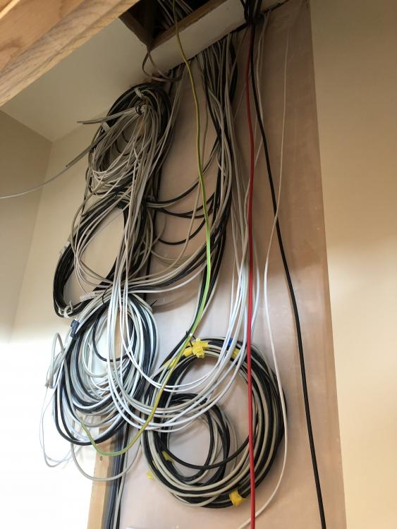

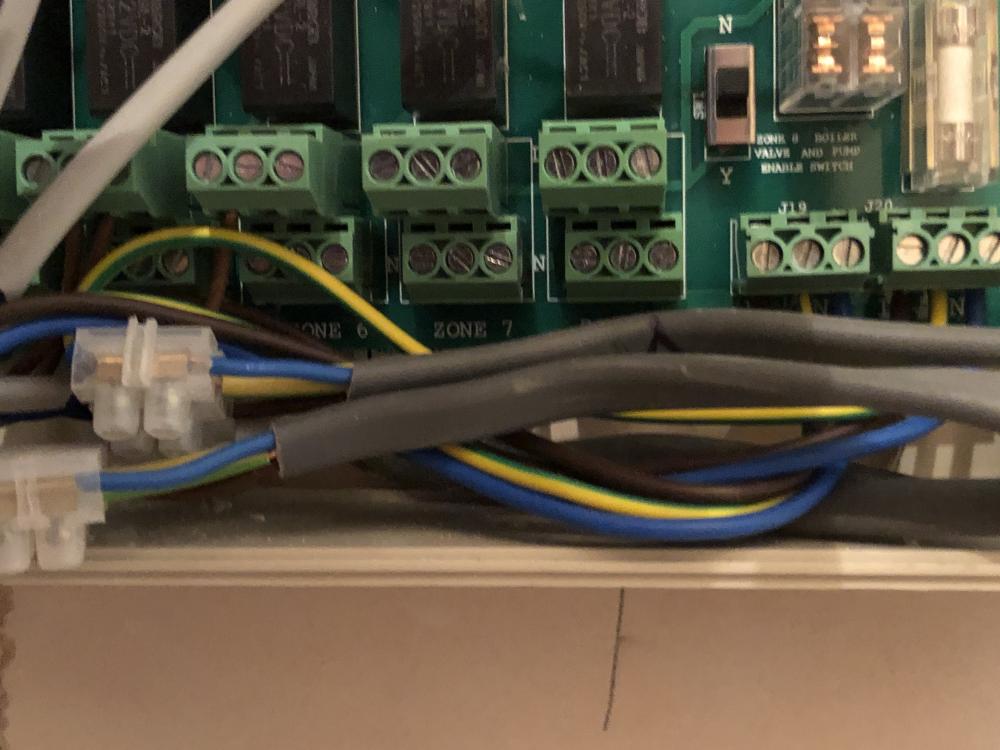

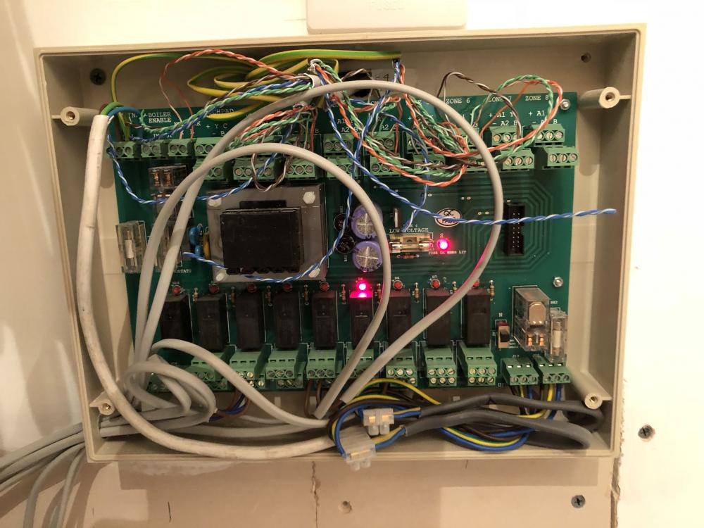

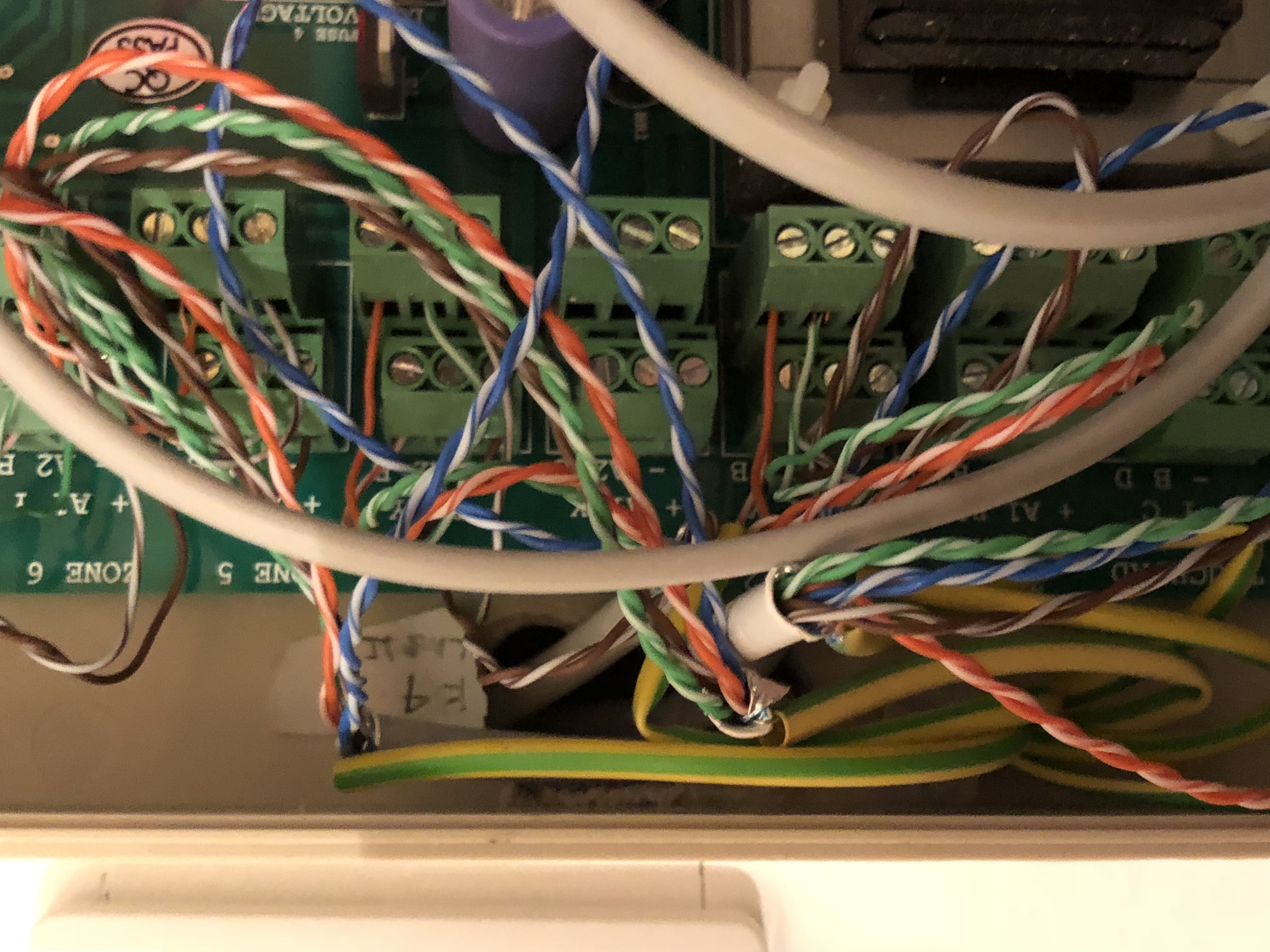

@PeterW here are the Heatmiser photos. It’s manifold 3 upstairs, only so I don’t have to crawl round in a cupboard downstairs. I can do if you need a downstairs photo though.
